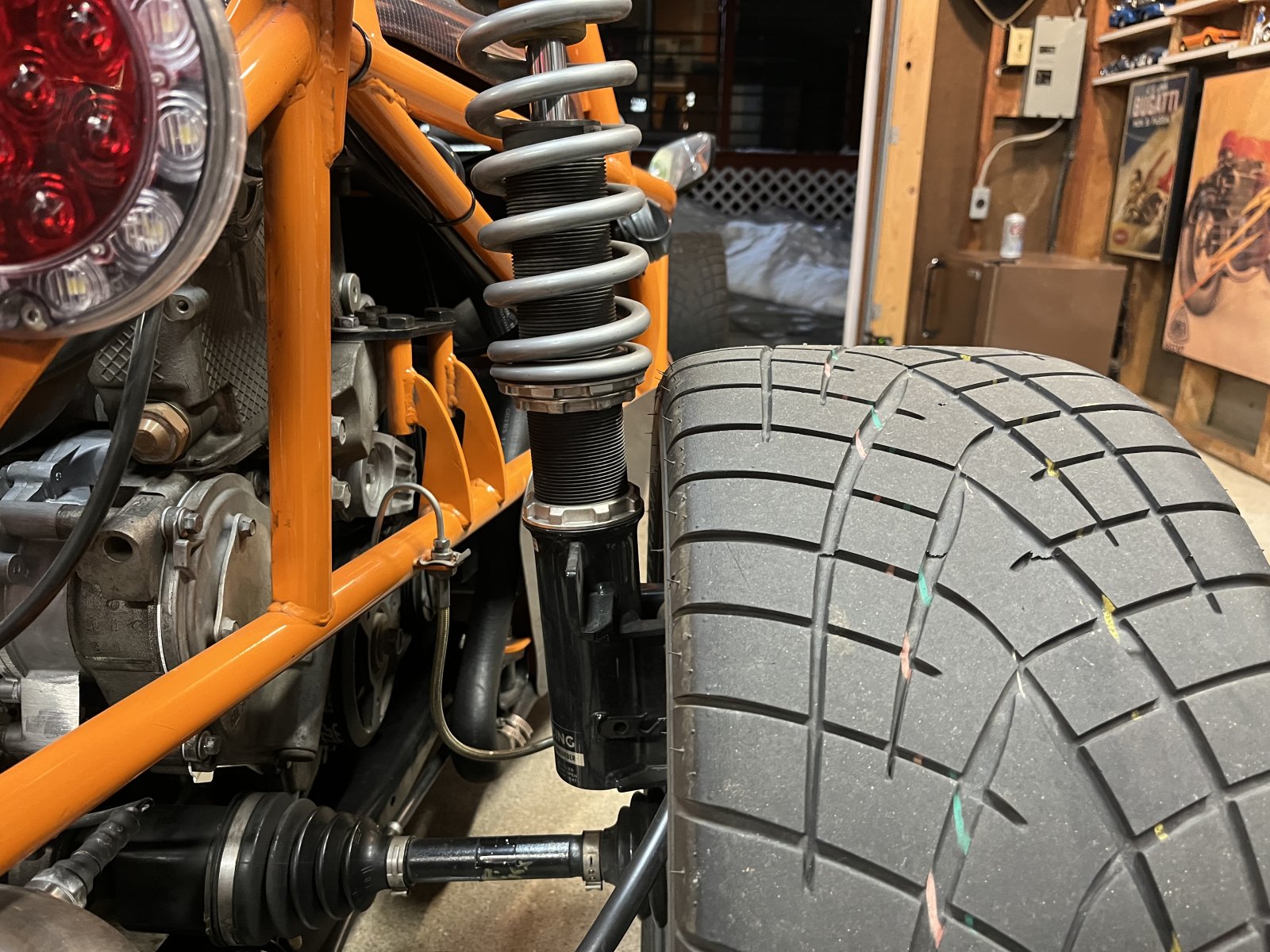

Guys, I’m buying new wheels and tires. Do I need to buy shorter coil-overs to fit the wider tire. Attached is a current pic. I need to have the bottom of the coil above the tire. Any suggestions would be appreciated
I have 275's and needed 1.5" spacers for my wheels. But, my wheels are offset toward the outside of the wheel because they are meant for Mustangs. If you go with wheels that have a closer-to-0 offset, you may not need spacers.

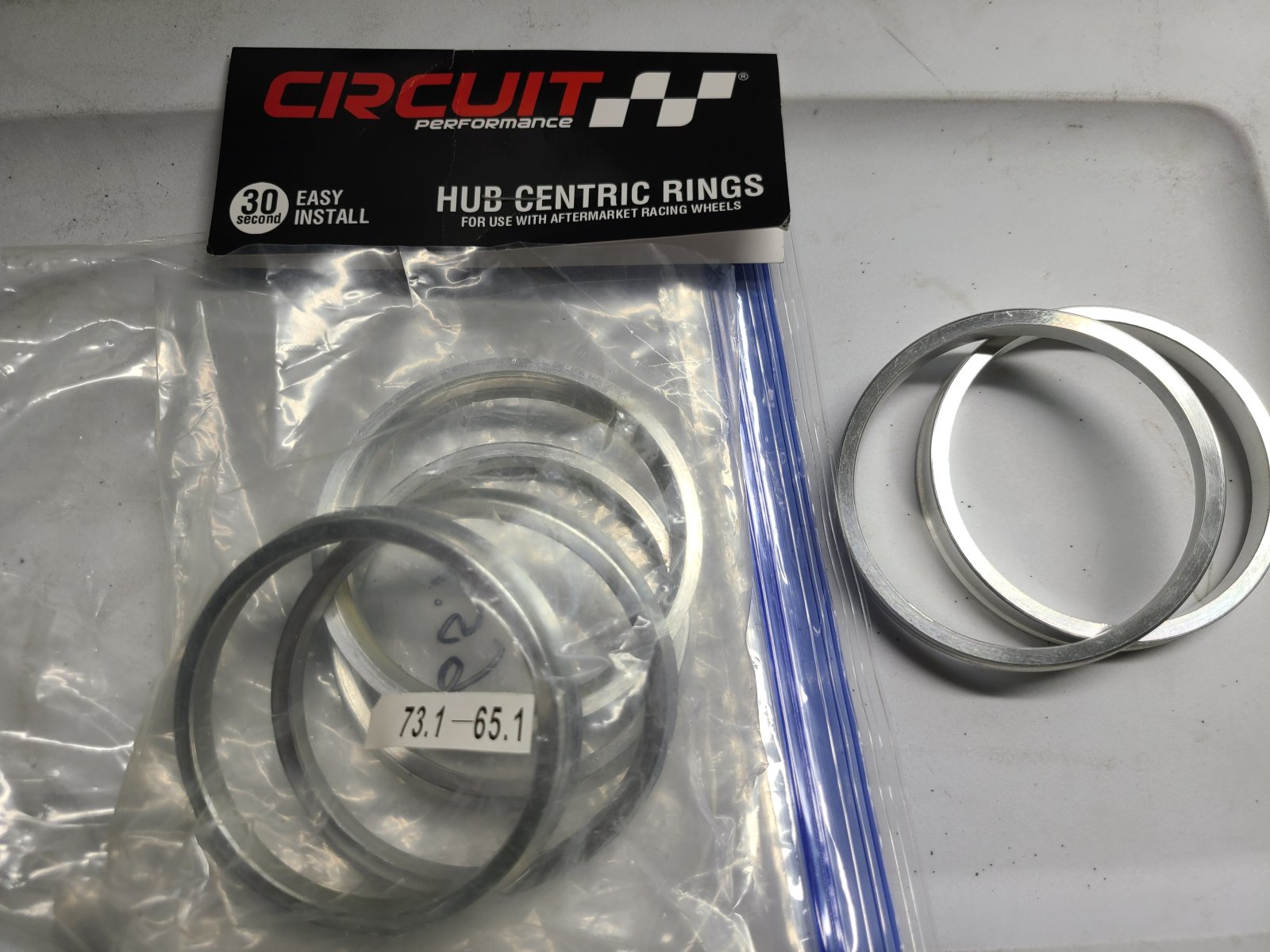

You need to get the 5x110 bolt circle TR4s if you are sticking with the stock Cobalt SS hubs. Hub centric rings are also nice to have, but not required.
They help ensure alignment of the wheel center to hub center to help prevent wheel runout. The VORS TR4s use the 73.1 outer and 65.1 inner size - get the aluminum rings, the plastic ones are crap.
