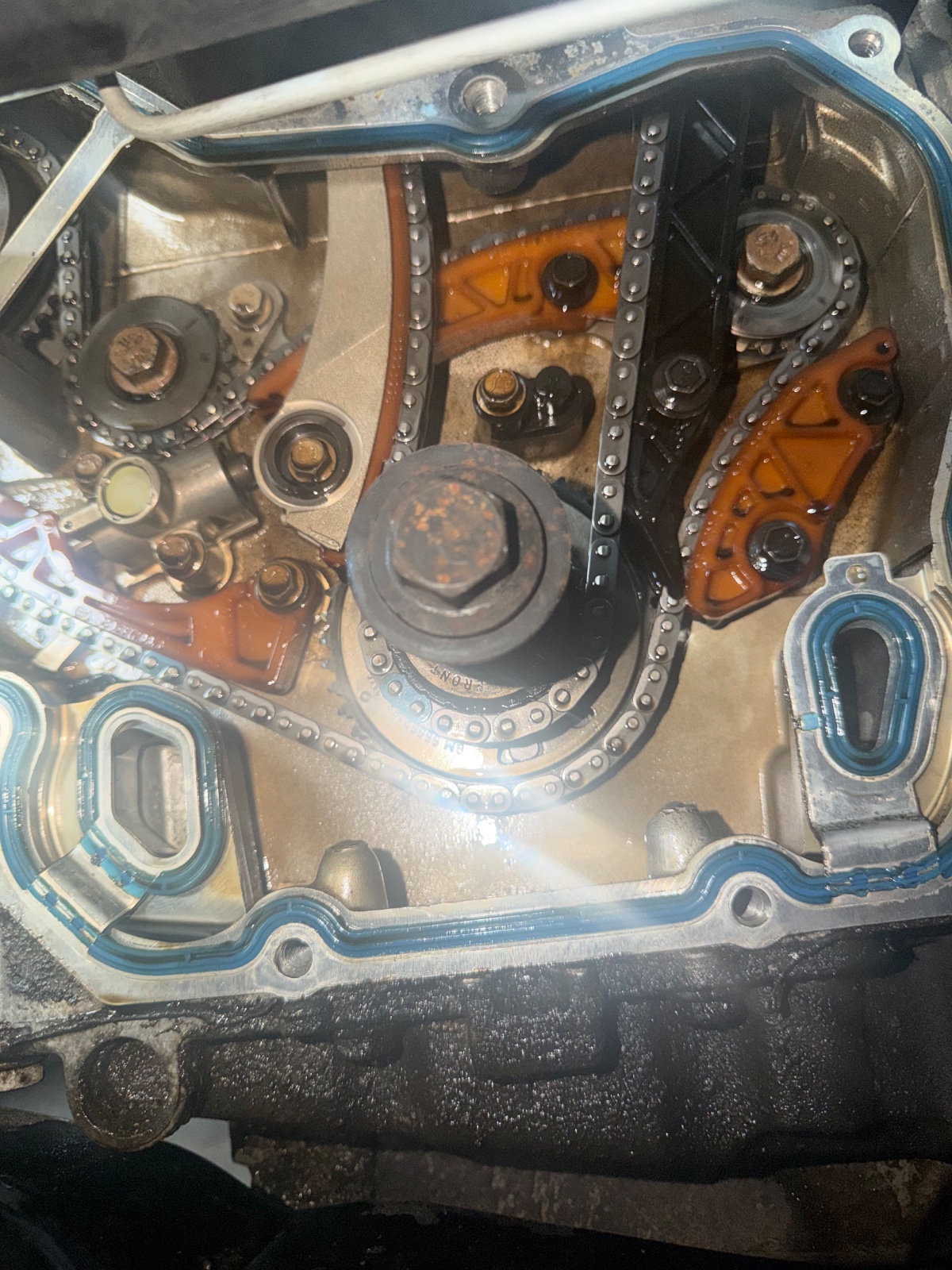

Tried that… it’s definitely coming from lower down. The metal flake worries me. I just noticed my black chain guide looks to be installed upside down

I definitely think it’s timing chain related. But all the chains are tight. The only thing I can think of is if this guide is upside down?

It would certainly appear that guide is upside down. I'm a little surprised it fits that way. Ref this timestamped video from Cloyes on the install of that guide:
I would note also the upper guide bolt is a highly failure prone factory part which is easily bulletproofed by this Dorman part: https://www.dormanproducts.com/pages/products/stories/timing-chain-guide-bolt.aspx
It would be easy enough to remove the upper plug and see what's going on with that guide, and assuming you don't have the Dorman part in there, flip that guide (assuming it's in good shape), put the upgraded part in, and see where that gets you.
