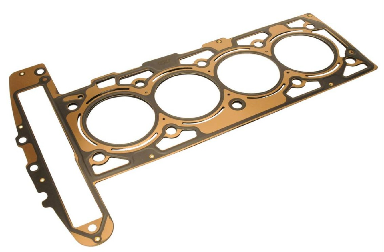

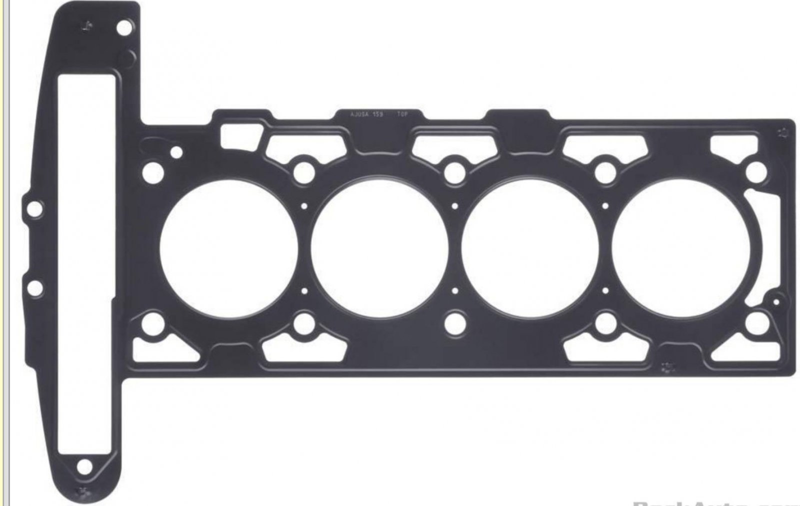

Possible culprit? I was comparing head gaskets and noticed the cometic one I got from ZZP does not have any holes near the cylinders. The original GM version has these long open slots around the cylinder i assuume for coolant passage. Maybe this could be the reason for the coolant leakage? I'm going to find out.
