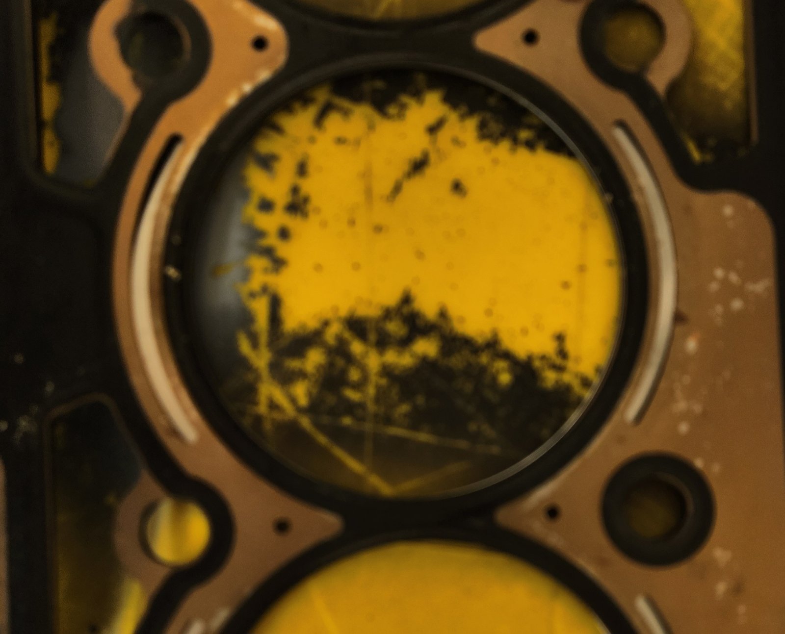

The picture above was taken right after pulling the head. Nothing in the cylinders except a tiny bit of excess assembly lube.

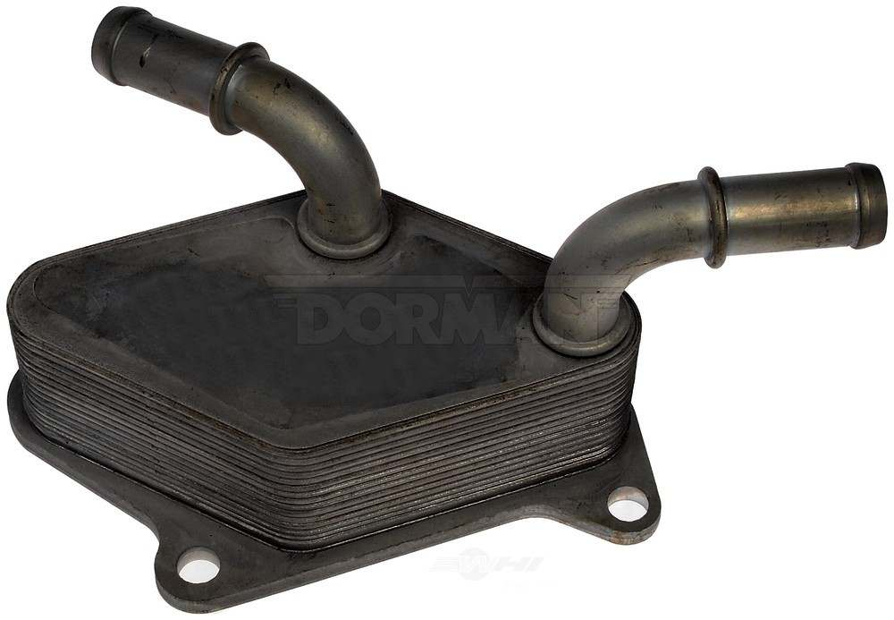

This proves you did NOT have the PCV hose hooked to your cooling system while filling. That mistake would have filled the air passages in the intake and then the cylinders BEFORE the oil pan. BAD oil cooler? Or did you already prove the oil cooler is ok? I have only seen damaged ones leak, and usually damage is obvious leaking pressurized oil to the outside. It is that thing that looks like a stack of plates beside the oil filter. I think it has a small size coolant hose from the thermostat housing and another small hose routed out to a place I don't know? (But I am sure coolant goes THROUGH this cooler, so it has an "in" and an "out" hose, I am unsure where they both go!)**** Most donors had an accident that took them off the road; DID YOURS? You could easily check the oil cooler by taking both hoses (in/out) loose at their source ends, Plug one hose Hold the open end of the other hose higher than the cooler and fill with a funnel through the other hose. IF the cooler is ruptured inside water will again run out the oil drain plug on the pan. ****That would get water in your oil but fails to explain how water is coming out of the bellhousing?(and since my last name is BELL I am always concerned about housings with my name on it! LOL!!) But really, that leak is just weird. 1693407646865.png

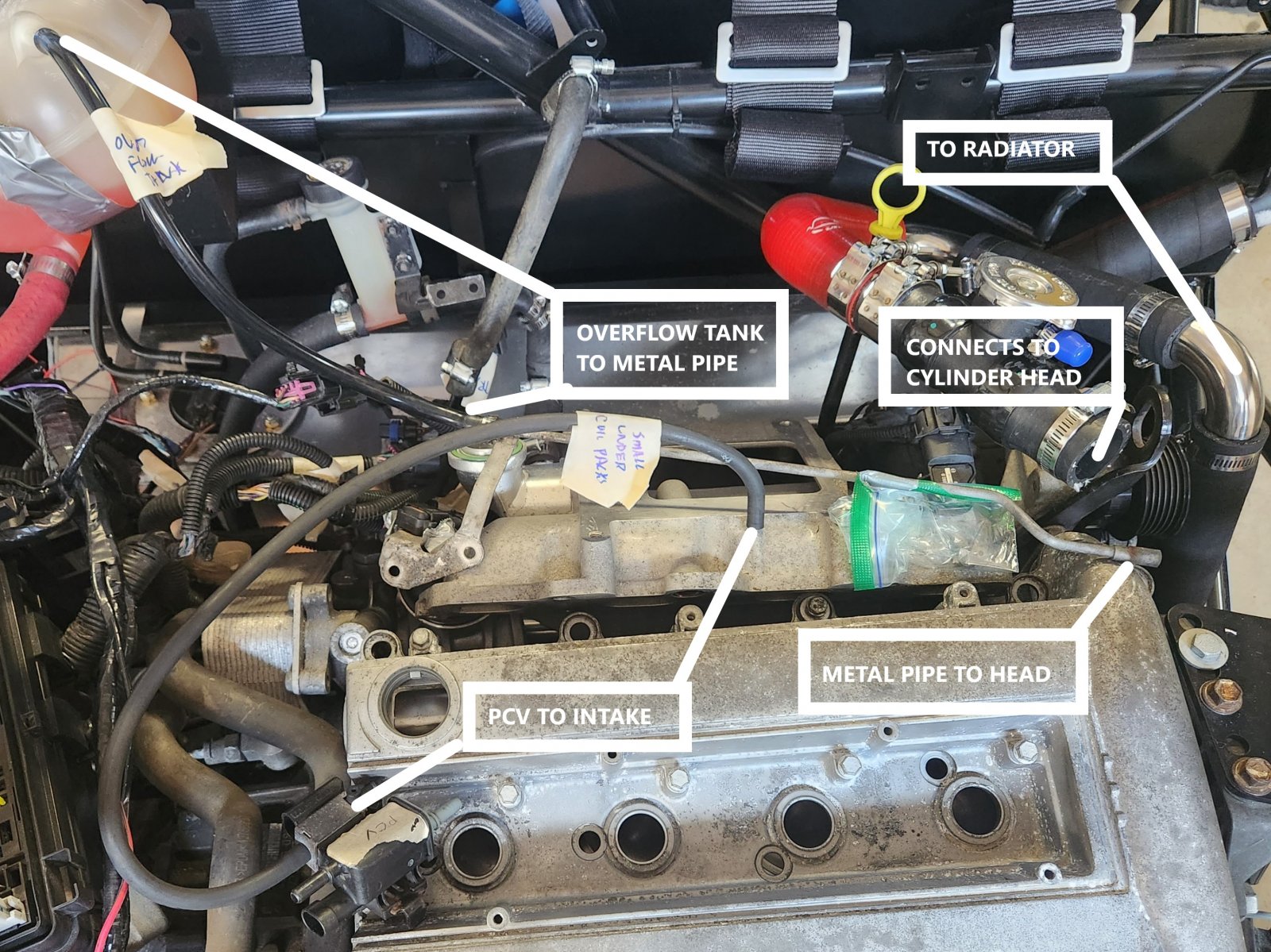

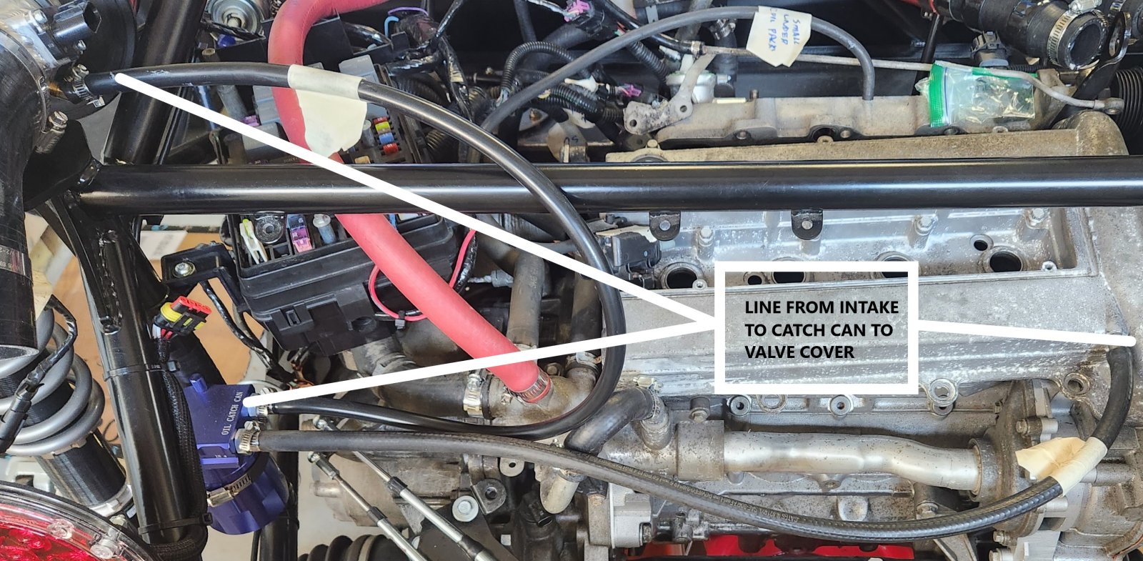

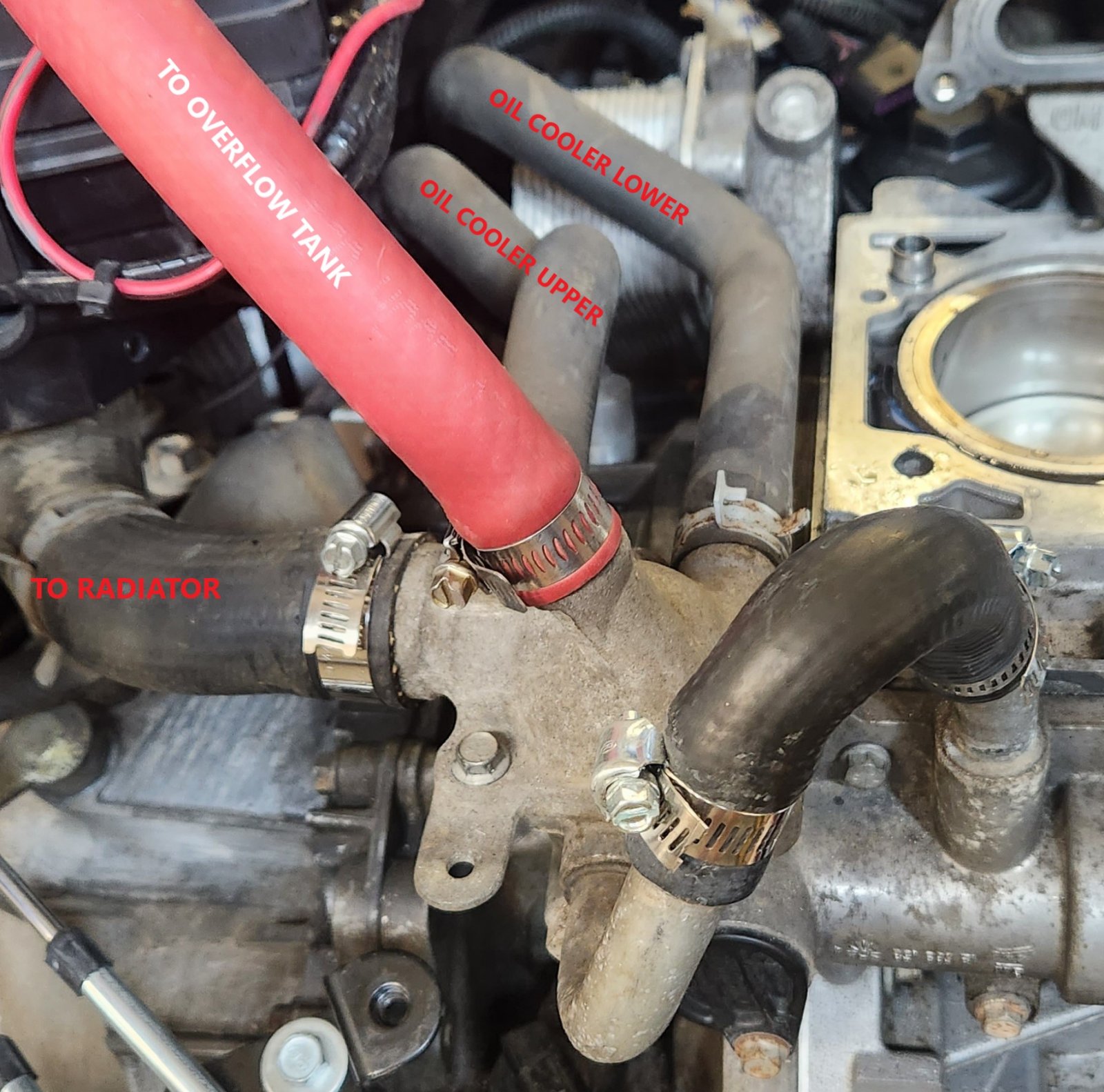

Some had asked about how everything is plumbed in my engine. My engine is partially disassembled but these pics show my plumbing.

What you have labeled as PCV to Intake in the first picture is actually a vacuum line that goes through the boost solenoid to the bypass actuator, but all the coolant and PCV lines look like they're plumbed/piped correctly.

Have you checked to too see if the oil cooler is leaking yet?
AND oil coolers are cheap and easy to replace! Could the water pump be leaking into the timing chain area? We've covered so many possibilities I can't remember. This pile of brains ought to be able to figure this out!

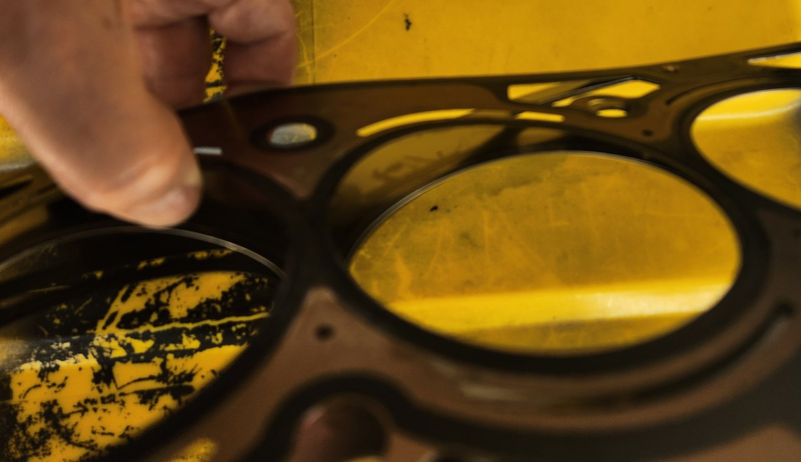

I did have a question about gaskets. All the ones I have tried are multi layered and I noticed the middle layer is open. For example, the semi circular openings around the cylinders have a direct passage to all the oil passages with this middle layer.
