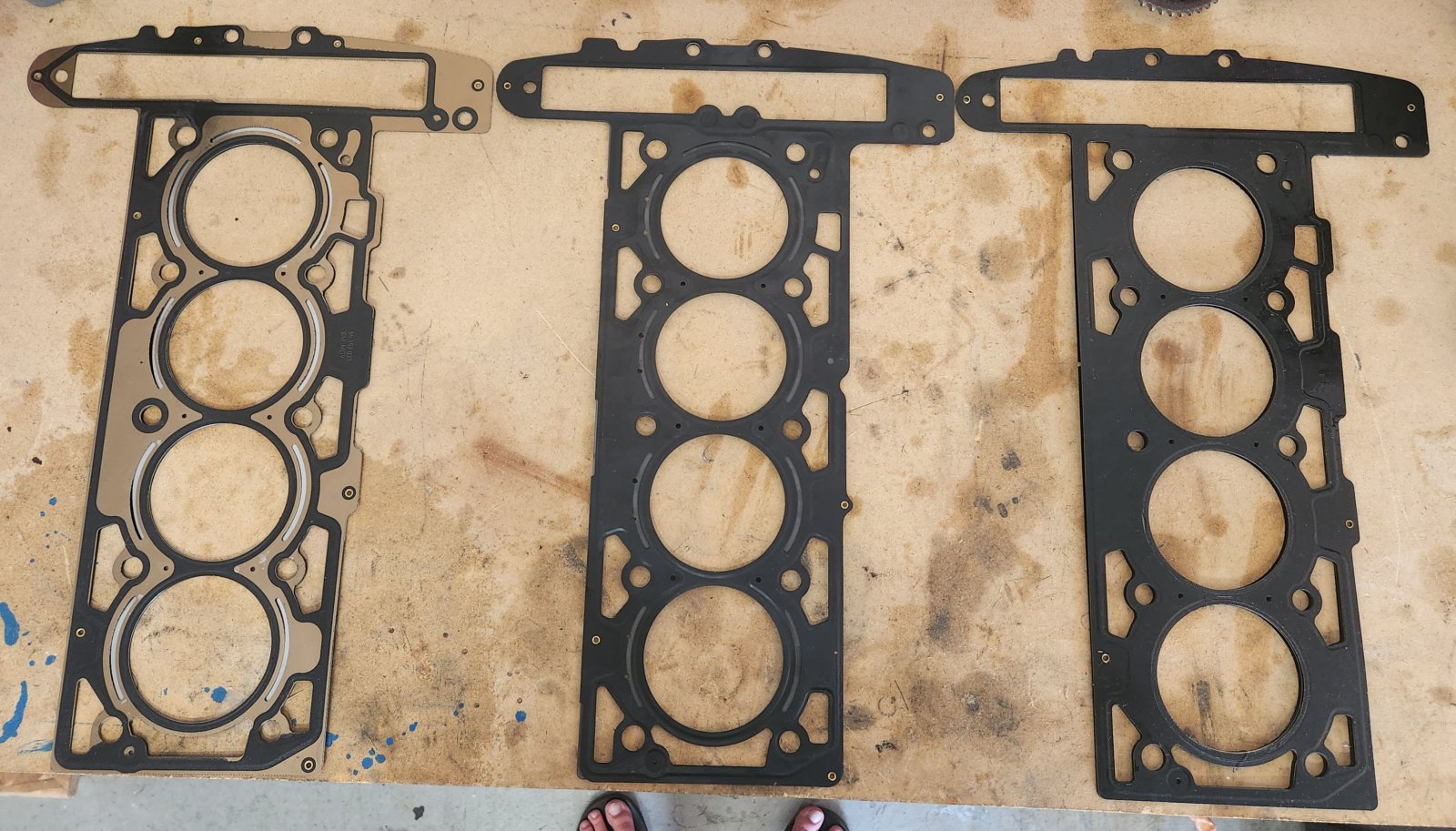

Just for giggles I put the head back on with no gasket. No leaking! None at all. Clearly it's an issue with the gasket. I have tried 4 now purchased from ZZP, Rock Auto, GM Authority, and somewhere else. All were supposed to be LSJ. The holes seem to line up. There is very small variations between the last 3 versions as shown in the pic.
But still, no gasket no leak. What does this mean? Do I run without one?

Did you use any sealant on the head bolts into block? That is a strange one - eh?? All of those last gasket pictures match -- except for the gold one which has extra holes (3) around the cam gears but they have sealant rings around them.
The middle black one has two extra things at the cam chain head side in the middle.
Which one did you have on the car when it leaked??
Otherwise all those gaskets look like they have the same passageways. Gold and middle black have the semi-circle areas at the cylinder liners. The last black one deletes those but still has the steam holes which in effect work the same by allowing a pathway head to block. Different designs with same function.
