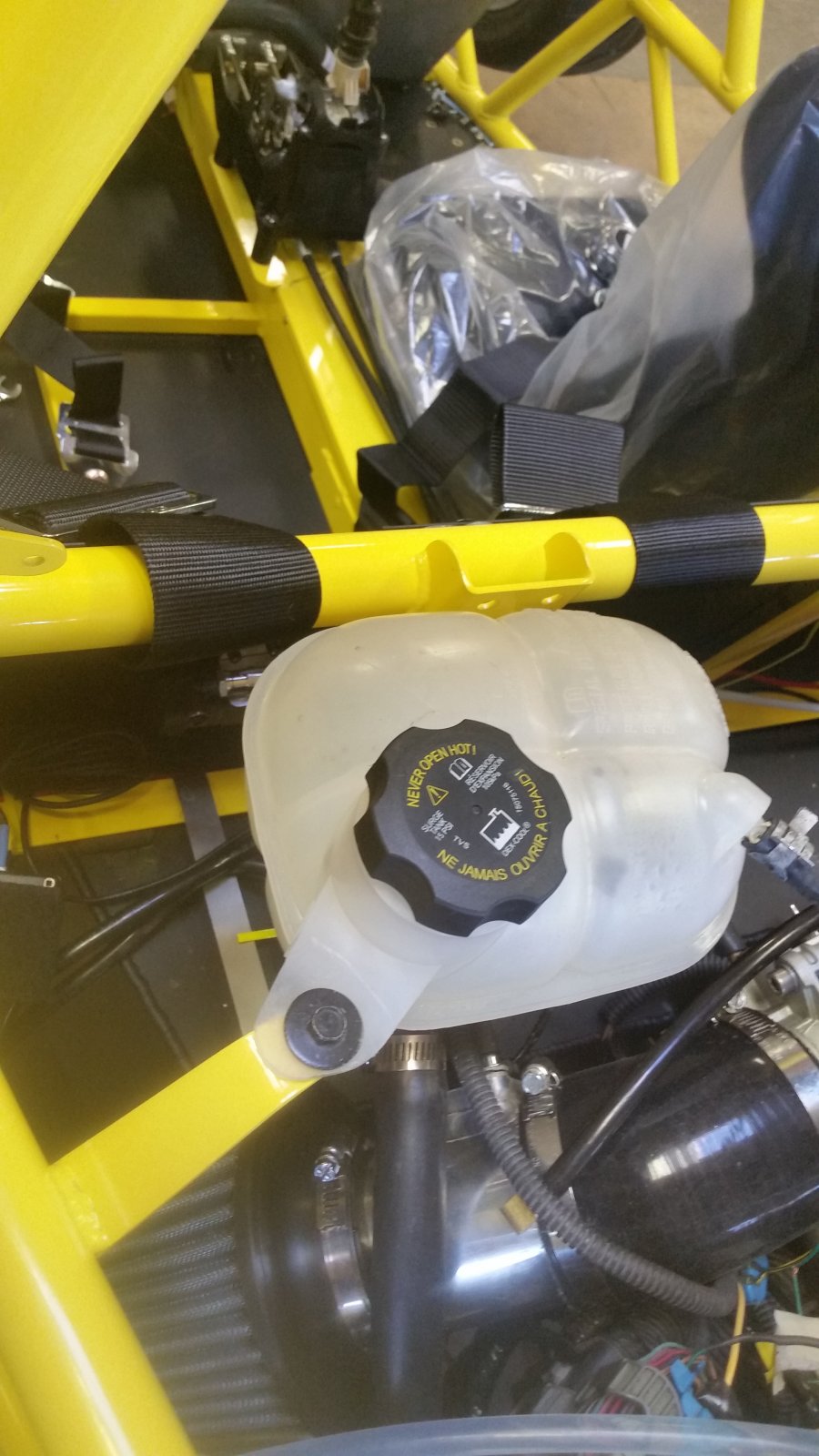

07 SS SC tank mounted
Brad

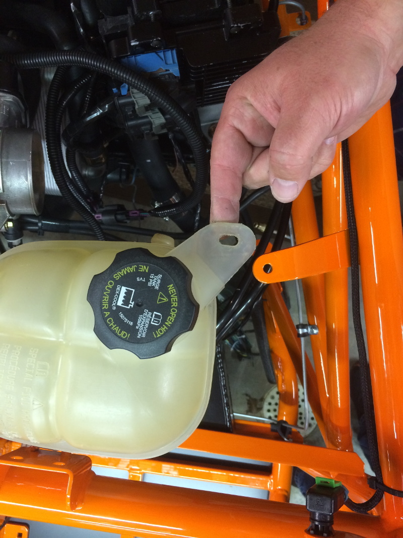

I can't figure this out. I would have to twist this tank to get it to bolt up. If it were straight and level, this is where it would have to bolt down.

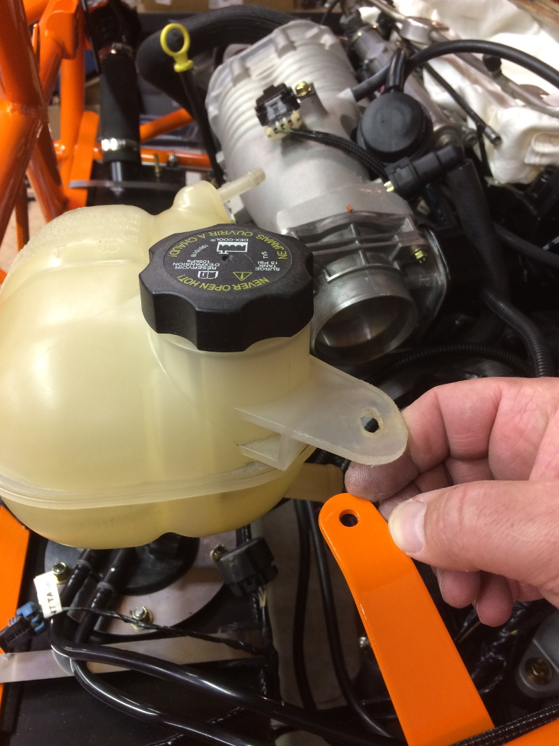

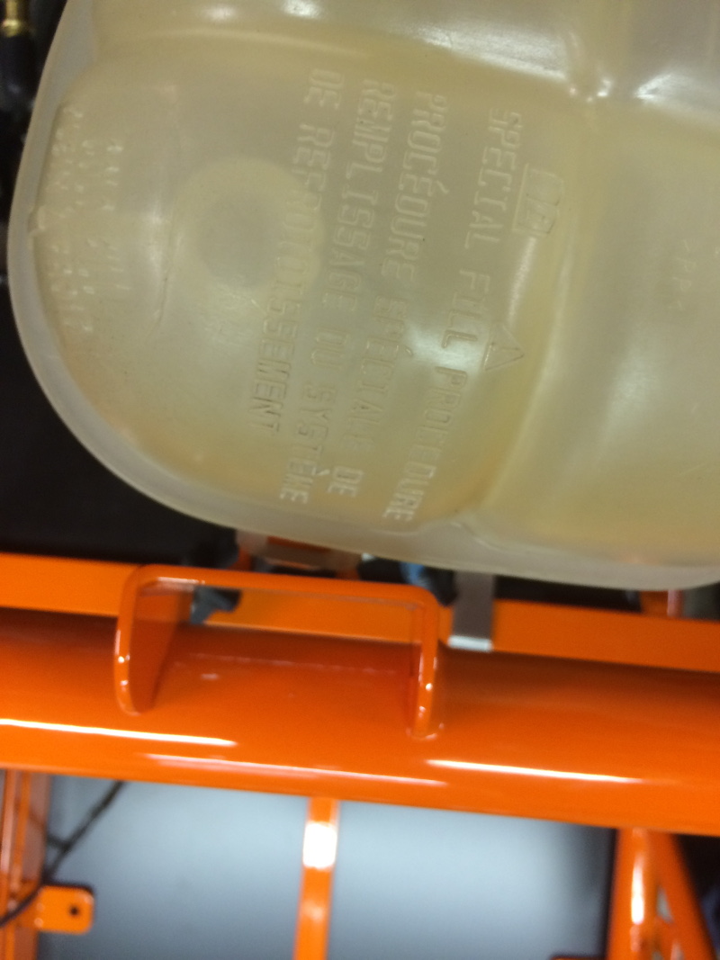

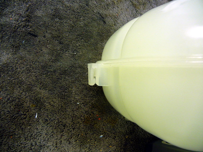

Here is how far off the mounting is if it's clipped in straight.
If I force it to mount, here is what it looks like, the tank is twisted and not level:
Here is the mounting if the tank is straight and level. Are any of yours off this far? Did everyone just shove it over and bolt it down or do I have something different going on here?
That is exactly what mine looked like. Just had to pull it over to get the bolt hole lined up. I didn't really like doing it that way because it puts the clip under constant strain and it might break down the road, but I didn't see any other way. The plastic seems pretty springy though so hopefully it won't break later on.
George
No real effort required. When I removed it the clip had taken a set so when reinstalled it just dropped into place.

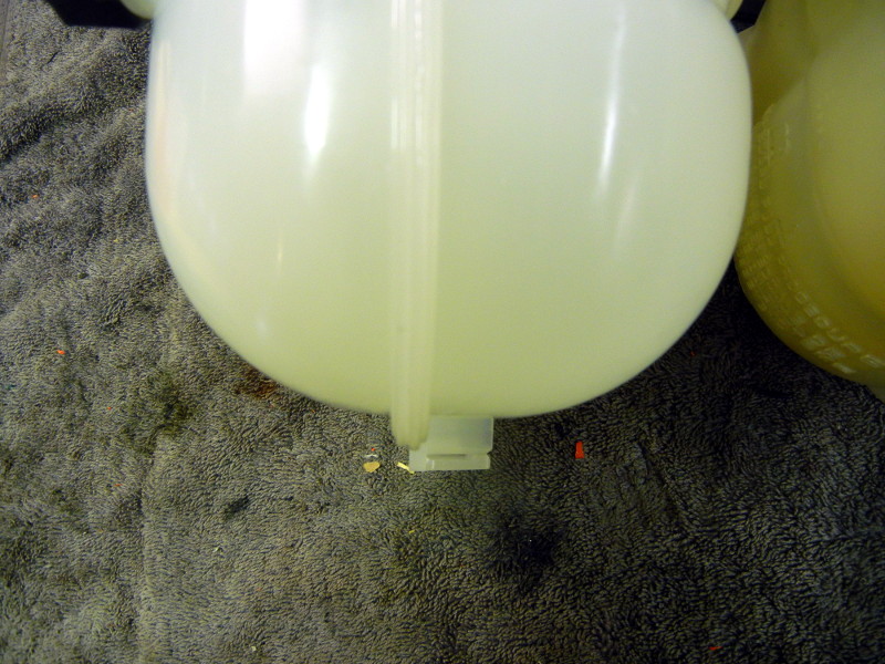

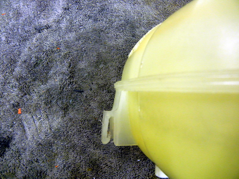

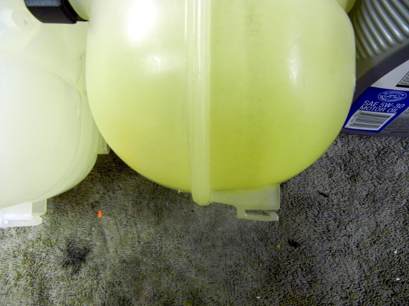

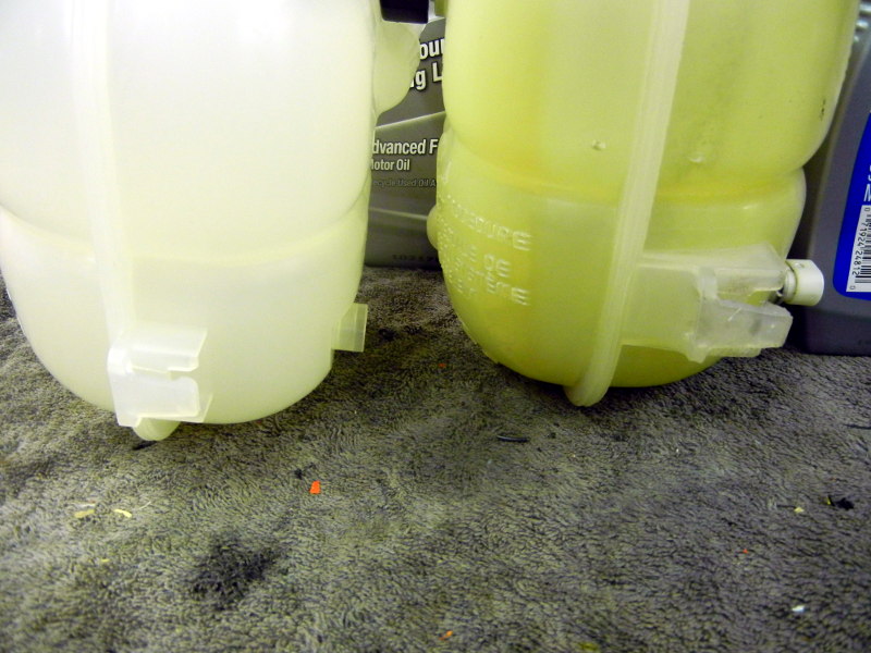

Looks like the tanks between the Base model and the SS/SC are in fact different. There are two differences, one the clip mount is at different heights and the Base model has an additional mount that is not use in the our build. I purchased a new Base model tank (which is $40 cheaper than the SS/Sc model) to see the difference. The Base model is the more white one in the photos.
The answer to my question in this thread is there are two things wrong. The bracket was welded on at a bad angle (neither line up well front/rear) and the SS/SC sits higher in the mounted position.
