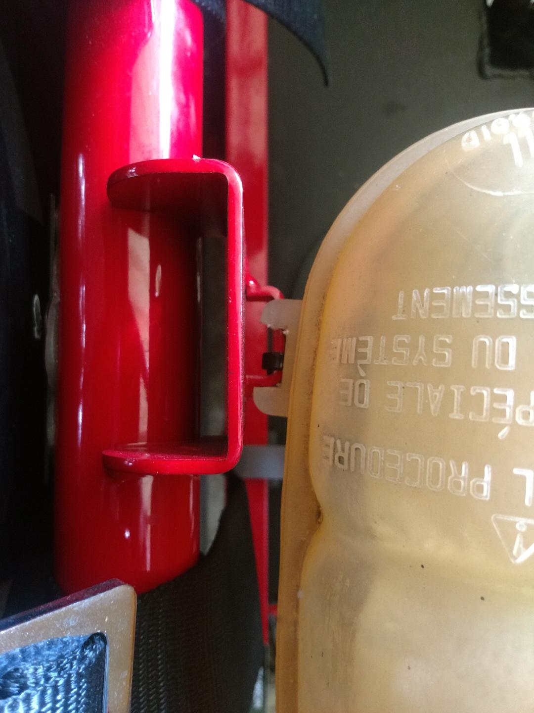

My tab was broken when the donor was wrecked but I was able to use a zip tie to attach it. Haven't had any problems. Although now that I look at it, I would have needed to twist it to line up the bolt as well.
