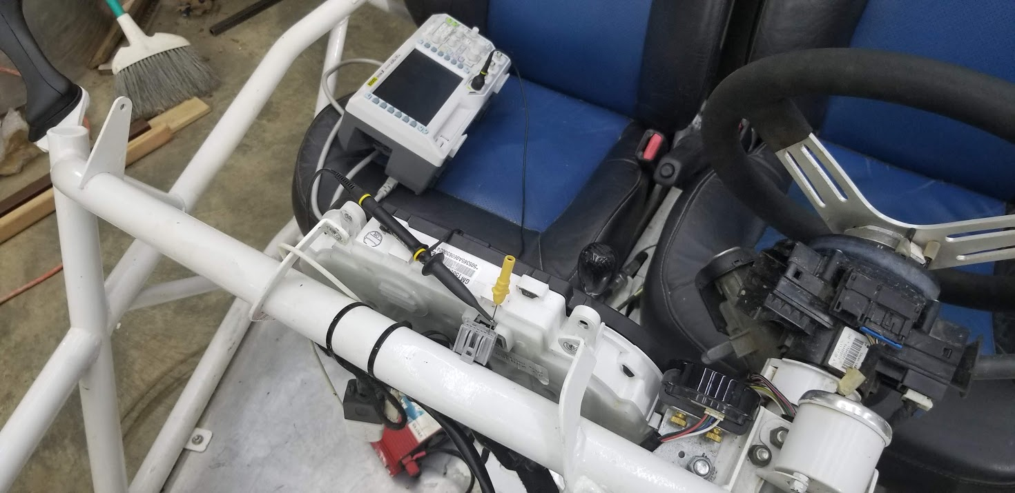

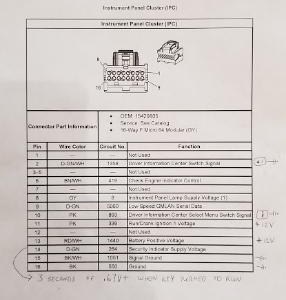

So I probed the wires going to the dash cluster:
15760
Pin 2 - goes to ground when the button is pressed.
Pin 6 - It is 0V as my check engine light is off.
Pin 8 - PWM signal that changes based on the dash brightness knob.
Pin 9 - I am getting data packets on this. There is a fair amount of data, and I don't have a data logger or sniffer, but I can take a screen shot on my oscilloscope and see data packets. Guess I could decipher some packets manually.
Pin 10 - goes to ground when the button is pressed.
Pin 11 - goes to 12V when key is on
Pin 13 - 12V+
Pin 14 - normally 0V, but goes to 0.67V for 3 seconds after key is turned on
Pin 15 & 16 - 0V ground.
I have tried 2 dash clusters, and 2 BCMs, but the problem persists.
Today I drove the car with the oscilloscope on the GM Low Speed LAN wires, but the data packets are still flowing when the gauge issue occurs.
I have voltage probed the dash wire connector with the gauges working, and not working.
Not really sure where to go from here.
I have ordered parts so I can do data sniffing on the GM Low Speed LAN, but that will be a while.
I need specs on what the GM data packets mean, so I know which ones are for the gauges.
Probably be faster just to do visual wiring inspections everywhere... wish I had better method.

Where did you get the detailed table with all the pins? I've got access to Chilton's library, and found the overall wiring diagram, but don't see this kind of table in it. I've got a '07 base, and don't think the wiring is the same as yours.
