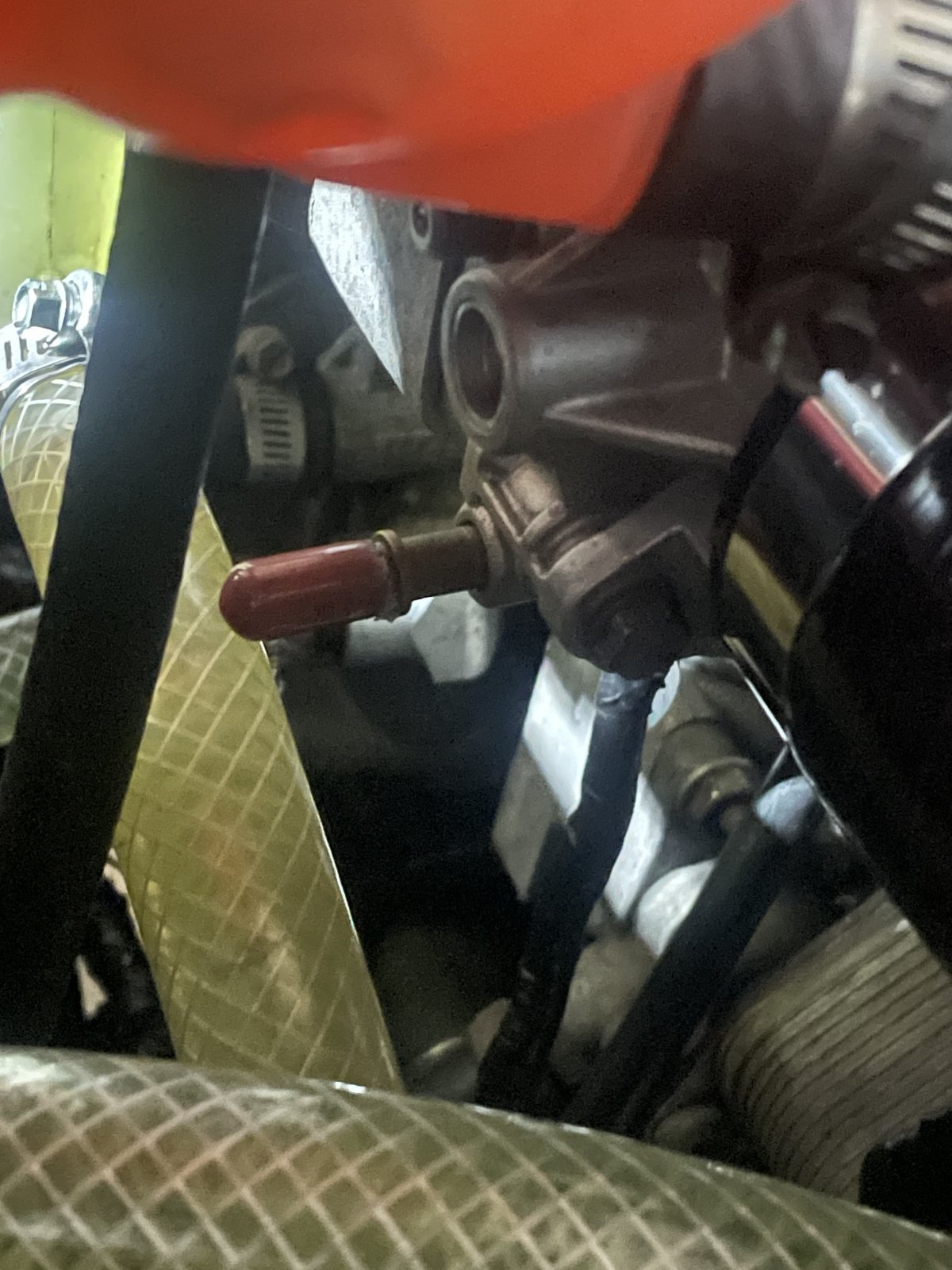

The barb at the throttle body was where the EVAP system connected to the intake manifold. It should be capped.
The supercharger bypass solenoid and EVAP solenoid shared a bracket. What you're holding looks like the supercharger bypass solenoid to me. I don't think the EVAP solenoid had three ports. It looks like the EVAP solenoid has been removed from your bracket.
To address a point you made earlier (perhaps in another thread), connector views and wire colors are both useful tools in figuring out what's what.
