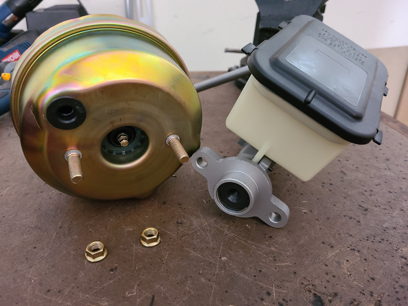

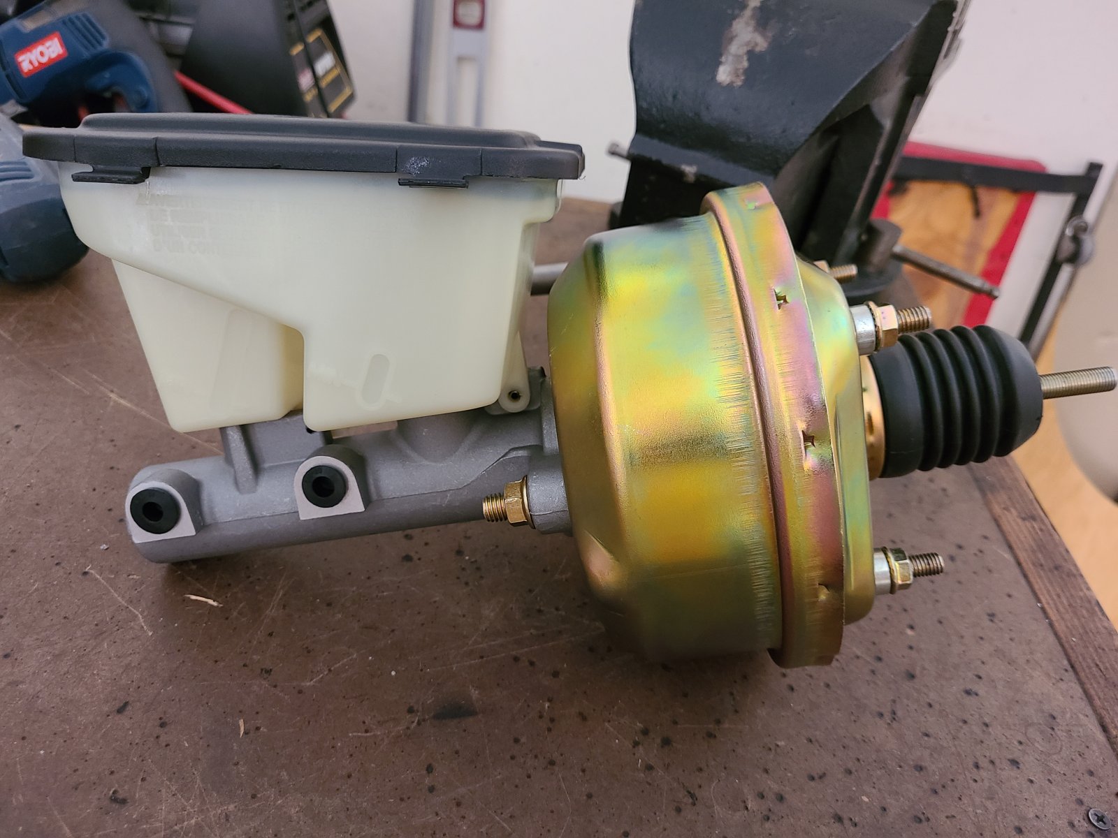

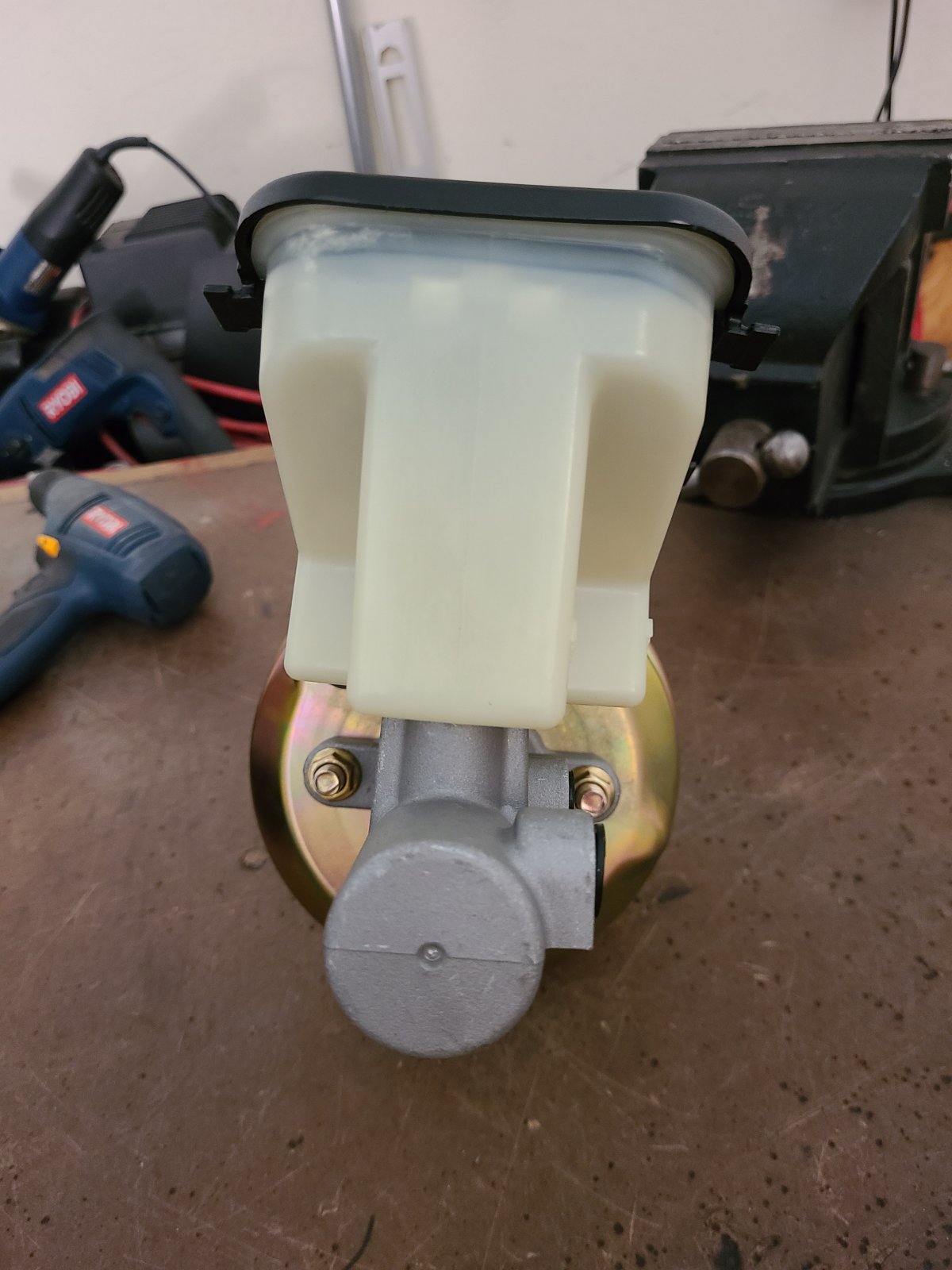

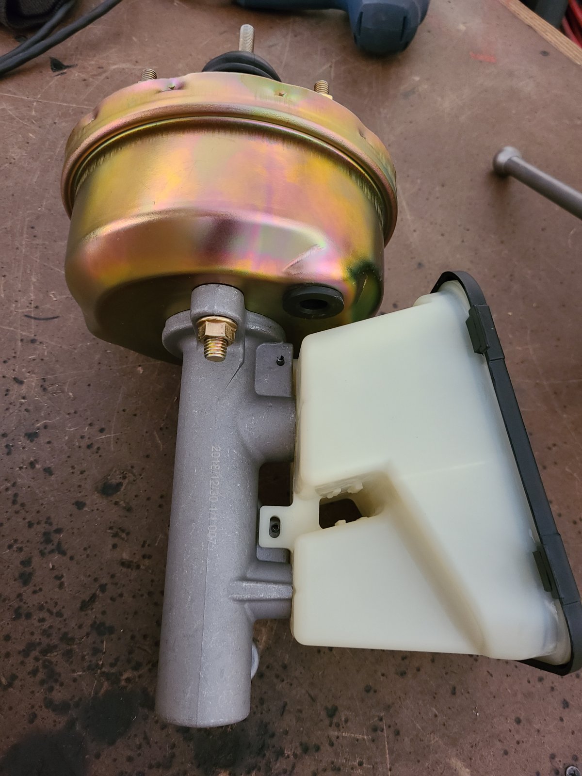

Braving the record heat here in Arizona (35 days and counting at 110* or higher :eek:) I finally got around to modifying the brake booster mount to accept the 7 inch single diaphragm one I purchased quite a while ago. Had to weld shut the 'metric' booster mounting holes in the pedal assy and frame bracket to re-drill for the standard GM 'universal' 4 bolt mounting pattern, which is wider by 1/4 inch.
This new booster is 3 inches smaller in diameter than the Cobalt booster, weighs significantly less and will accept many different brake master cylinders - which can be better matched to the Goblin braking requirements. It also has more under hood clearance for the cockpit air vent mods I made to the underside of the hood. I haven't decided the brake master cylinder yet, but looking at some aluminum Corvette disc/disc units - with chrome cap. ;)
I have been researching brake master cylinders for a while, that would match up to my smaller brake booster and have a large enough piston to get the correct geometry for the expected pedal feel that I'm looking for. Took a chance and ordered one for a Chevy Astro van - has the correct mount spacing, piston engagement face, and is the correct piston size (1.125 inches). The one thing I was concerned with was the overall length to fit into the space between the face of the booster and the top rear edge of the radiator - I measured it at just a hair over 7 inches.
Got it in this afternoon and it fit perfectly for face engagement and length, right at 7 inches. The stock reservoir will have to go - not sure about a remote mount for it - but adapting an aftermarket one shouldn't be a problem.
Overall, the smaller booster and aluminum master cylinder saved about 2 pounds over the Cobalt pieces. BTW, at some point, after getting everything fitted for my new setup, I will have the Cobalt setup - booster, master cylinder, reservoir, DF adapter parts - available to go to a new home. ;)

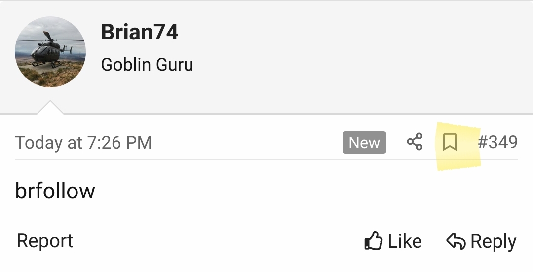

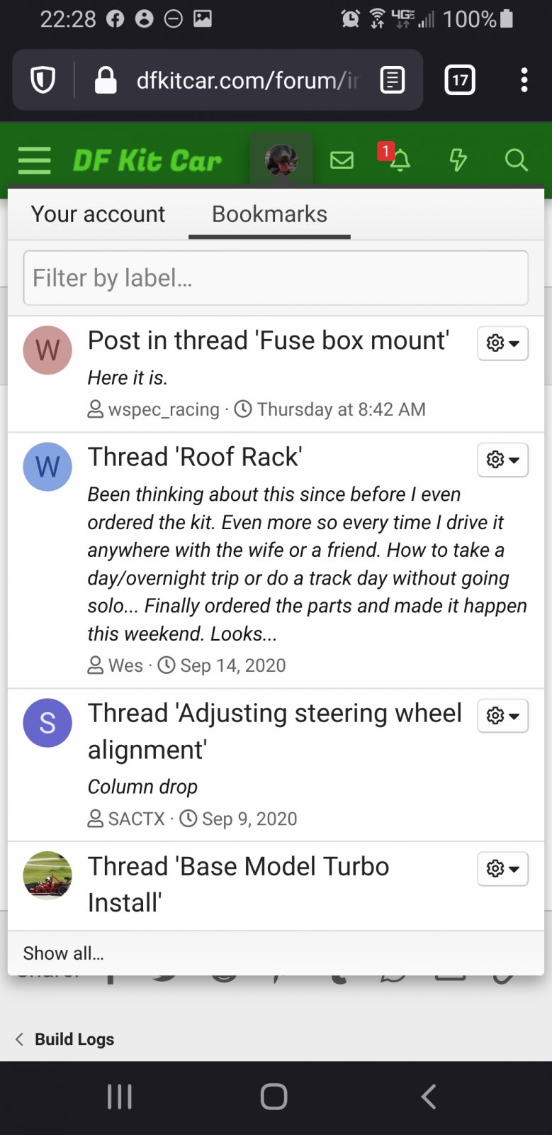

If you click on the icon I highlighted in the picture, it adds the post to your forum bookmarks. Just another tool for stashing information for later reference.
