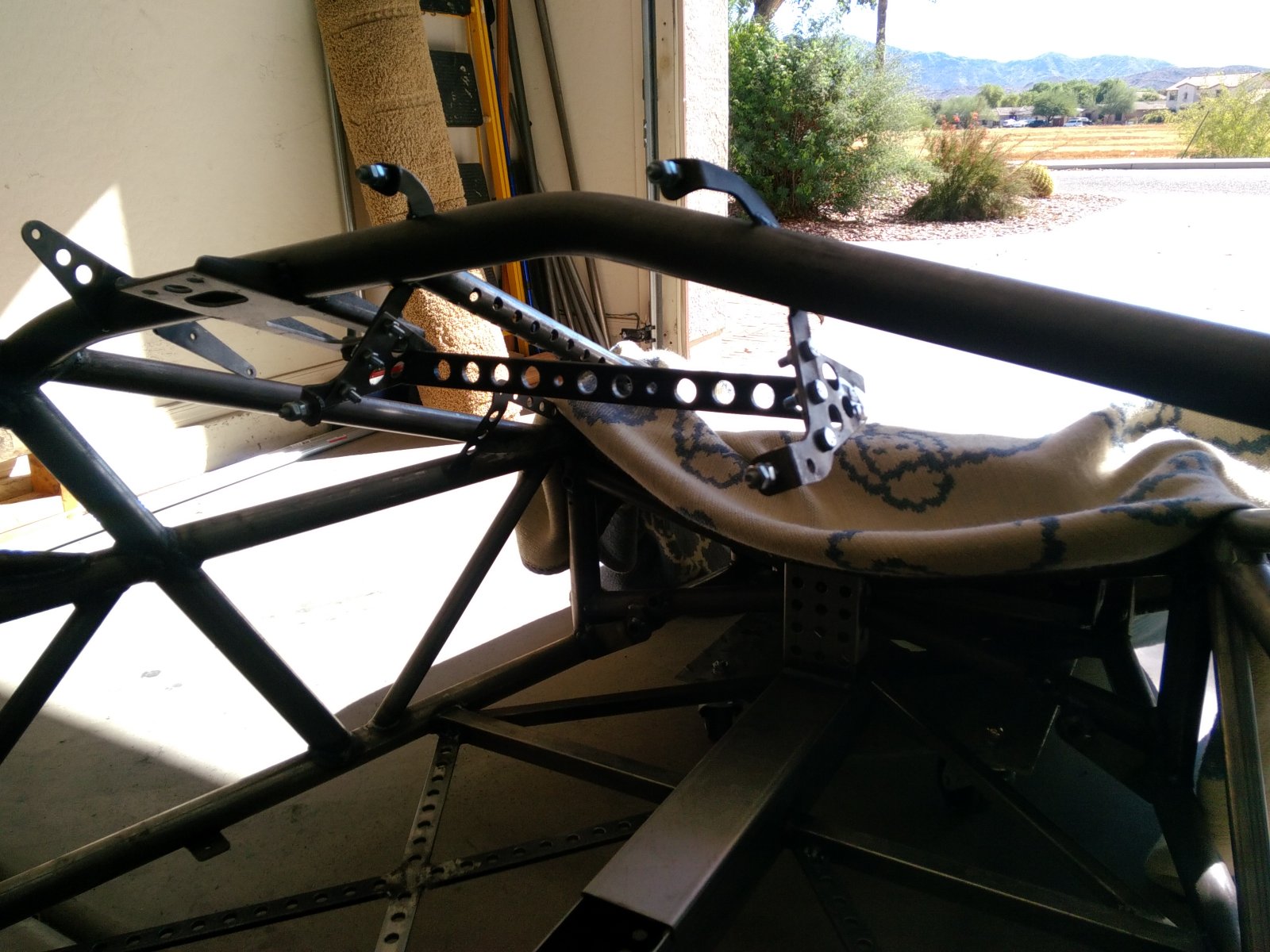

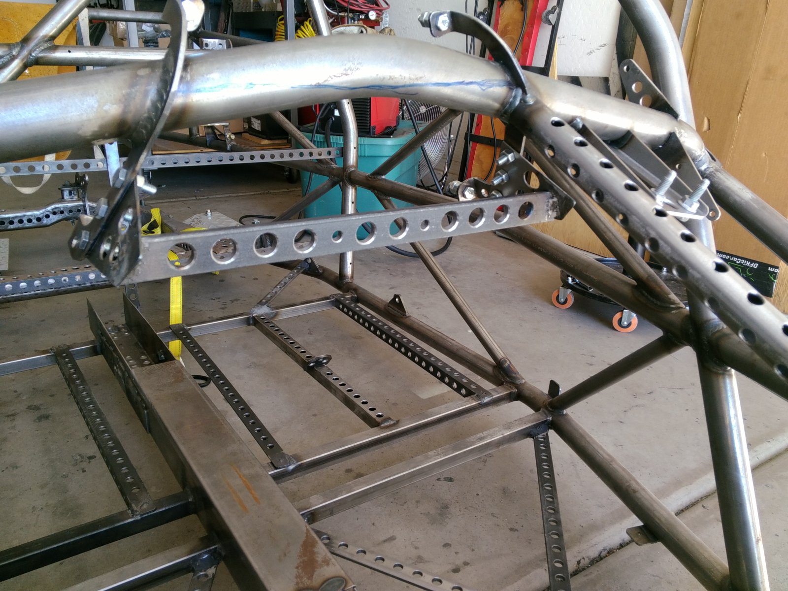

Another weekend of mods, fabbed up a bracket to mount a Tilton triple remote reservoir - thanks Optimizeprime for the info on this upgrade to the stock reservoir. I built the mount to bolt up to the back of the gauge panel brackets. It will be centered up out of the way and have plenty of fluid head to keep the brake and clutch cylinders filled with fluid - even going uphill (which we have a lot of out here in AZ) at launch velocities. :p

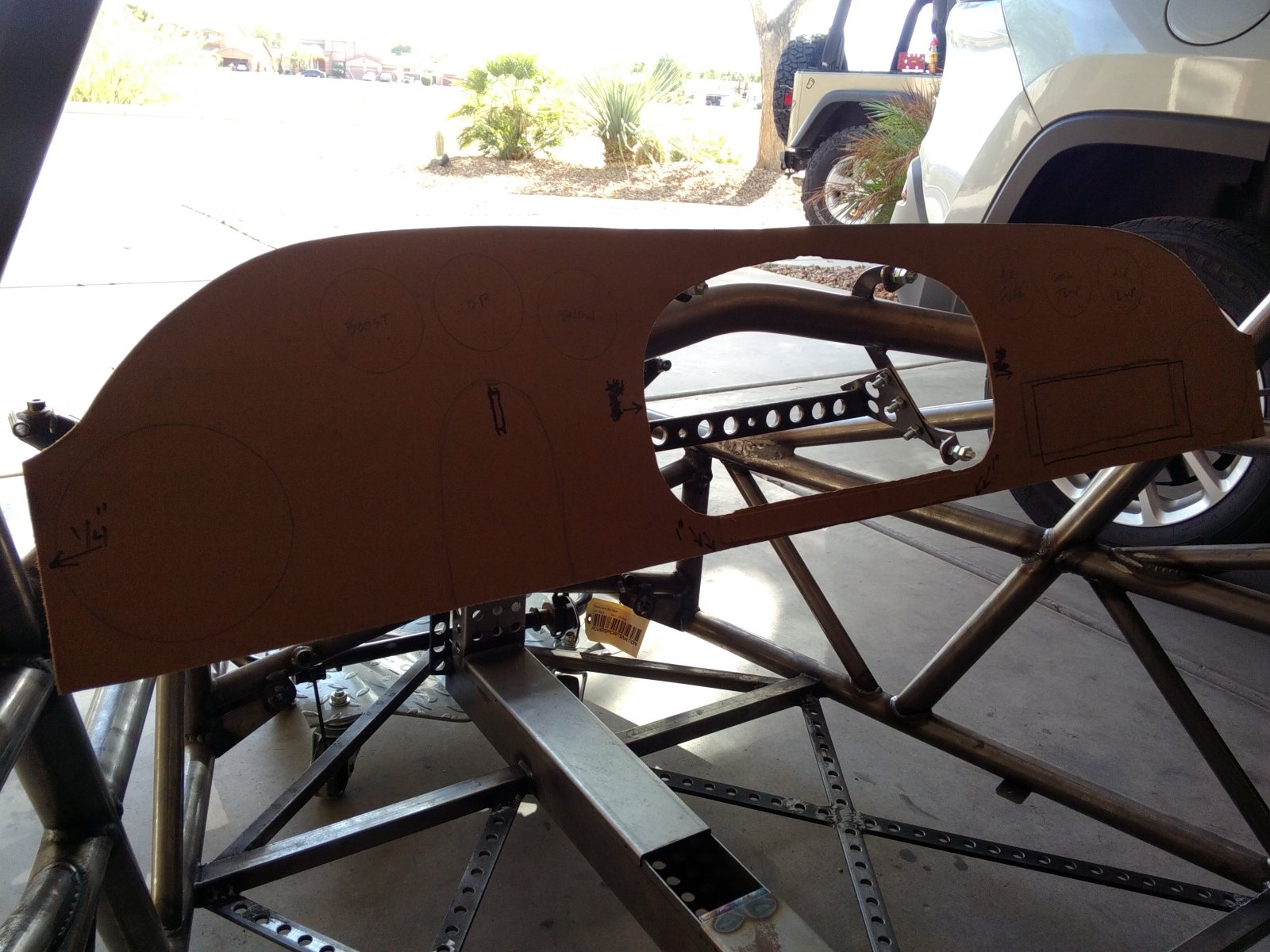

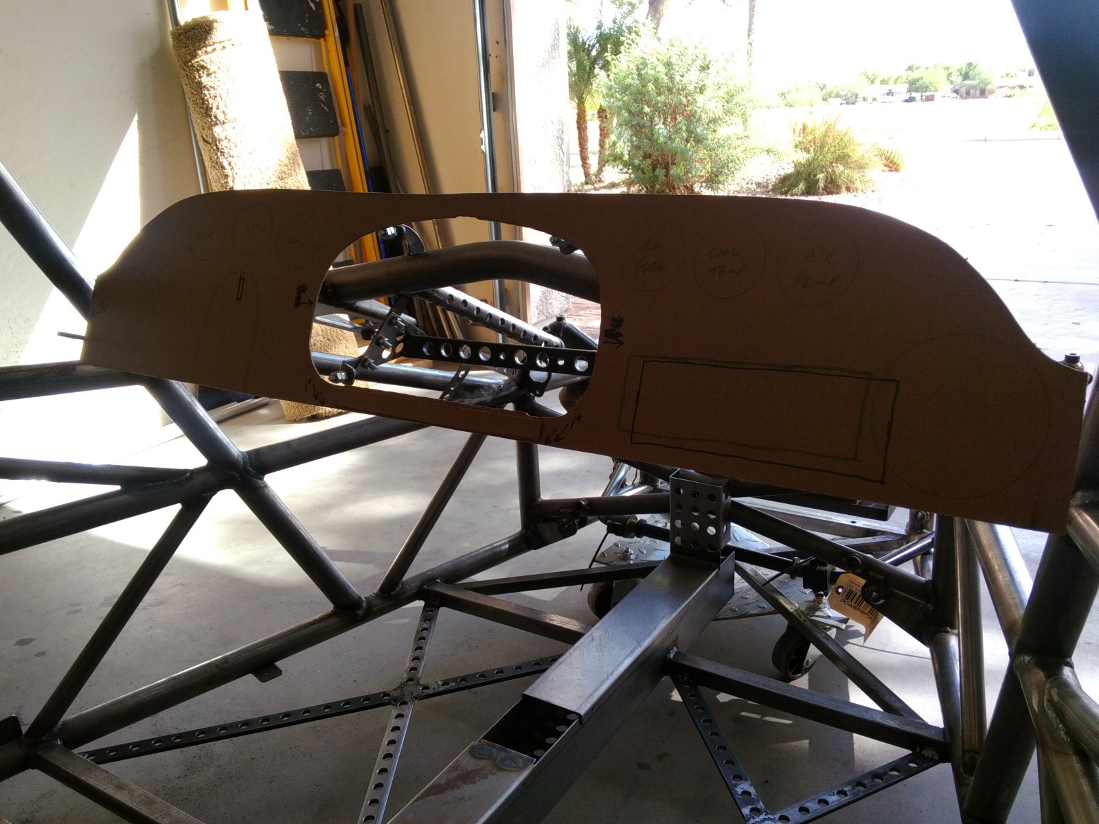

Next up is a dash panel - Brian74 inspired, but more analog (old school) look with individual gauges, not so USS Enterprise. ;) I plan to add some tunes to my Goblin and I have been reviewing what others have done with their head unit and speakers. I will have to think about this to minimize space and maximize sound output into the cockpit, since a dash panel in a Goblin is not very big.

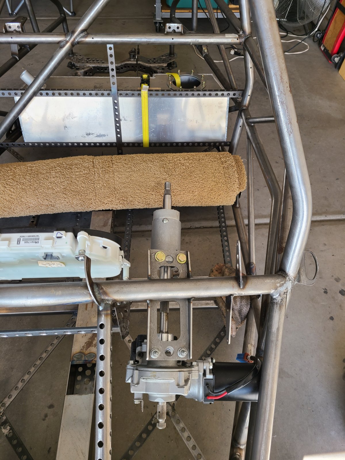

For those who may need the information:

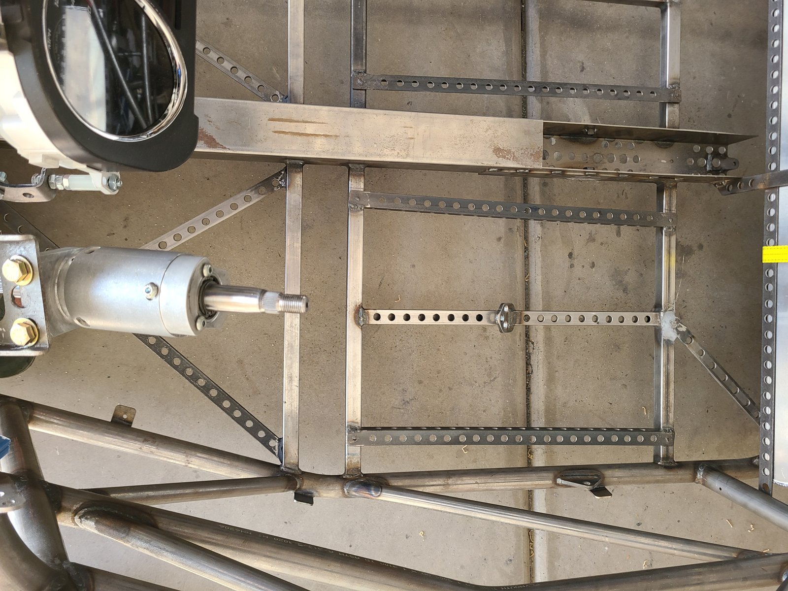

I purposely angled my seats in toward the center of the car by 3-4 degrees and angled my steering wheel about 3-4 degrees toward the outside. After test fitting my seats, before welding in my seat rails, I found this slight angle was much more comfortable for my legs when resting on the pedals and holding the steering wheel, than being straight forward and having to sit angled in the seat. Angling the steering a like amount puts the steering wheel centered on the seat and equals out the reach for both arms.
My seat rails were a no-brainer to drill them offset by 1/2 inch - outside rail versus inside rail - to accommodate the seat angle. For the steering box mount, I slotted the forward and rear bracket holes about 3/16 inch to allow for the assembly to be slanted. The photos show how these are angled.
