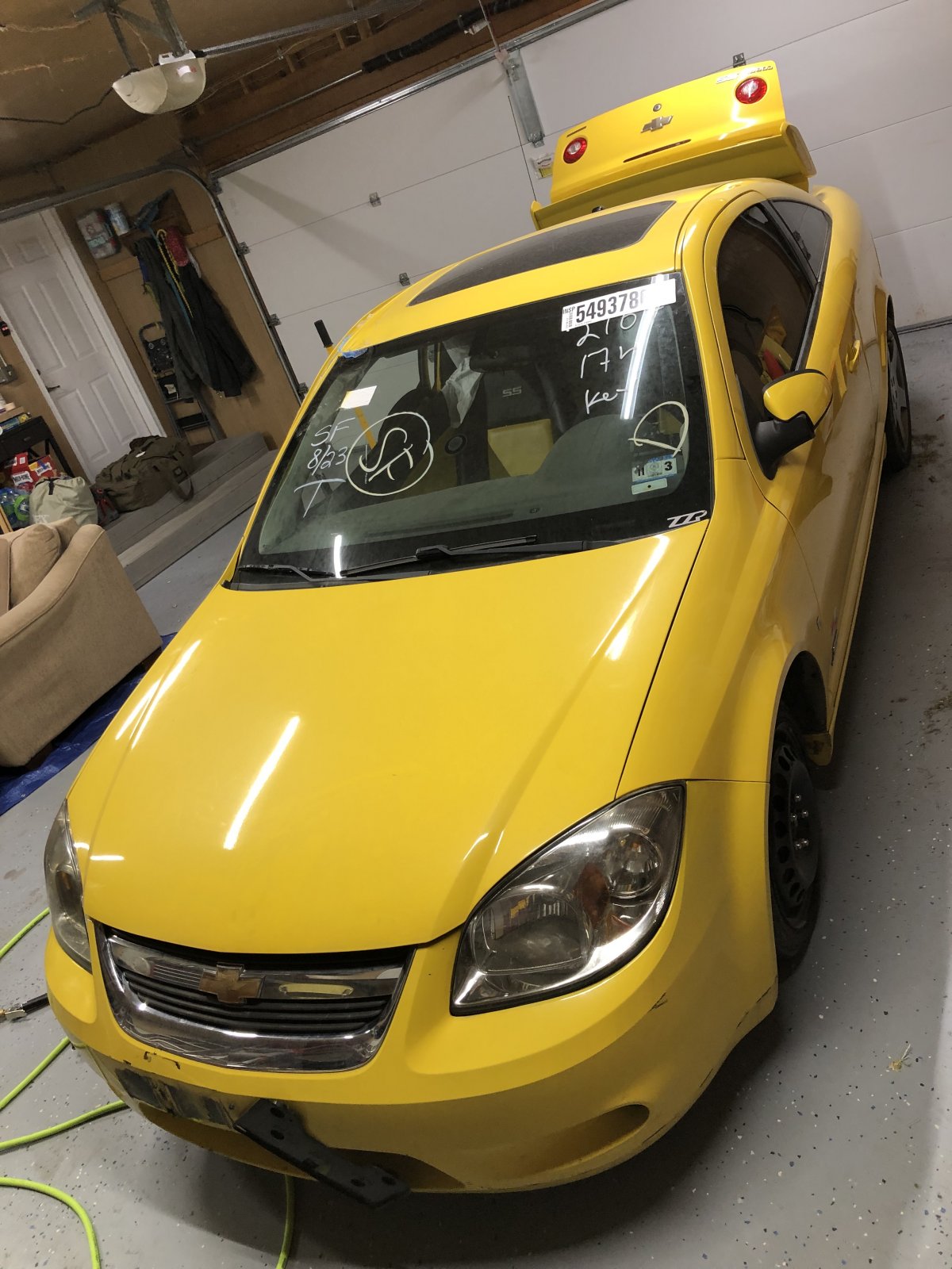

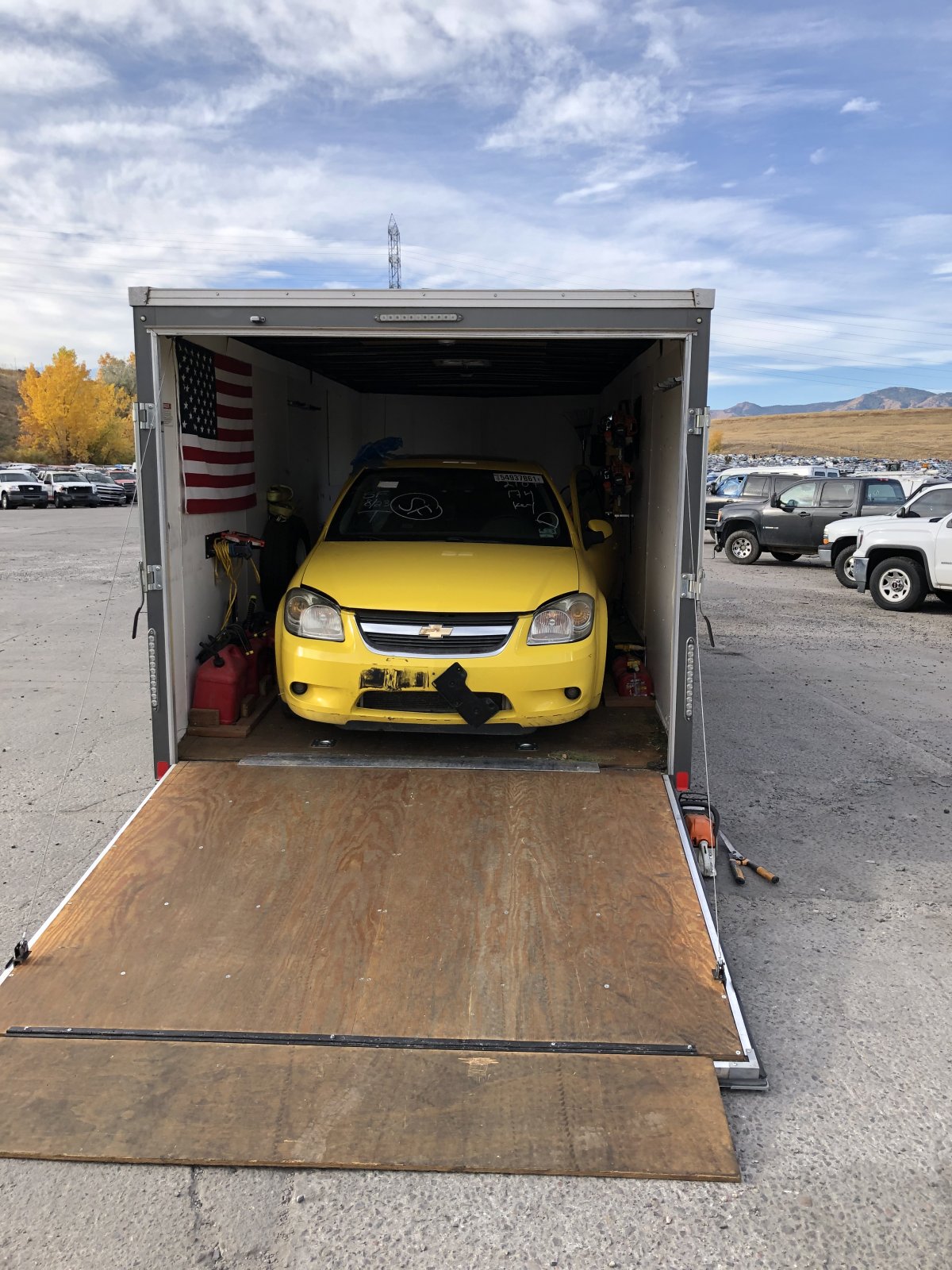

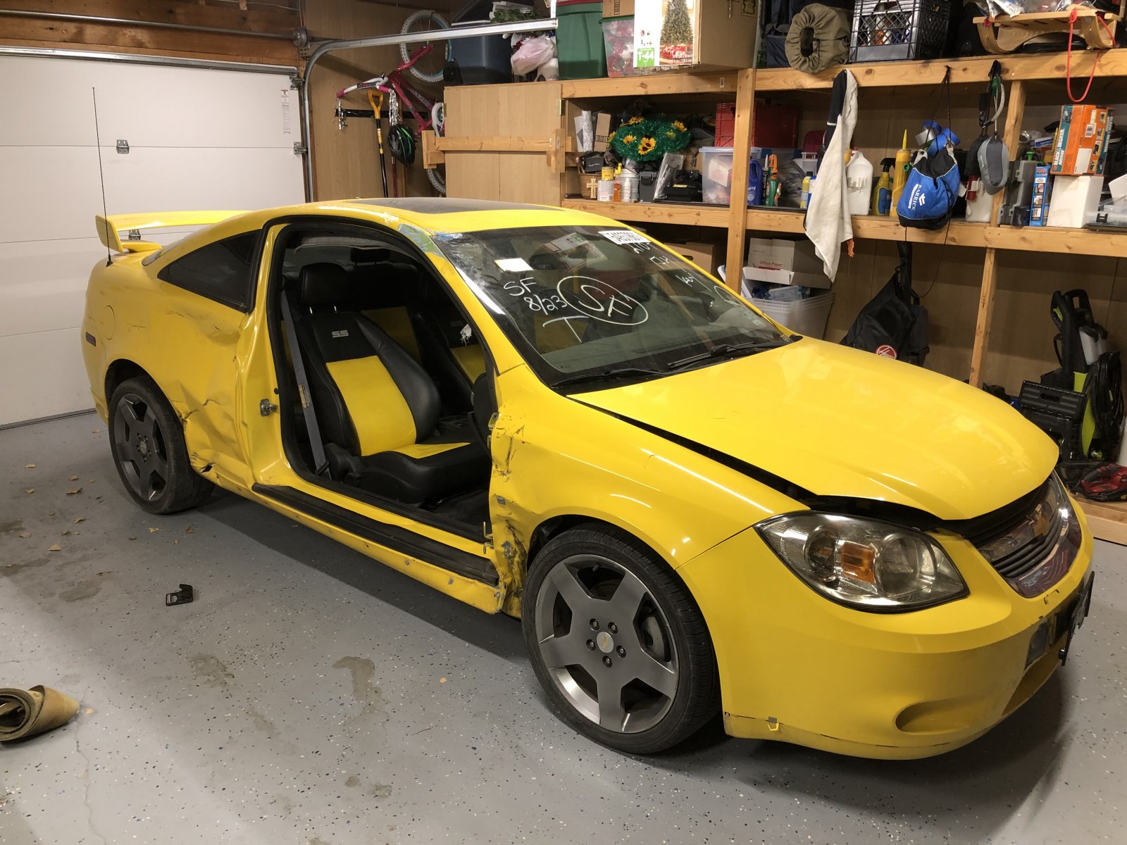

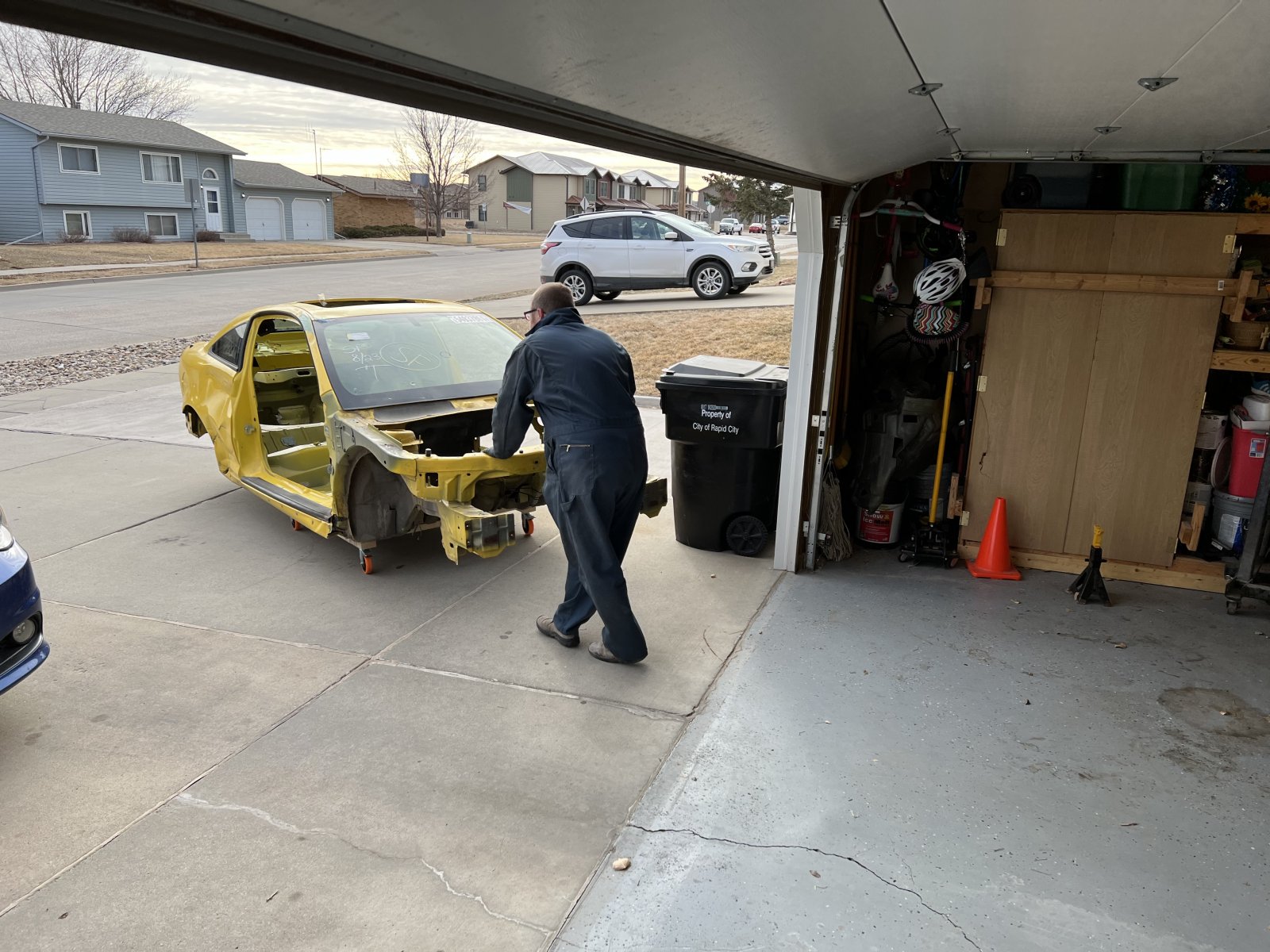

Being in western South Dakota, the pool of available Cobalts is smaller than a lot of areas. I scoured the web and local classifieds for months but came up empty. Even increasing the search area to around a 400+ mile radius, pickings were slim. I ended up going the Copart route and picked up a 2006 SS/SC with just over 60k miles on the odometer from the South Denver yard. It was hit somewhat squarely on the passenger side of the vehicle, and the listing noted that it did run and drive. After fees, taxes, and diesel, it was more than I wanted to spend but was exactly what I was looking for. Disassembly occurred over the winter, and Cobalt parts now cover every spare inch of space in my garage.

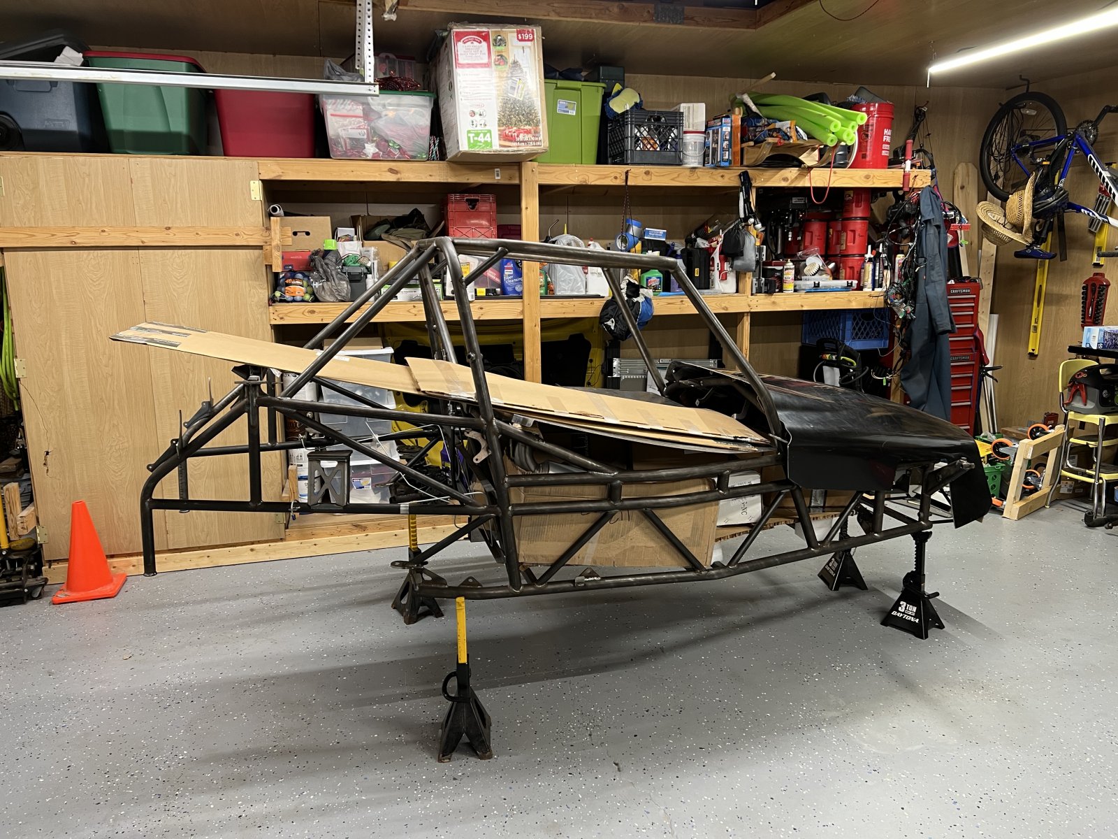

For chassis #381, I went with the extended track frame and double door bar option. It will be primary street driven and used as a canyon carver through the Black Hills. I don’t know if the Goblin will see any track time, but you never know what the future holds. The frame will go to a local powder coating company later this month – Chameleon Teal is the tentative color.

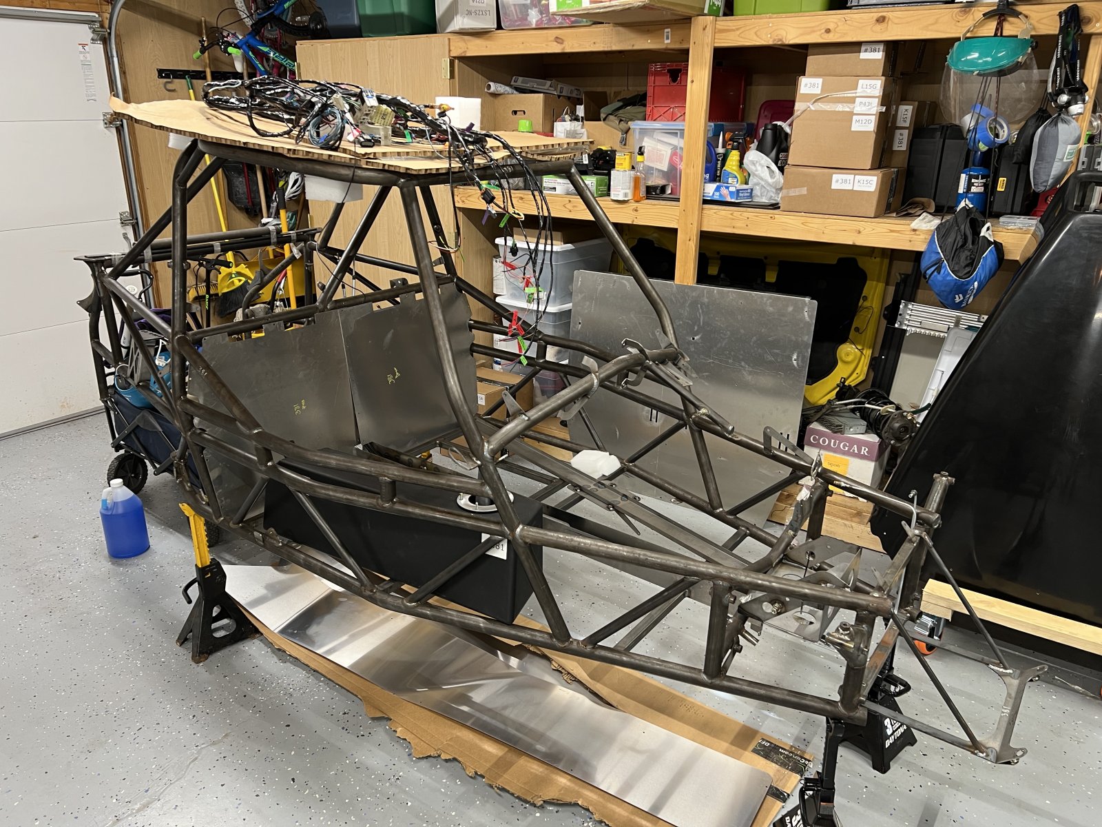

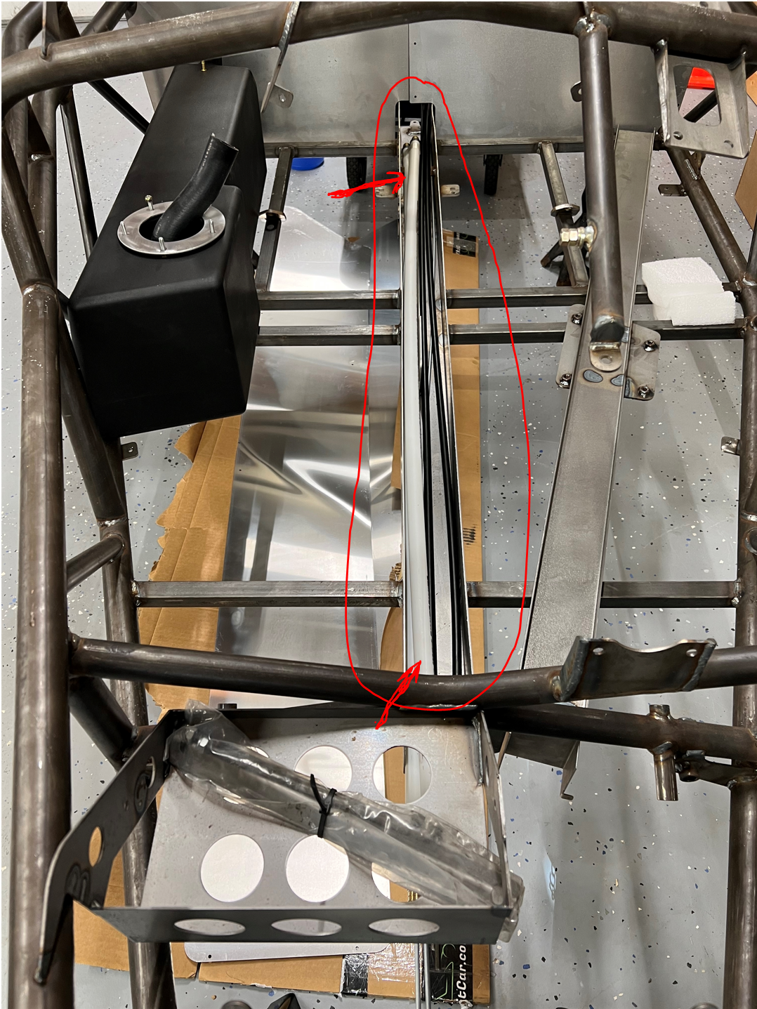

Rivnut tool is in the mail, and I plan to dry fit the side panels before the frame goes out for powder coating. As I unpacked everything, I came across the white PVC pipes with barbed fittings in the tunnel - see picture. Can anyone comment on their purpose? Also, with the tunnel, the lid is a tight friction fit. Do you need to adjust fitment prior to paint/powder?

For me, the difference between needing a hammer or not was just squeezing the sides of the tunnel cap with my hand.

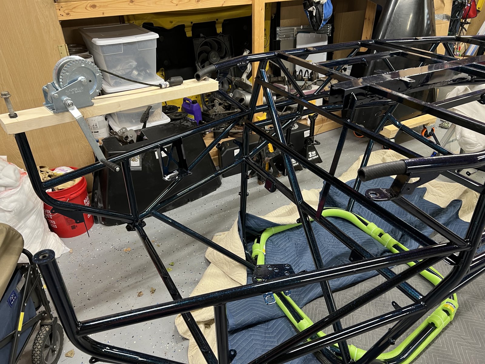

Chassis and parts are off to power coating next week. Where does this one go?
D

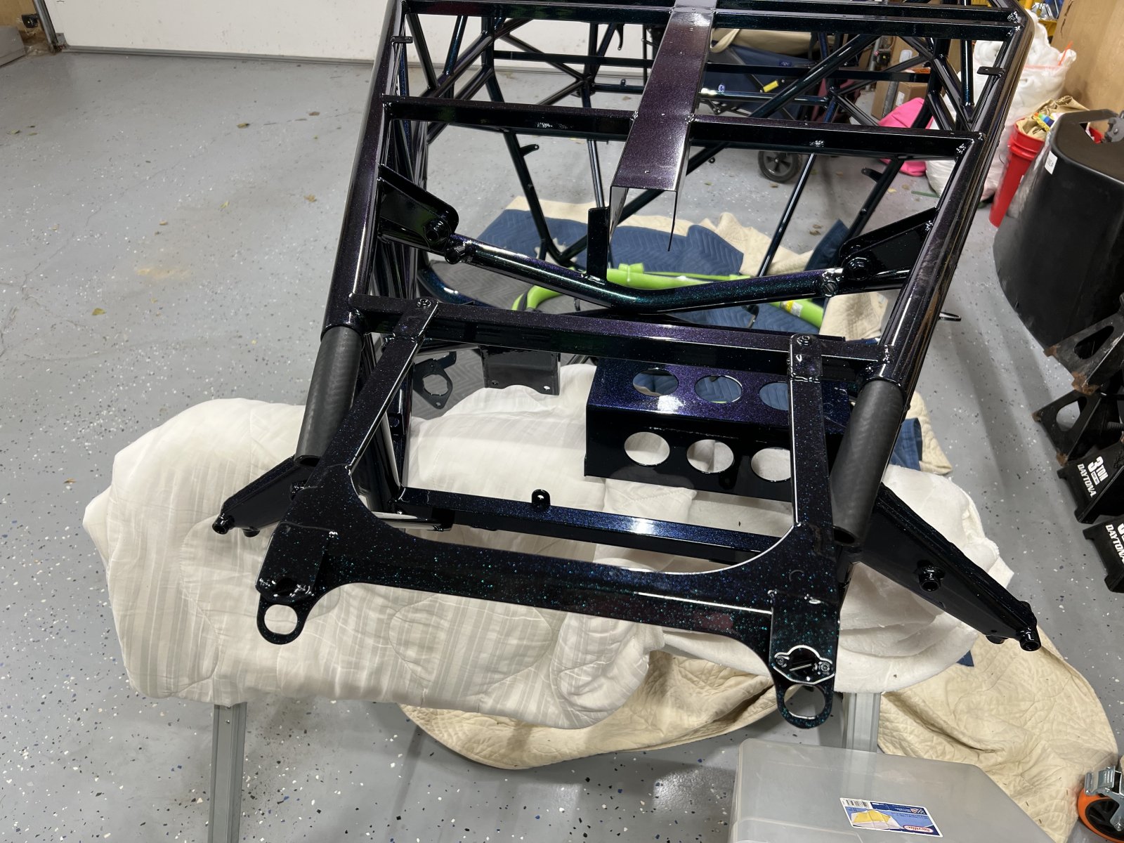

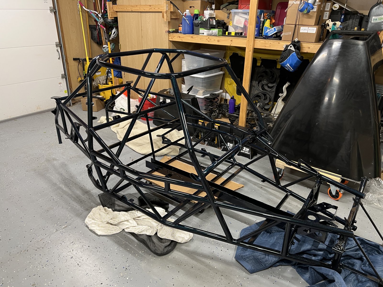

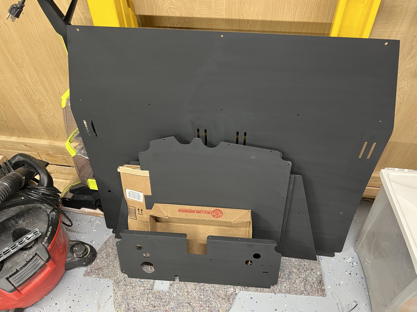

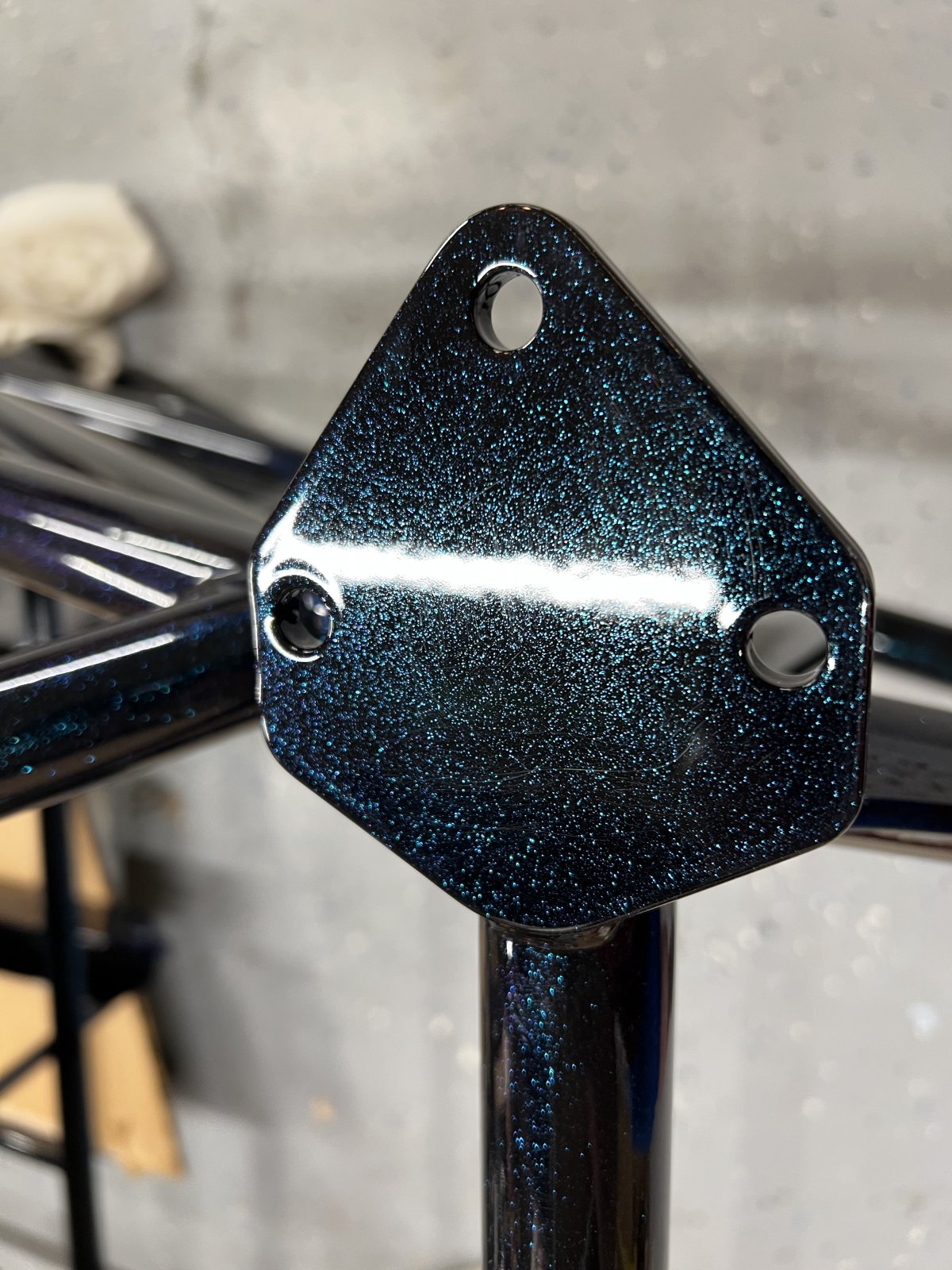

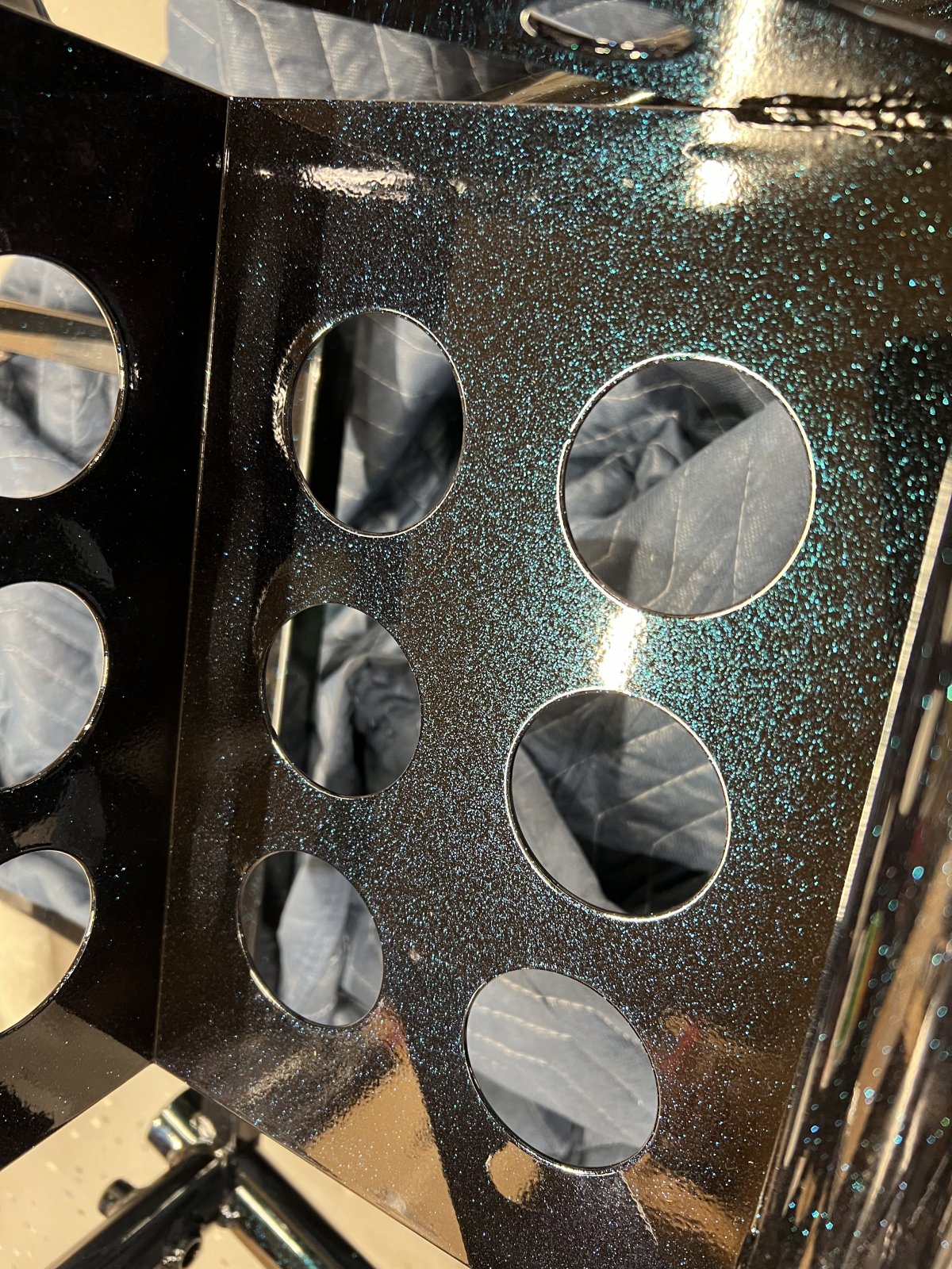

Picked up the frame and corresponding parts from the powder coating shop yesterday. Pictures don't do it justice - the chameleon teal color is gorgeous!
I'm planning on going with Raptor undercoating for the floor pan, bulkhead, & firewall. Hopefully it provides a little noise dampening as it claims. The summer is already way too busy, but maybe I can get the radiator hose tool built this week and operational for the weekend.

Sparvy
Awesome color...looks like black from a distance and then pops when you get close.

Hoses pulled through the frame and floor pans dry fit. Huge kudos to DF for the updated pulling method. I read all the horror stories in previous build logs. With less than a can of silicone spray consumed, both sides pulled very easily.
For the pans, I cannot recommend the Raptor underbody coating. Even with 3 coats, it still has a streaky appearance to me. If I had to do it again, I'd either leave the raw aluminum or have them powder coated - clear or color match.
