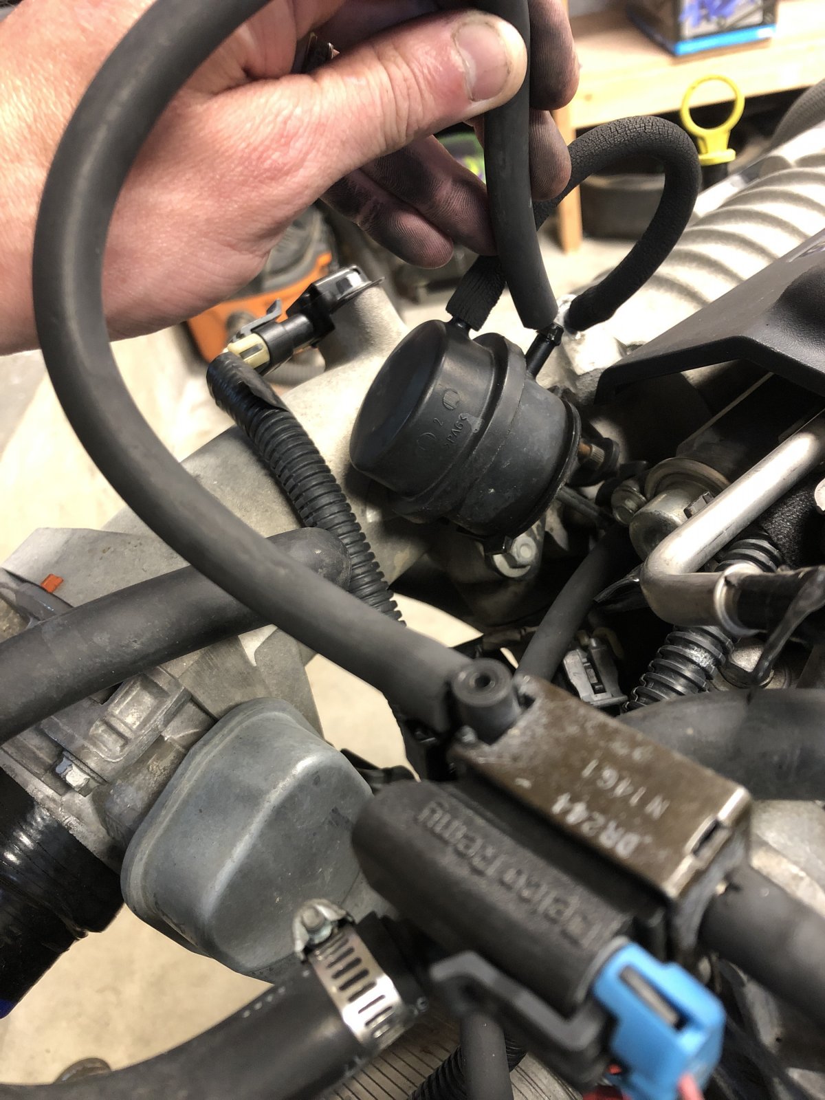

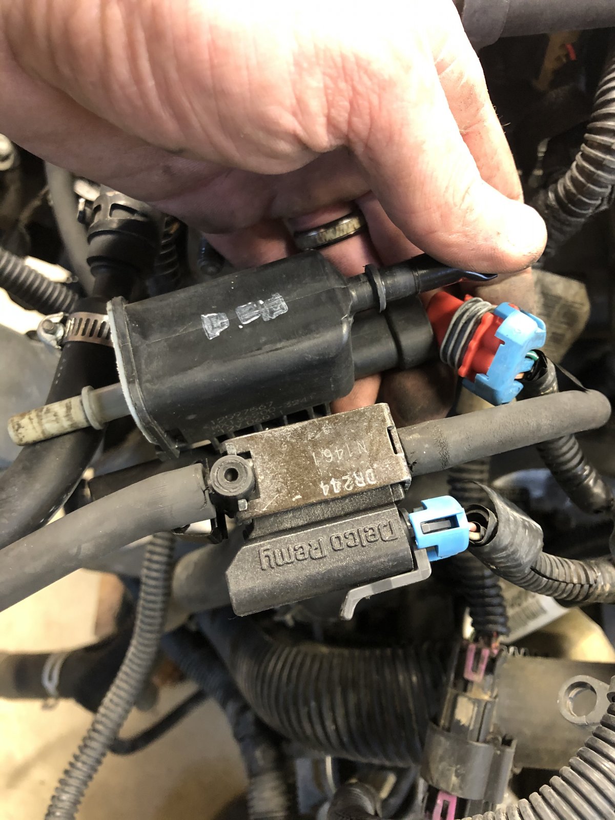

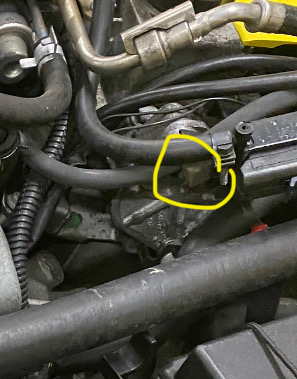

I’m not sure what this little sensor is next to the evap. Do I need it?
The one you are holding is to the evap. The one next to it is boost control solenoid. It’s needed and goes to the the boost actuator on the supercharger.

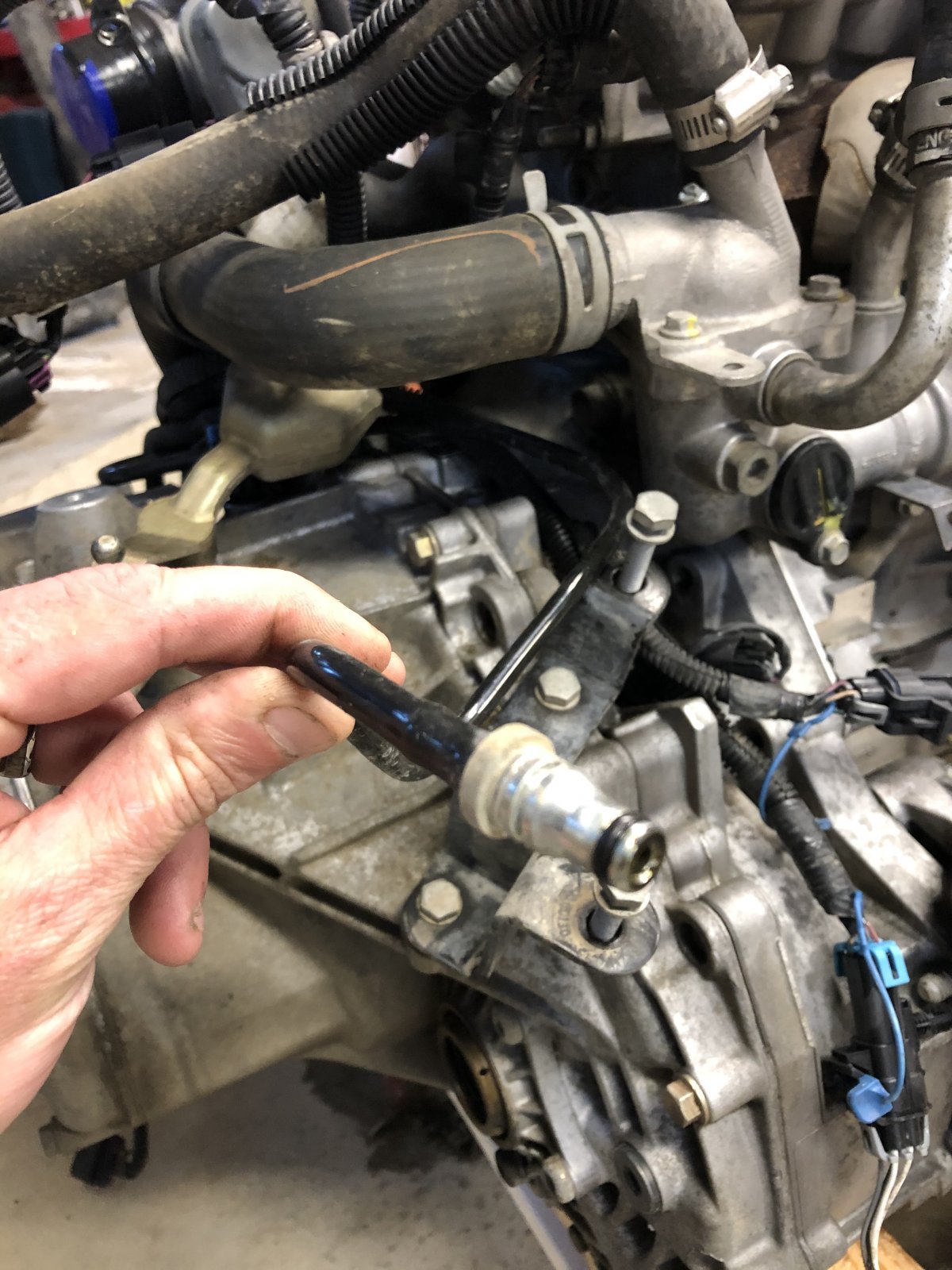

This hard plastic line goes around and into the top of the transmission. I can’t remember what it came off of.

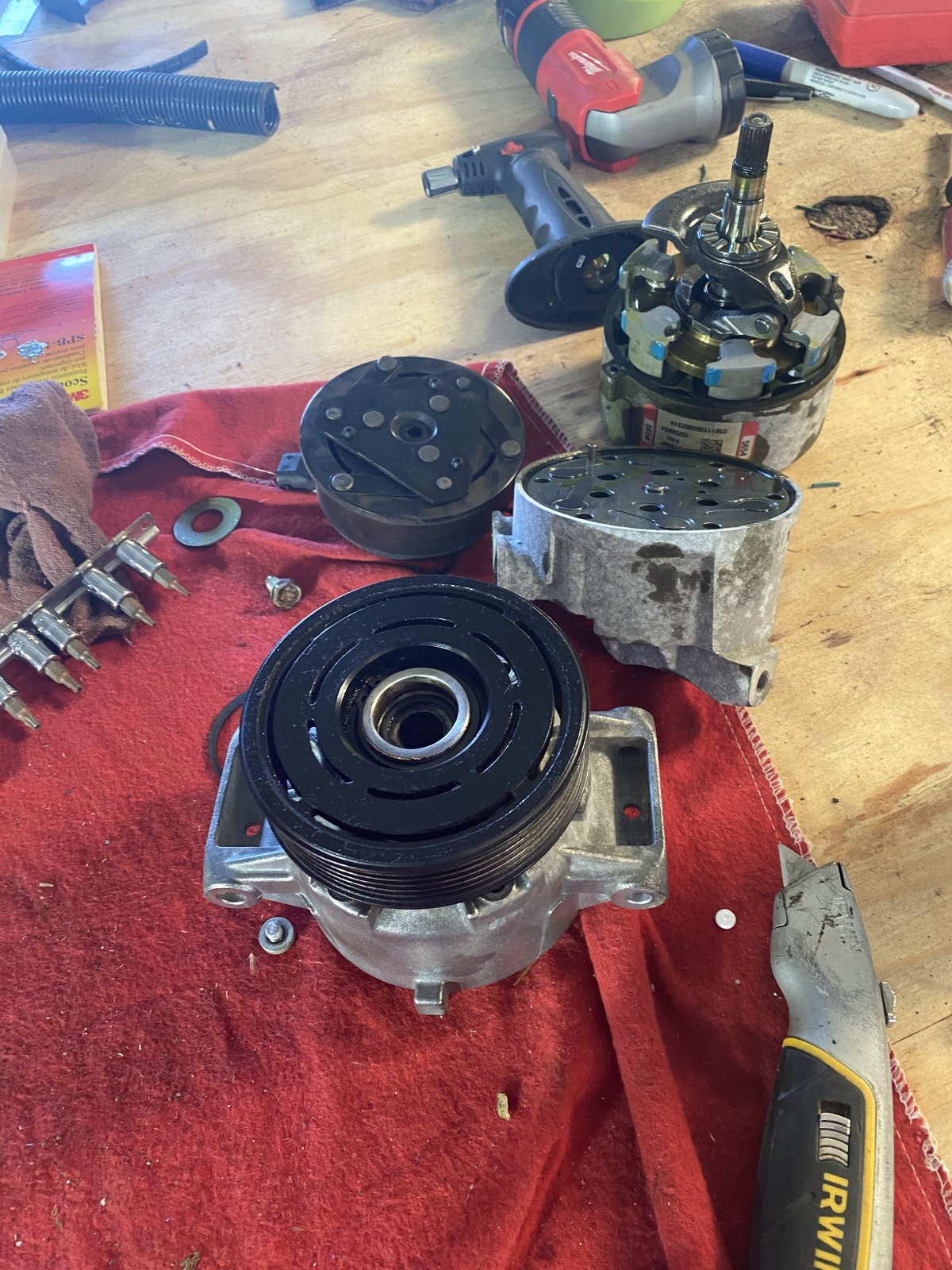

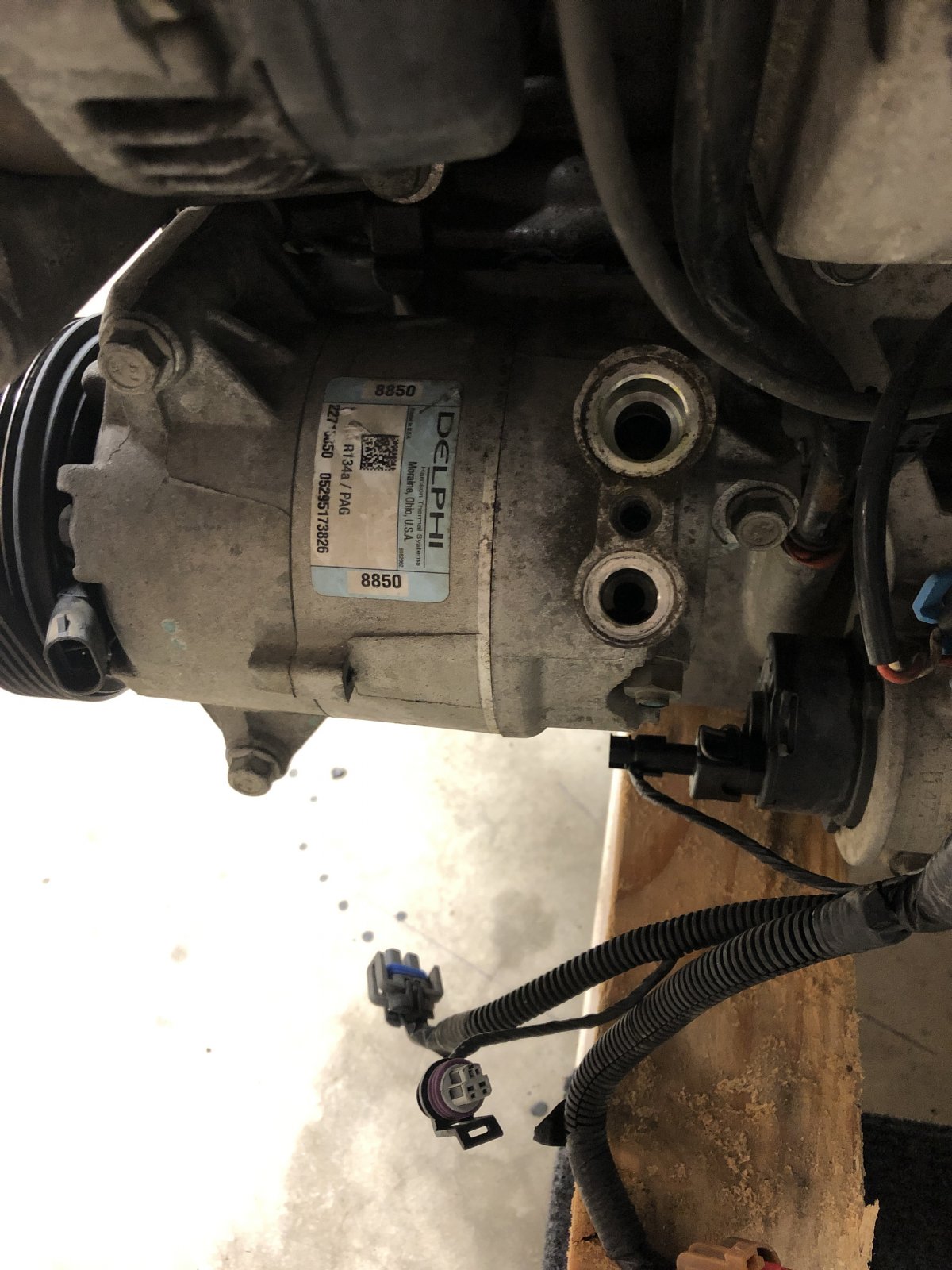

I’m under the impression I have to leave the a/c pump. Do I need to plug these holes? Do I leave the wires plugged into it?
You have to have it so the belt works properly, but you can gut the compressor to save weight. You can eliminate the plug and wiring.
