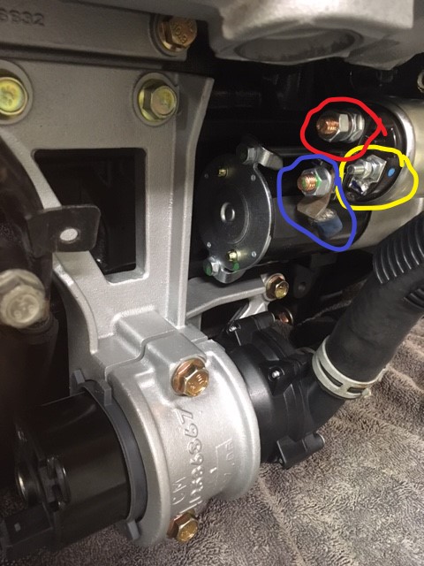

You could also just measure to make sure you are getting 12vdc on the small (Yellow) terminal when you are trying to crank it. Also make sure you have 12vdc on the large terminal (Red) all the time. When you apply 12dvc to the small terminal (Yellow), you should then have 12vdc on the other larger terminal (Blue, this is the actual starter motor).
