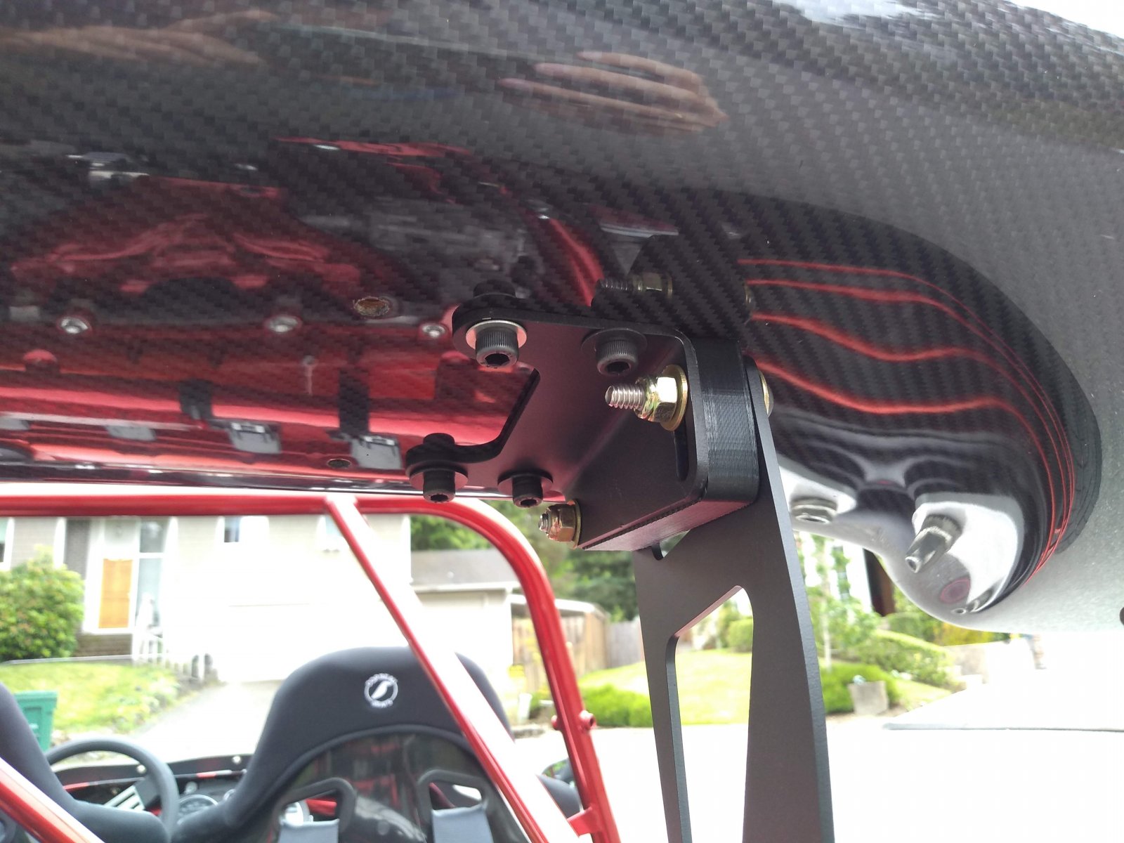

Would you have any pictures of the underside mounting of the Wang you got?
And was it this one?

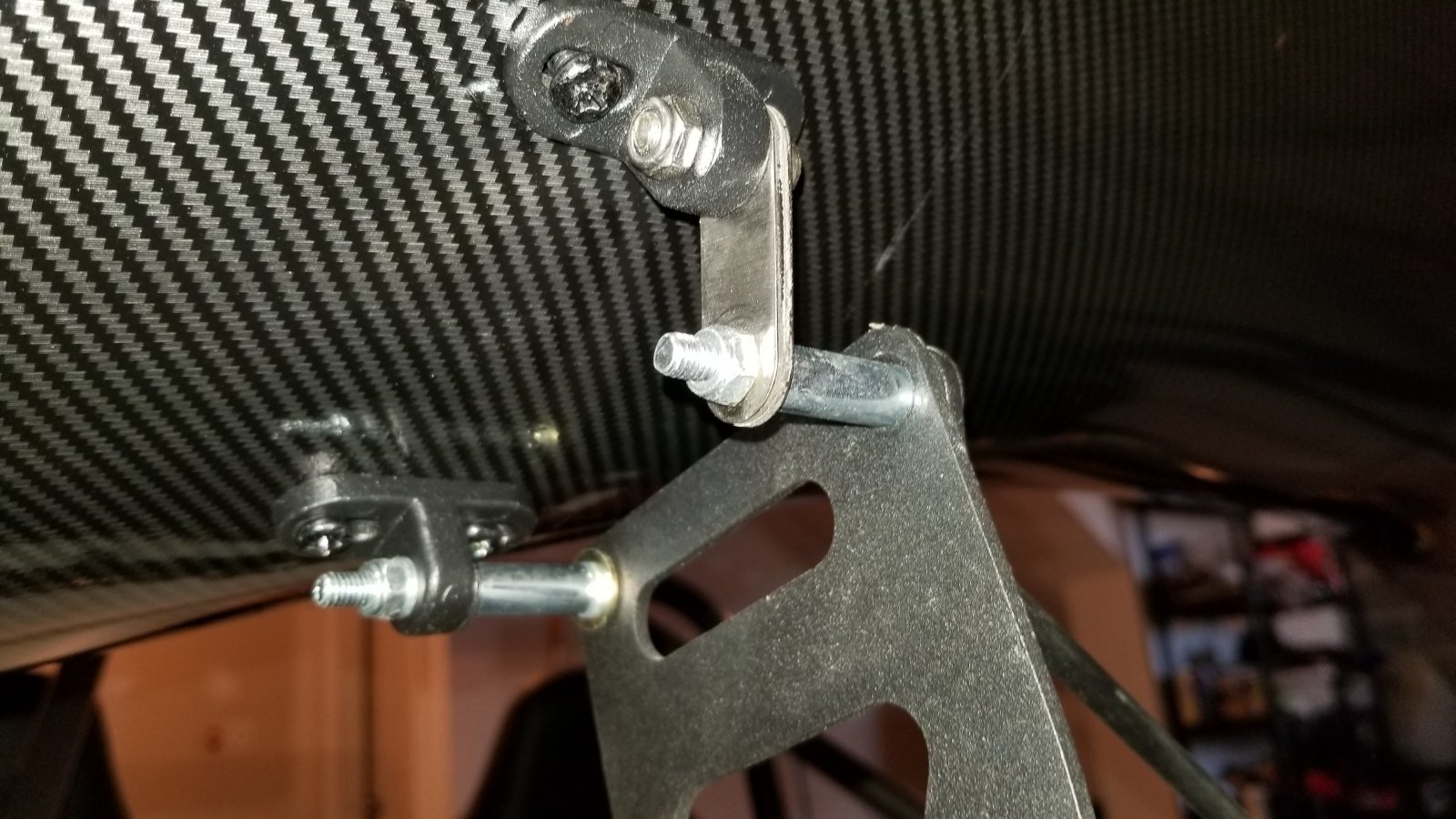

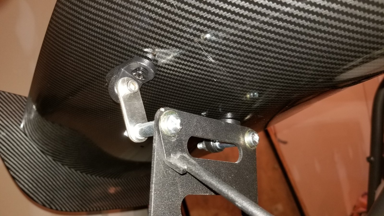

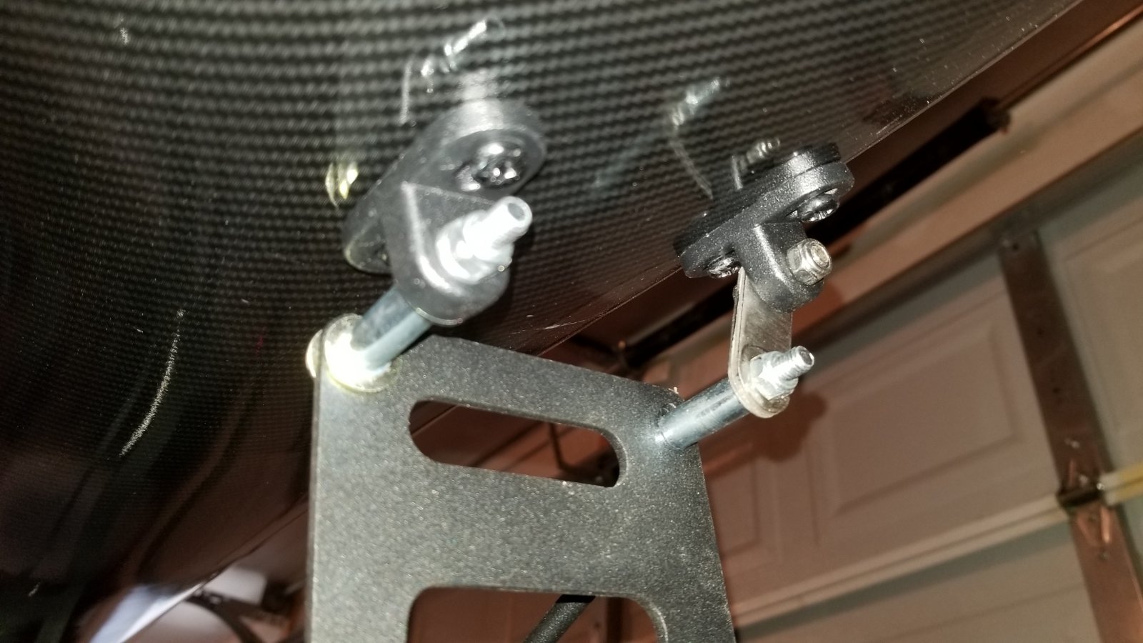

The mounting points are shown as 28" apart, which is close, but a little wider than the DF mounting points. So, I went to the hardware store and bought some hardware to get it mounted up. It's REALLY solid. Here's some pics (all three are from the driver's side, at different angles):
Not really. Since there is a curve that changes it's rate of curve, if you did move it forward, there would be a gap in the middle. Besides you would have extra holes, but I'm sure you knew that already.
An adapter might work to achieve what you are shooting for.
