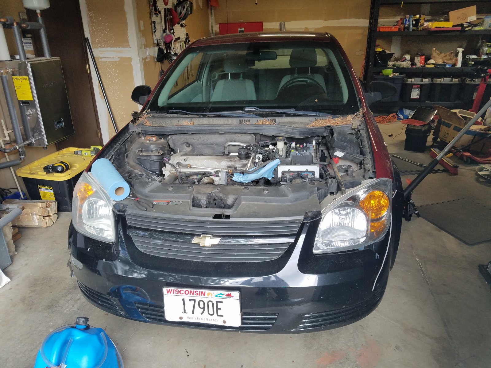

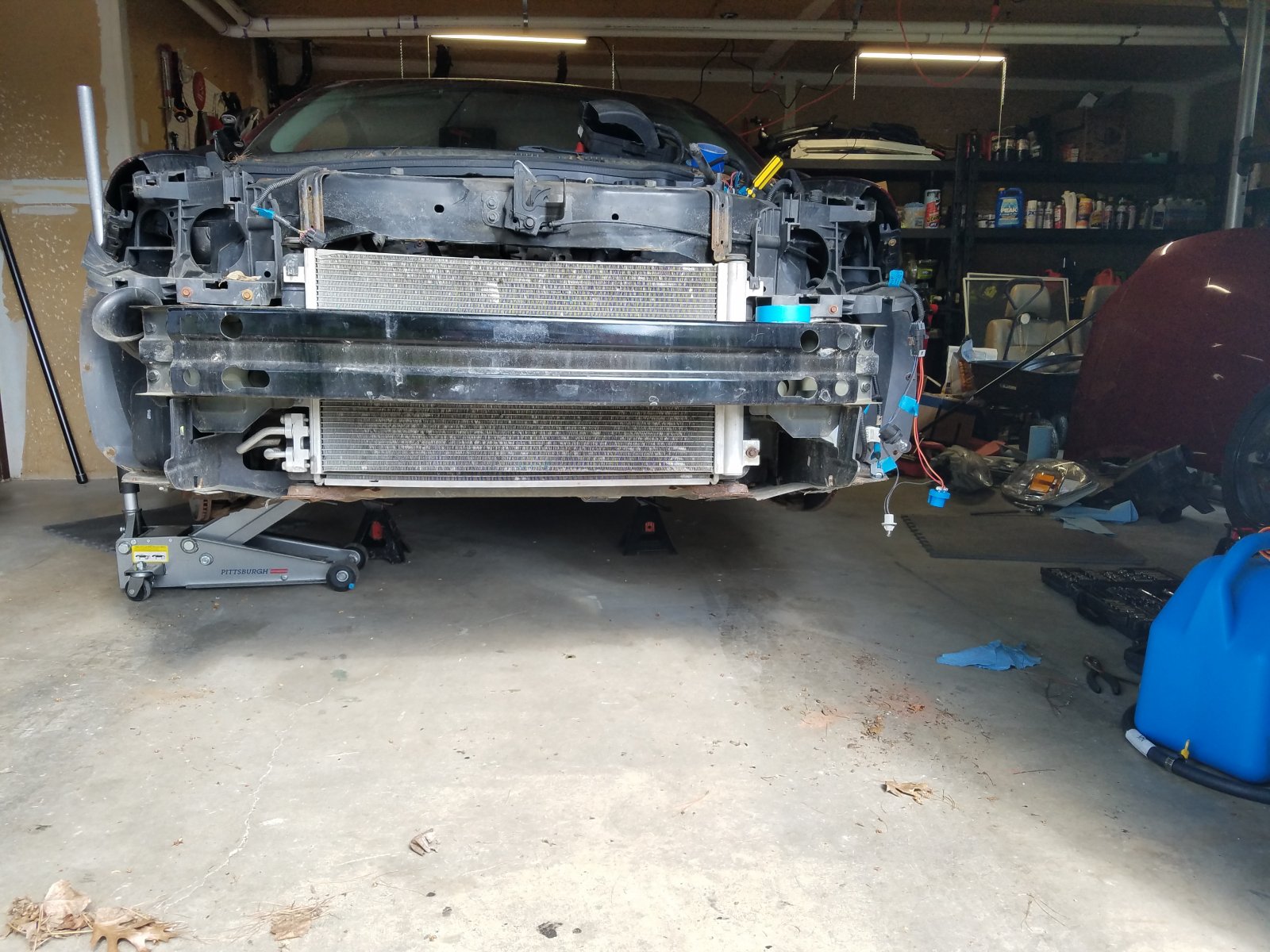

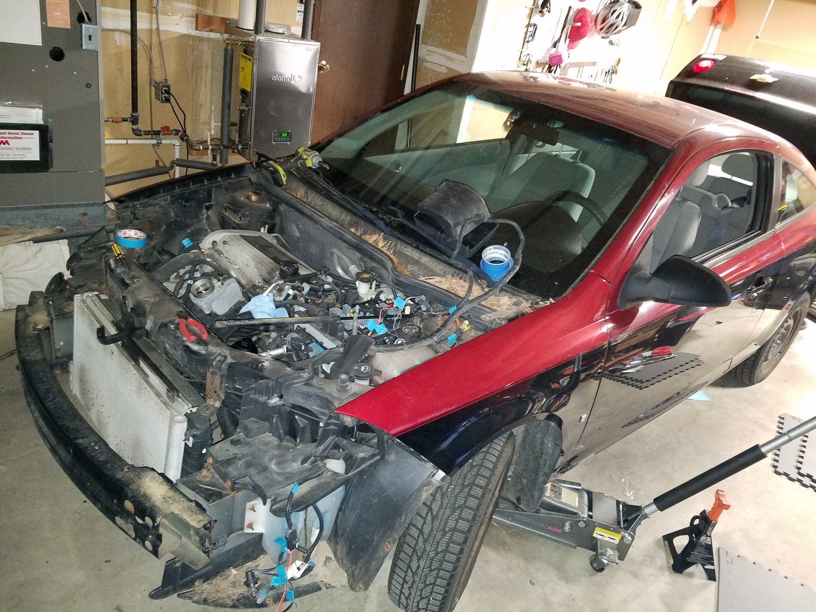

So i finally got a chance to start taking apart the donor. Just got part 1 and started post 2. I'm going to skip taking off the body panels and doors unless needed. So far things are going well... there is a lot of surface rust, but sand blasting should do the trick

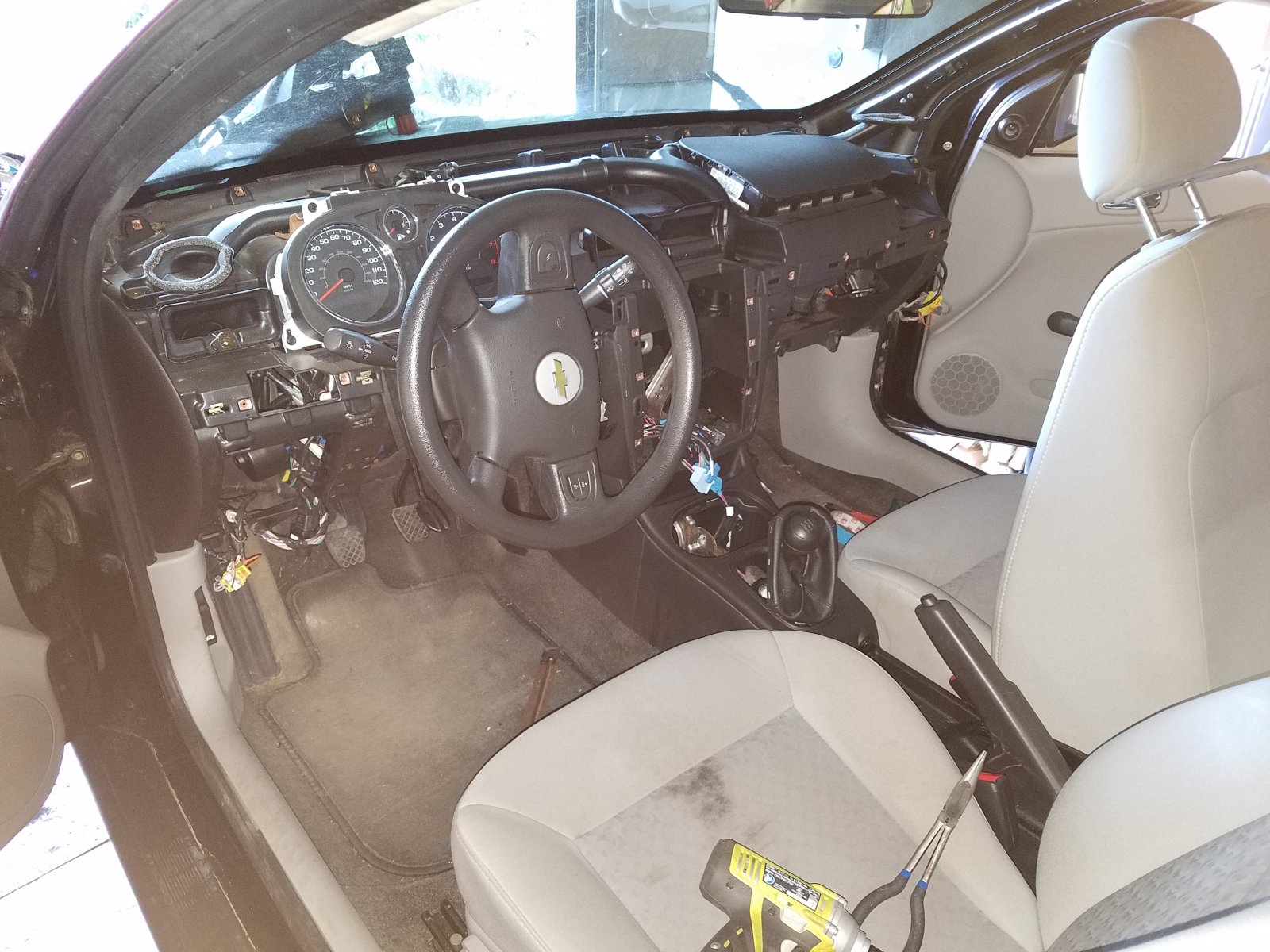

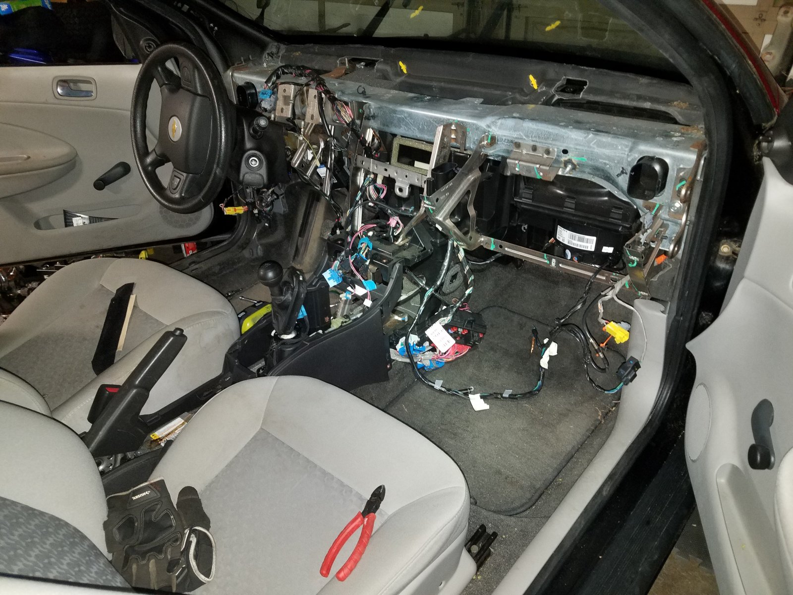

Put In a little more work today. Drained the oil and started to take the wiring off in the engine bay. I also stated to do the wiring for the interior... I need to get a spring compressor to take the struts off the car and borrow a friends cherry picker to do the engine, that's why i started the wiring harness.

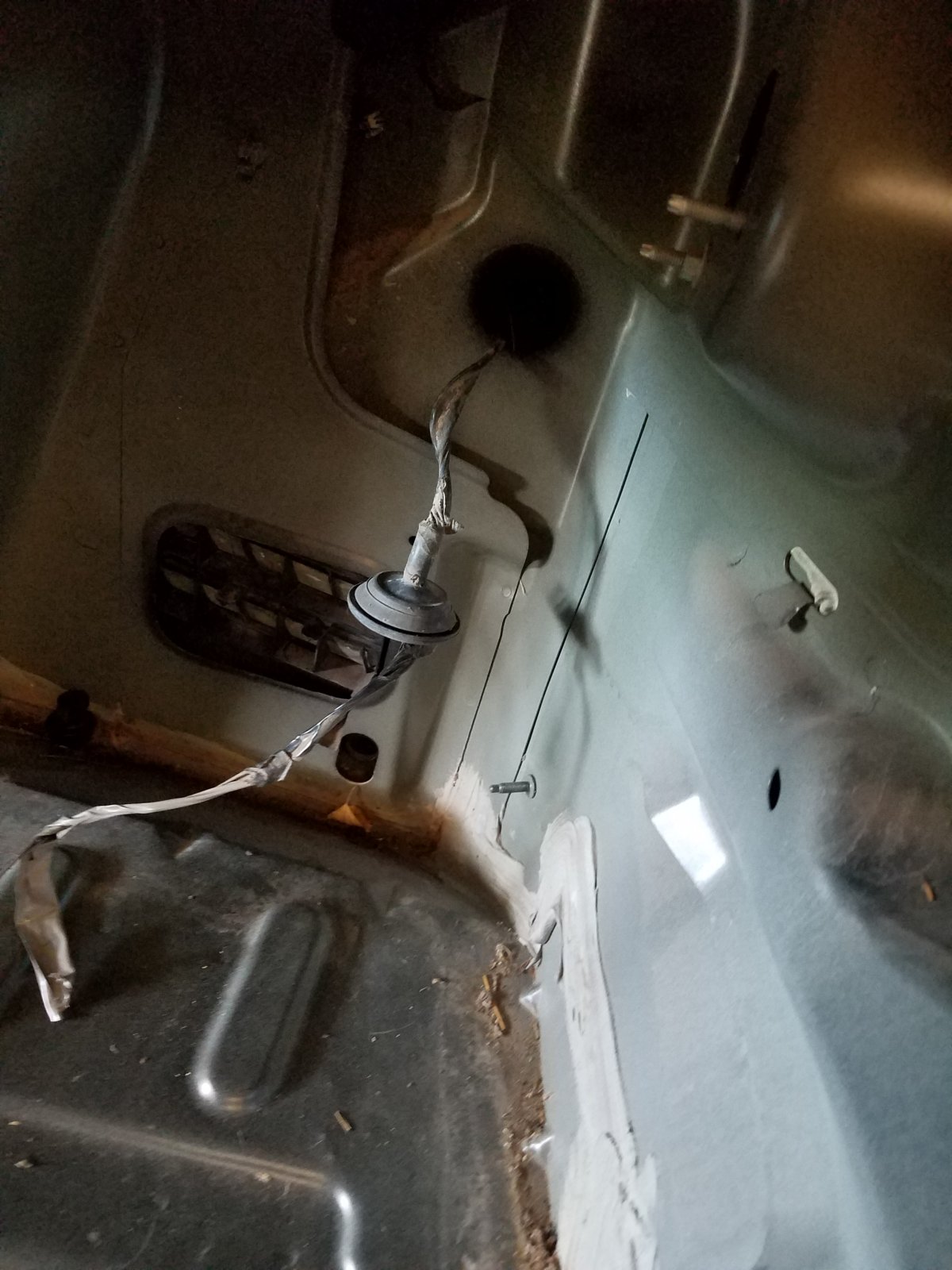

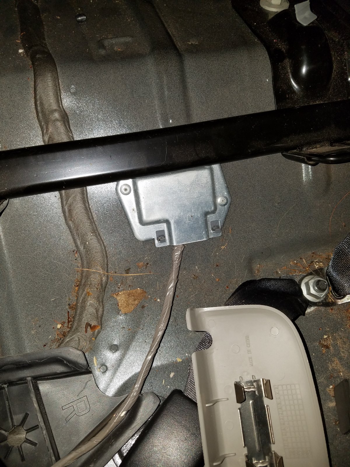

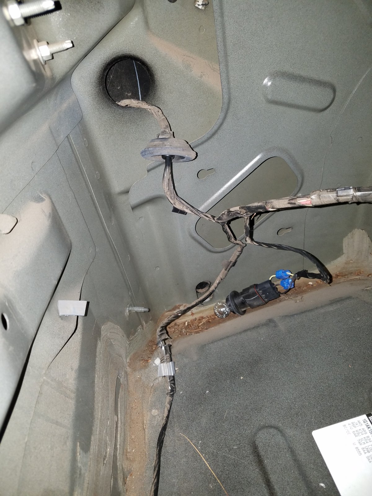

What do these wires connect to? They are under the rear seat. (First picture). I also cut the ones that are in the trunk that lead to the wheel well area (2nd and 3rd photo), what do they connect to?
dperkins
I believe the first picture is of the EVAP system wires. The cut ones might be your tail lights if I am remembering correctly :oops:
Karter2026
You are correct. I think those are the drl... ****
The first is Fuel pump and EVAP system wires.
There are no DRL wires in the trunk area. They just feed headlights.
That is either rear lights or the harness going up to the headliner. I am almost positive it is rear lights and trunk release in that harness
