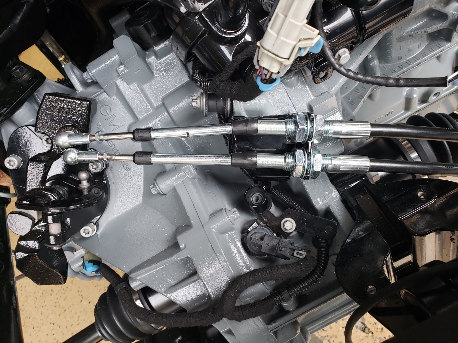

Can someone tell me if the bracket is correct?

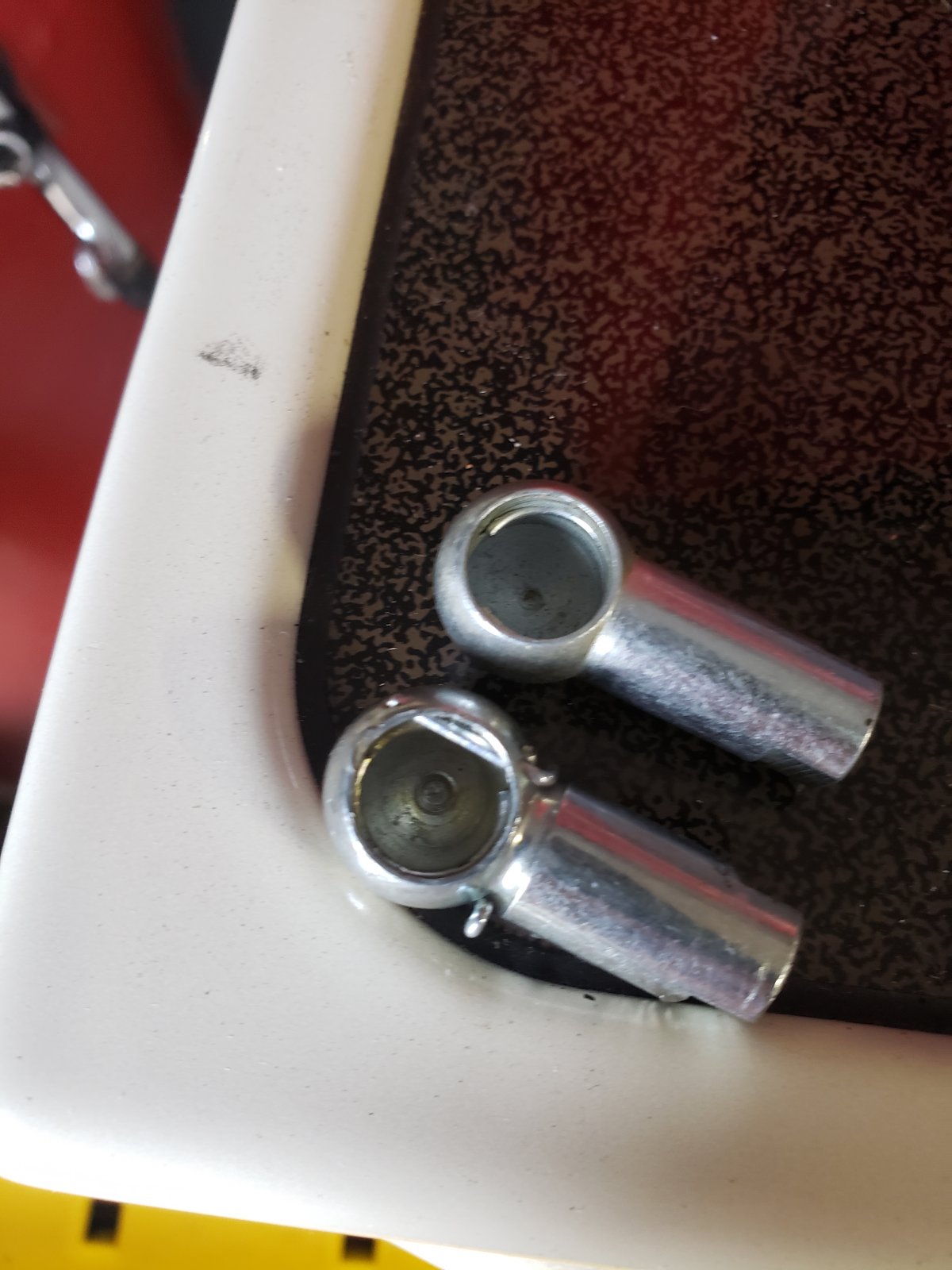

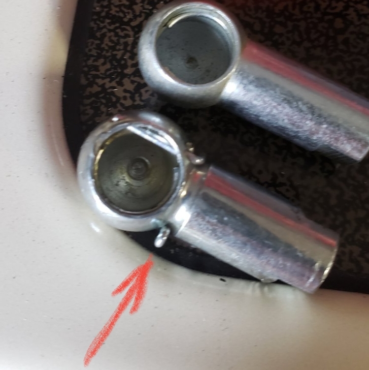

Also I can't get one of the connectors on at the transmission... they are different which leads me to think I have the wrong part? Or are they suppose to be different?
22633
I used pliers to pop those on... so, yes, remove the straight pin, then muscle it. The other one looked like it was a spring clip instead of a straight locking pin. Both should work.. but I only got straight pins in my kit.
