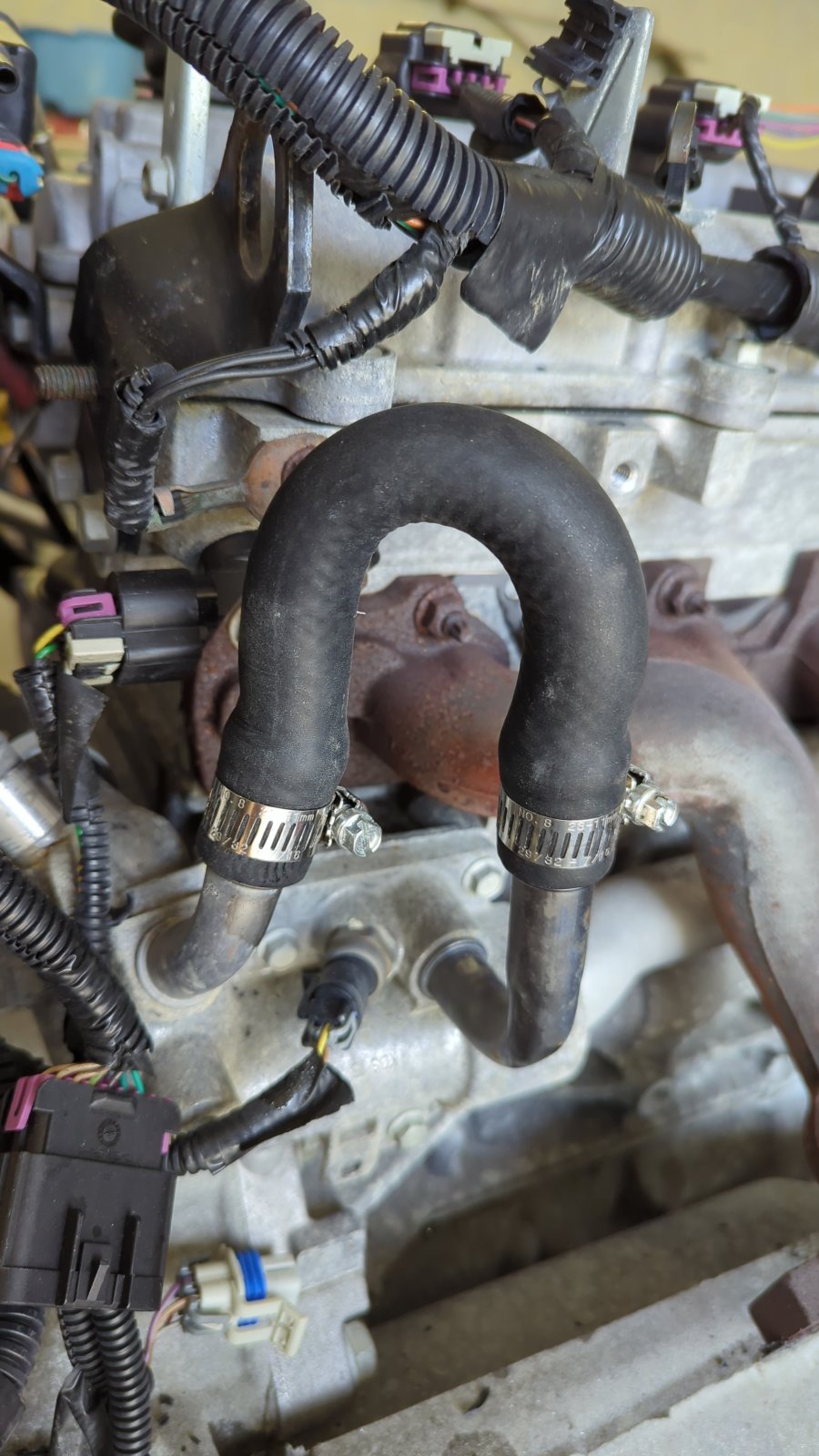

Can we cut that hose shorter if we want? I'd prefer to have my hose not stick up as far. I'm assuming that since its just a bypass it doesn't matter as long as the flow is unrestricted?Yes. That is the heater core loop that is not used in the Goblin.

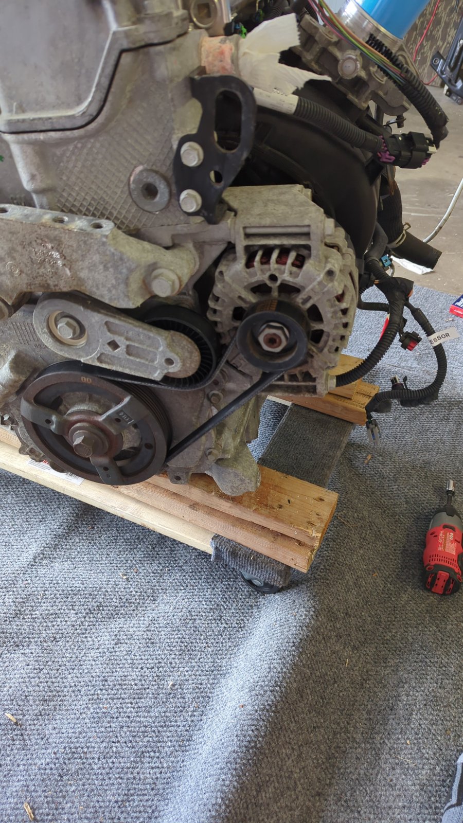

Yeah thats one of the reasons for me to stay NA as well. Less moving parts. I could see always upgrading later, but have to wait and see as we may choose to just start a new build then keep tinkering with this one when we are done.Removed the compressor and got the correct belt replacement, I think I'll stay naturally aspirated View attachment 39597
Sure, as long as it doesn't kink when installed.Can we cut that hose shorter if we want? I'd prefer to have my hose not stick up as far. I'm assuming that since its just a bypass it doesn't matter as long as the flow is unrestricted?
