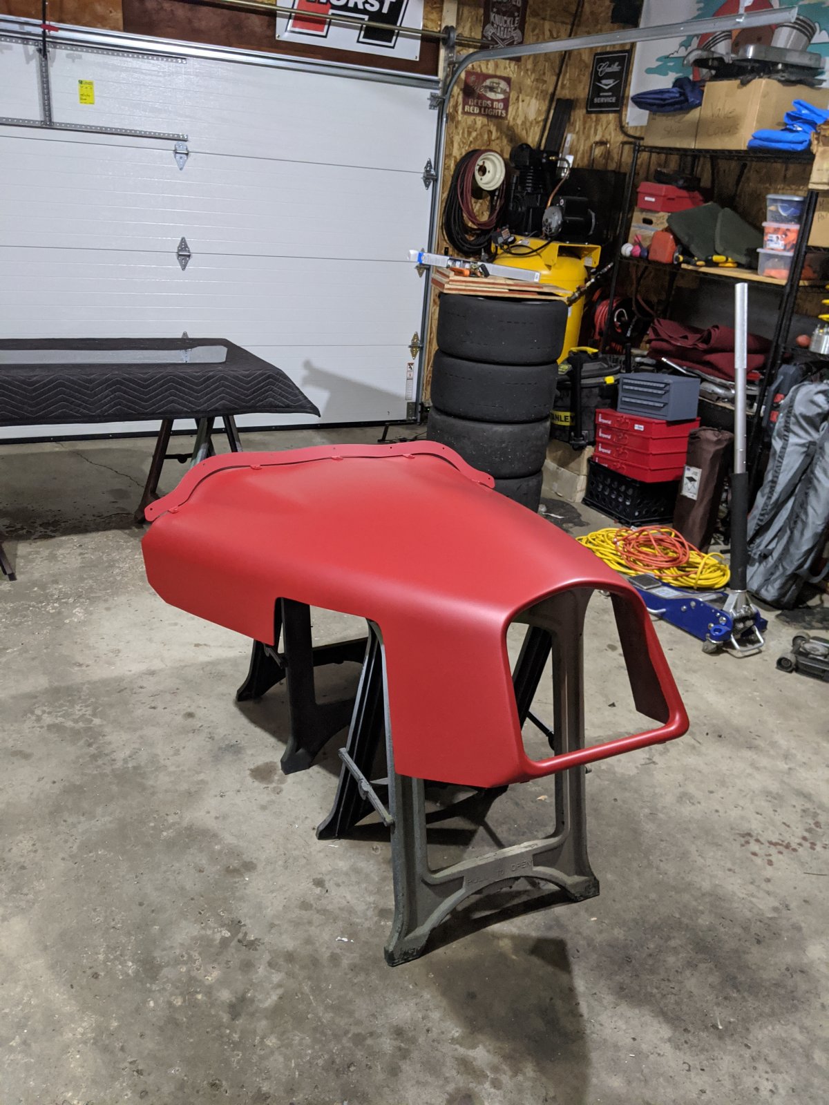

I was thinking doing the same plastidip route for my hood. What kind of prep is needed for the hood before you spray color?
I just cleaned it really well with DYC's pre-dip spray. Not sure how it'll hold up with the gel coat but the dip is cheap enough to experiment!

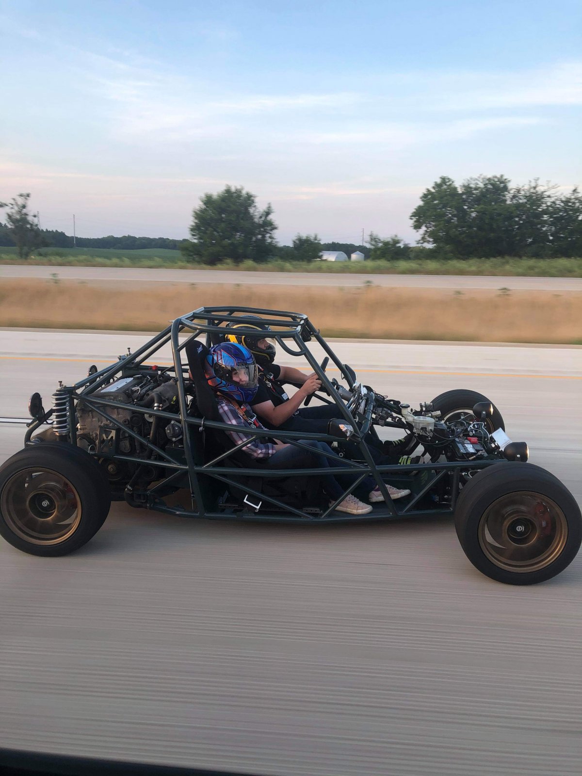

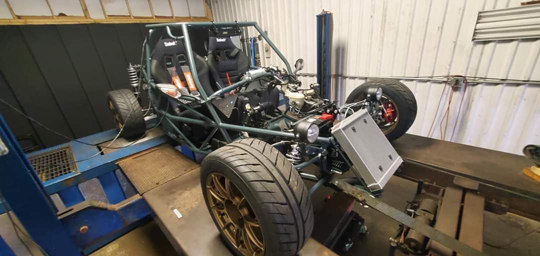

The Goblin made it the 40 mile drive home down the interstate from the tuner this evening! What an awesome drive! Can't wait for AutoX this weekend! It made 250hp and tq on the Mustang Dyno. I told him to keep it super conservation and it's on 91 so it definitely could have made quite a bit more power but that wasn't the plan. Gotta have somewhere to go from here!

If you posted it previously, I missed it. What size pulley and injectors?
It's a 2.7 pulley and 80# injectors. I got them from overthetopperformance. I went overkill on the injectors and pump so that I can make more power and switch to E85 if I want without having to buy the stuff again.

I really like your hood looks like it came out great. I looking into dipping my hood and sides panels too instead of wrapping them. I was wondering did you put down a grey base coat before the red or is it okay to just spray over the black without a lighter color base coat?

I sprayed right over it with the red. With dip you really want a good 5-6 coats so you can pretty much go over any color with any color unless there's a specific effect you're going for.
Also got the hood coated and windshield tinted today.
