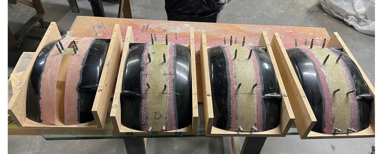

My plan for finders later on are to take 2 of these cut them off center weld them back together to make them wider. Then use as a mold to lay either fiberglass or carbon fiber to form the finder.

Captfrank2001 adapted the DF wide fenders to wider tires by channeling them and adding a strip of fiberglass to the middle. Look for his build log.

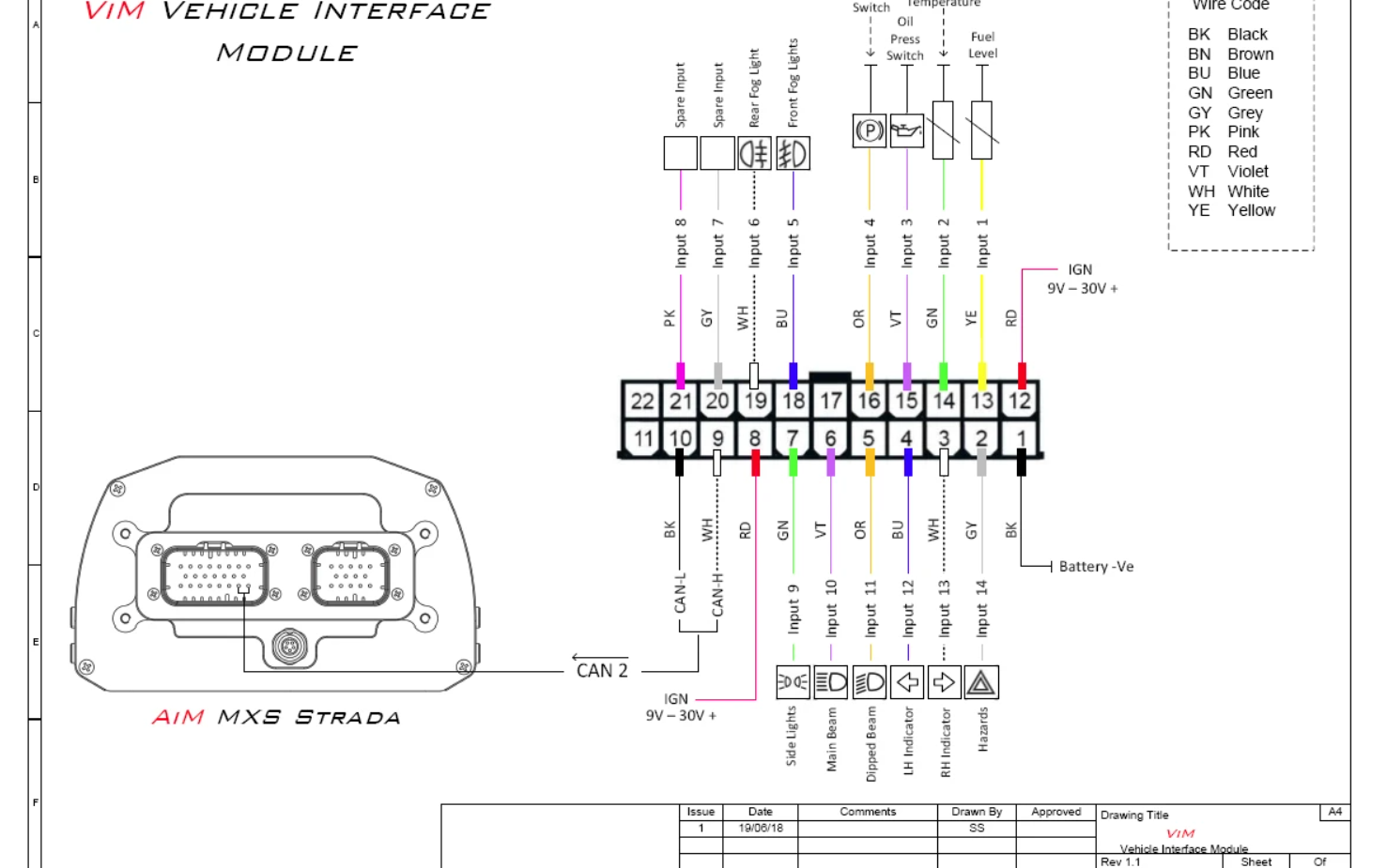

I didn't even realize that you had the AIM unit and were in SF. What are the odds....
This is what was suggested to me by the Ultima Community.
So I'm using the AIM MXG which has a different set of inputs compared to the MXS Strada.
Check out my Post in the Digital Dash thread, HERE.
I posted a full set of my "wiring diagrams" for how I'm connecting it.

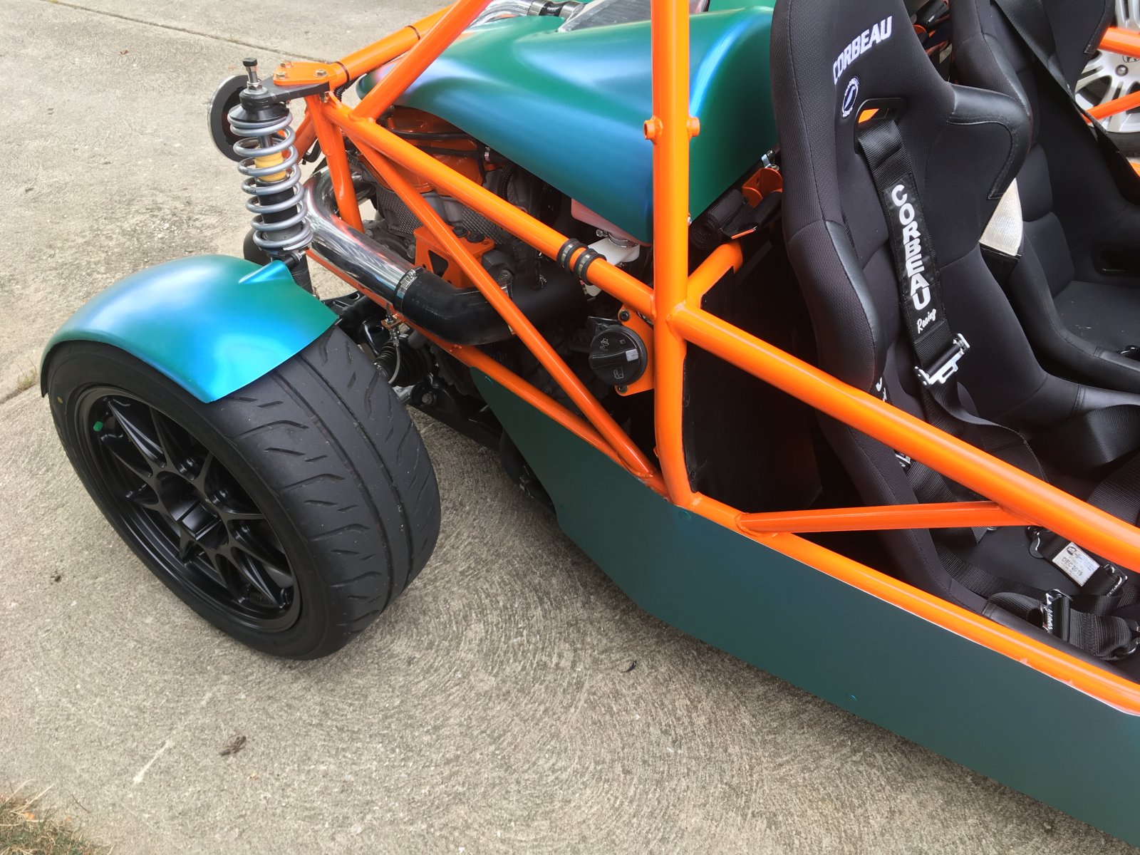

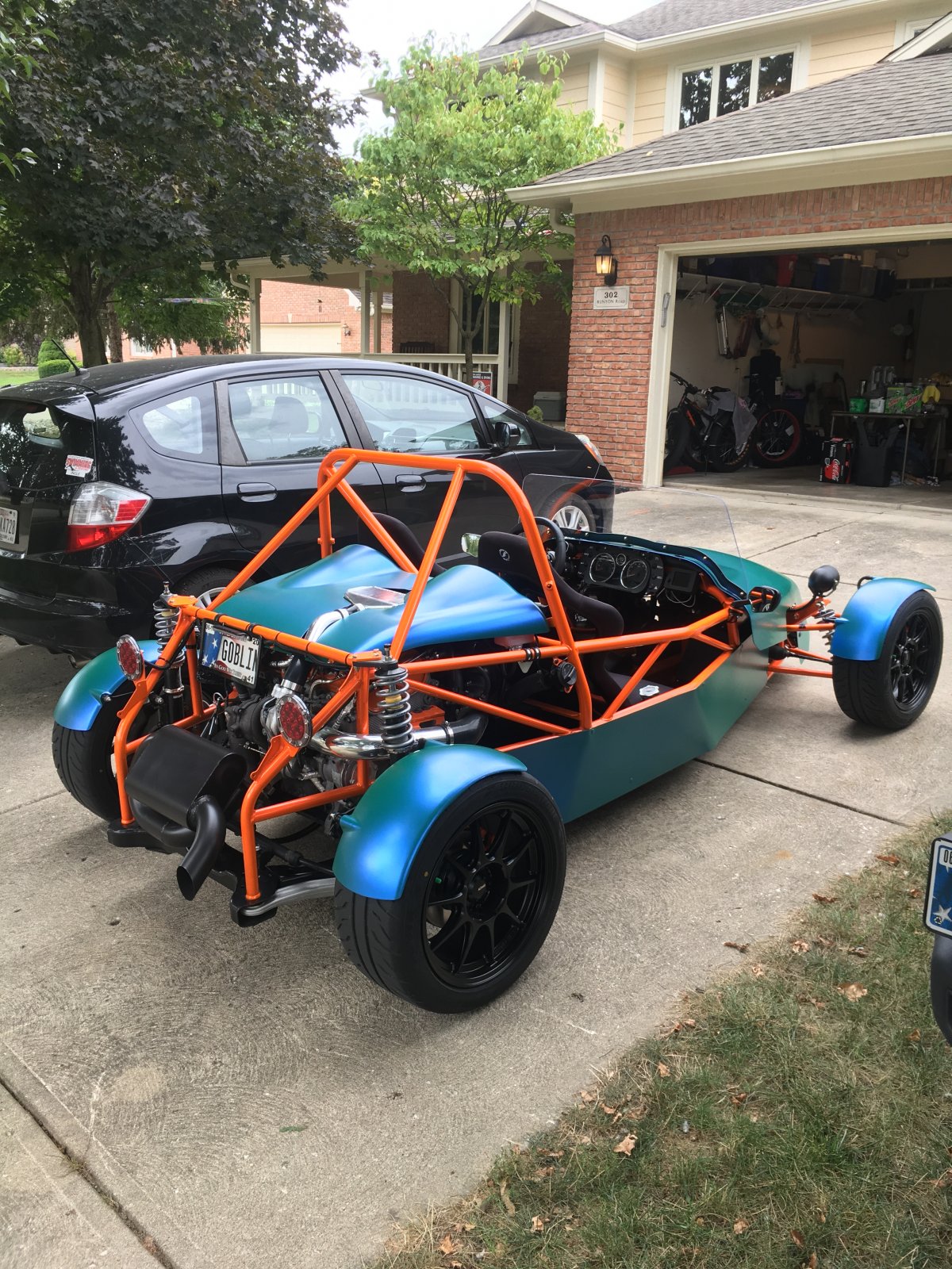

Looks great with that Wrap!
Do you have the 245 wide fenders front and rear??
I ordered the 245's today with hardware from the factory. 520$ I may channel and widen each fender if these look too small for the 275's
Indy Lonnie

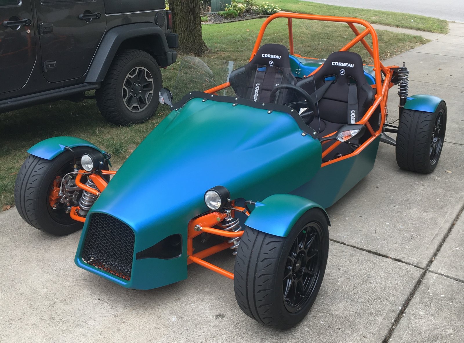

Just in the rear. The rear fenders are the large - "for 245's". They fit like a glove. Be sure to account for the diameter of the tire as well as the width. My 205 fronts fenders do not match the diameter of my front tires. They look OK, but not as good as as the rears. The rears are tight - maybe 3/8" clearance. No rubbing issues. I love them!
The fronts stand off a little since I went with a tiny 205/50R15, smaller diameter tire than stock.. The rear tires are 255/40R17 - the same diameter as the donor Cobalt SS.
I went with the staggered big - little look.
