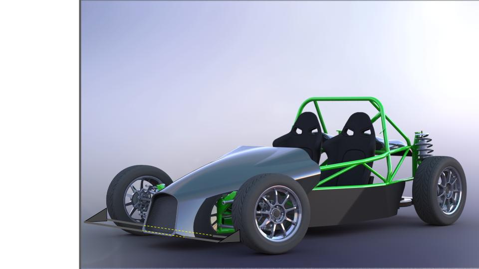

I noticed in an early computer mock up of prototype 1, the kit is shown with a front wing mounted to the nose.
Is there any intention of offering this alongside the rear wing in the future?
Adam
The front wing is definitely something we will be revisiting.
Because we moved the fuel tank behind the seats and the radiator up front, the nose is being changed to include an opening for fresh air to get to the radiator. Since the nose is changing, we are holding off on designing the wing until the nose is finalized.
Here's a rendering that shows basically what the new nose is going to look like:

Adam
In reply to Mr. Smith:
Donkervoort has a wing similar to what you've sketched and is one that I like.
We would probably not start off with an adjustable wing like the Donkervoort but I like how the wing flattens out in the center to fit under the nose rather than sticking out in front of the car like a plow.

rallyracer
I think a decent front wing is a must. With most of the weight being in the back, we'll need that downforce to help keep firmly planted up front under high speeds, and to help with front grip flying through the twisties.
