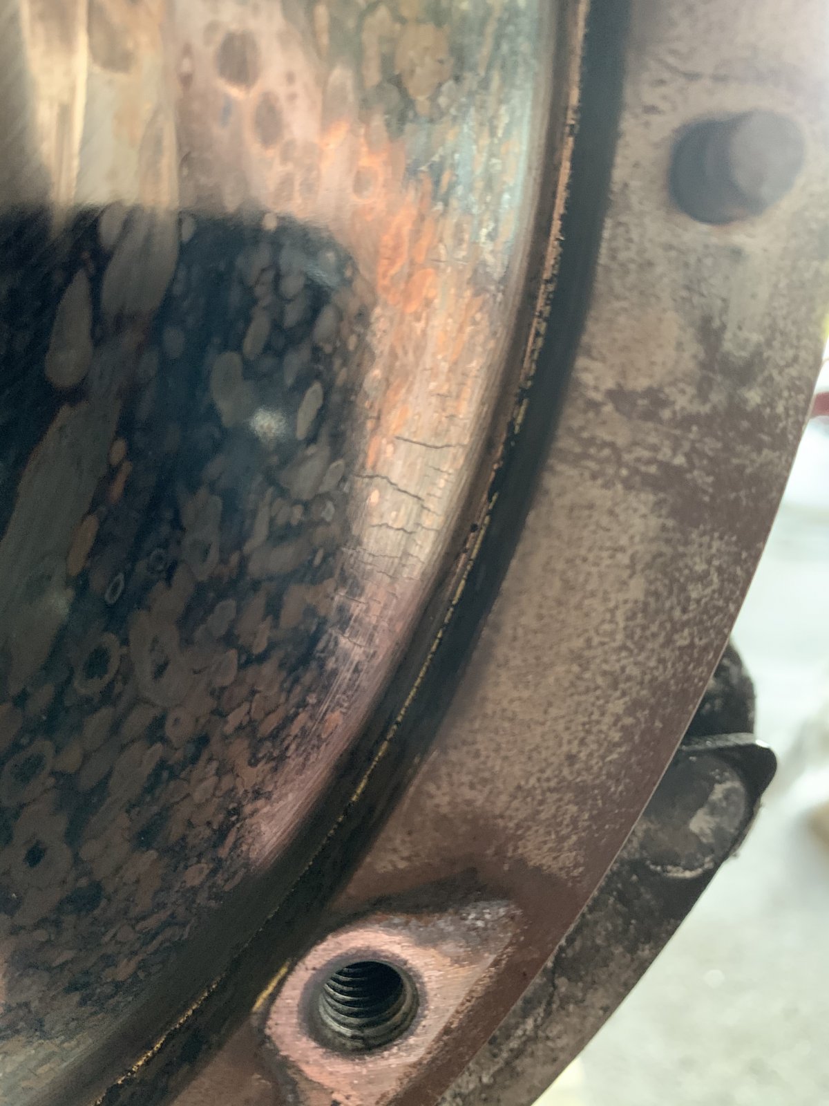

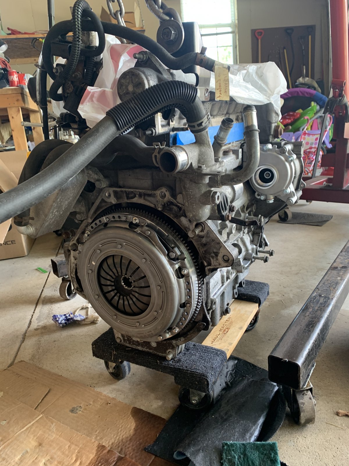

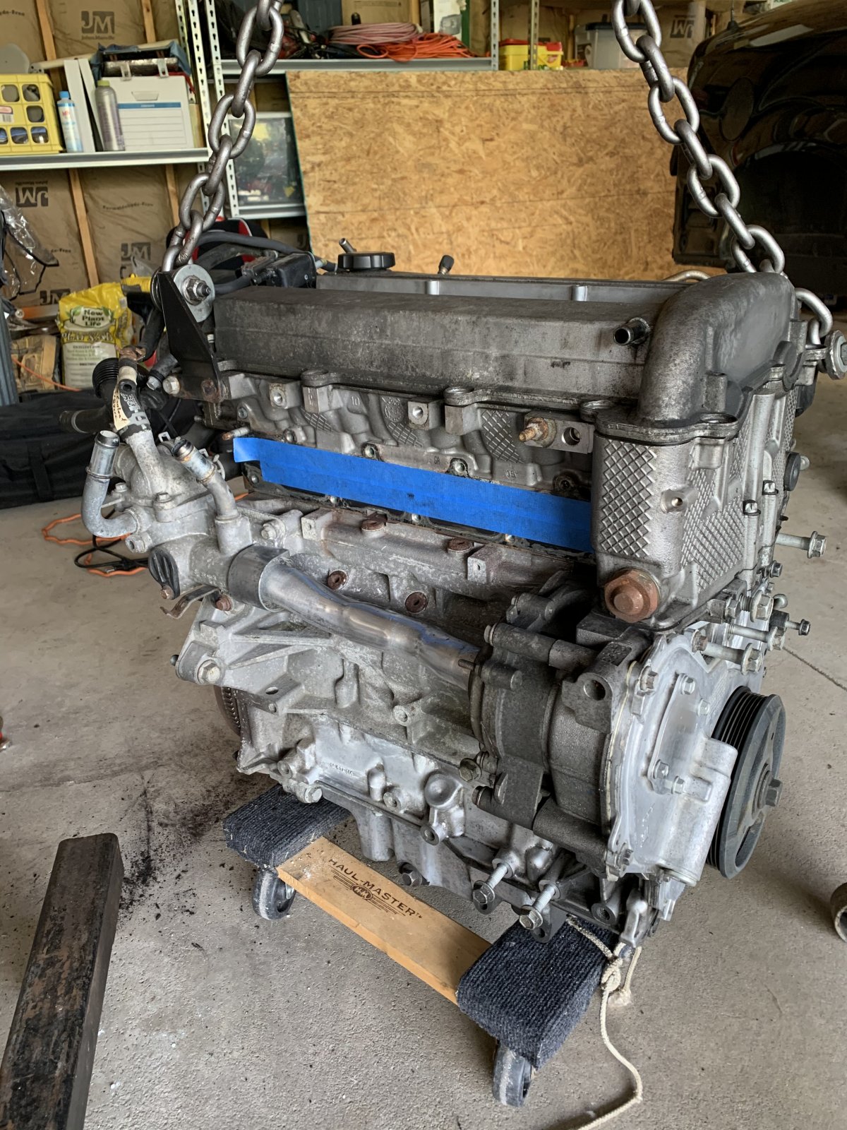

Trying to get the engine clean...so much corrosion. I think I am just going to get the grease off and call it good. Took a closer look at my flywheel and noticed two cracked areas. Some parts are on their way and then I can begin the process of putting the engine back together. Really need to start on the wire harness too.
14733
14734
Ooh, that's not good. Small cracks eventually become big cracks and when they are on rotating assemblies with lots of kinetic energy they can potentially cause all sorts of secondary damage if they fail. We're you going to replace the clutch? Would highly advise a flywheel replacement too, to be safe. :)
The block may not be shiny, but you got it very clean! I did the same and did not paint any engine parts. Looks good when complete.

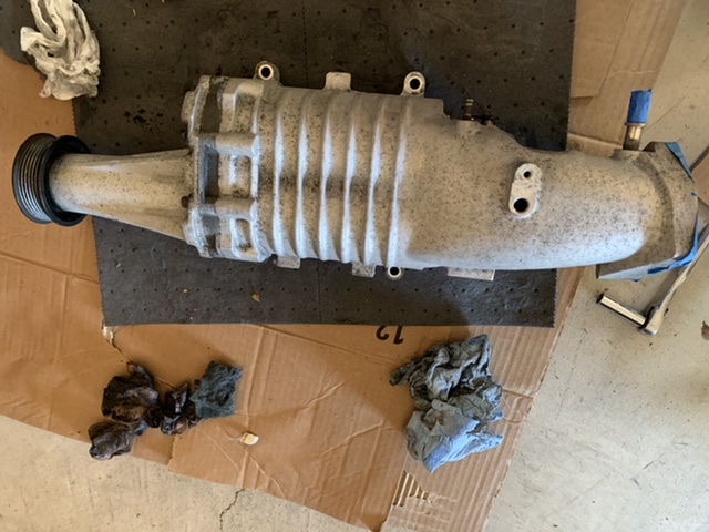

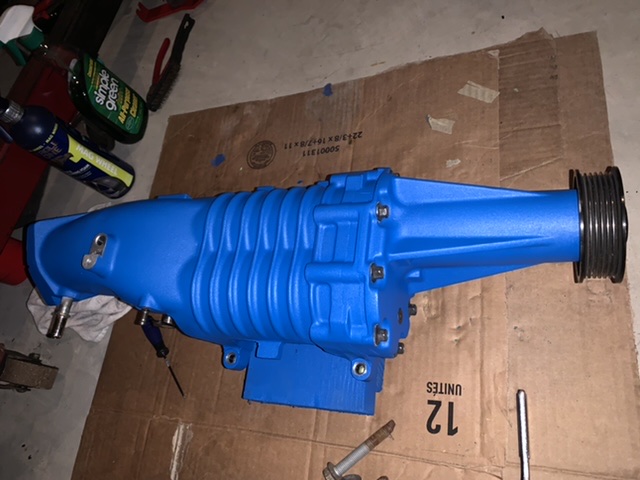

I really wanted to paint the valve cover and supercharger. The valve cover I can get sand blasted...the supercharger I probably shouldn’t unless I gut it before hand (sand always finds a way in). This is as clean as I can get it. Maybe the paint will stick?
14759
Murcielago311

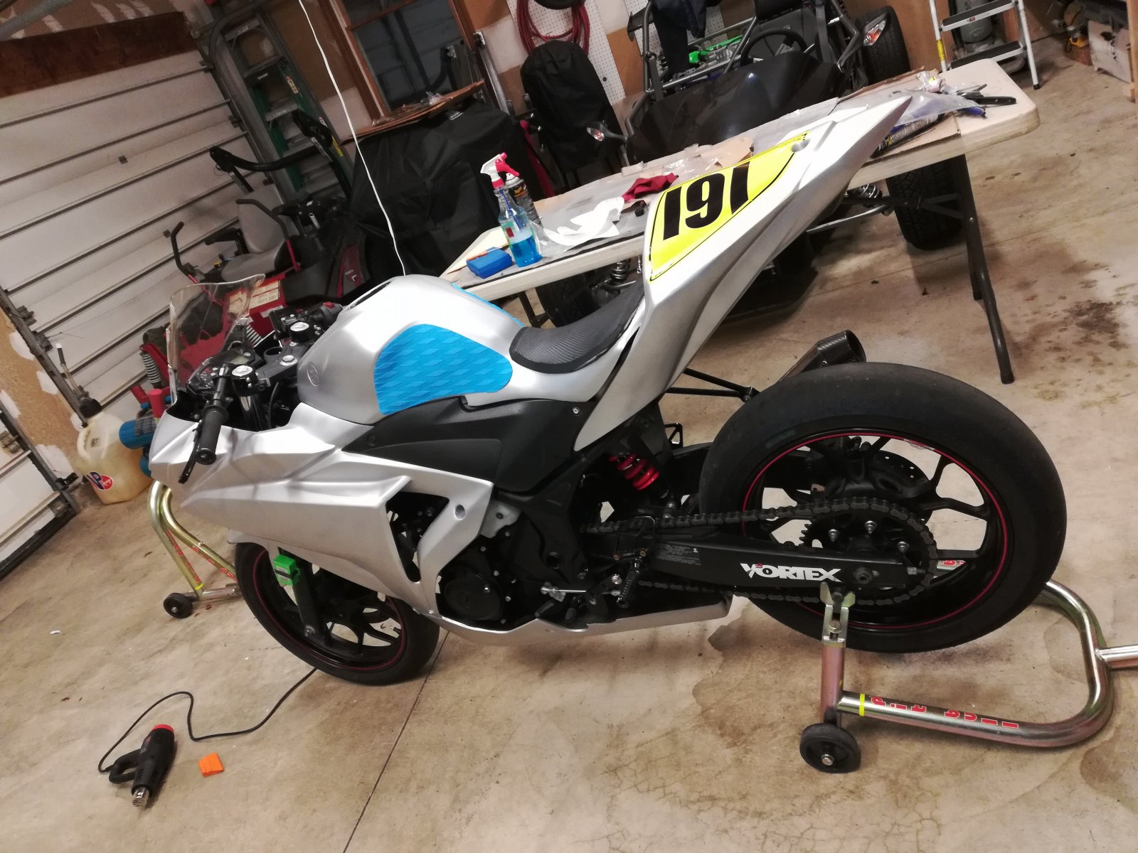

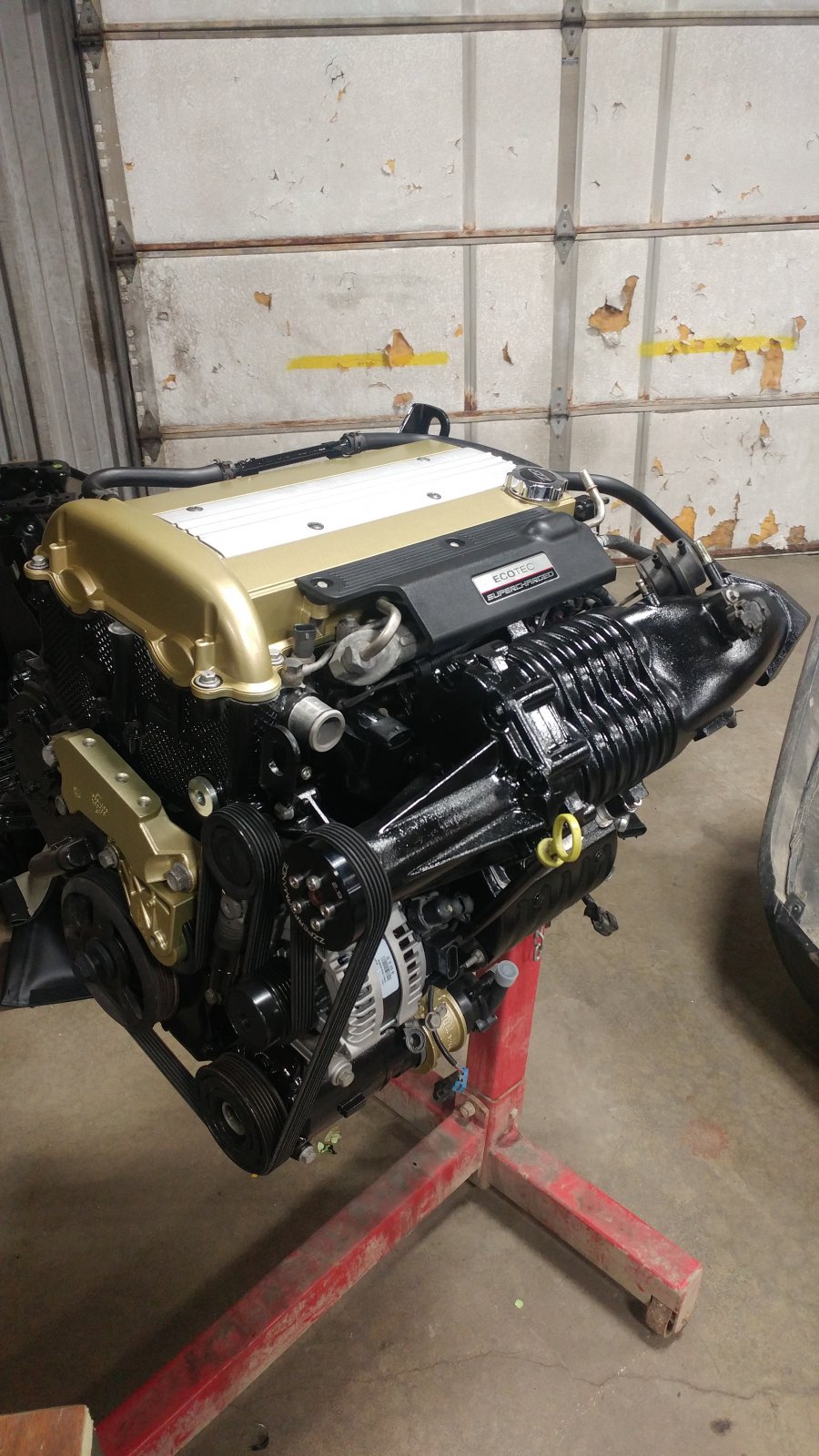

Mine looked similar after wire wheel work and brake cleaner wipe down. I used dupli-color ceramic engine spray paint and was really impressed with coverage and strength. Even hit my track bike with it using the extra cans. Go for it!
If you're going to blast the valve cover, just know that reattaching the baffles is a pain. Dealing with that now.

Nice paint job!
Total-coverage look is way easier to achieve (with way less paint) when silver is the color of choice. (Gotta first get the grease and crud off, though. Tedious but worth it.)
Excellent view, btw, of a gutted AC compressor.

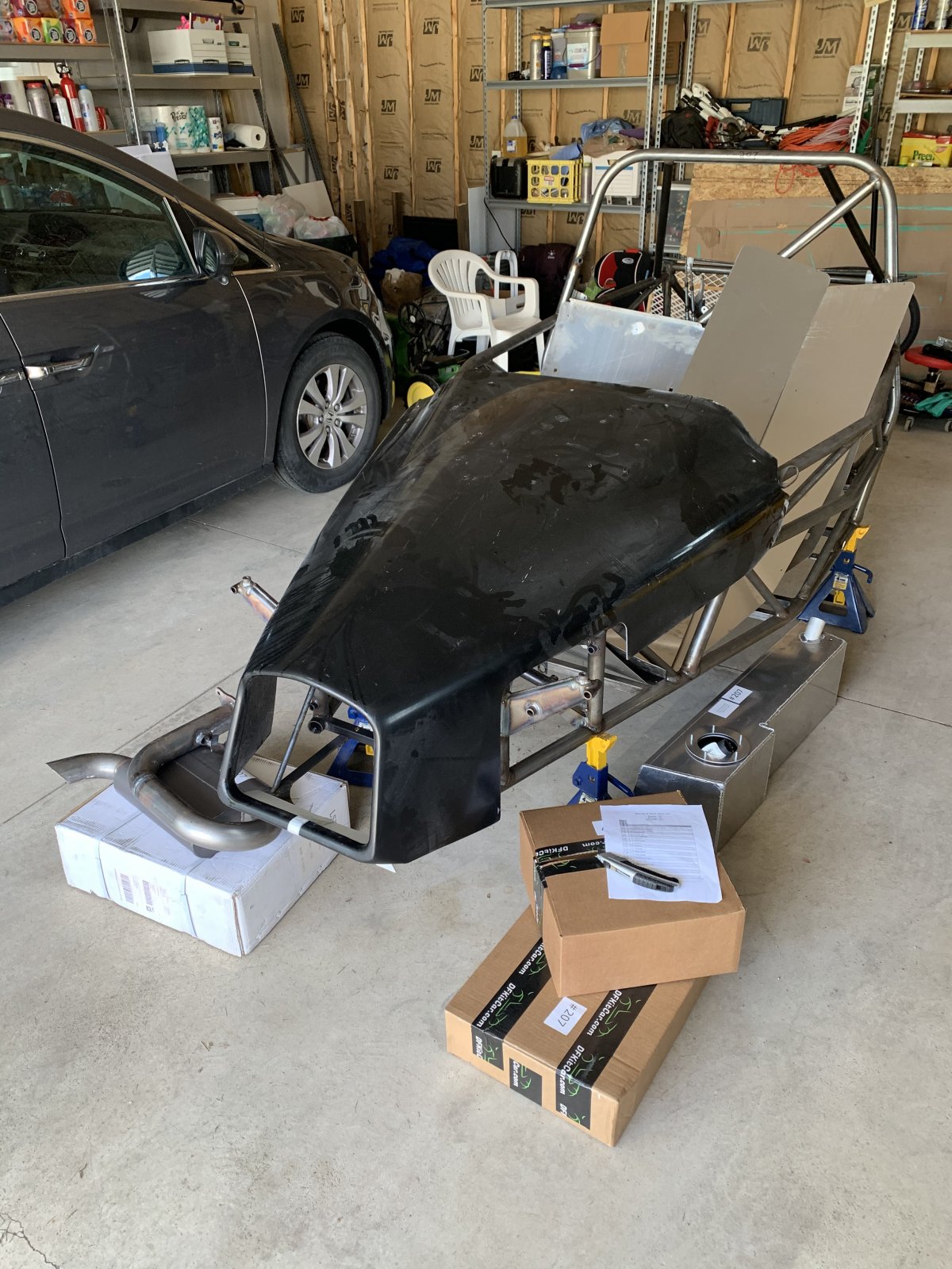

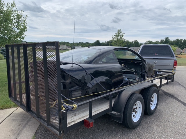

Chassis #207 arrived home today! Delivery from Stewart Transport went really smoothly. Everything is looking pretty good upon first inspection.

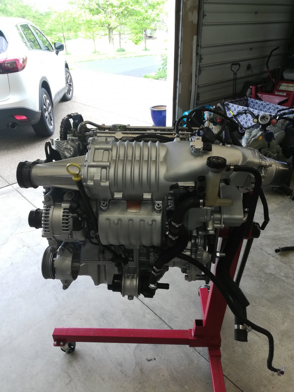

Attached the aluminum flywheel And upgraded GM pressure plate/clutch/TOB. Also replaced the water pump and cam sensor housing sea. Will clean out the intake manifold next and attach the new dual pass endplate. All the other components should go back on pretty quick after that.
