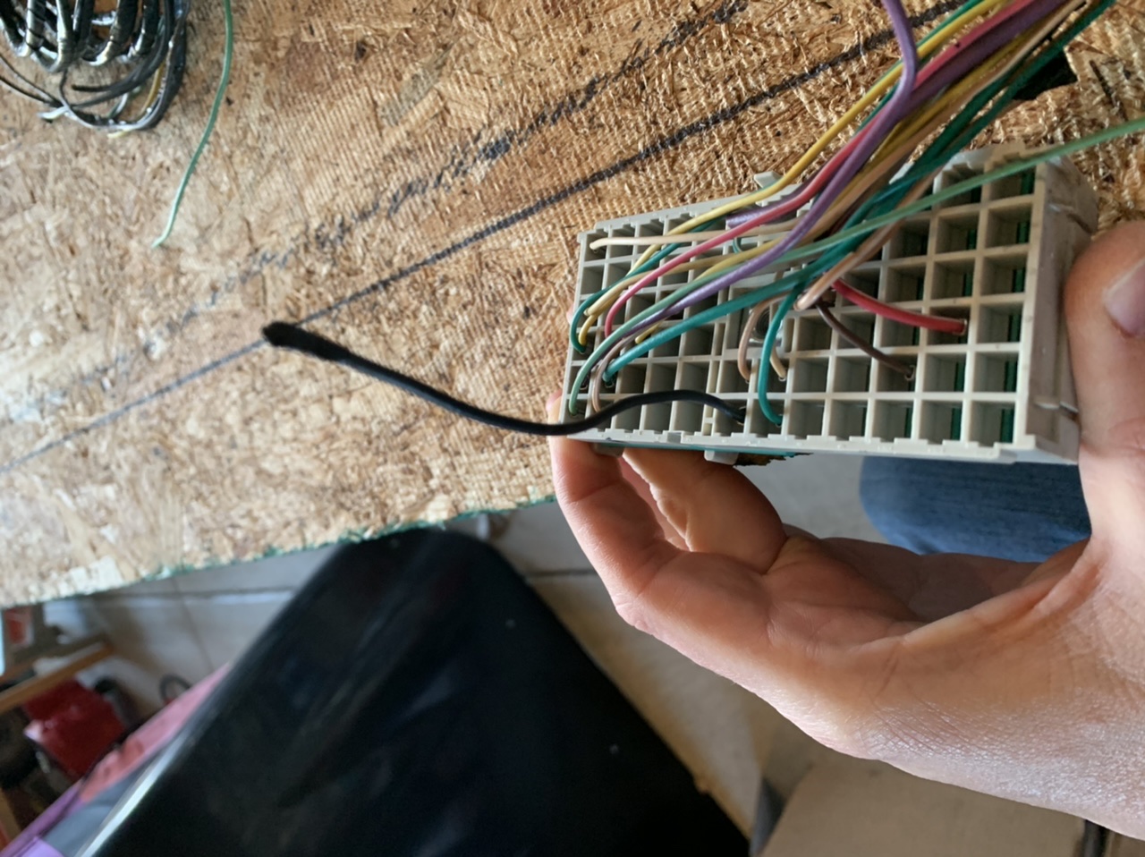

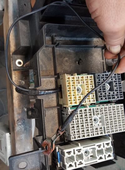

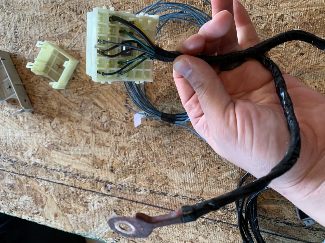

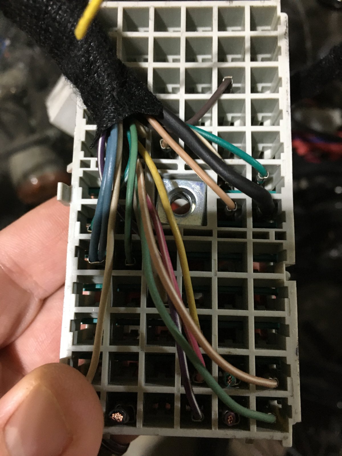

While you’re back there un taping here’s a couple things to consider. I plan on running a third brake light, so I added another ground wire back there to tape up with the blue third brake light wire.Just popped mine off, I have that wire too...but it has no continuity with any of the ground lugs....looks like I have some I in-taping to do.
The other thing is you don’t need the circuit for the intercooler pump that Lonny has you add back there. That will already be part of your engine harness on an LSJ.
