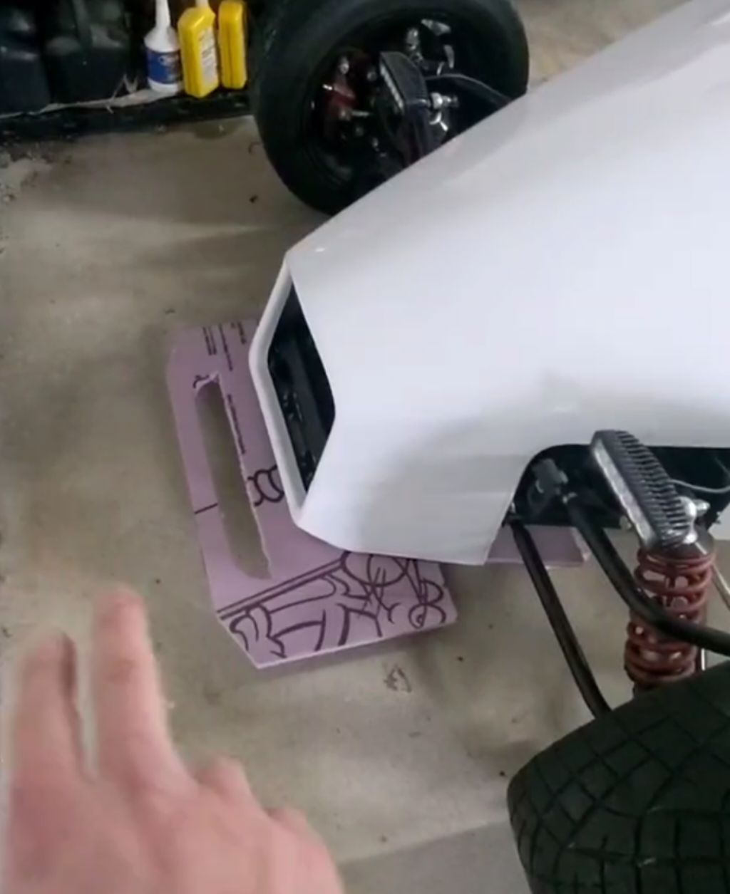

I don't want to super derail this conversation, but I need input. Has anyone accomplished the hinge hood + the splitter? I cut this out of foam on my CNC and couldn't get it to open without removing a large chunk from it (slid forward for pic)
Don't know the geometry of a simple hinge will allow for a tilt forward if the rotating point is not right at the very front of the nose. Using the dzus plate puts the hinge point 2-3 inches aft and, as you illustrate, the nose moves lower than the top of the splitter.
A compound hinge, that operates like the donor hinges (hood or trunk), would be needed to move the hood nose up and forward to clear the splitter. This is something that I originally looked at with the Cobalt hinges mounted to the sides of the radiator support frame. This is just one option, I'm sure there are other ways to make this work. :)

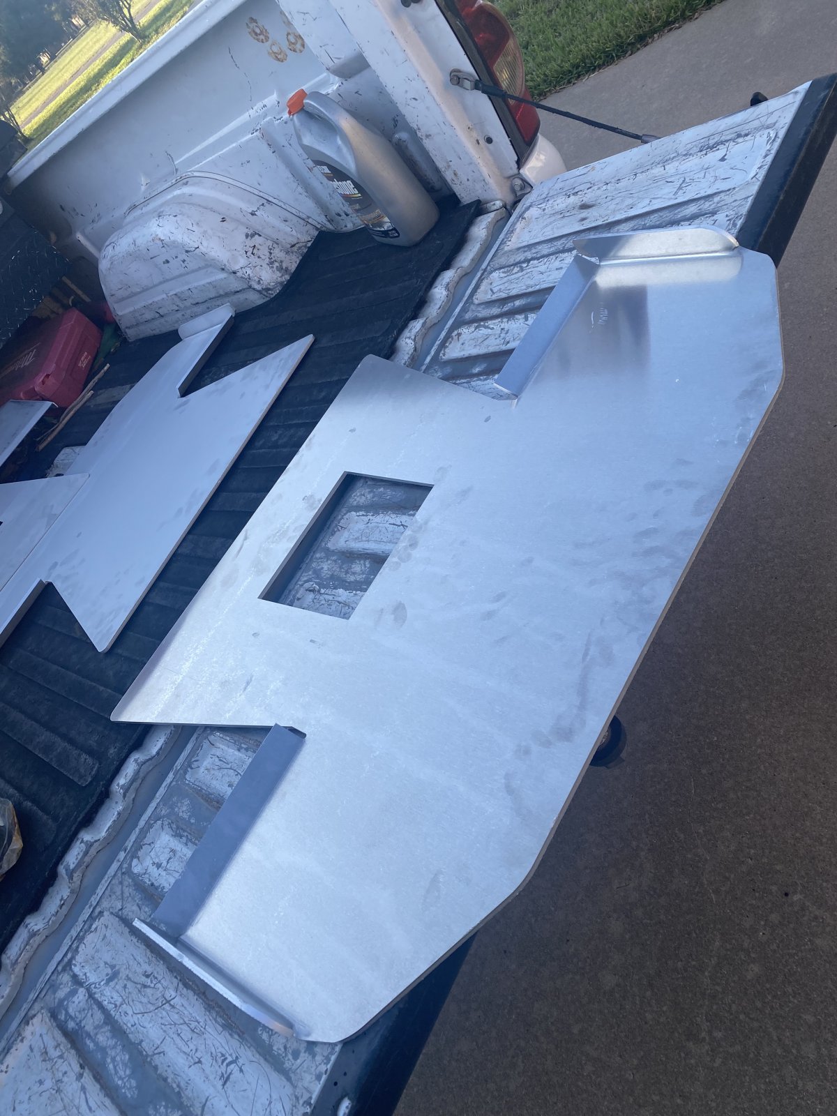

Correct. Intercooler means a cutout to let air still escape. Yes it’s somewhat counterintuitive but it is what it is. Without intercooler is uncut flat and smooth.
As I have said befor, a backwards cheap “hood scoop” will help keep the flat bottom but still let air out for the intercooler.
If you are running a front intercooler, it’s not a bad idea to use a pusher fan, instead of puller. This way the airflow can go from main rad to ic rad to out the bottom. Like I said a little counterproductive trying to create a low pressure under the car, but it’ll give you the best results overall.

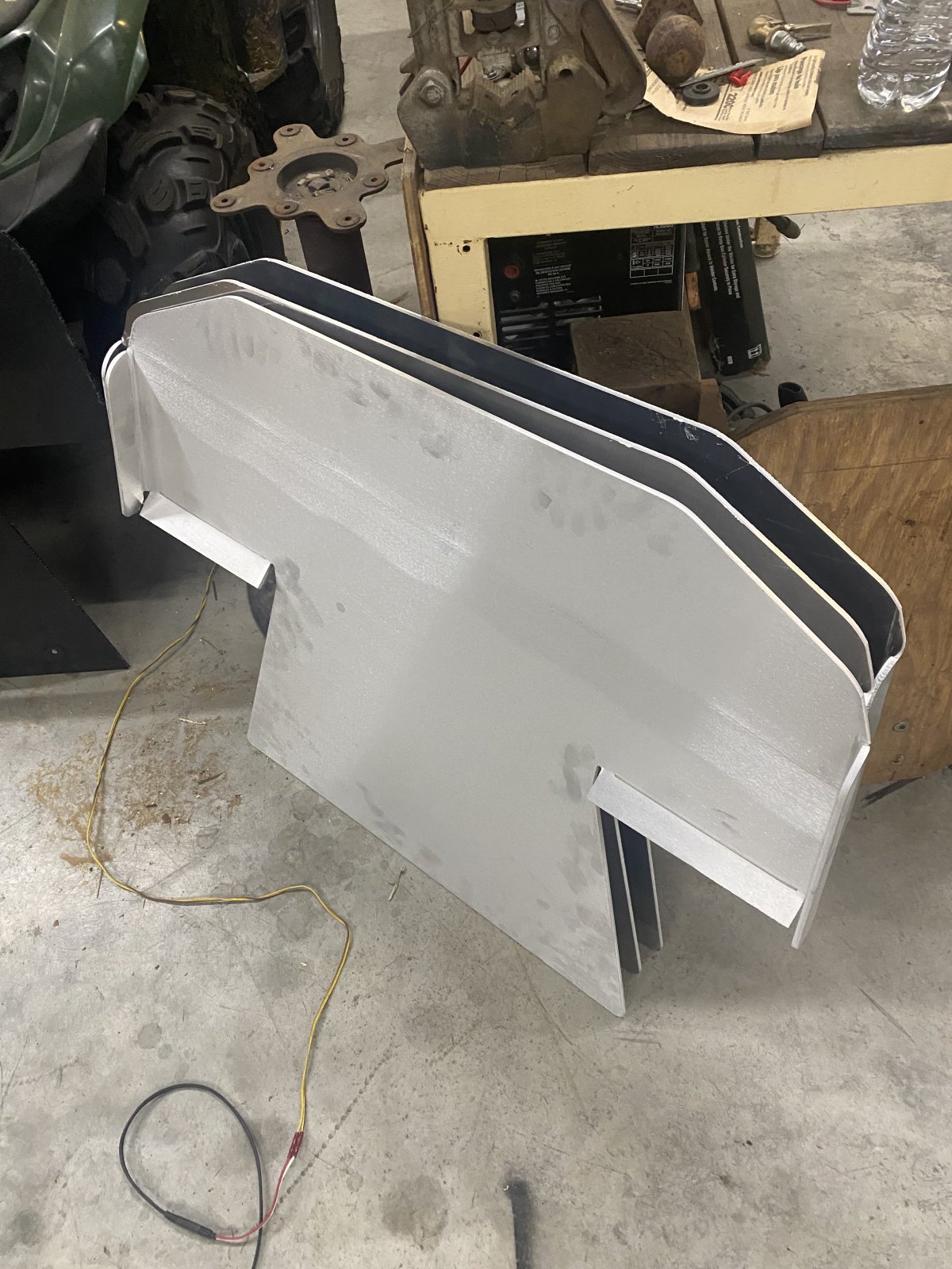

Here’s where it all started. SACTX made the original splitter for us (him and I) out of alumilite. I took it further getting it made out of aluminum plate with the bends. There were a few prototypes in the development and have settled where we are now. It’s amazing how a little tweaks here and there change the characteristics of the car so easily. You can easily go further with this, but where it sits now, is a good spot.
