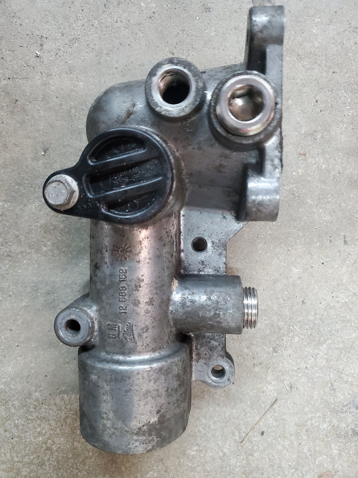

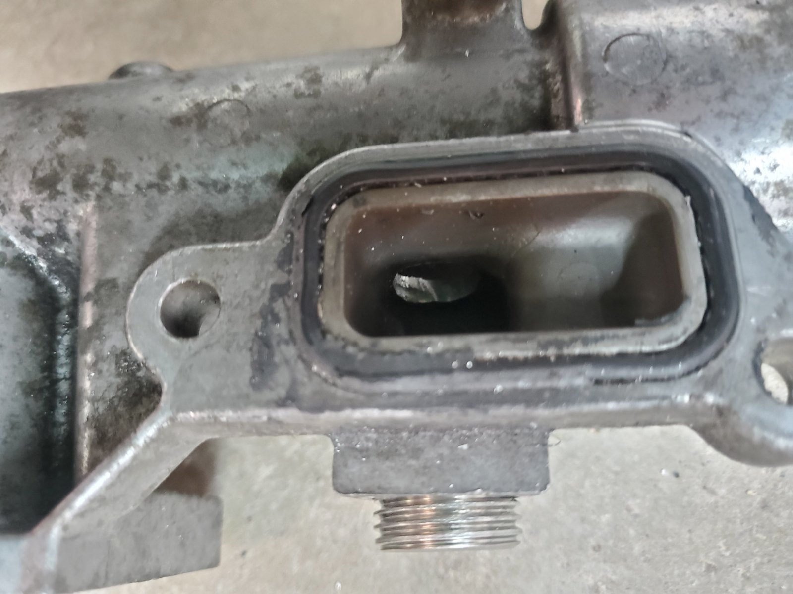

Looking at threads for the heater core pipe bypass and it looks like people have looped the pipes with hose, taken the pipes out and installed 90* fittings and hose, or used the CBM Motorsports housing which removes the thermostat.
I bypassed the route of the 2 pipes internally by just drilling through the passage that comes out of the head down into the lower portion where the coolant ends up anyways with the heater core loop in place.
Then tapped the pipe holes to 1/2 npt for plugs. Now there is nothing on the outside of the housing, you keep the thermostat, and your coolant pasage for the head is not blocked off.
Nice modification. I hadn't heard of this before, but it will clean up the heater loop nicely. Of course a water cooled turbo would put those lines to a good use too.

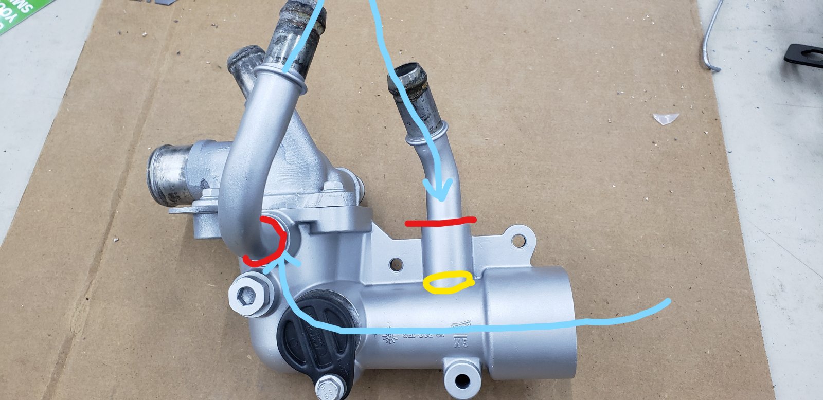

it routes the coolant the exact same way as leaving the external loop with hose. Except it is now it is internal.
Towerdog
Exactly, Mine is off... Freshly painted of course cuz I think Im on board with doing this. Coolant comes from the pump, "underneath" the head entrance makes the turn up to where the thermostat is and exits out the side through the heater core then back to the head. So if you cap (Red) and drill (Yellow) you can eliminate the goofy loop.

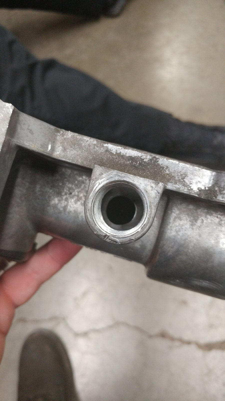

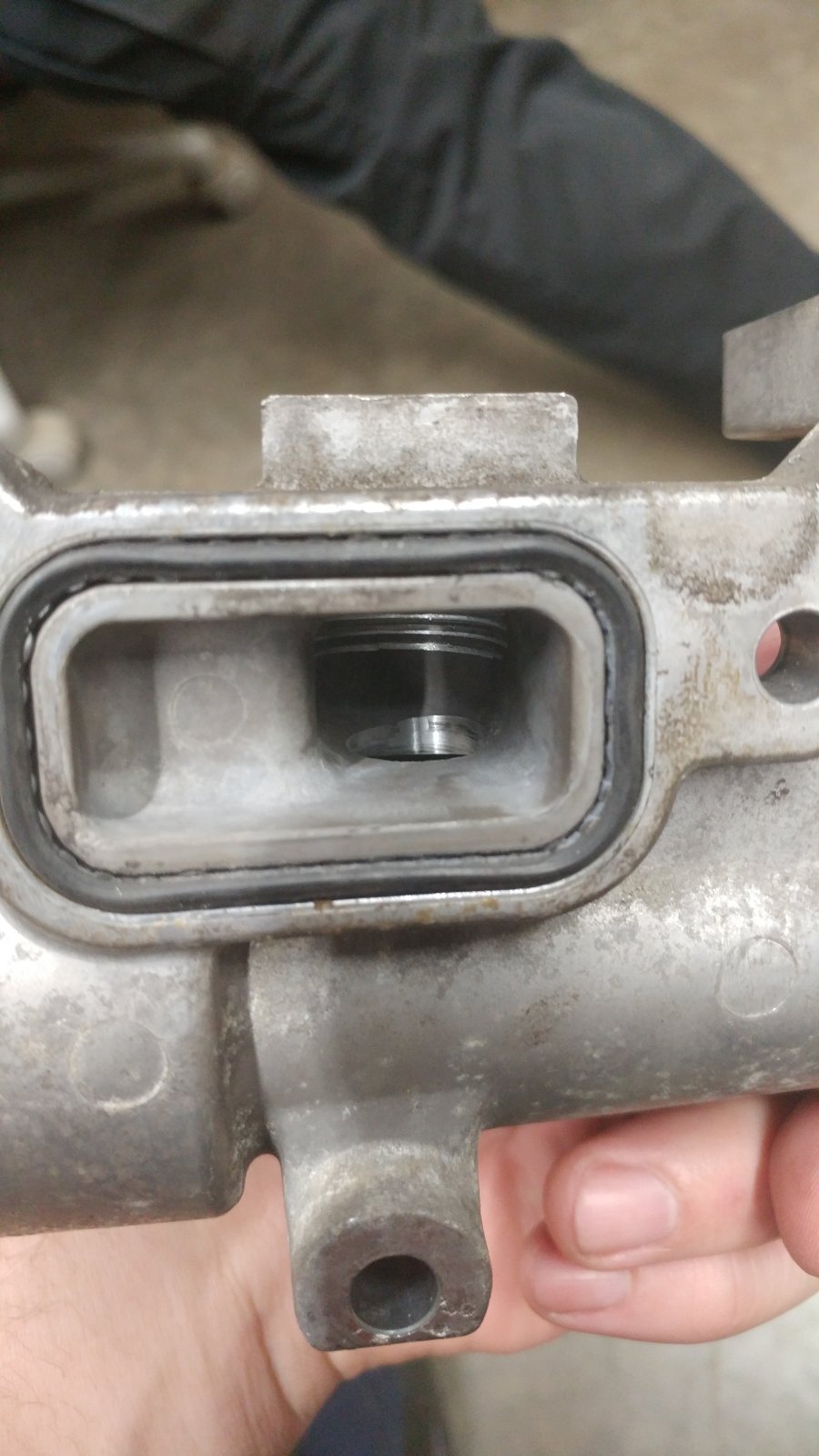

I see, if the opening is below the thermostat then no water is going through. Just seems too easy to be true !

Yea you can not just put a block off plate over it as there is a sensor in it... Planning on going the external route.
