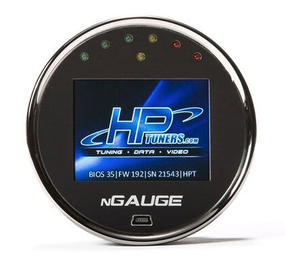

There is also the NGauge. It is not compatible with the Turbo cars (I really wish it was!) but I think it may be compatible with the SC?
