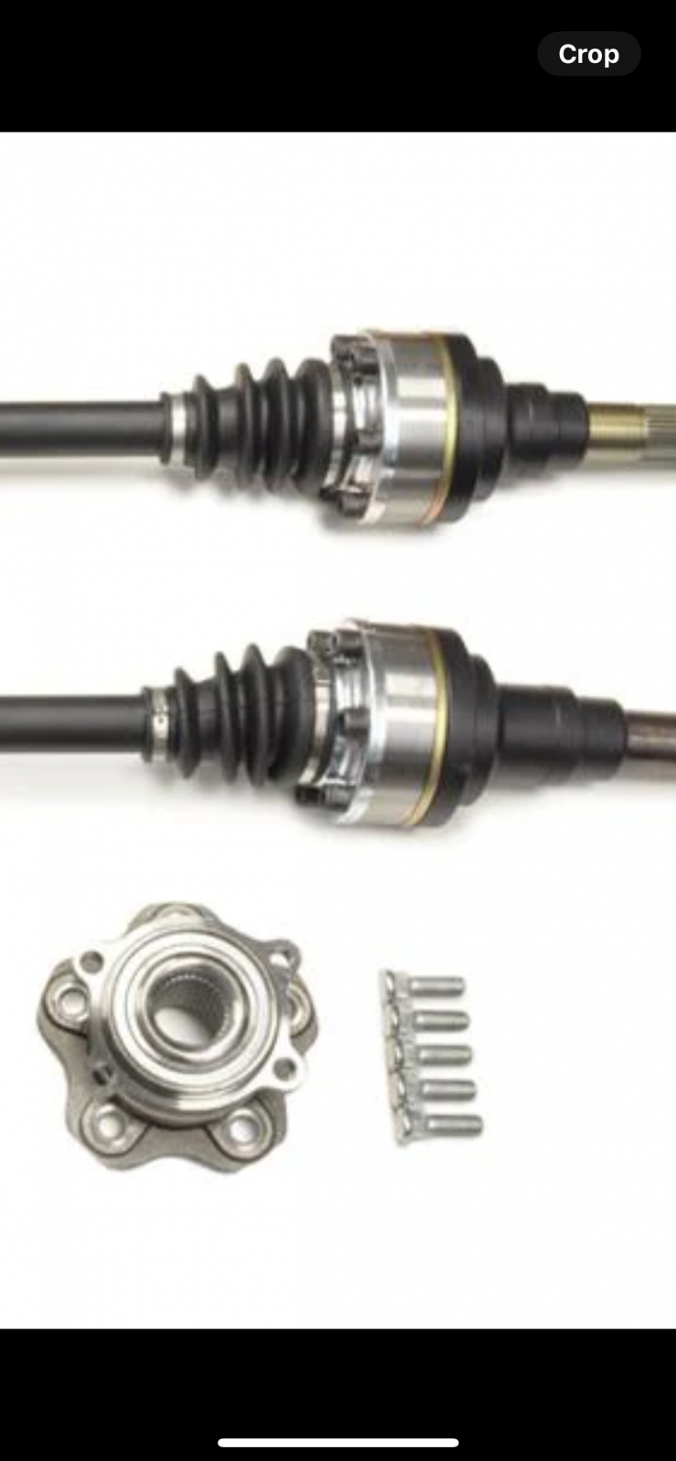

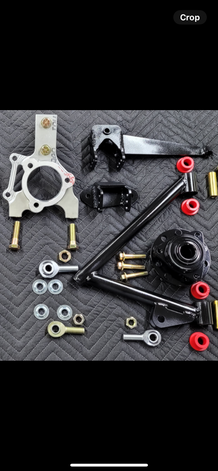

Is there an adapter that converts a 4 lug to 3 lug on the bearing hub?

Are you trying to find, a hub that matches your drive shaft spline count?
No so the knuckle and hub is a 3 lug, but the axle and hub I’m going to use for the k series is a 4 lug…. I’m wondering if there’s an adapter for that change or am I going to need one fabricated?
I assume you're planning to use a Cobalt rear hub (4 bolt) on the front of your non-Cobalt Goblin. If not... good luck.
The Goblin uses a Cobalt front knuckle and hub (3 bolt) on the rear. I'm not sure if it'd be easier trying to adapt a different hub onto the Cobalt knuckle or to adapt a different knuckle onto the Cobalt LCA/strut. It looks like their new tubular rear subframe uses the Cobalt front hubs as well with custom uprights.
Agree with Gtstorey, a custom driveshaft is your easiest option. You will probably need custom driveshafts anyway, because the lengths of the Honda shafts are most likely not correct either.

The Honda has a different wheel track width than the Cobalt. Therefore the axles probably will be different lengths. So, from you first post pictures of parts, the control arms may not be the right length already and you will have to make your own.

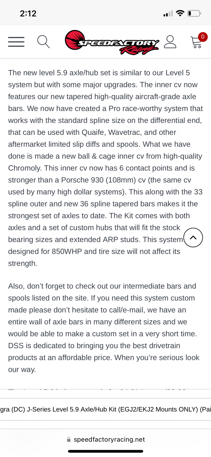

i know ima do custom axles for the right length, and i ordered the tubular subframe., i think ima have a problem with the hub unless i get a custom fab adapter
If you're already getting custom axles, you should be able to have them put cobalt outer splines on them, which would just bolt up to the DF knucke.
