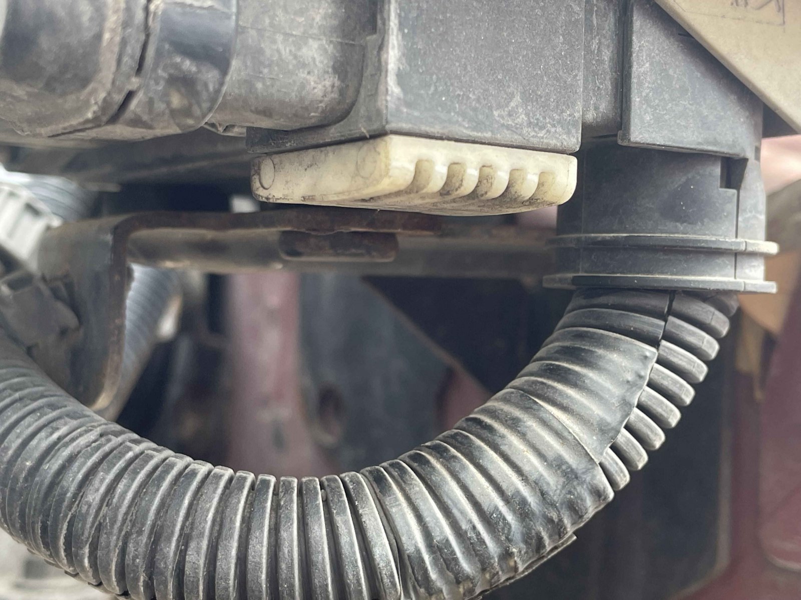

I checked this morning, that's a spiderweb or other stringy gunk. The upright looks fine once the crap is brushed off.

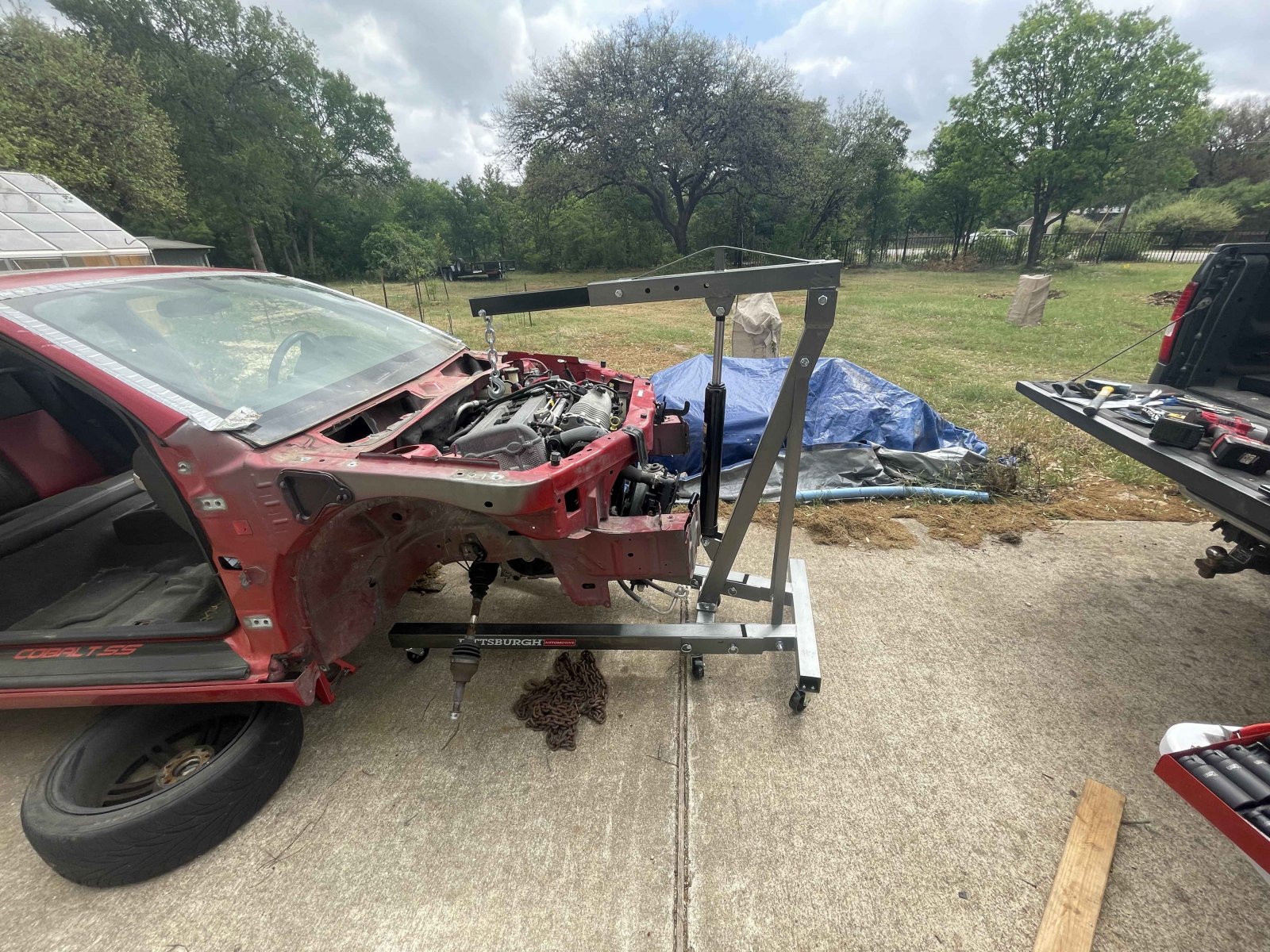

Put together the engine hoist, which took longer than I expected.

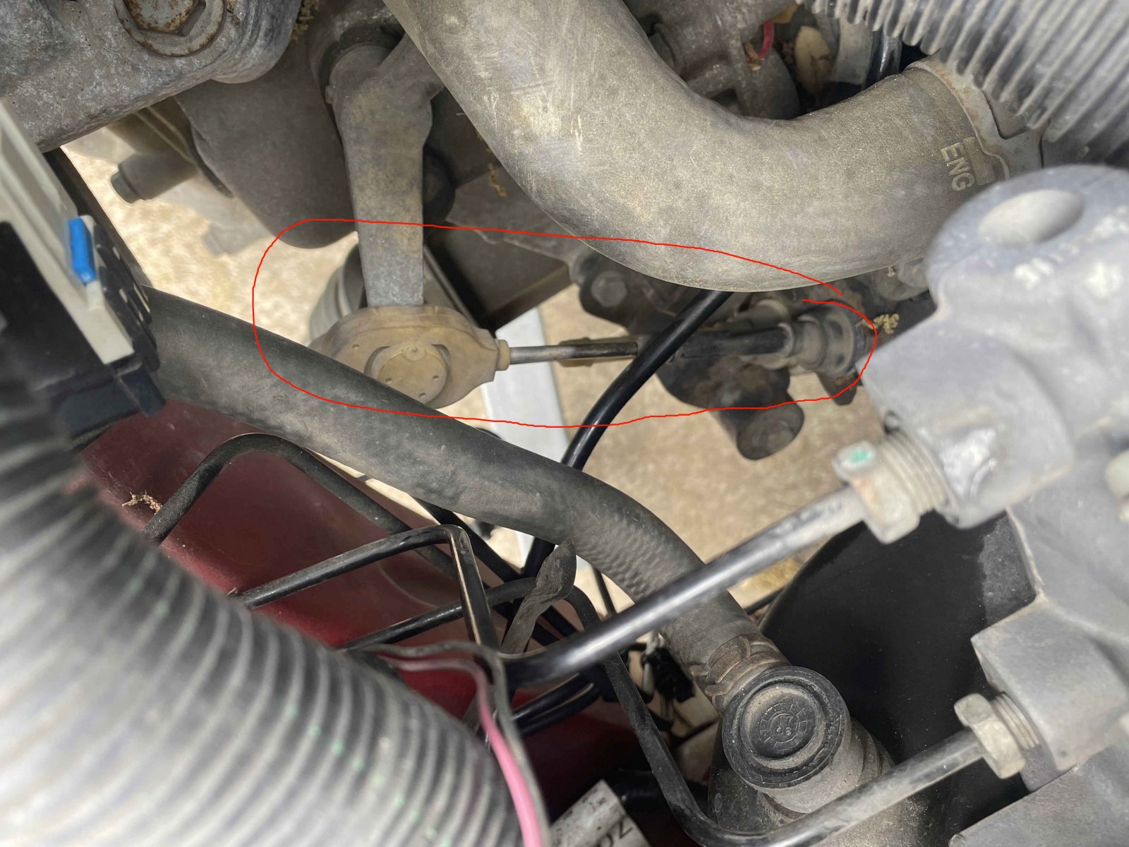

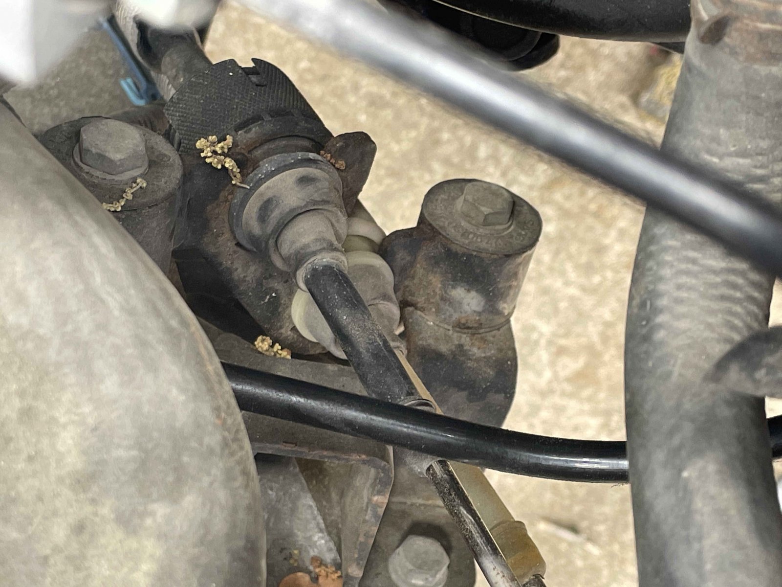

First, I have two cables running into the engine. The bottom one looks like the transmission cable housing mentioned in the video, I don't know what the top one is. The throttle, maybe?
Another view of what I think is the throttle

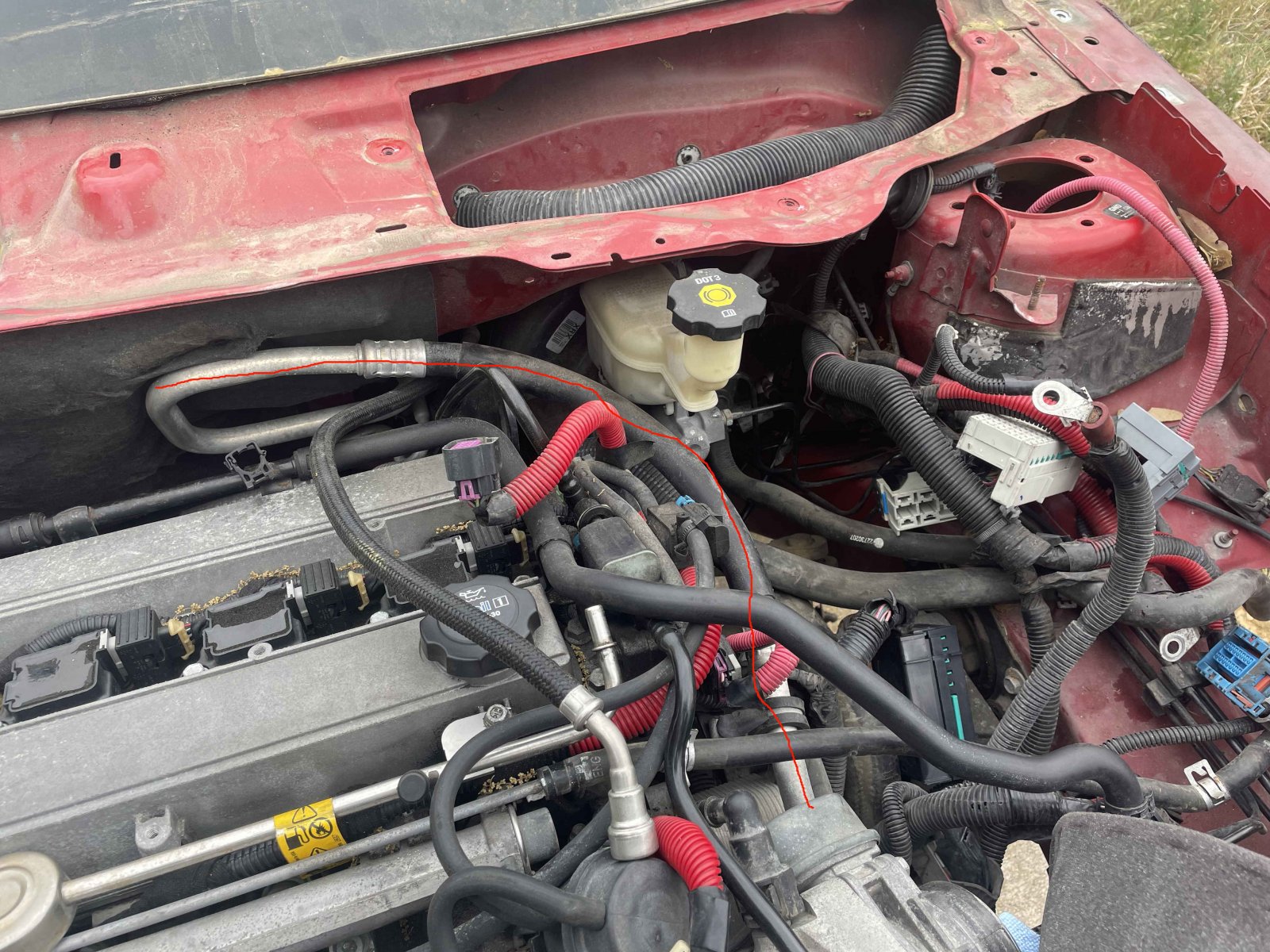

The next question is what is this? I see Lonny move it out of the way in part 4 but I didn't see any instructions on how to disconnect it. I mean, it's straightforward but one of the reasons I'm building a Goblin instead of just buying a track car is to learn everything about it.

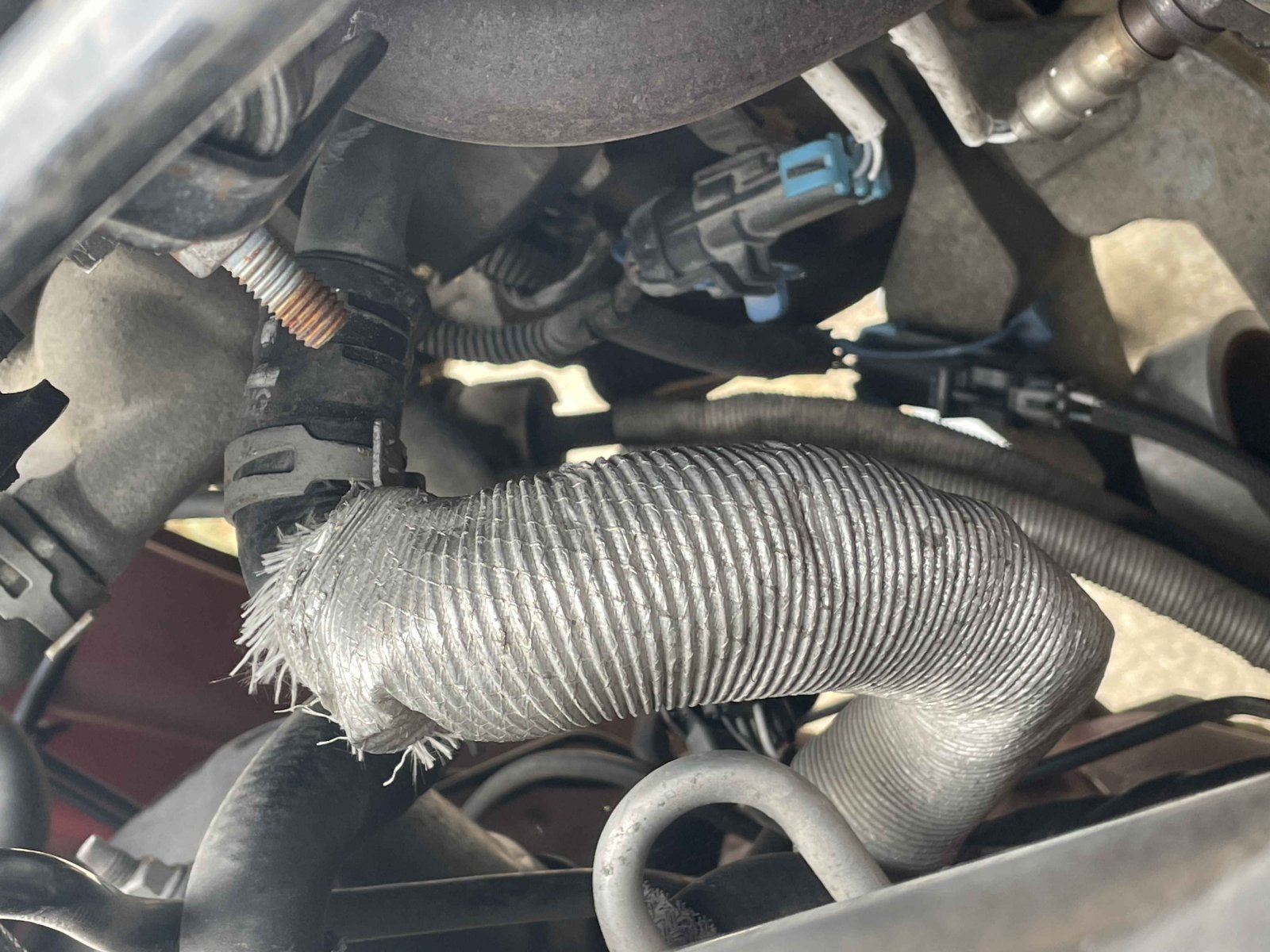

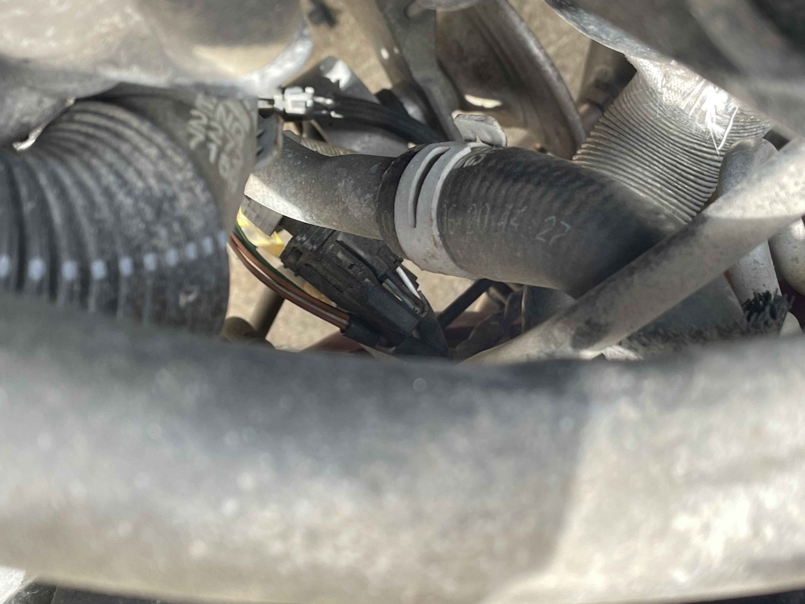

My heater hoses don't look like they do in the video. I see one hose that kinda looks like one. As you can see I tried to remove the line by moving the clip but it's still firmly attached.

I worked on the car this morning, although I ended up with more questions than getting something done. Let's start off with the positive.

Someone else can chime in to confirm, but I think the two cables are both shifter cables. The aluminum crimped to rubber hose is an a/c line (not sure if its high pressure or low, but definitely a/c)
C
Yes, the two cables are both shifter cables for the trans.
Like snirtman said, that line is an ac line. Not needed.
The final hose is for the heater core I think. You'll eventually bypass it, but keep the hose. Some of them get cut to different lengths and reused. Not sure about that one.
There is no throttle cable. It's a drive by wire setup, with a servo motor in the throttle body.

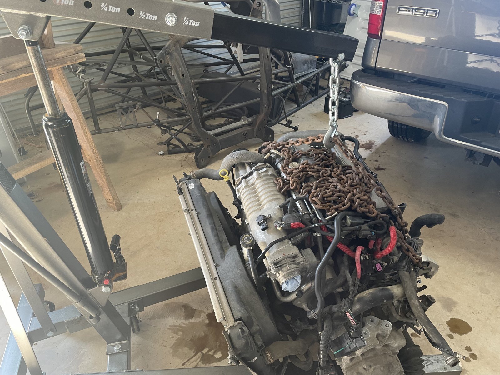

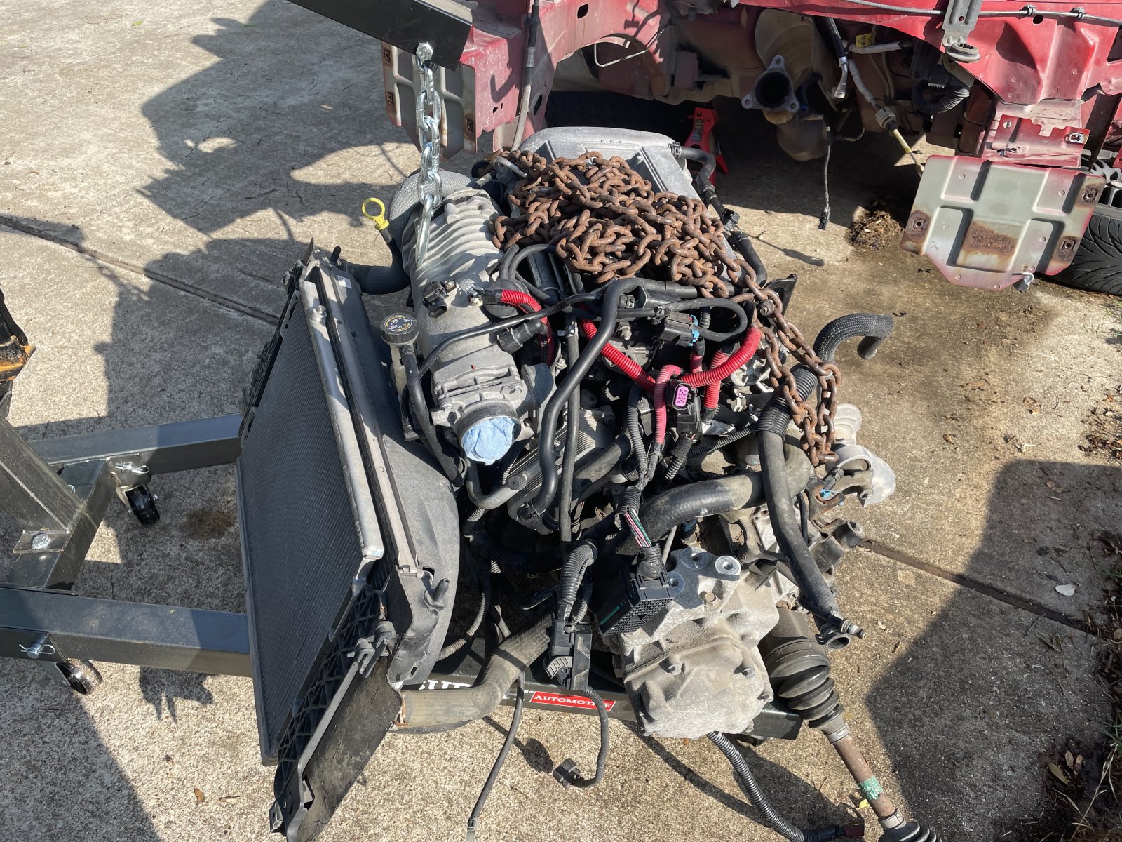

The weather and my work schedule finally allowed me to drop the drivetrain.
I then went to introduce the engine to it's new home. No, not the workshop, the Goblin frame in the background.
The fluid on the ground is from some rainwater that collected into the engine hoist.

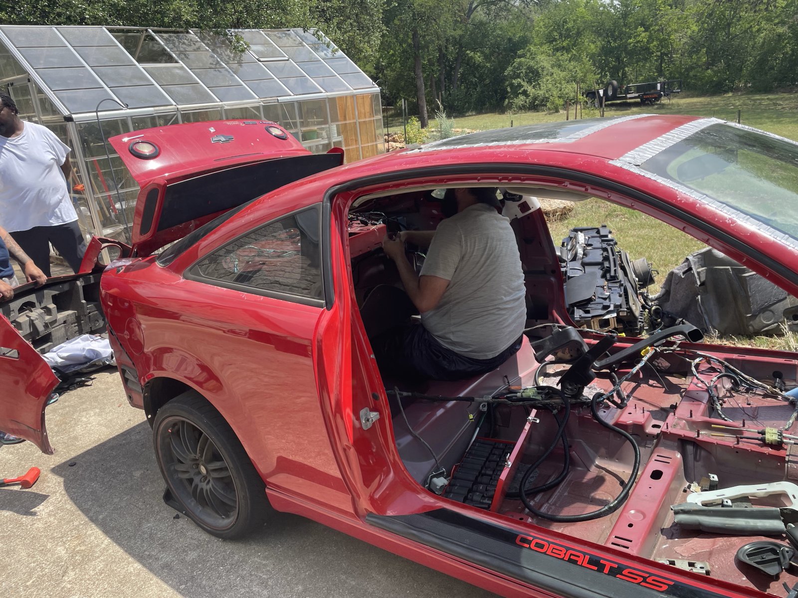

For my birthday on May 30th I asked my friends to help continue the disassembly of the Cobalt. I ended up with four extra hands and not a lot of time to take pictures.
We managed to complete all of the interior disassembly. All that's left is the rear end. The weather in Austin has been extraordinarily hot for this time of year, add in extra work at my day job and I haven't been able to finish stripping the Cobalt.

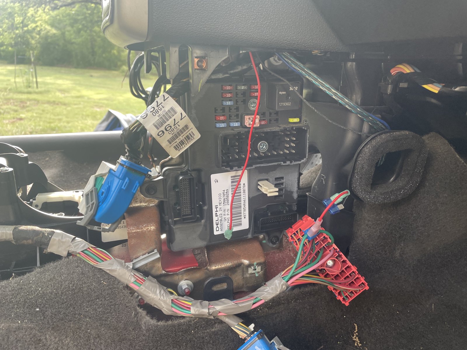

The previous owner(s) modified the wiring.
This isn't a great shot of the crew that helped me but it's the only one I have.
