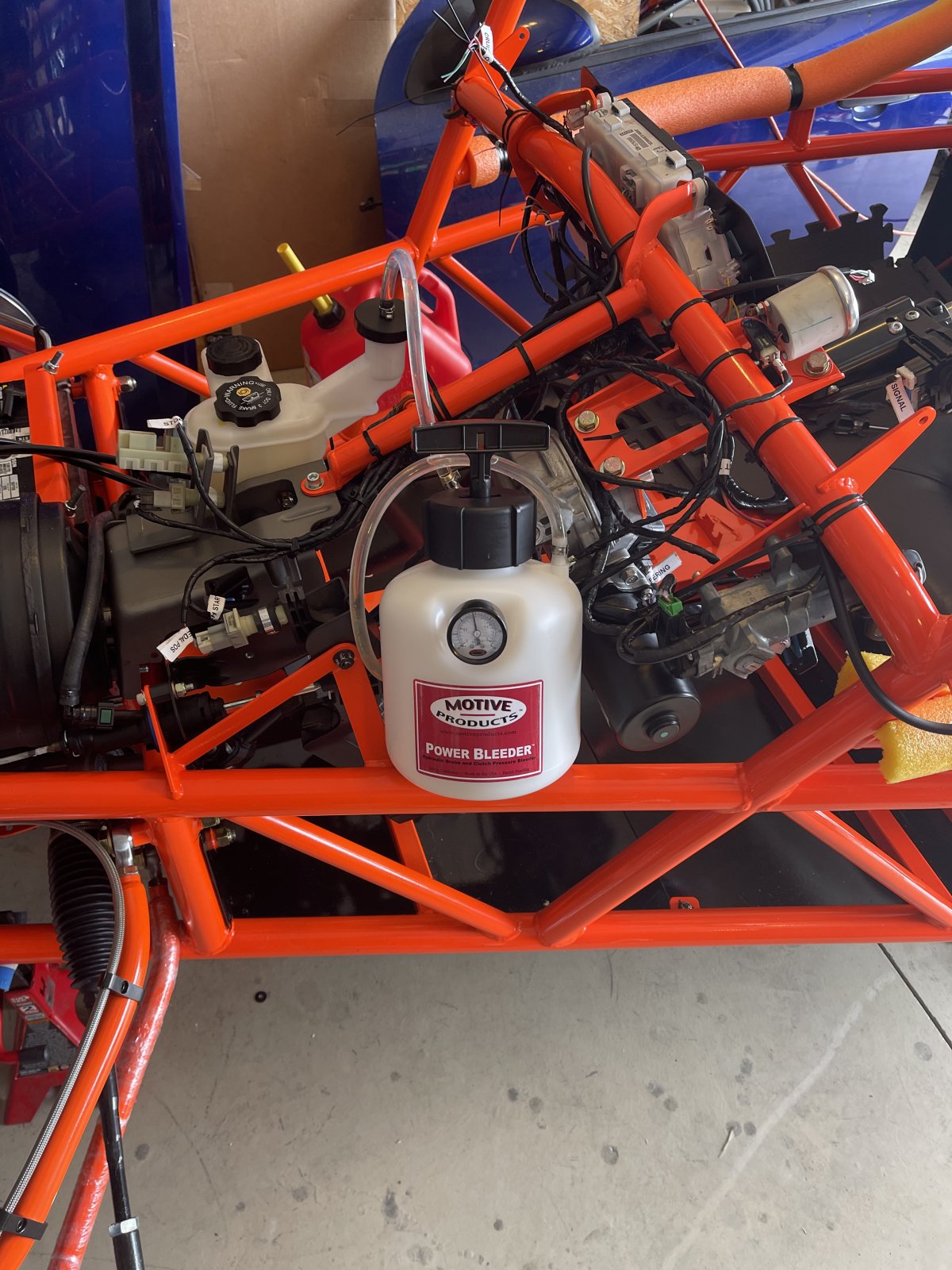

I had problems getting mine to have a good feel. I used this pressure bleeder and it was so easy and gave a great pedal.
