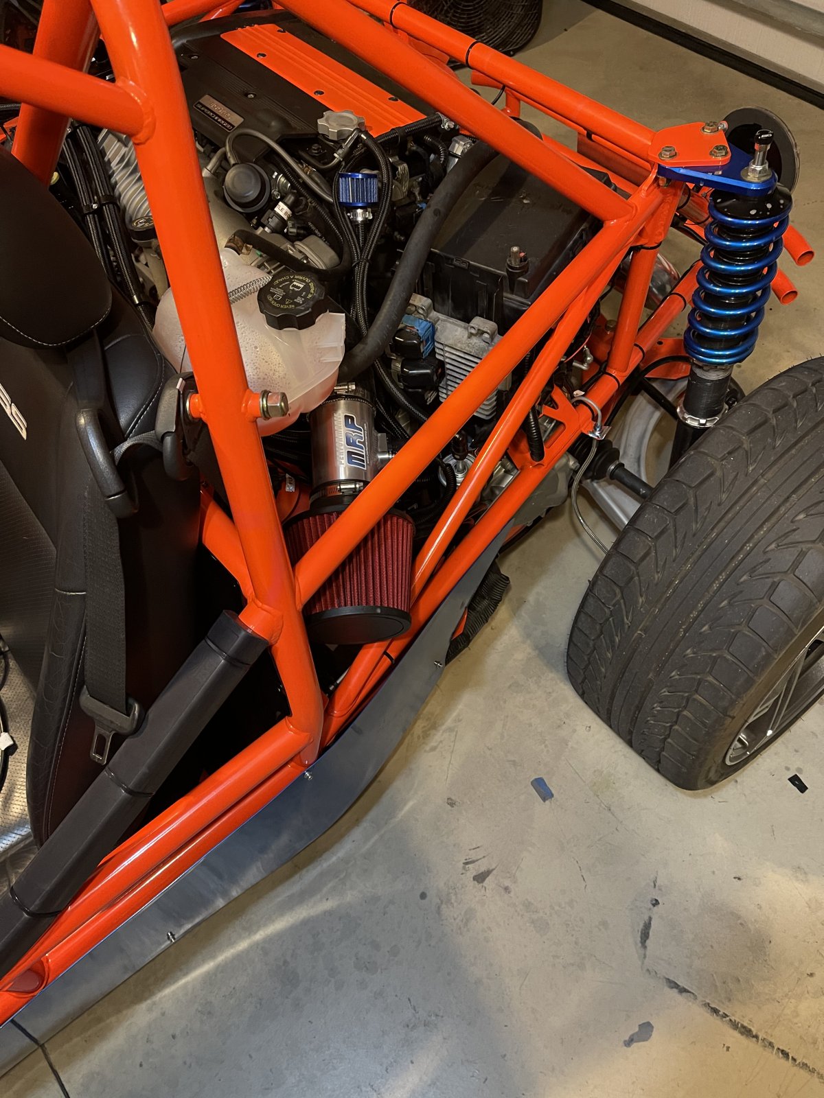

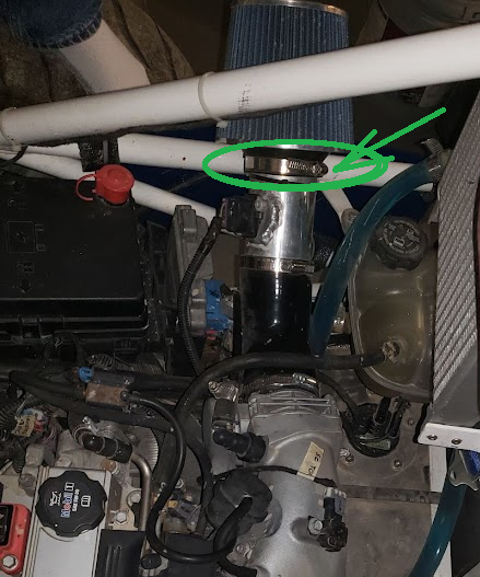

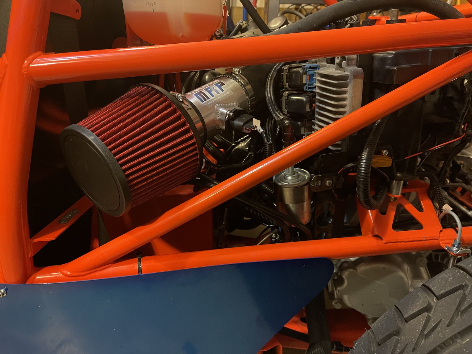

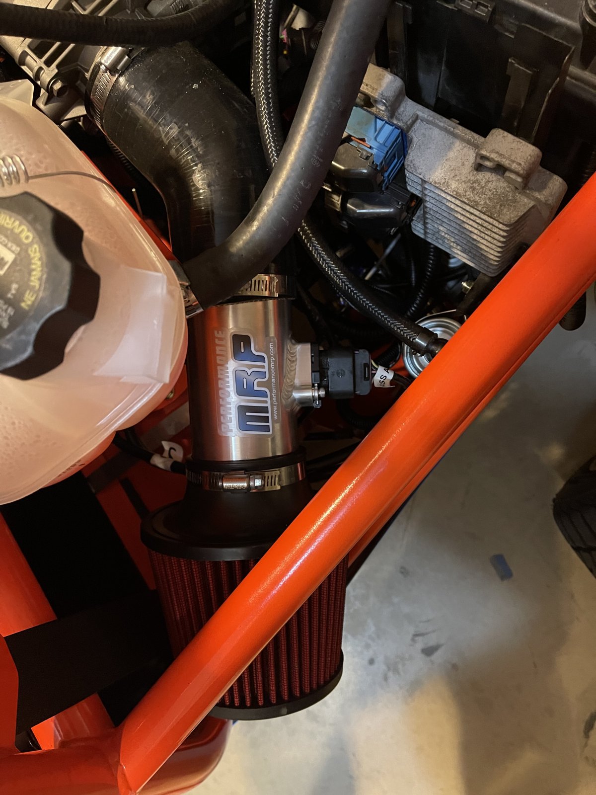

I think that I have good clearance for the filter. Your pic makes it look like more of your filter is out in the open.Jay, have you backed up the air filter as far away from the MAF as you can? A 1/2" makes a big difference. The bell housing molded into the air filter needs to flow nicely into the MAF.
I think I am still playing with angles. I am going to get side scoops made to catch more air.It is. I'll have to try your air filter position. Last position I tried took about 15% power away.
Some other positions won't even let the engine run correctly. Basically the MAF is fussy, and wants laminar air flow.
