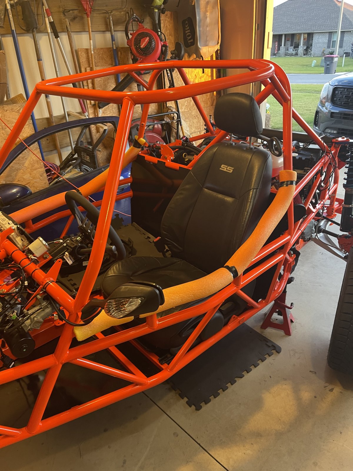

Loosely installed the tunnel cap. My M3 rivnut puller would not pull. It kept stripping out the threads. Will have to order a new chuck. I don’t want to rivet the tunnel cap. I want it to be easily removed if need be. Got the rear firewall installed and set the drivers seat in. I’m a bigger guy and am pleased to report that I was able to get in and out with out much problem.
I seem to be able to turn my headlights on with out the key being installed or turned on. Not sure if I have something worked wrong. I am getting a brake fluid light and low coolant light. Both are have been replaced with Rock auto parts. Time to read out the wires and determine if it’s a wire problem or a sensor problem.

It’s on the digital readout That says low brake fluid.

I did not have good luck with rivnuts for the tunnel cover, but tapping the pre-drilled rivet holes for M4 button head machine screws worked out great.
