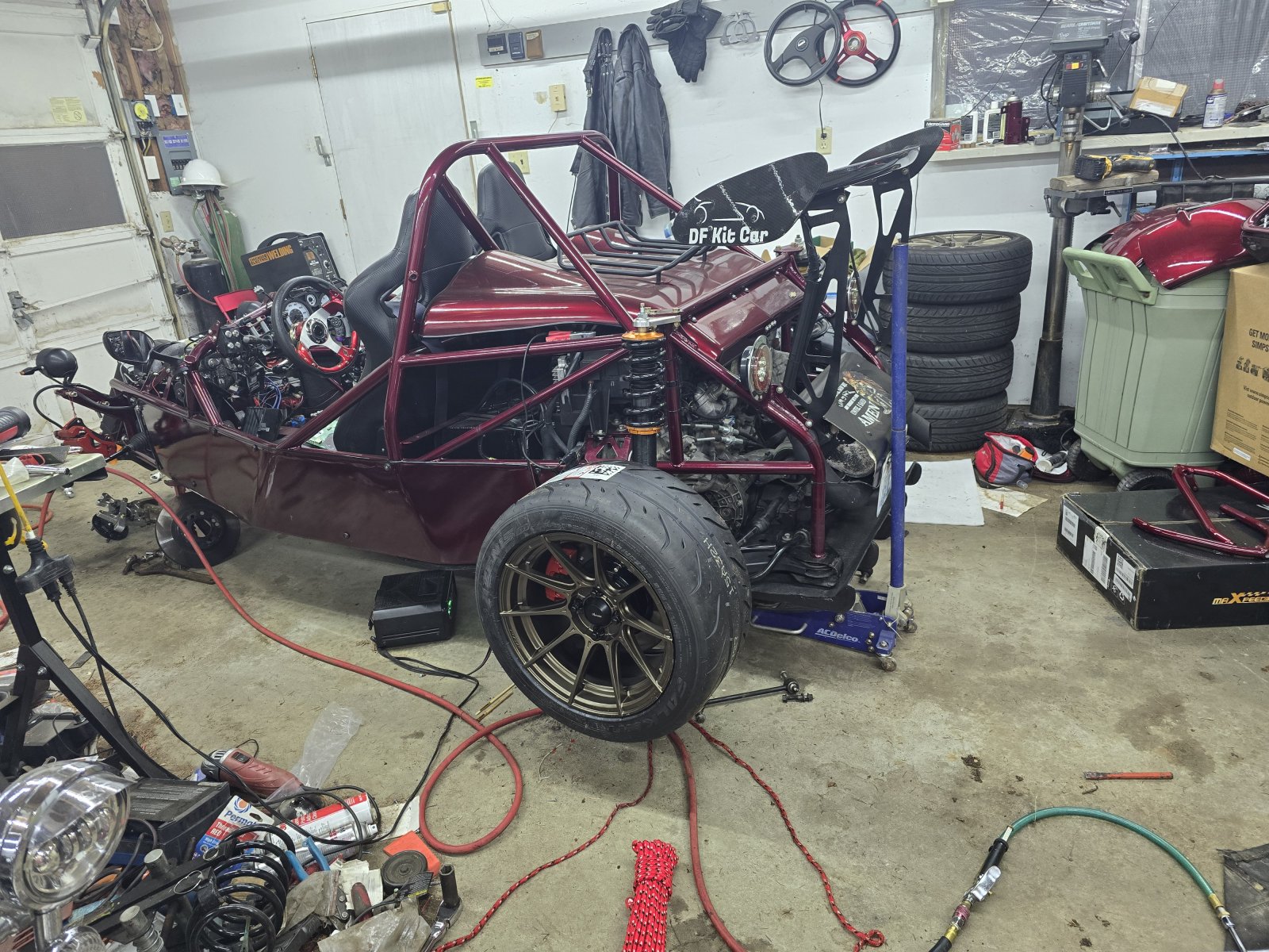

So Guess what. I get to build another Goblin. Not sure if we want to jump up for joy or .... The first was fun but we had our little problems but we sure have enjoyed every second of the drives. Now the Nest builder wants one of her own. So I have brought home another 2007 LS in a automatic. As we progress with that one I will keep you all up to speed and I think we will just share it here with the first. This one should be more fun as I am going to make the Wife do more and Me less. Which will let me take more pics to post here. So many things I wish I would have shared but I didn't think about it until I was on the other side of the project.

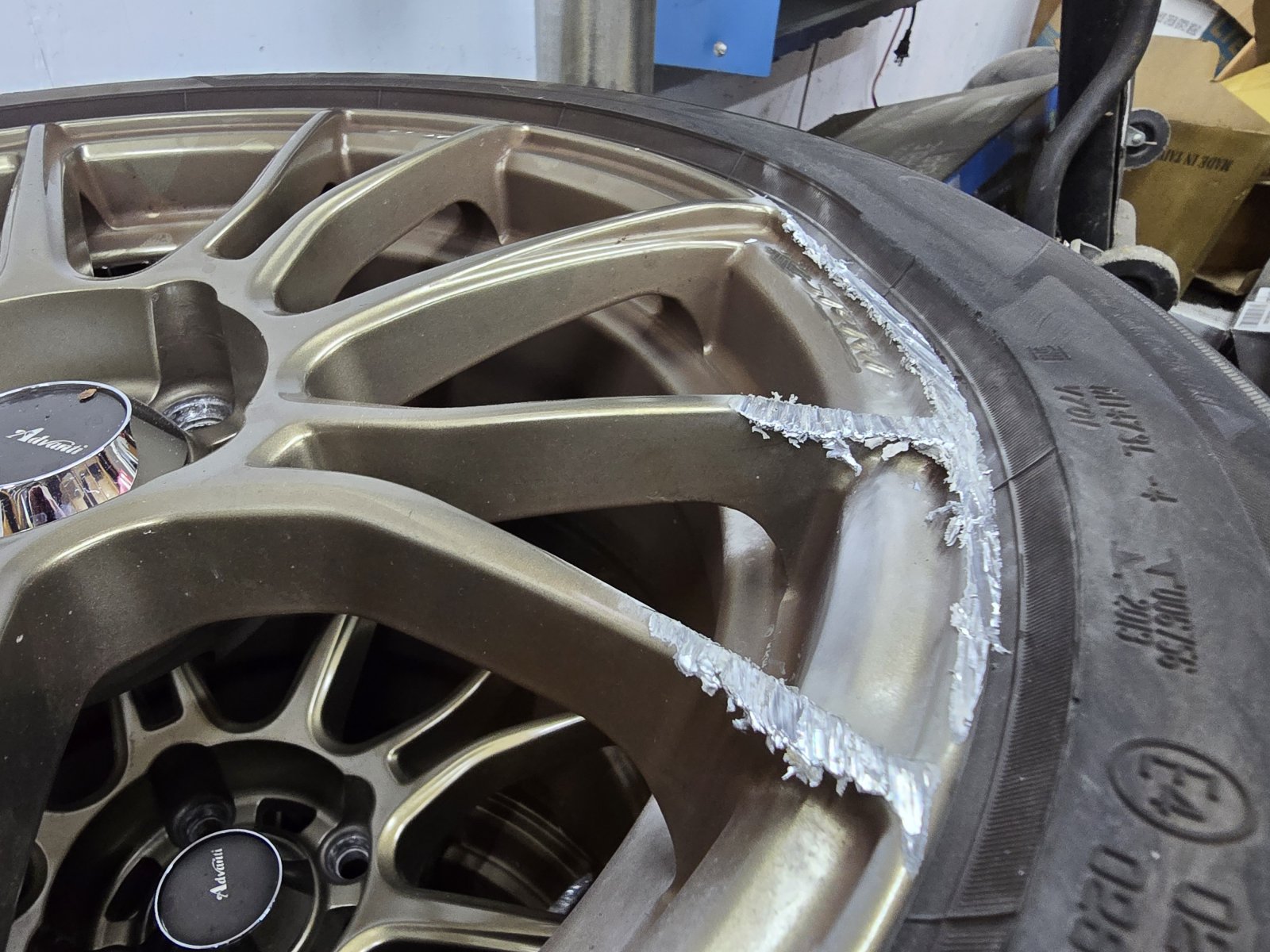

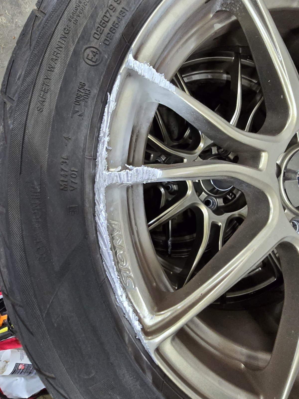

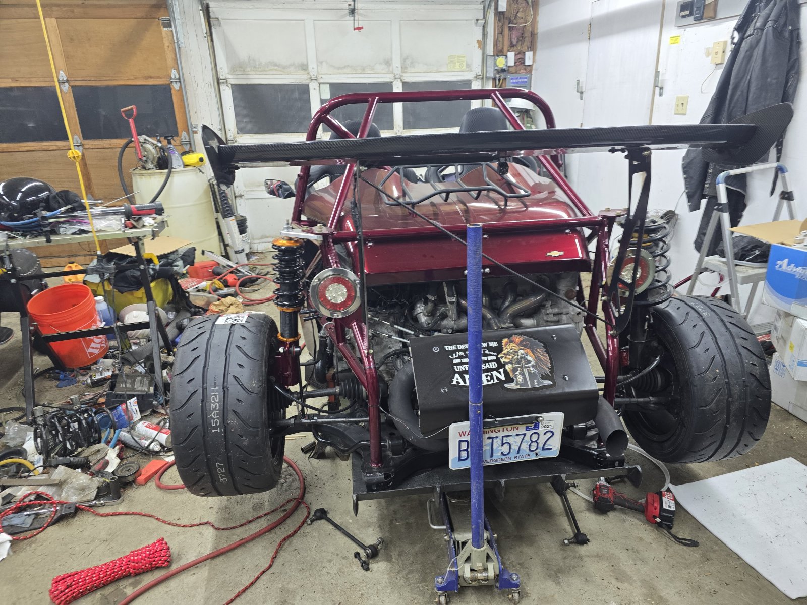

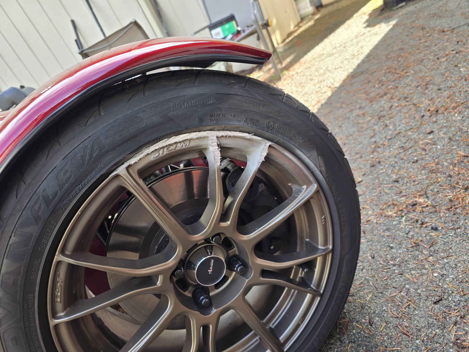

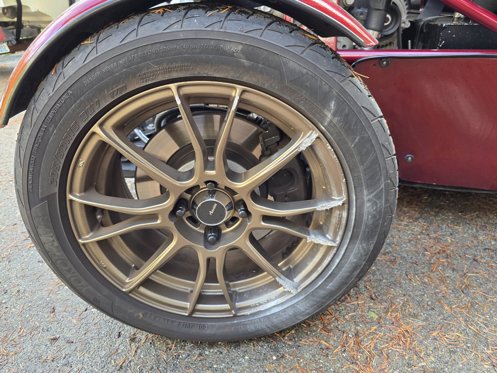

well Guys it finally happened kinda my fault but not. I got ran into the curb close to home in a double left turn lane. messed both wheels on the right side bent the control arms on the passenger side stood the passenger rear tire up so something is not right there either so have decided to replace the rear struts too. considering that the front shock compressed fully and bent the bottom mount on the control arm both the front shocks also will be replaced. The upper control arm nicked the upper bolt of the shock. on the bright side DF has upgraded most of the parts in the front and I now have a reason to do the same to chassis 188. I wanted to do some clean up work in the front because I kind of pushed through that and it need a new touch of color anyway. So here we are again waiting for parts to arrive almost feels like 5 years ago when i was just starting the build. New wheels will start to arrive on Monday and the rear upgraded struts will also be here. not sure which end for the wheels as this time the fronts a 7 wide and the rear are 9. I have been tossing over a new gauge cluster and decided to pull the trigger there as I will have the hood off and tons of room to make changes and access to wiring. As I tear down the car I will send pictures of damage and maybe do a better job of showing my work than the first time. Adam and the DF team are great as we discussed what could be bent or damaged we both agreed that certain parts may not have visible damage and so we have opted to replace.
as for the insurance company as of yesterday I told them I was done with them for further insurance needs. at this point this is all out of my pocket but we live and learn. I will give a better description latter of what happened and you will see where I take the blame but the other car that ran came into my lane and I jabbed the brakes fast used to driving truck with almost 30,000 pounds all day so I was hard on the brake pedal before I realized it I was in the curb.
So now I can now go back into the garage without feeling queasy in the stomach and get a calmer look at things. This time it looks as if I will have a 6 year old chief mechanic. My grandson is so excited as the 1st box showed up today the rest will be here over the next week or two. By the way the age old question when do we fall in love with cars. this boy has been packing cars around since he could crawl. He has so many cars he calls kit cars and it is fun to see that excitement that he gets to help Papa with his. I am looking forward to the memories.

OUCH! At least everything looks to be replaceable. No bend or twist in the frame or control arm mounts? Bet you are glad you were alone and didn't have your grandson with you - wouldn't want him traumatized and afraid to work on Papa's car. :D
Jcas

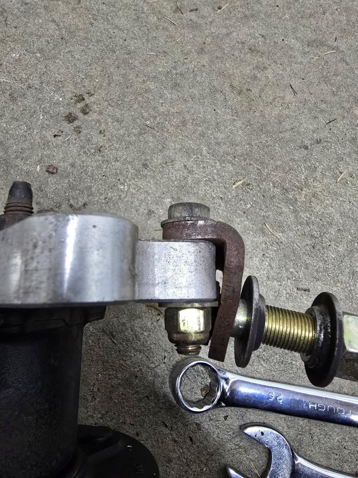

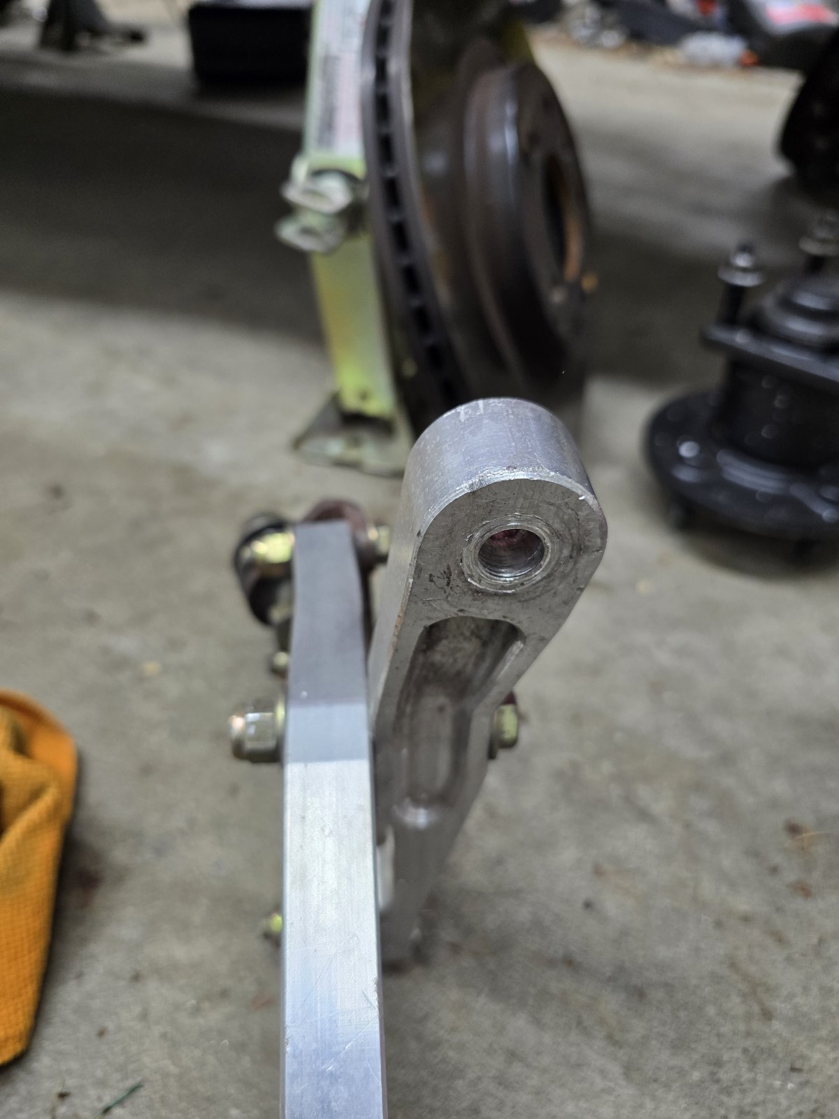

Yes i also am glad I was alone as I had to get out and pick up the oil filter for the work truck as it hit the sidewalk. So far it looks that all damage was to replaceable parts. Also don't forget that this is chassis 188 and most all front pieces thanks to a few others have been redesigned . However I did not see that bend in the lower control until I took it off and the upright was ordered only because we could not guarantee that it was safe to put on the road. The hiem joint also has play. We only guess at possible damage to front shocks and for what ever reason I can not get that one to fully extend but that is okay as we have a new set comming as well

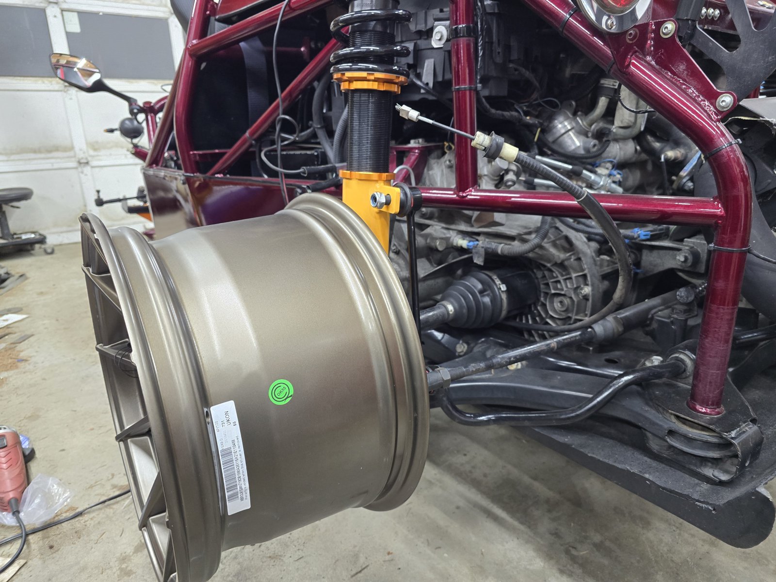

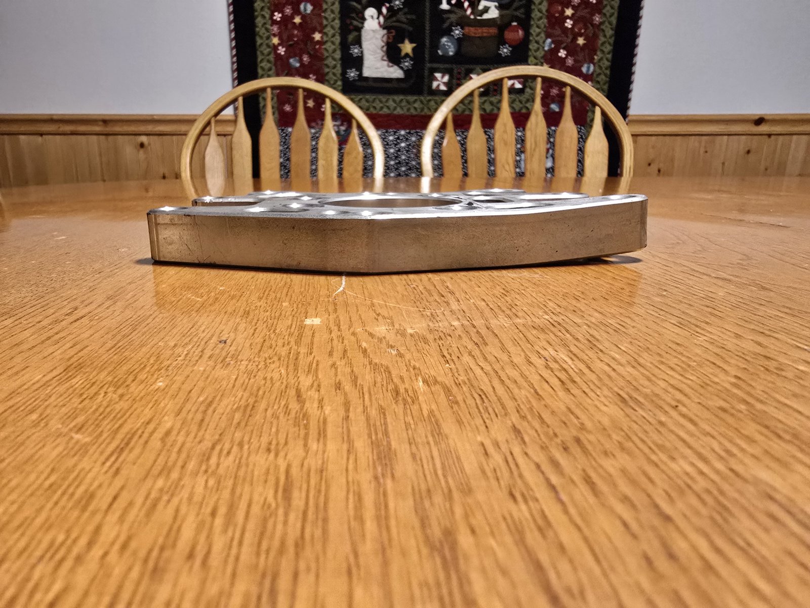

Well that nasty flu bug ran through the house shut me down for the past couple days but here is some of what I have done. Sadly like every thing things have changed. The Advanti Storm wheels I have changed style. So that means I had to buy all 4 new. Please read this the way it is ment to be heard not the way I said it to the wife. "Dang I have to replace all 4 wheels!" Then why do you need wider tires? This was her next question. Good thing we don't have a dog house. But you can see we are now sporting a new set of 245/40ZR 15 Falken Azenis RT660 for the rear and a set of 205/50ZR 15s for the front changed rear struts powder coating old front spring in black for the front shocks. Tons of clean up and repainting. I will do my best to keep you up on what is going on have new tunnel cover and both upper and lower control arms headed to the powder coater on Monday because of bug and weather slow downs.

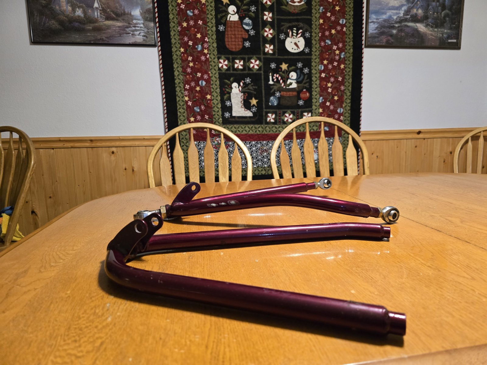

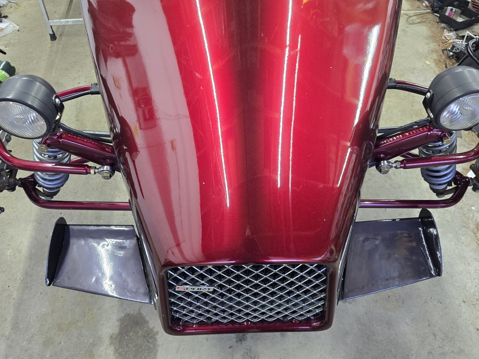

Okay guys I have searched and searched for the front suspension intall vids and I can not locate them even on YouTube. Really all I need is the torque specs and how many turns out to start with on the Rod end joints. There has been tons of water under this bridge since my build and I just don't remember i know that they where very close when I went into alignment.
If I remember correctly, DF's video said to leave the rod ends out 4 turns, both top and bottom. When I did a quick garage alignment, the bottom A arm was tucked in tight, and the top A arm was about 12 turns out. A digital angle finder is inexpensive.

I just remember it gave me a great starting place and about an hour of playing pretty much had it. Fine tuning and rechecking more fine tuning should be good to go.
So far almost have the drivers front back together there are different parts so it has been a bit slow but I had not completely disassemble one side so used it as template to install the new parts.
