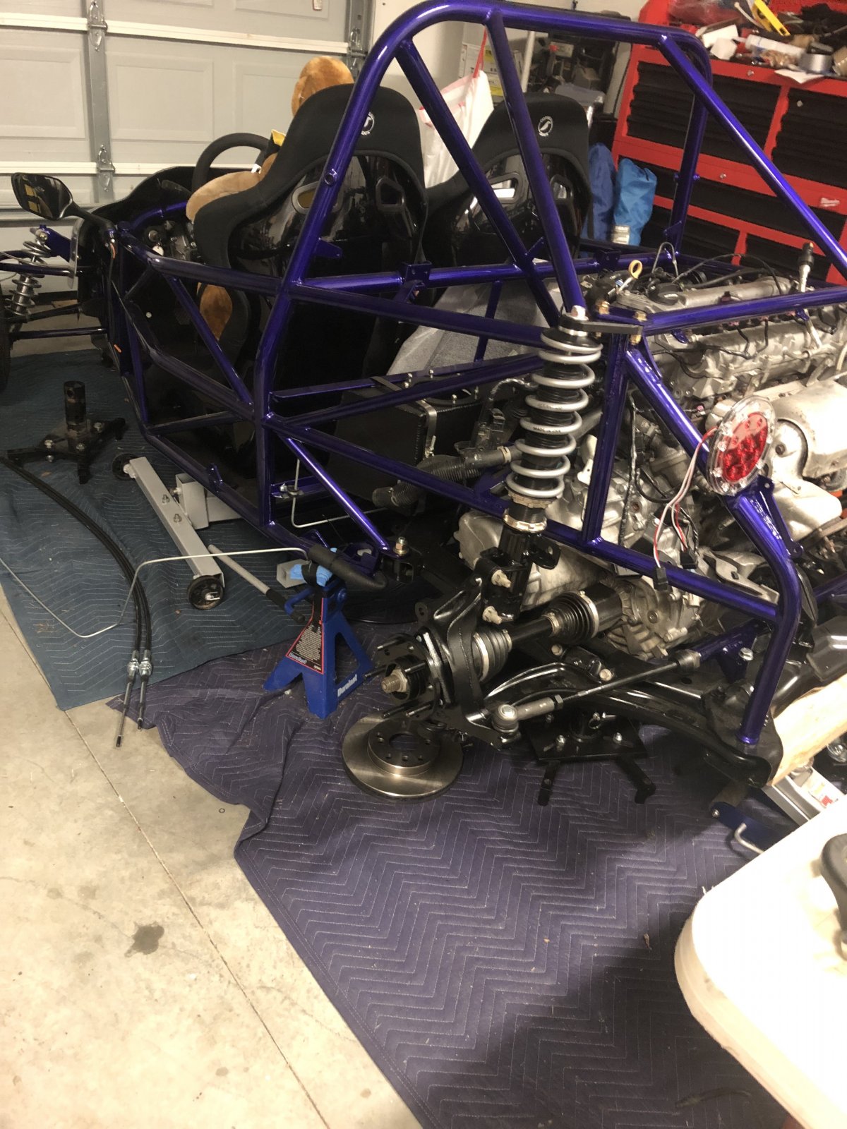

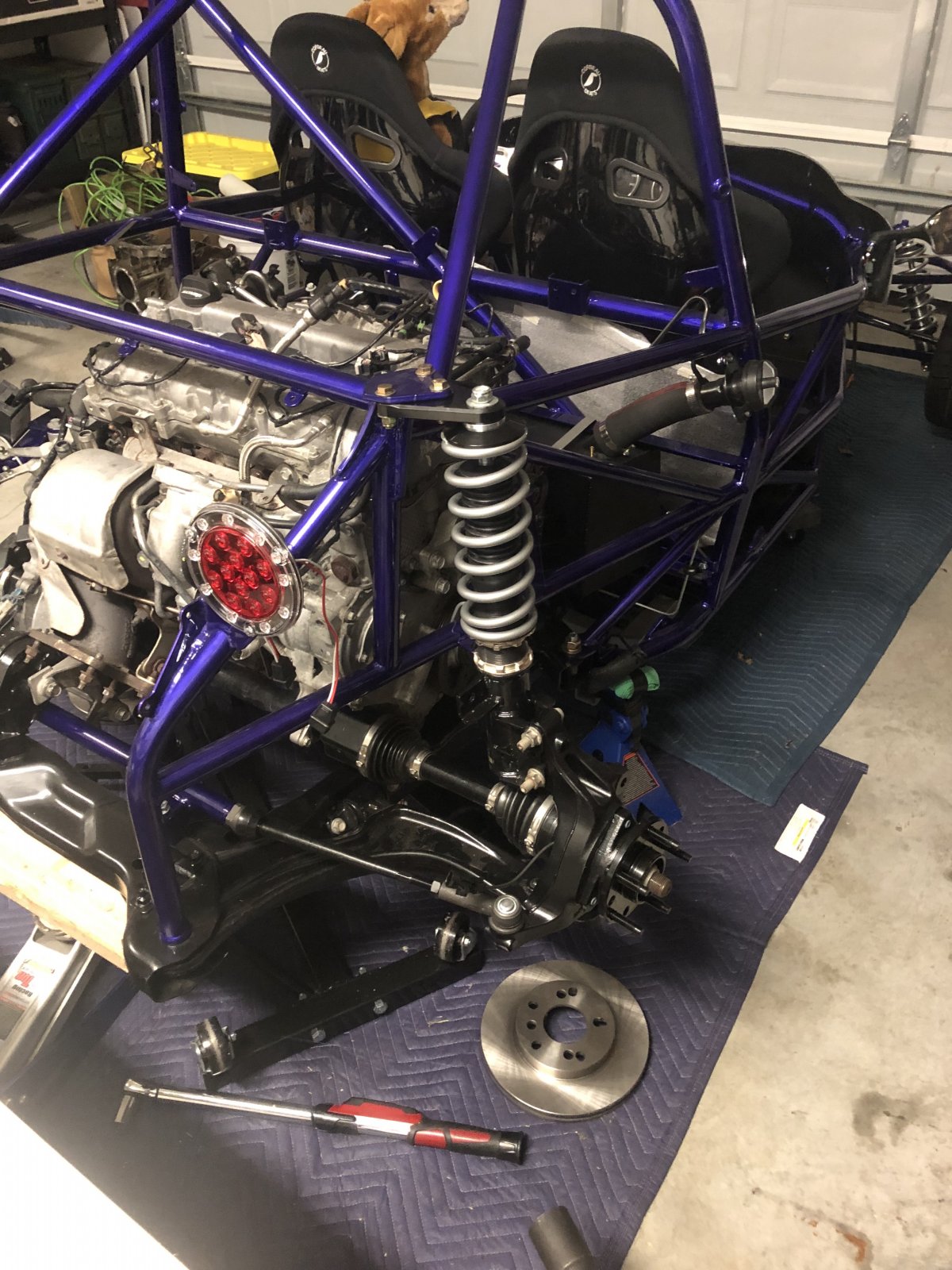

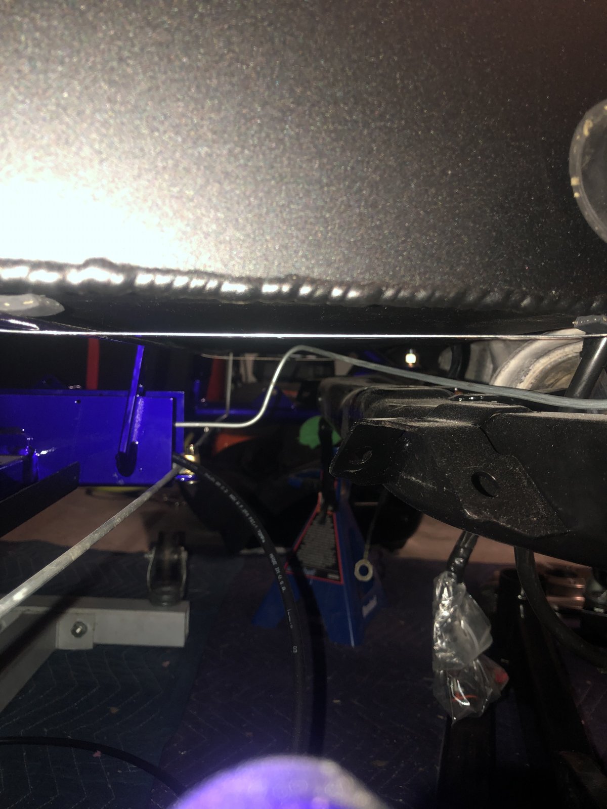

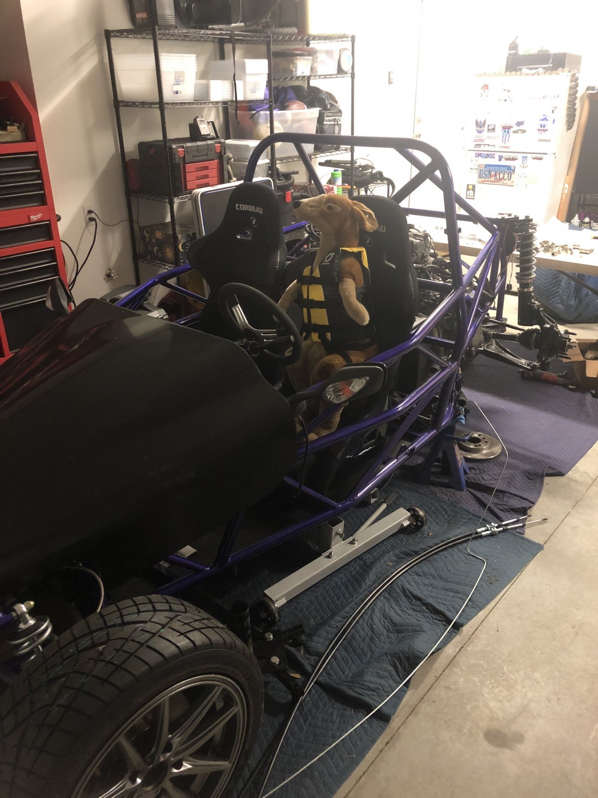

hey so i'm jeff's roommate and i'm helping him with putting this thing to together cause he been slacking lol. but does anyone have pictures of the clutch line going from the master cylinder going to the slave cylinder . i don't want us to continue on then find out we gotta back track because he didn't put the line in sooner. but here the progress we made on the rear suspension tonight. its going to be torque all down tomorrow and make sure we set the coil over up properly. btw yes that is a kangaroo his name is randy and he has a instagram @randyrogerroo

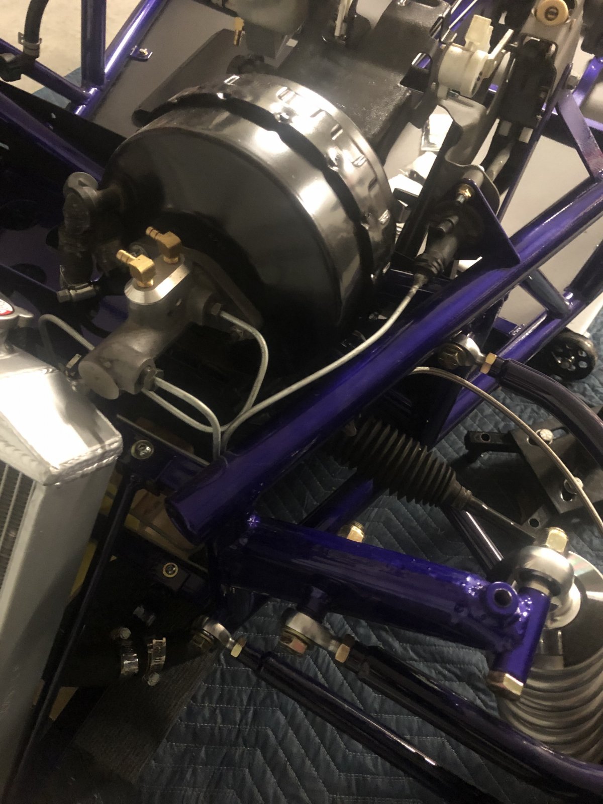

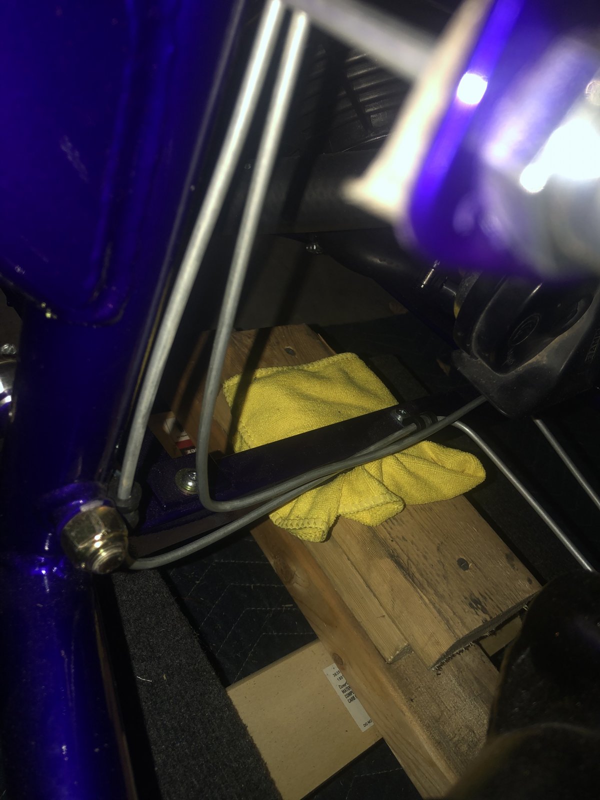

You can work the clutch line in place but it is definitely easier before you install the engine.
You will need the tunnel cover off and the seats out of the way.
In the front the clutch line follows the same path as the bake line.
In the rear the clutch line goes between the subframe and the fuel tank and then up between the engine and fuel tank.
As you work it through the frame it will straighten some of the bends so once it is in place you will need to correct the bends. It is easy to do this with your hands.
This is also a good time to place the two heat exchanger tubes into the tunnel.
The short bends go to the front and the longer bends is in the rear. There should be a couple of short 90 degree bends in the front to follow the frame.

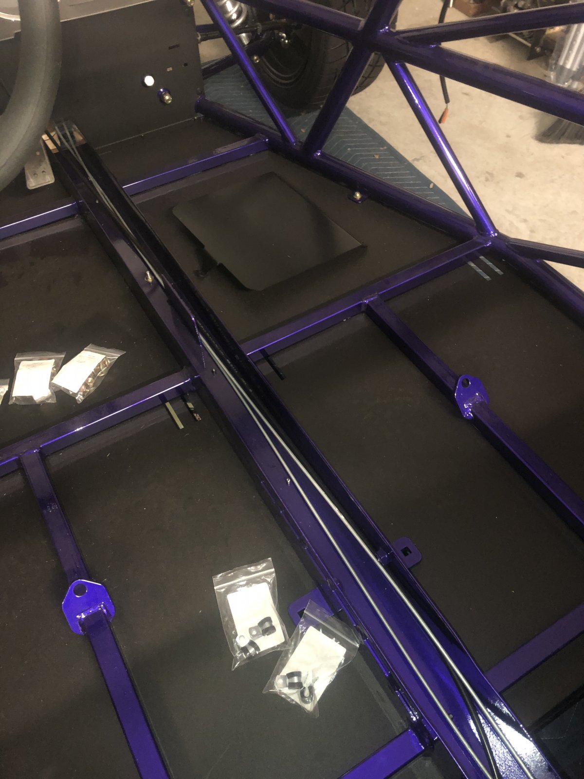

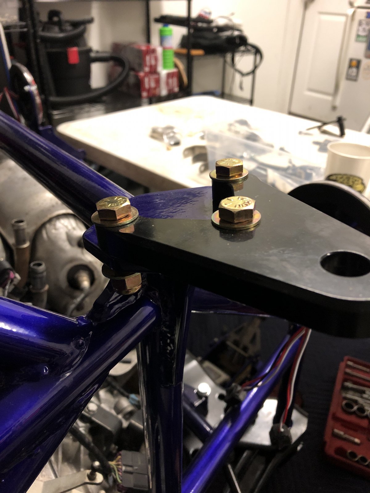

So I’ve gotten it feed thru. But where do these 4 Mounting clips go or do they where every we feel like putting them?

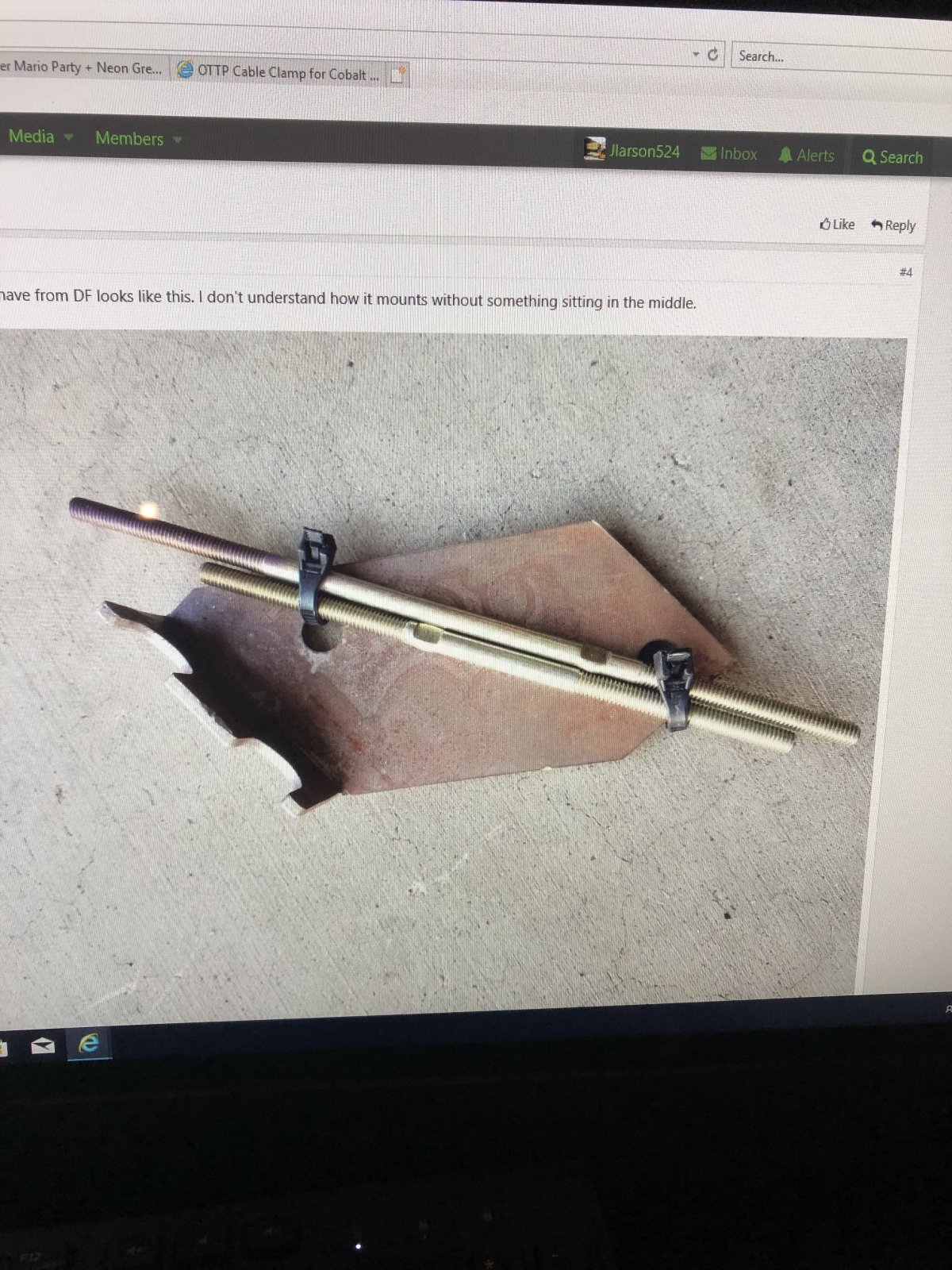

Are these parts supposed to come with the kit? I’ve looked everywhere and don’t think I received them.
