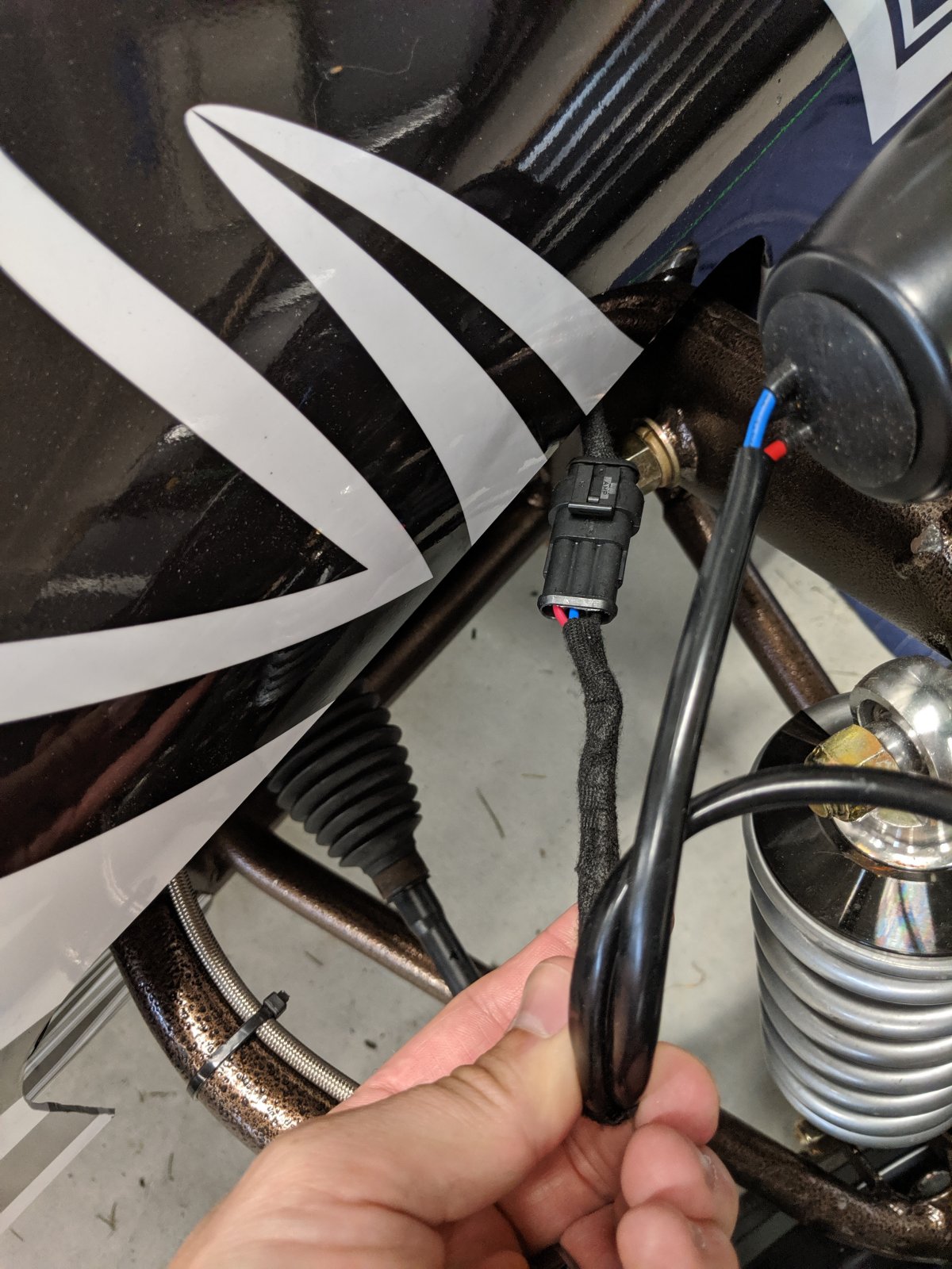

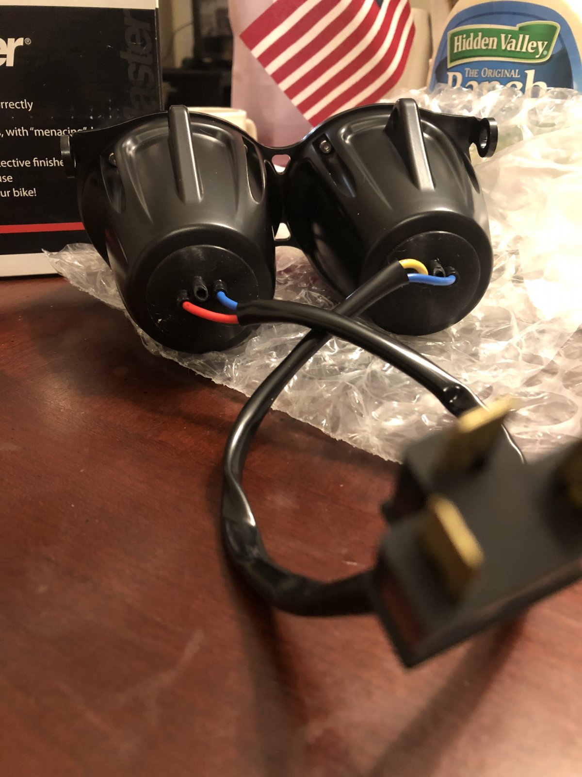

I have purchased the dominator 2.0 headlights and they have a different wiring. Just curious if someone running them could tell me what goes to what
Those are different! Sorry, I thought I had Dominator 2 headlights, but I must have Dominator 1.
They only have 2 wires per bulb... and a common blue wire. Probably blue is ground.
I bought a pair of connectors off amazon and spliced them in. There are only a couple wires...high. Low and ground. Just connect power and go from there.

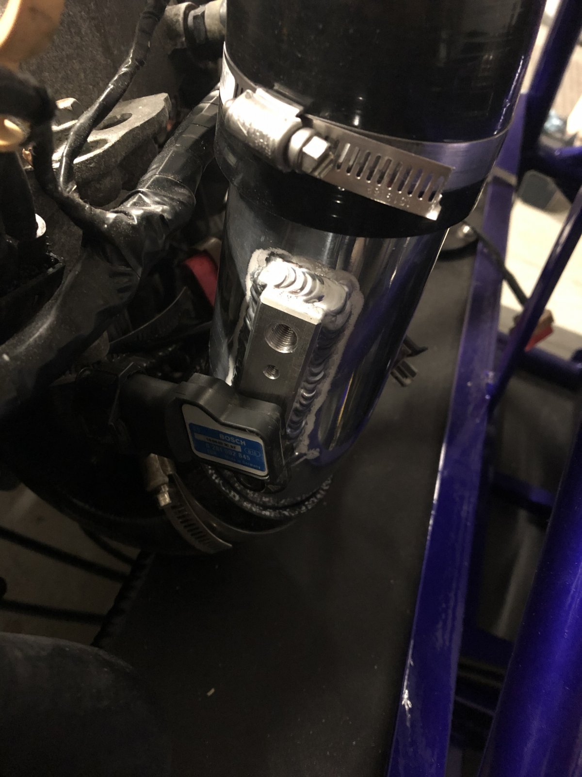

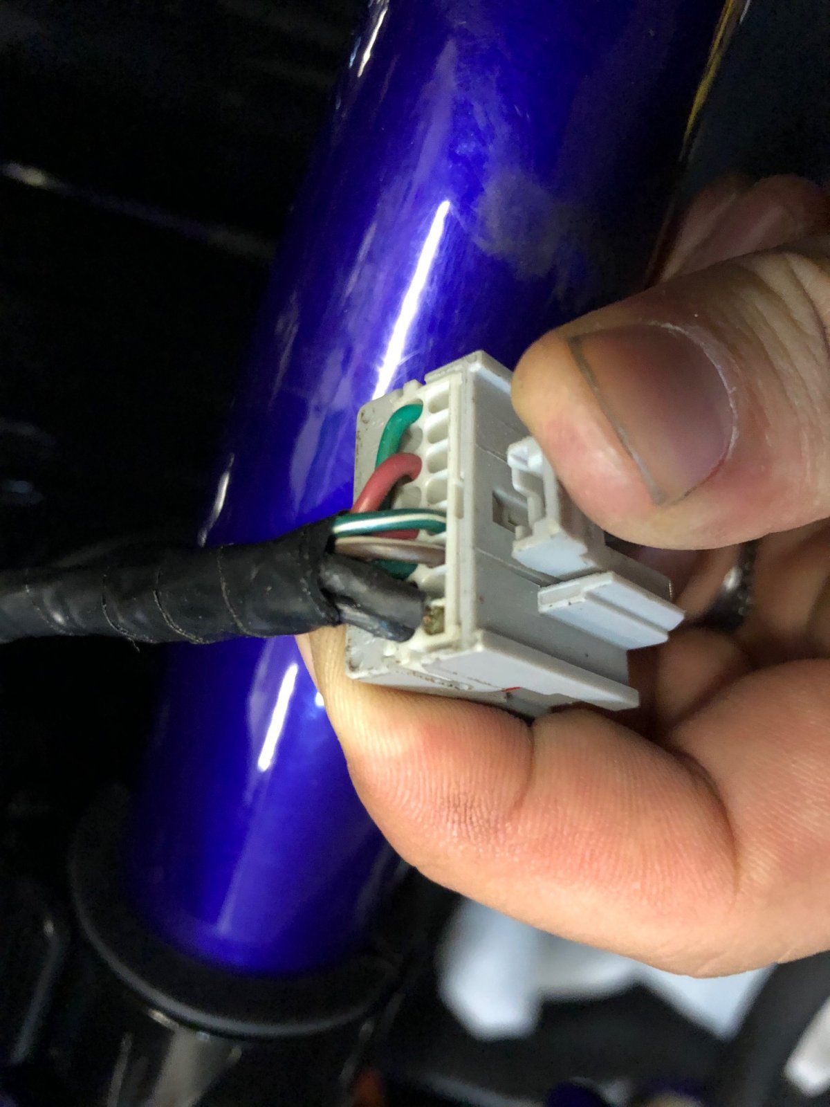

Jlarson524

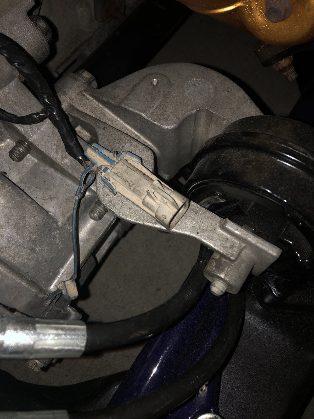

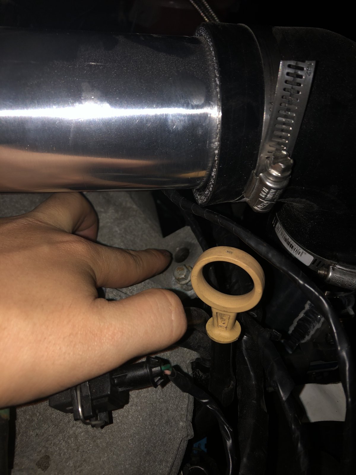

What goes into this vacuum hole? and what plugs into the plug in the first picture?
Karter2026
Pic#1 downstream o2 sensor You wont have one unless you are running a cat
Pic#2 From what I can see looks to be where the TMAP sensor on supercharged intake manifold

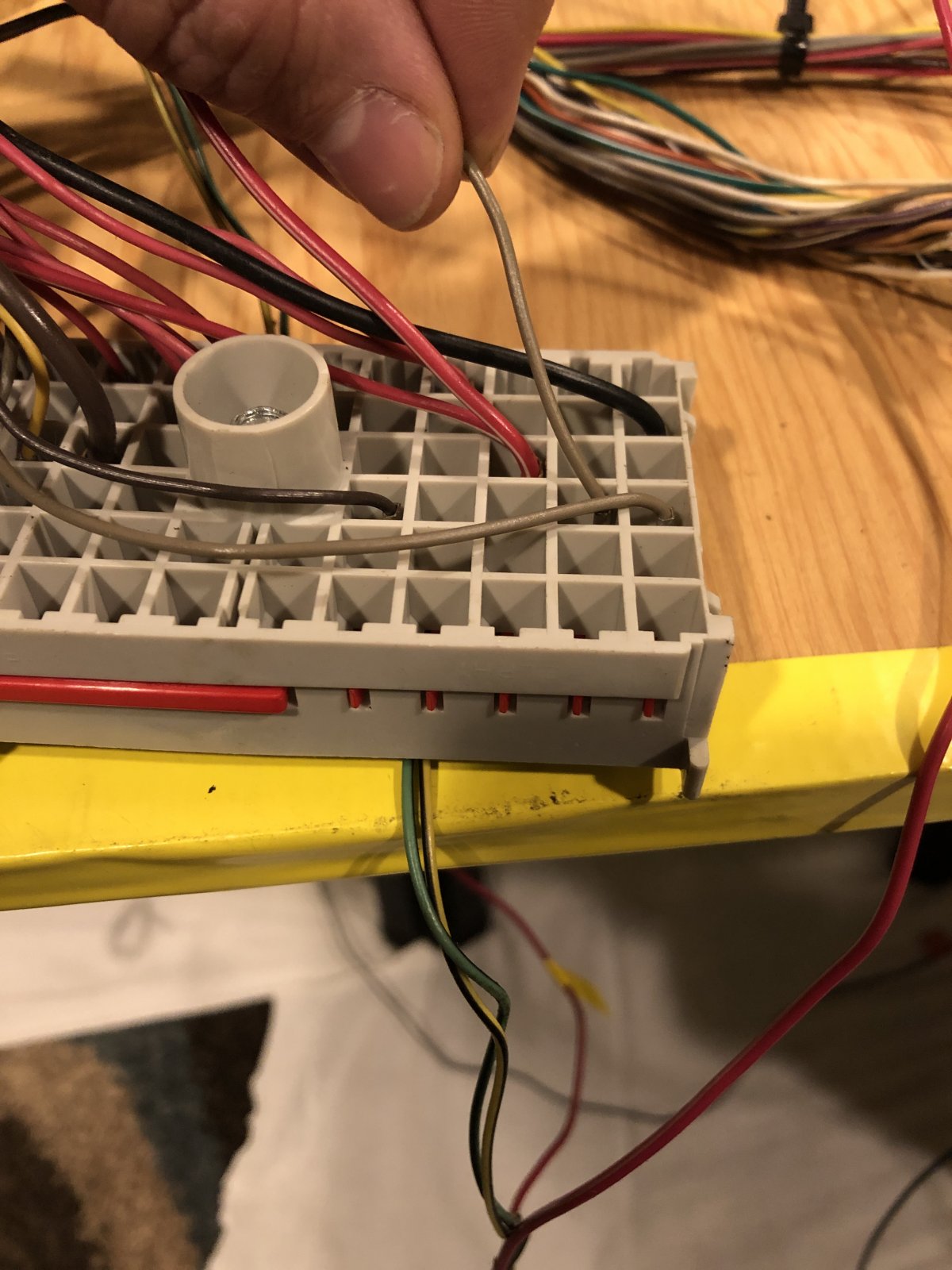

Can anyone tell me what this bottom right wire goes to on the instrument cluster? It looks like its breaking. At the moment the speedometer isn't working and I am wondering if that wire could be the culprit.

mnKevin
It’s possible, it’s a gray wire that connects multiple functions like hazards and fog lights. Connects to white bcm plug
