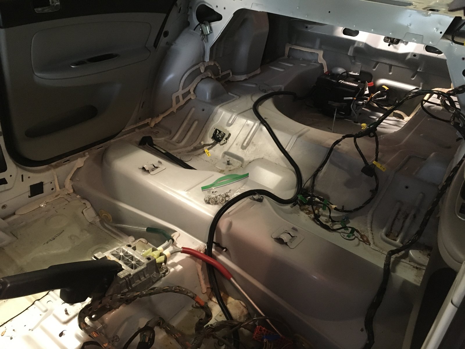

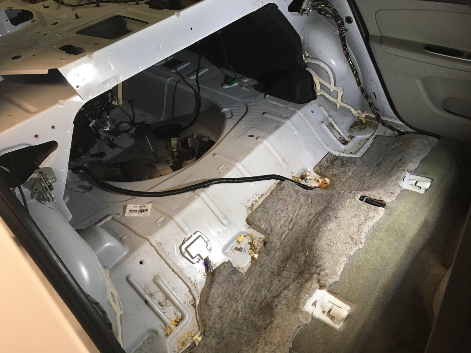

rear gutted

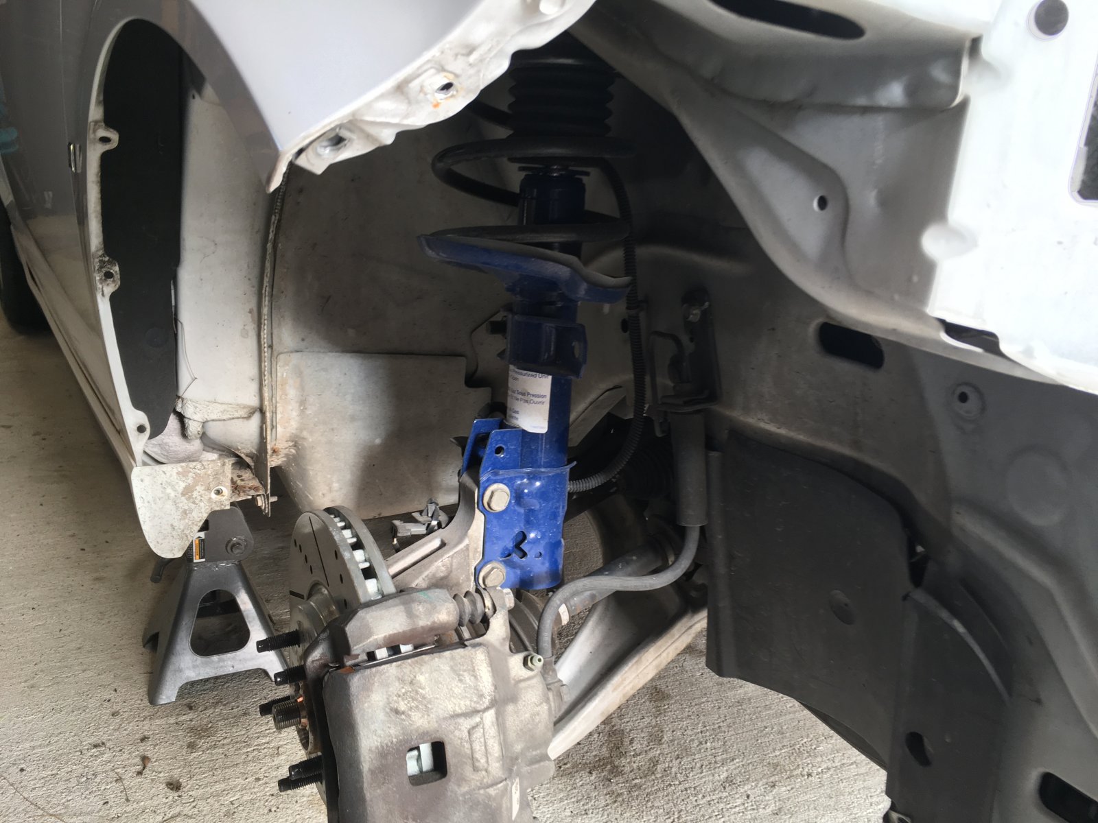

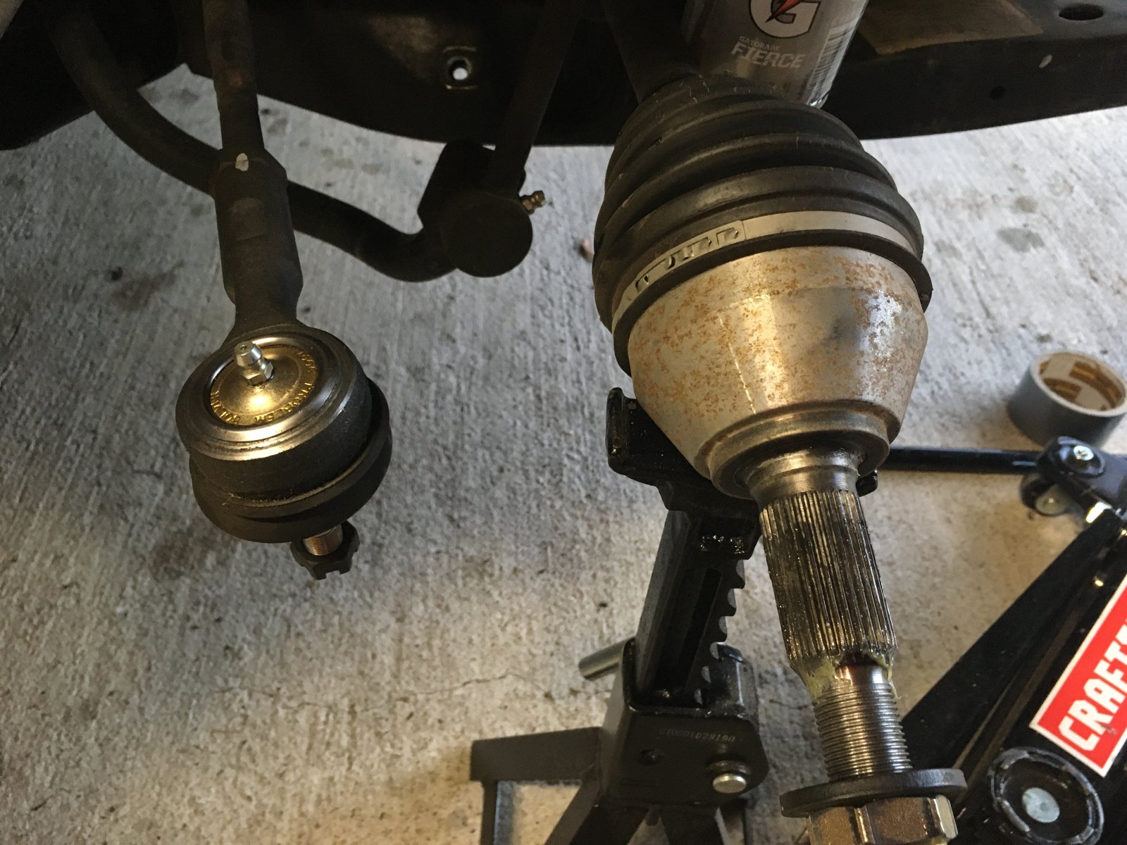

Got the front end on jackstands and started pulling the suspension and steering parts off. Had to stop as needed a 30mm socket for the axles but everything is clean and rust free so hoping for no surprises.

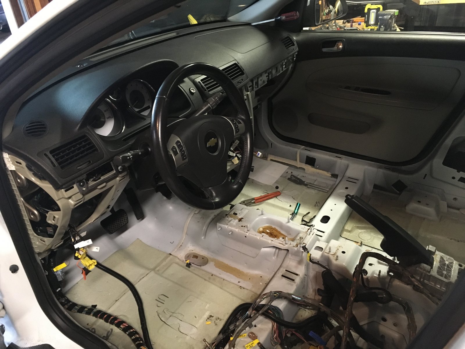

Waiting for Axle nut to arrive so started picking at the dash and pulling the fenders and releasing all the body wiring. Huge PITA was getting the front driver and passenger door harness plugs undone. needed like 4 hands to be inside and outside the car and push and rotate levers all at the same time. Done so that will not bother me again.

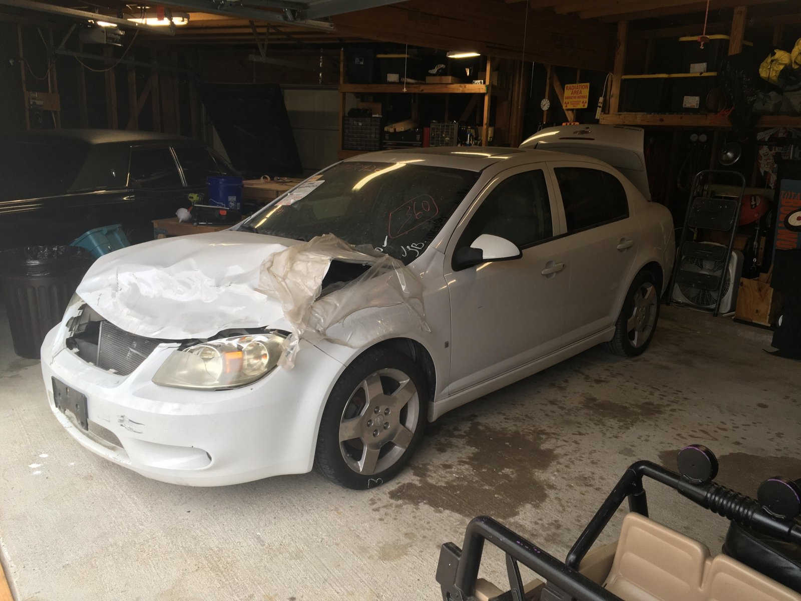

Next step is pull the subframe and try the lower the front end onto a dolly and lift the chassis off the motor. Roll the car forward, set back on jack stands (all 4 corners, and disassemble the rear)
I do have one question for the audience. I cave a California car with the California emissions, I saw in the video that my fuel pump could be on the bottom of the tank. Is there a visual indication of this? If I need to buy a new fuel pump, do I need to pull the tank at all? I will keep the EVAP system as I am in Texas.
Later.
You will need the evap to pass inspection. Never heard of a fuel pump being on the bottom. If you scrap the body, the fuel tank will have to be out of it anyways, so might as well pull it.
on a side note, you’ll need to keep the title to the cobalt to get the title to your goblin. If you scrap the cobalt, they will want the title. This could be a problem.
Brett
When I was done with my shell, the wife took an add out on facebook marketplace, "free car shell, no title, must haul off" I dont have a truck so I would have to rent a trailer to scrap the shell myself. Given low scrap metal costs, I figured it was just a wash in order to keep the title.
Took about 24 hours, but a guy came in from Brookshire, took the shell, didn't say a thing about the title and left. I felt like it was a win / win for me.
My son, 6 at the time, took apart about 90% of the interior (excluding seats / dash). I know he had a blast. Hope your kids are enjoying it too.
Cool. That’s probably the best way to do it. I just try to remind the Texas folks that you’ll need the title to the doner or the dmv will have a fit.
Goblin Graber
I followed Brett’s advice and had my donor shell gone in an hour with a Facebook ad. All I had to do was backup my trailer to his.
Idk about Texas, but here in Montana you absolutely don’t need a title to go take a vehicle to a steel recycling place to get it crushed for cash. It’s one of the reasons vehicle theft is so bad in Billings.
Here in TX or at least in Houston, you have to have the title for the scrap yard to scrap an entire body. I know this as 100% correct. I know some have got by with it, but the “rules” are that you have to have a title to scrap it.
after messing around with several scrap yards, I ended up cutting mine into about 20 pieces and sent it in a little at a time with other scraps.
pisco
here in NE if it’s a “car” the the junkyard wants the title. If it’s stripped and for scrap metal only they don’t care.
Maybe rules or maybe since no vin parts can make it back to them they turn a blind eye and drop it in the shredder.
Joebob
No problem. I will gut the rear and drop the tank and the evap stuff...and keep the Title.

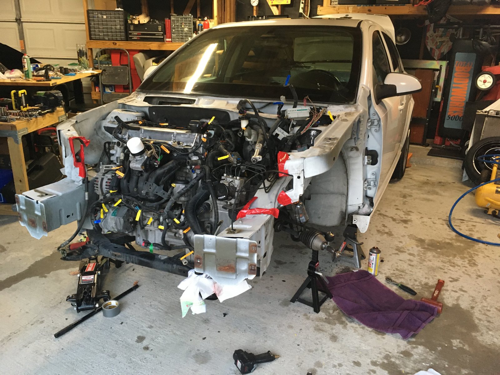

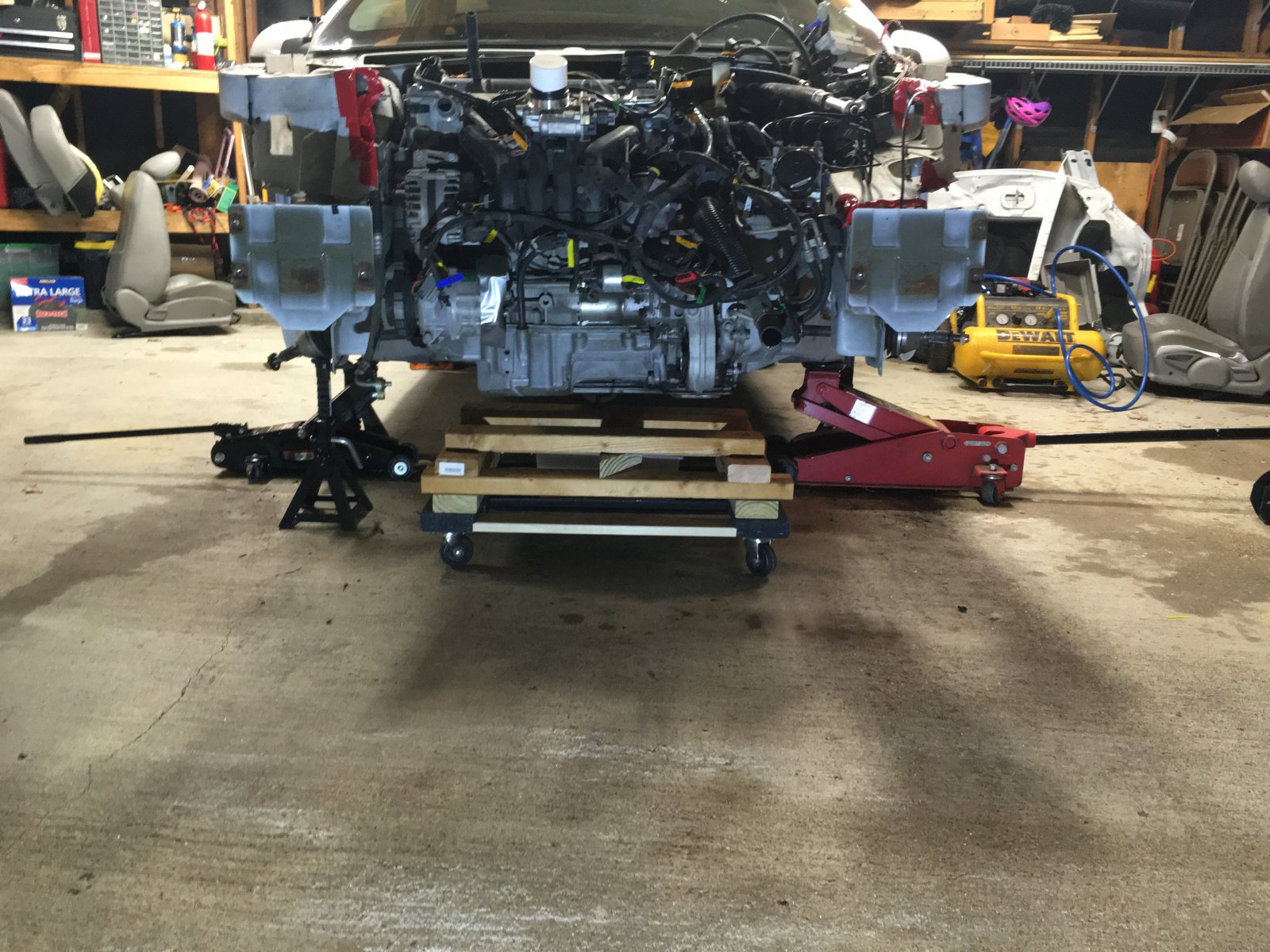

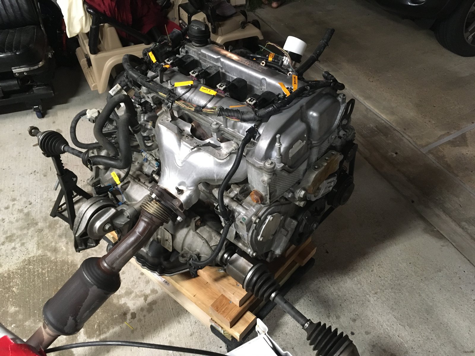

Milestone yesterday! Engine removed!

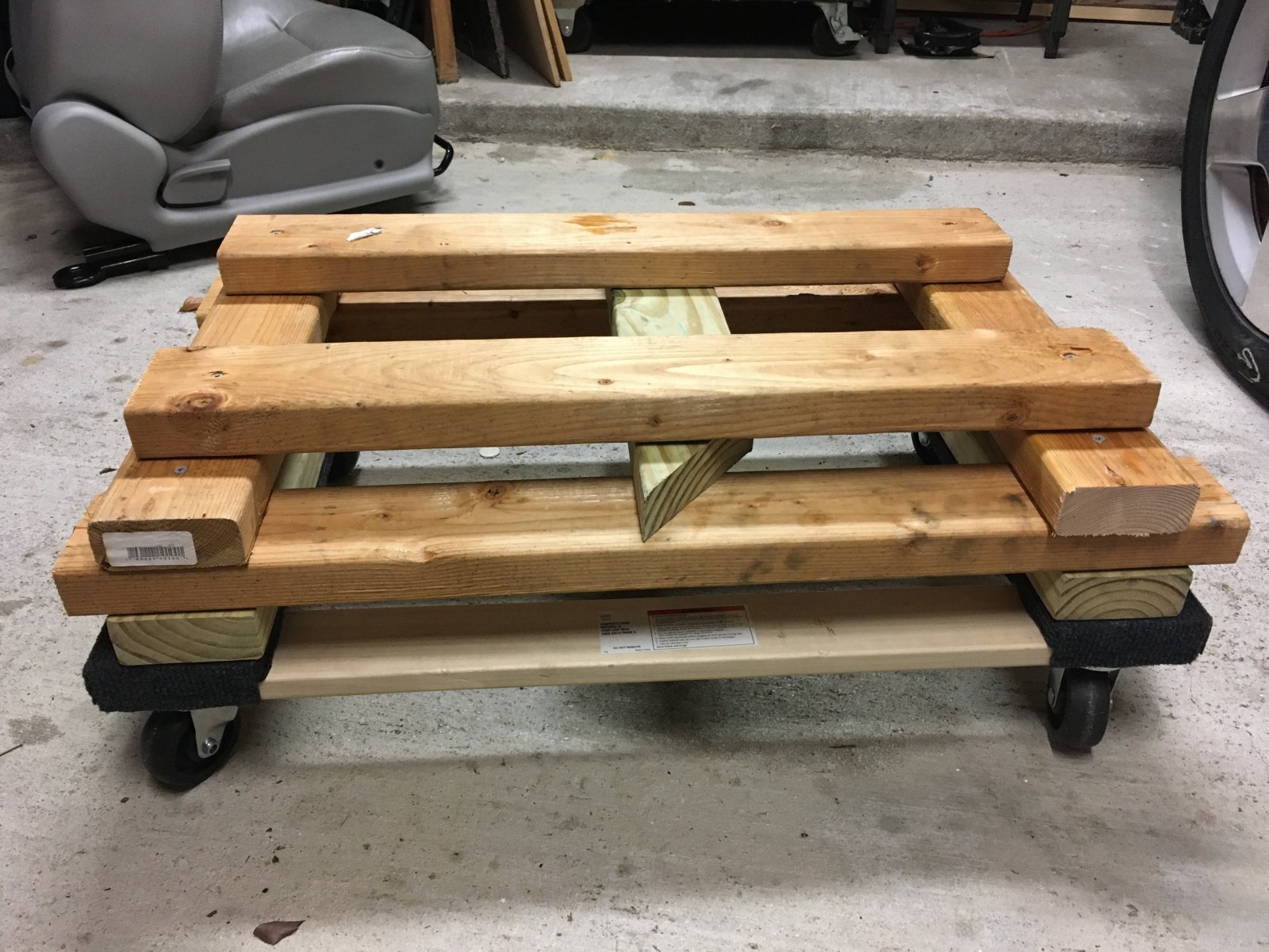

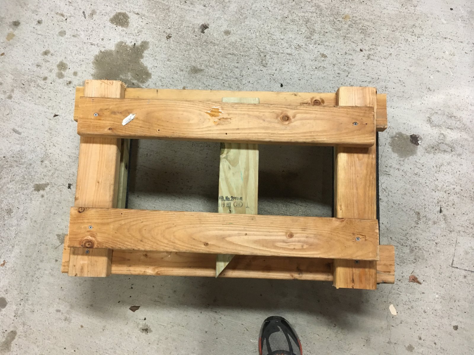

Took a 30"X18" harbor freight dolly and stacked some scrap wood to build up the height.

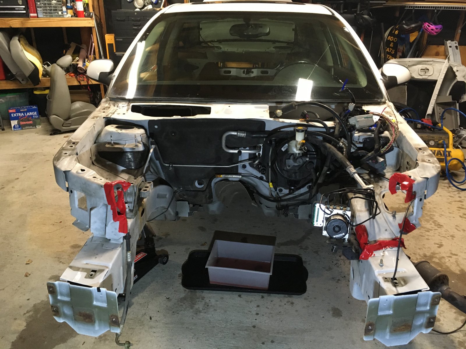

Slid the dolly under the engine. Raised the car up on two floor jacks to remove the jack stands. Lowering each side 1 inch at a time, I walked the chassis and motor to the dolly. Kept weight on the jacks and undid the side motor mounts. By the way, the rear is still on the tires at this time. Jacked the chassis way up for the engine to clear the front flanges and...
She rolled right out. Now to finish stripping the firewall and dash. After that, I will put skates on the front and roll the chassis toward the front of the garage to jack up the rear to drop the tank and rear hubs.

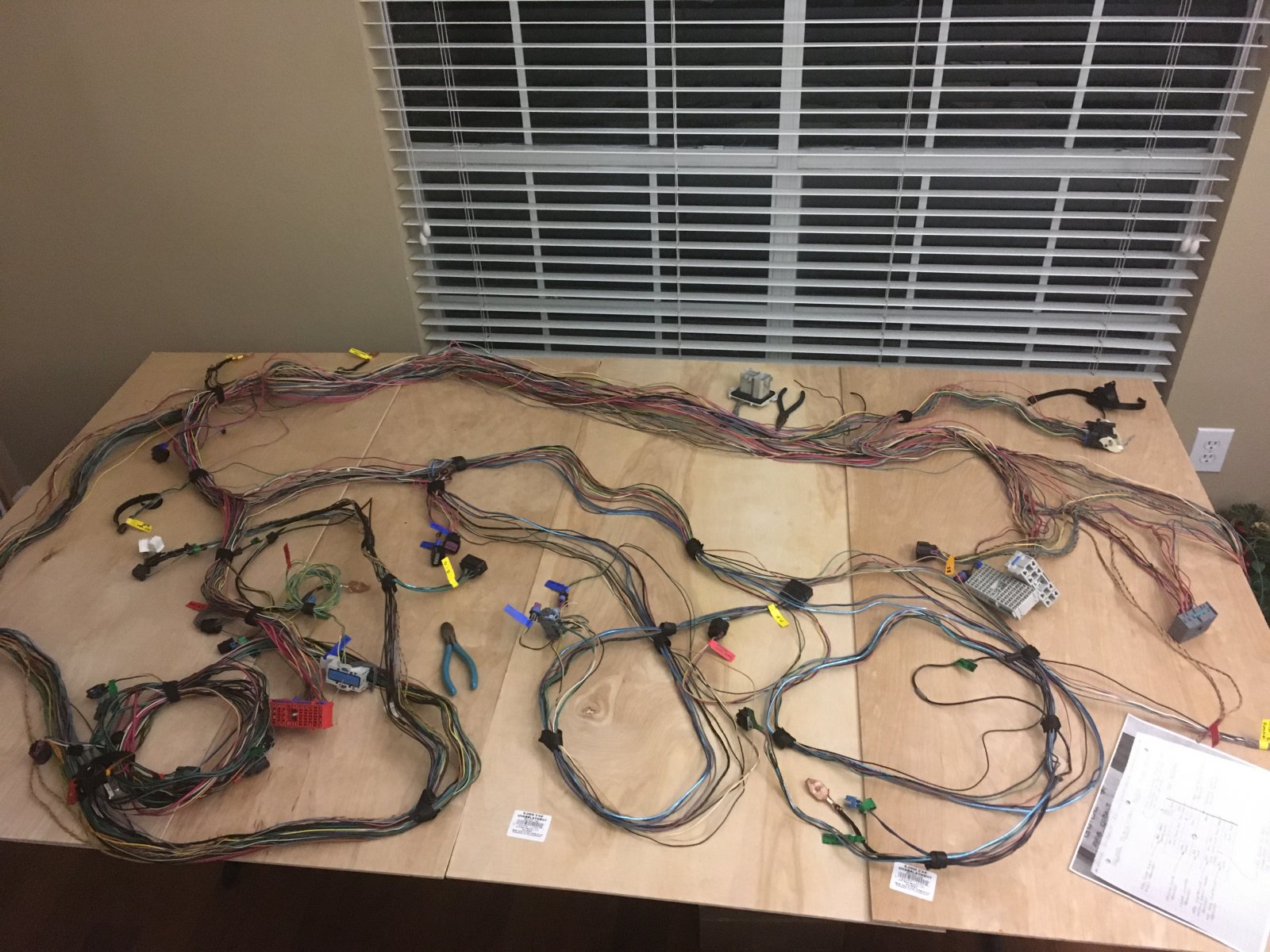

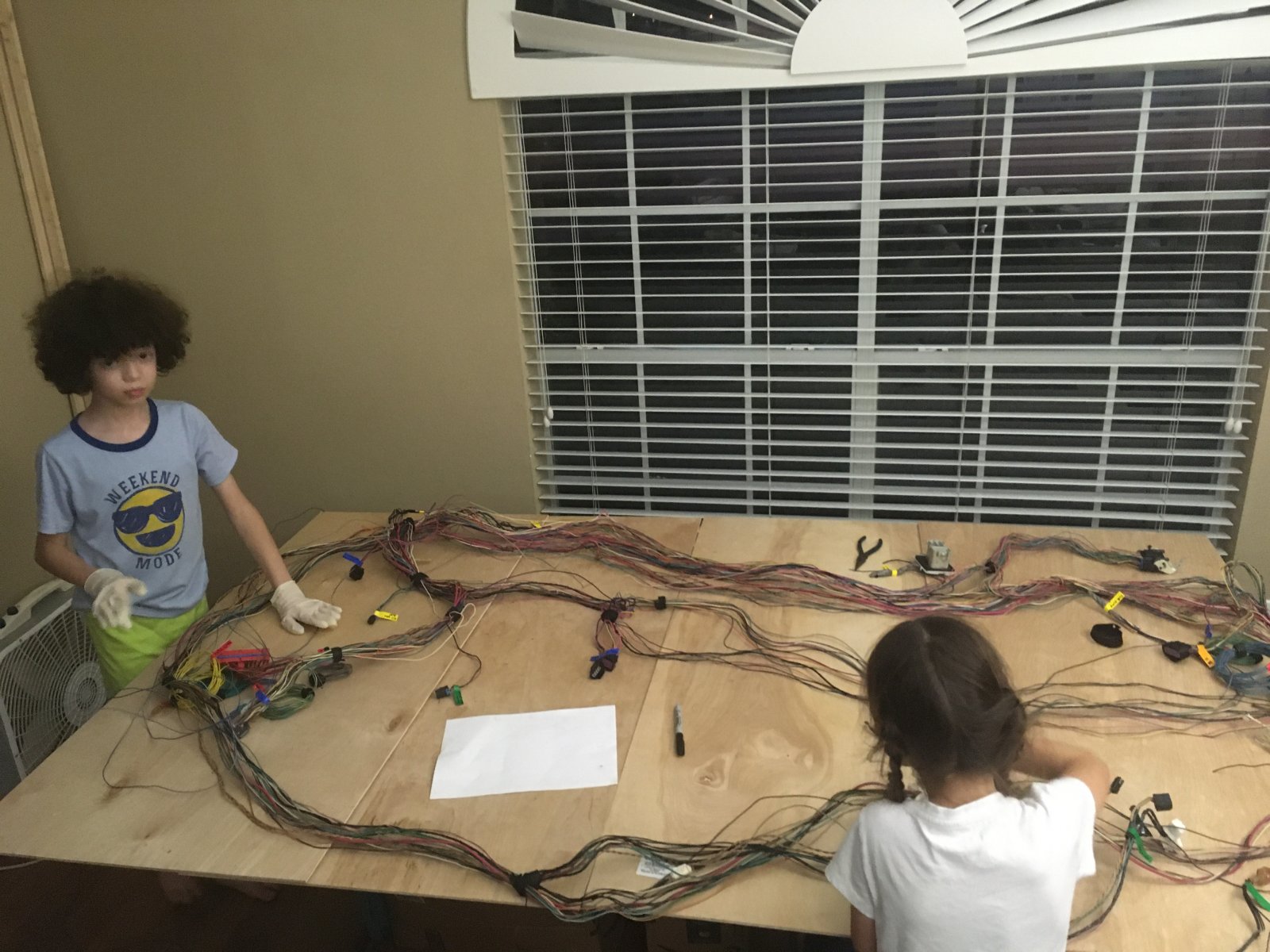

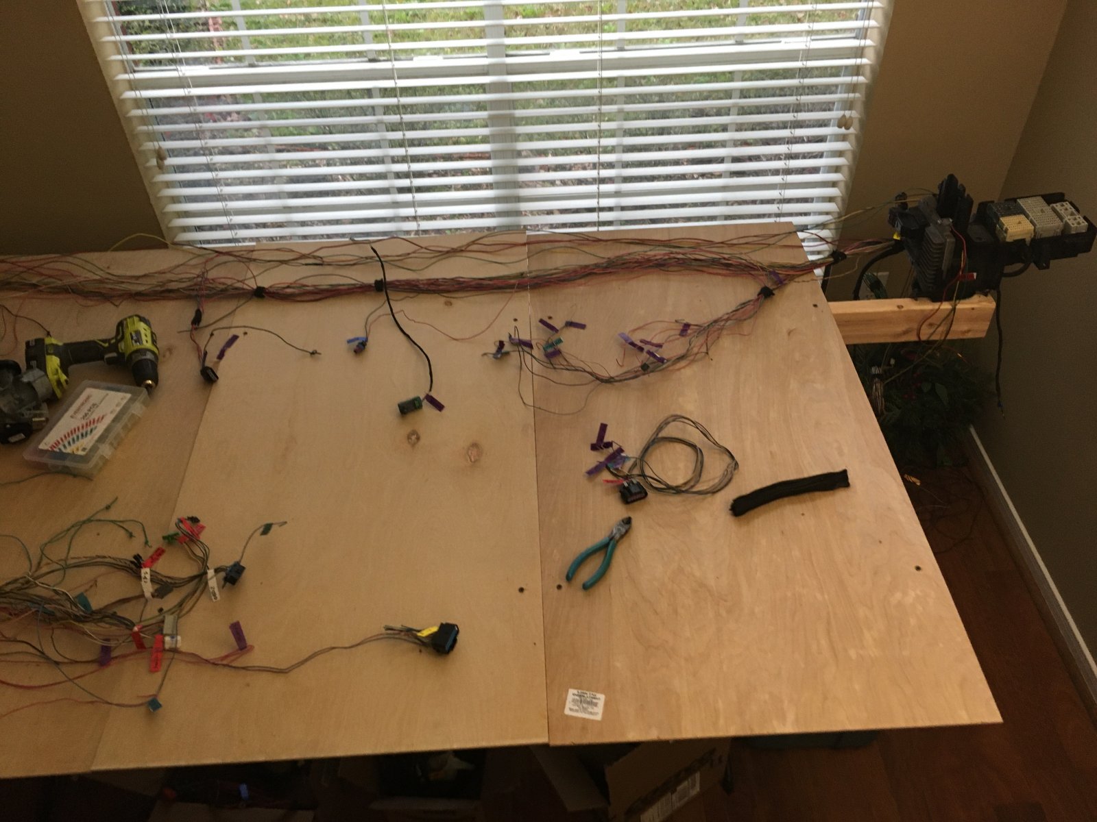

Long time and no post but thought I would keep all updated. Got most of the car stripped down. Just have the gas tank and evap canister left. Was cold and miserable outside so I turned my attention to the wiring.

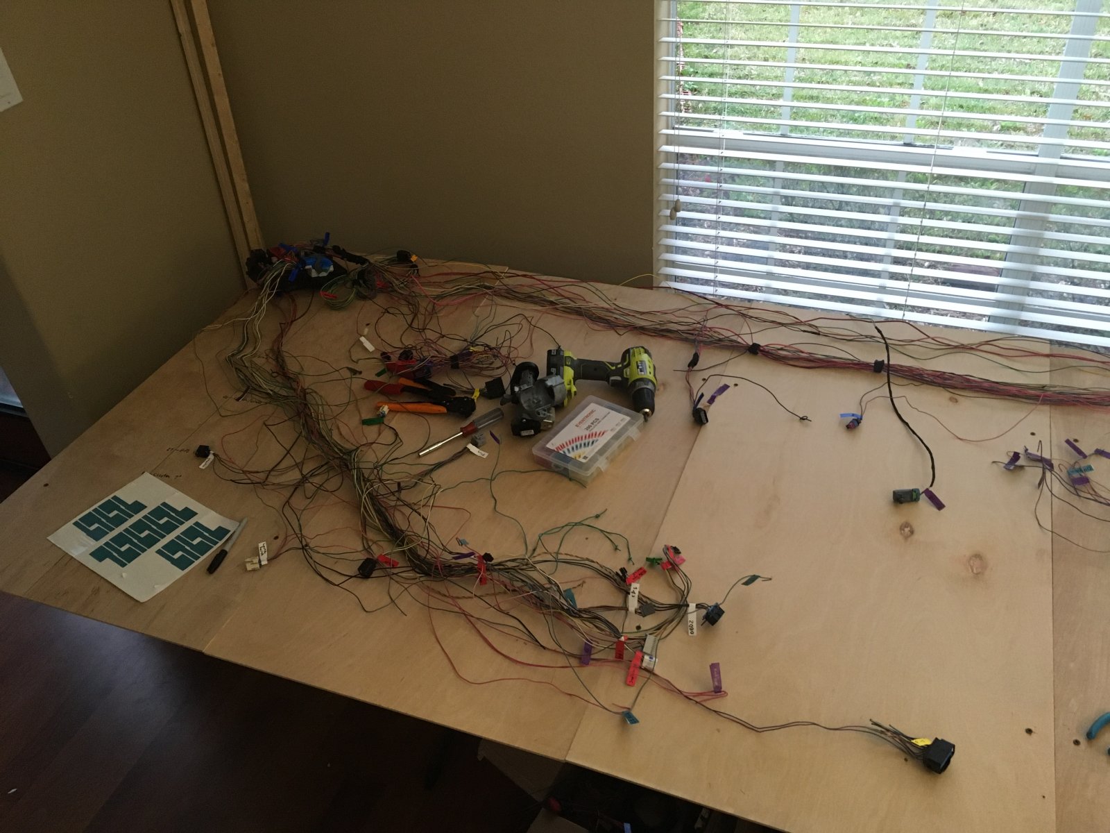

I didn't quite set up my dining room table for this but started cleaning the harness on a folding table in the home office. Man that old electrical tape is sticky and leaves residue everywhere.
Needed some more space and wanted to follow the spacing directions for the harness so got some 2X4 foot plywood pieces to spread it out.
I even involved the kids to help. I would cut one end of a wire to be thinned. They would trace and pull it through the loom and then I would cut it out. Kept them entertained for about an hour before running off to do something more exciting.
I am at the combining stage and it is taking me a bit of planning. Being in Texas with the threat of emissions checking, I am keeping the Evap system wiring in place. I also have an Automatic transmission, retained accessory outlets, and seat heaters for the stock leather seats that I am working in so some aspects are off the videos for what to do. It looks bad now but my brain is grasping the next steps more and more and don't think it will be an issue. One thing that has helped immensely was to label every connector and cut wire so I remember what things are after walking away for a few days. I also used a lot of 8" velcro bands to keep the wires in shape as I move between the harnesses. I hope in the coming days the harness looks more like Adam and Lonny's
Joe

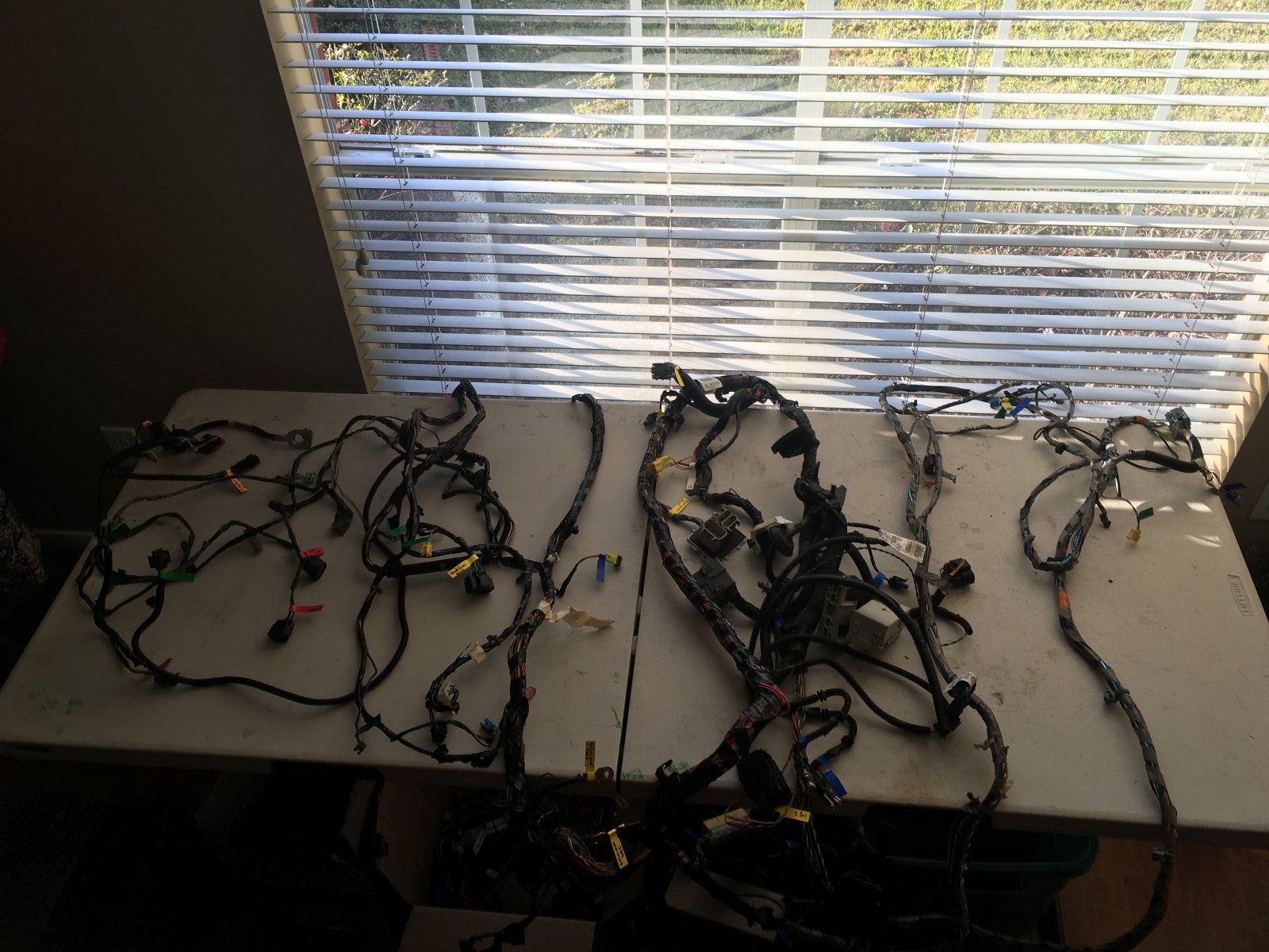

View attachment 20226View attachment 20227
Joe
I did something very similar with my harness which delayed my progress. I added in instrument dimming, kept the retained accessory power from the passenger door, rear defrost circuit, and both accessory plug power wires my donor did not have factory heated seats so I’m adding it. Morning drives in Nebraska can be quite chilly even in the nice season.

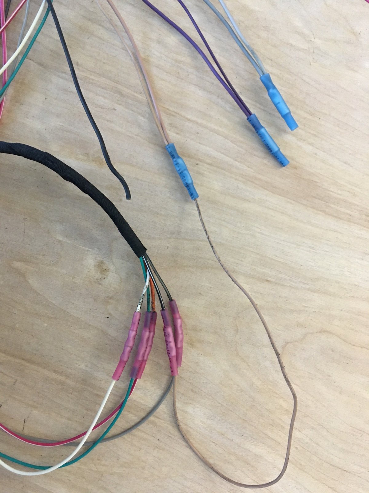

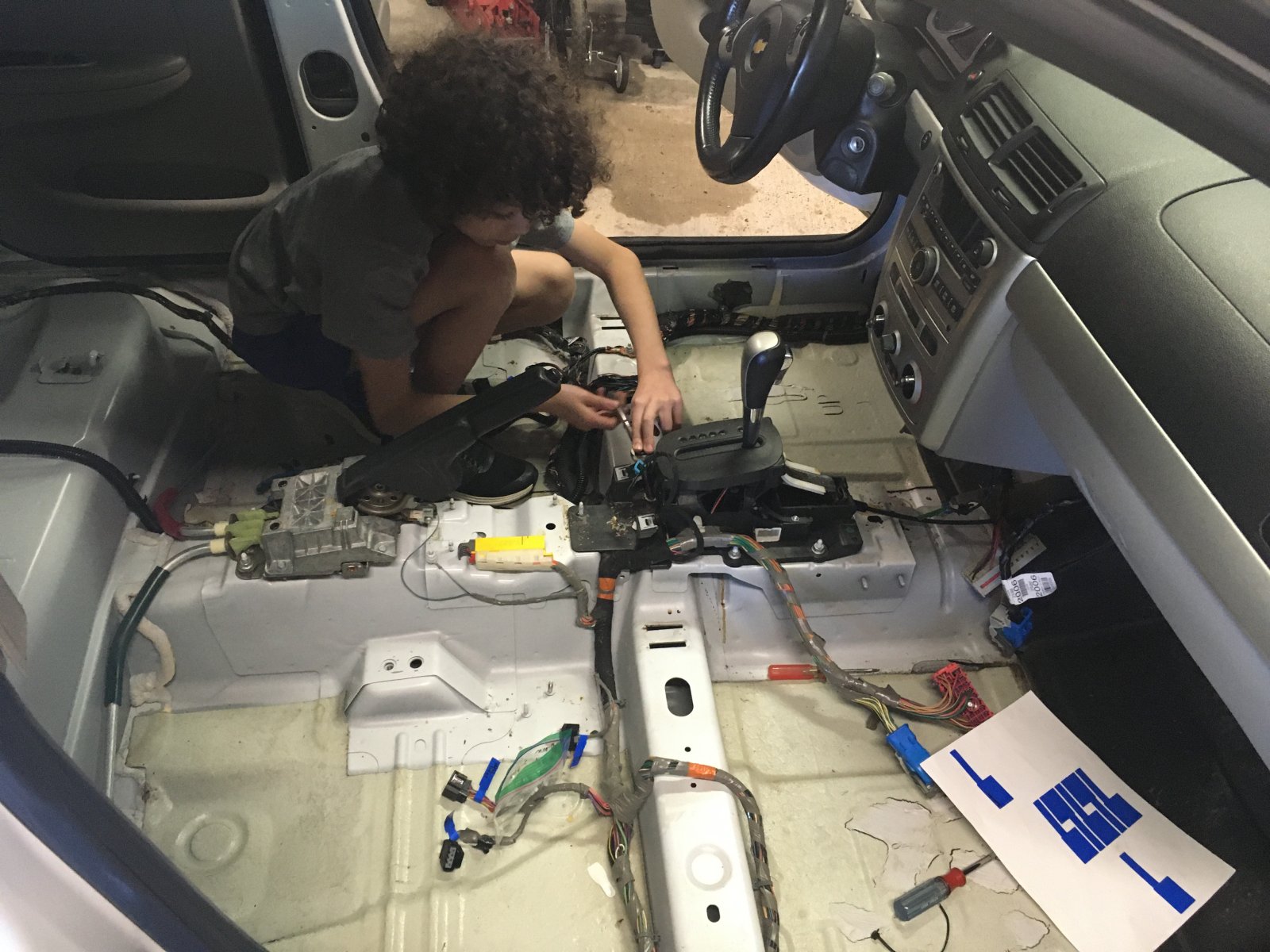

Work has been crazy busy and kids with homework doesn't help but I got a little bit more done over the last few days. I am keeping a lot of extras that are not in the video so I went through all the thinning videos and am now going back and organizing and joining knowing how everything interacts...I hope. In the videos, Lonny splits the fuel pump harness and tosses the EVAP system that I am keeping. I have joined the fuel pump wires from the plug to the fuse box just like the video.

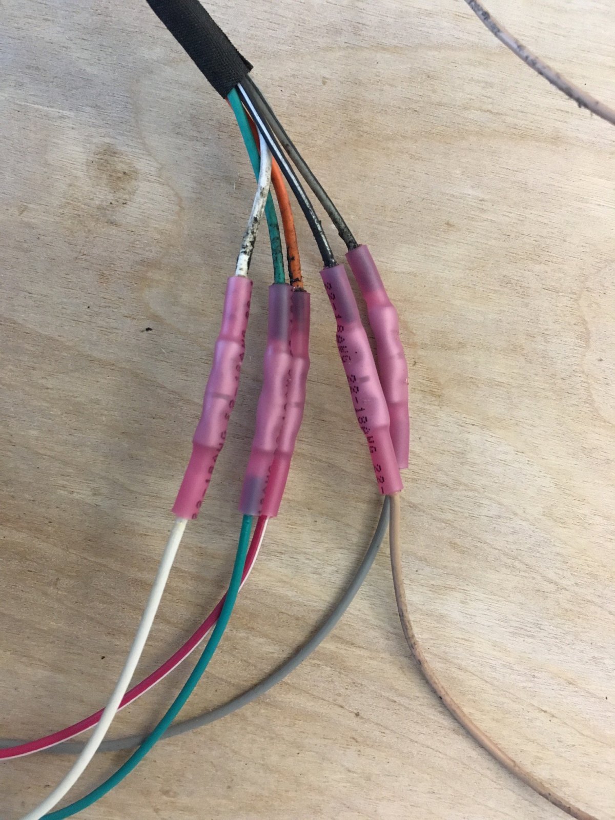

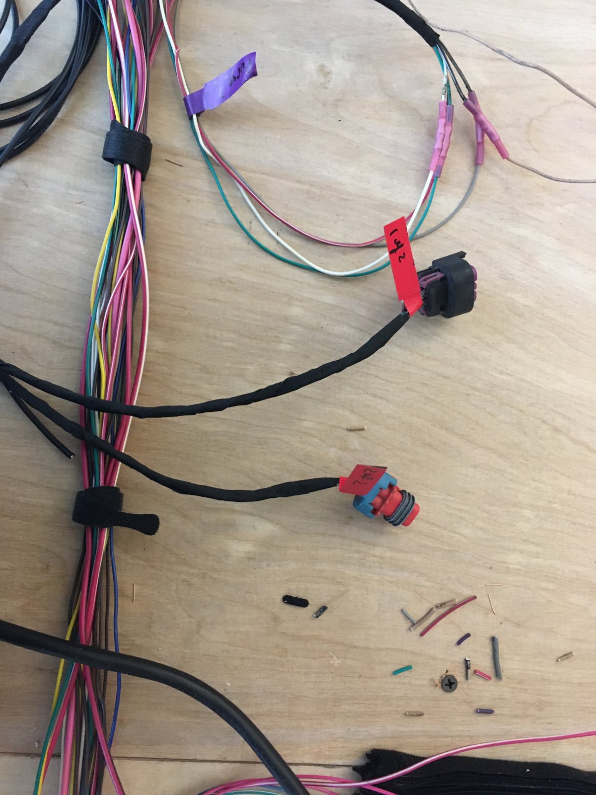

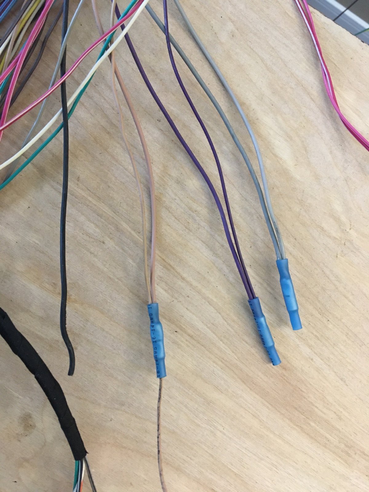

The extended tan wire is not for the clutch as I have an automatic, it is for the evap which share the tan wire. If you have a clutch wire that needs to extend, I assume you would have a 4 way junction. I hope I am right.
Here are the evap lines spliced into the fuse box wires. I didn't know that the tan is shared until I unwrapped the bulkhead connector.
Also to note is that the wire color changes on the underbody evap harness and the in-body wiring. it is:
Green-Green
White-White
Orange-red/white
Black/white-tan
Grey/black-grey
Here are the two plugs for the evap system. I will route them with the fuel pump wires but have left a few feet extra becasue not sure where to put the canister. I am more concerned on how to do the fuel vapor plumbing as there is a vent and crossover hoses on the tank that are not caried over to the goblin. Much later, I may need some guidance.
