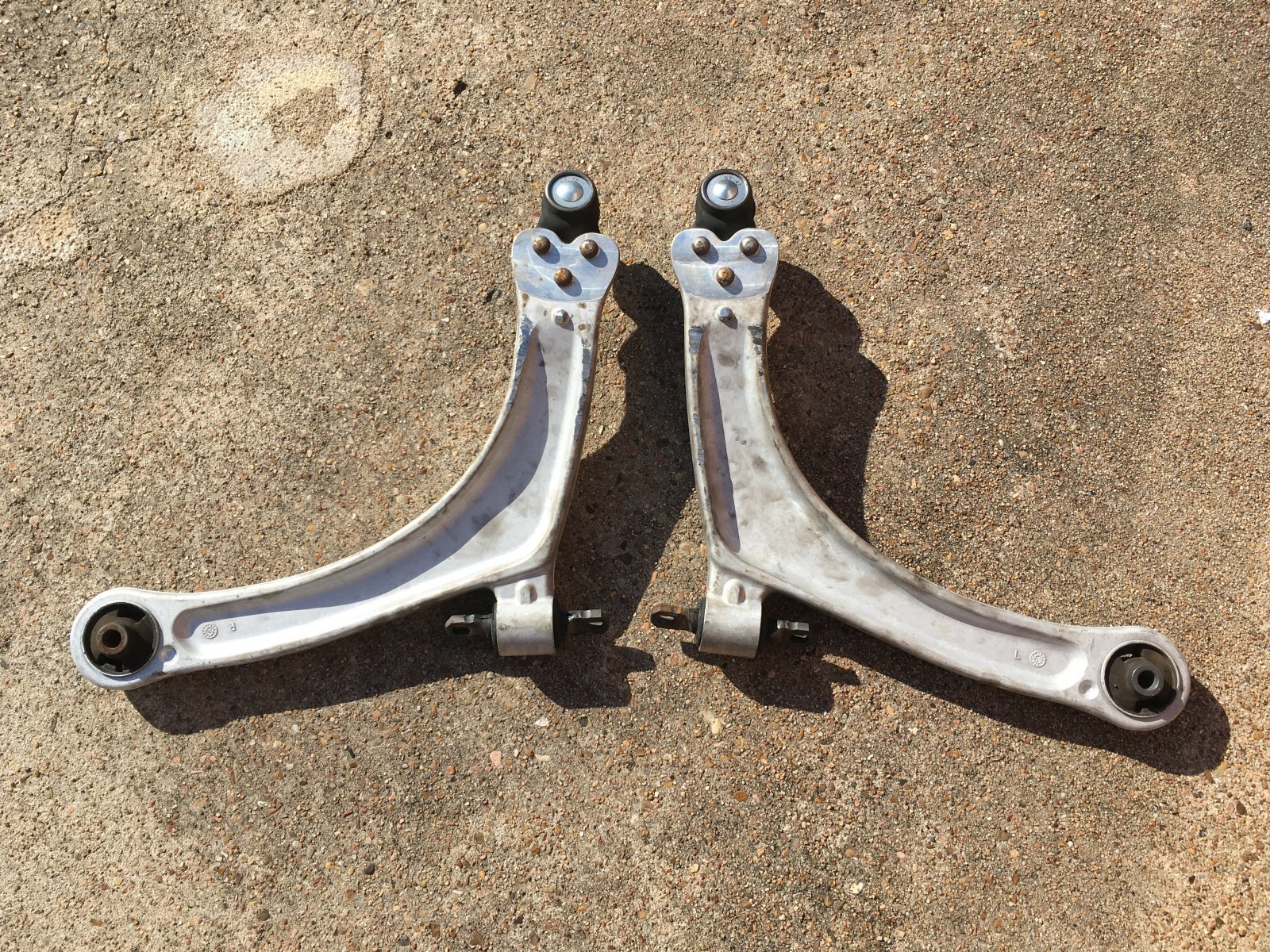

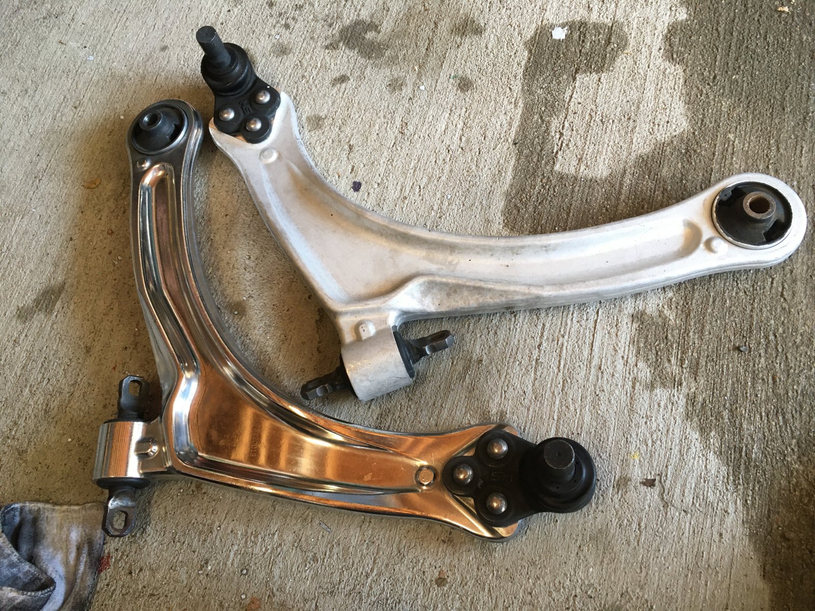

As it looks like they will be starting my frame soon (#270) I decided I needed to organize the garage and start cleaning and prepping parts. I am painting the steel parts black but started looking at what to do with the aluminum parts. The degreaser cleaned the lower control arms easily but etched the aluminum to a frost white. Me no like. With some wire brushes a drill and DA polisher, I think I made an improvement. What do you think?
Control arm start

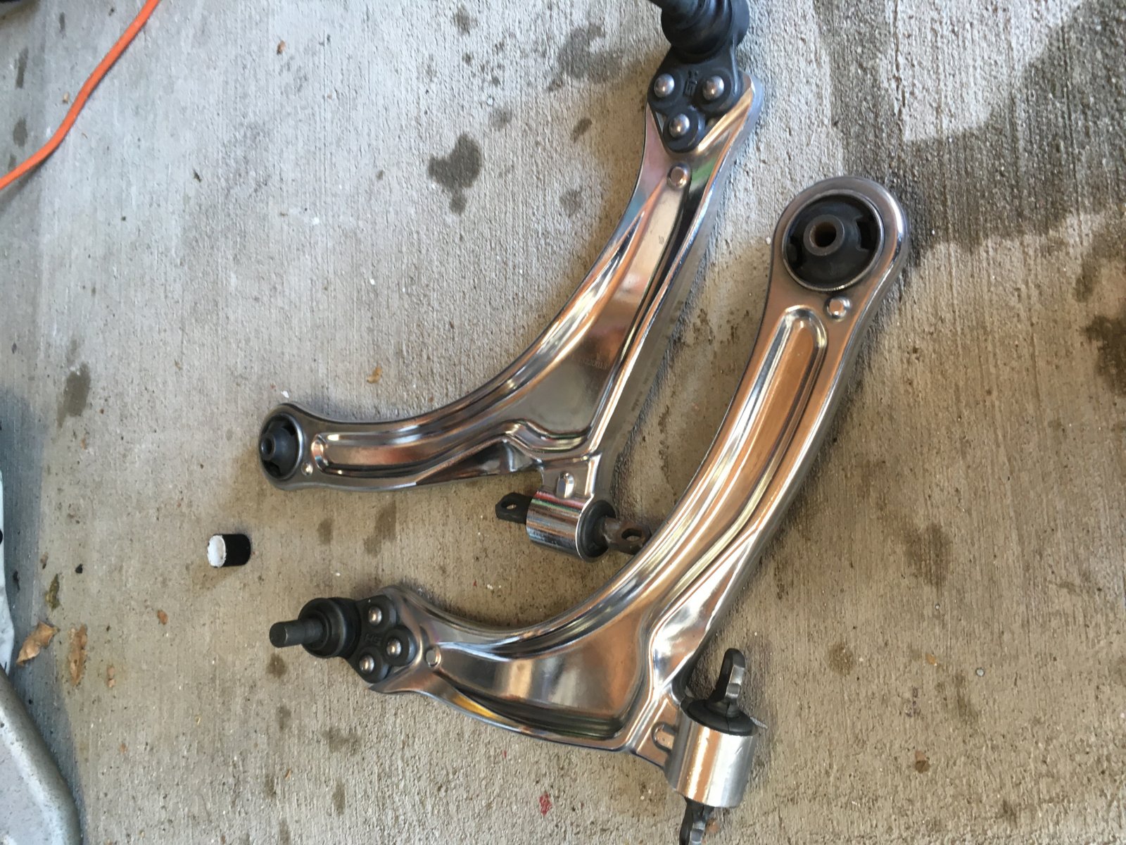

Finished...on to polish something else.

Dang those are very nice. I just wire brushed mine, didn’t polish them but I just might now if I don’t get the tubular control arms.
Dual Action polisher. Single action can cut the paint at the edges, so a dual action does a better job of feathering in the outer edge.

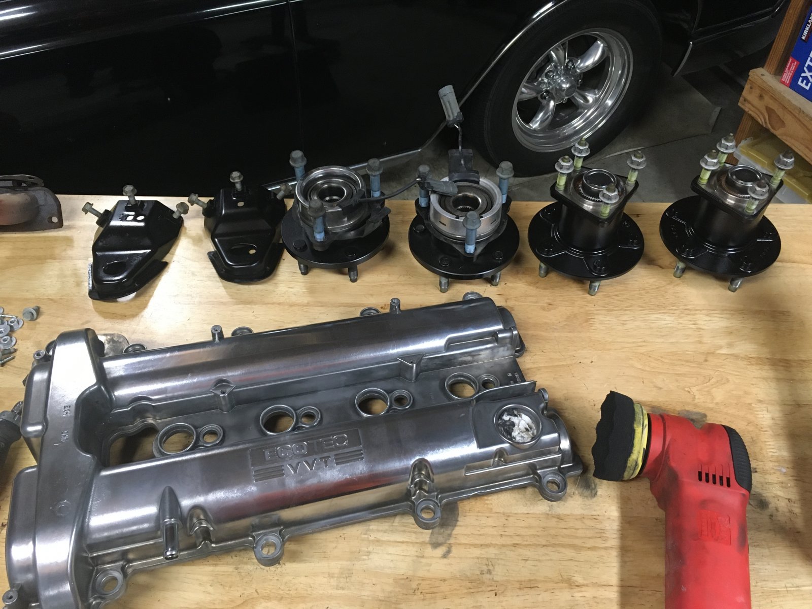

Over the last week I have started to clean and paint the hubs, subframe, brake pedal box, and other things. I pulled the ABS speed sensors from the "front" hubs, but are caps included in the kit or do I have to source my own?

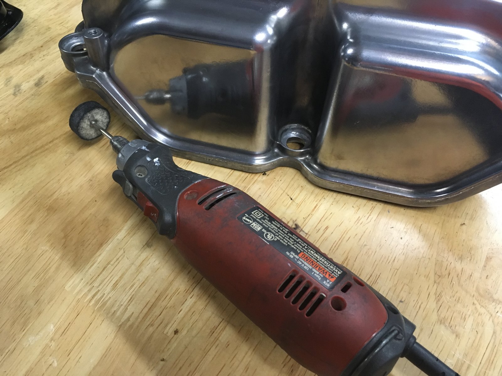

I have also started polishing the valve cover to make it "purdy". Not done yet but getting there.

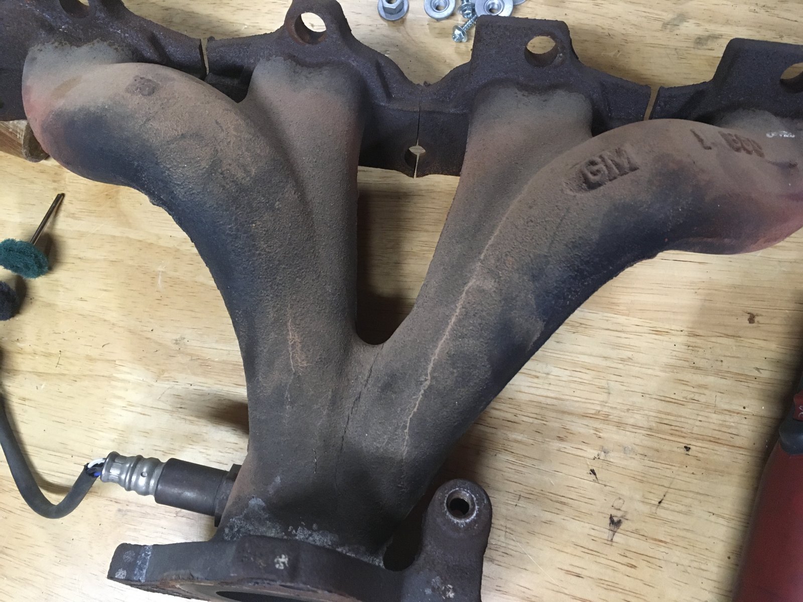

I also decided to take off the exhaust heat shield and see how ugly the stock manifold was as everyone will be able to see it. Well, a bolt tumbled out and also noticed a large crack in the manifold. No noise when driving it as a Cobalt but have purchased the Amazon headers for $78 which looks to be the same as the Ebay ones selling for $60.
As lots of people complained that it hit the water pump crossover pipe, I figured Amazon will be much easier for returns than Ebay. Oh, and the "bolt" that fell out. It turned out to be one of the exhaust manifold studs. Cracked right off 1/8" into the block. Wasn't me, broke sometime earlier in it's life. I figure since the exhaust wasn't making noise and the aftermarket header is a large solid plate, I will see if it is a problem before creating a new one by trying to drill out hardened steel surrounded by soft aluminum. Super easy access once the Goblin is assembled.

The caps for the hub to cover the abs come with the kit, but I think you have to order them, as an add on? I Can’t remember exactly.
There’s tricks getting those studs out of the head. If you have a welder, you can weld a nut to whats left of the stud and pull it out.
Joebob
I do have a little flux welder but the stud is broken inside the head. Unless the weld doesn't stick to aluminum, I am sure I would miss trying to weld a bolt to the end of the stud. All the manifold nuts spun off the studs with about 30 ft-lbs or so with no studs backing off. They are in there good. I will get more desperate once I have the engine running again and it leaks.
pisco
Use alum.
it will dissolve the steel and not harm the aluminum.
Several videos on YouTube cover the procedure.
