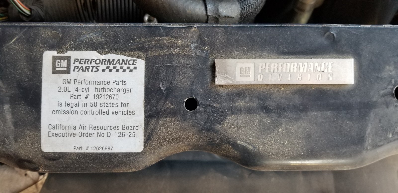

In the donor today. Its got an ugly misfire and a dirty MAF, unplug the MAF and it runs better, but not perfect Id still like to figure out the misfire before dismantling it. It does have GM Performance stickers and badging on the hood and rad support. Wonder if its tuned. Are these aftermarket sensors?

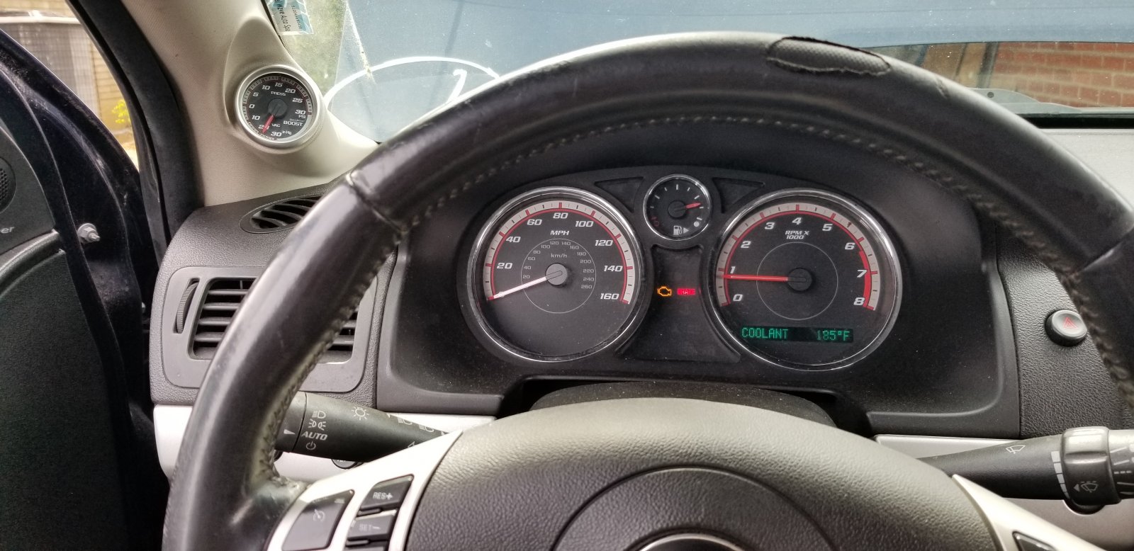

Bought that new radiator for $100 to run the engine one time to make sure I didnt end up the same situation that Tom Anderson was in. Engine came up to temp, got heat in the cabin.

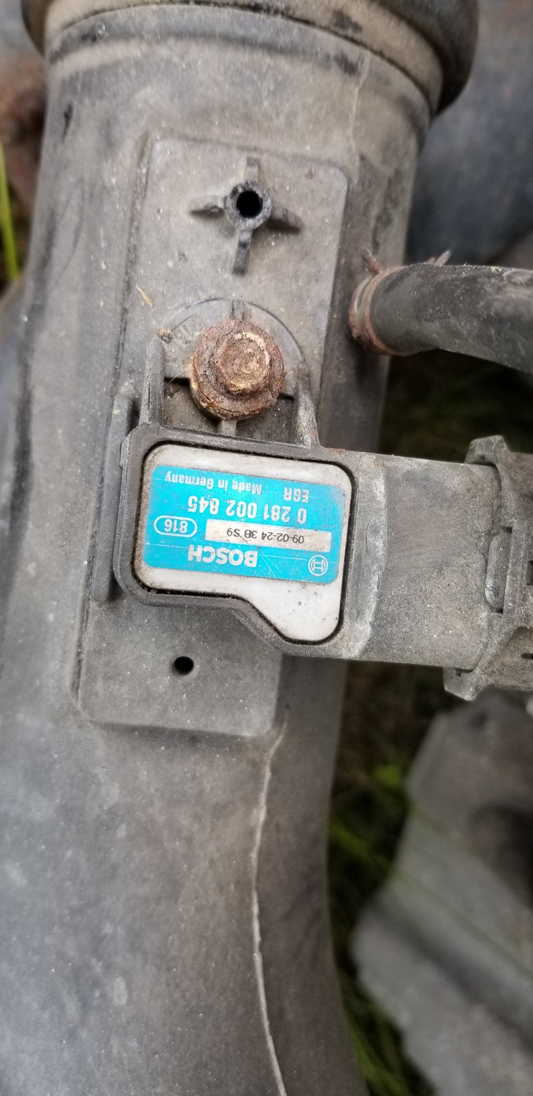

I realize now that those sensors are in fact 3bar map sensors, which is pretty cool. Makes me wonder what kind of tune this car might have on it.
Another note. I was getting a code for "Boost sensor circuit A low". I had cleared it a couple times, but it kept coming back. I was sitting in the car looking at those 3bar sensors pictures and noticed that the one picture there was a broken nipple. I feel like this might be the cause of the code.
Physically damaged sensors are always suspect, never know what has happened to the sensing apparatus or electronics inside. If I envision a broken nipple then it may be 'leaking" boost or maybe something far worse?!?

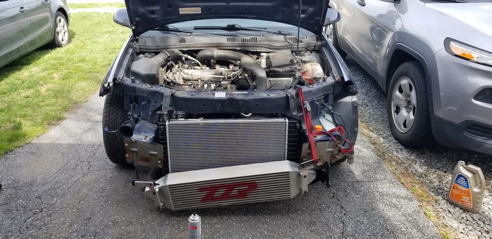

I wonder what "stage" this donor car has, like what GM performance parts it has on it. Factory air box, zzp front mount. My guess is some sort of tune.
Looks like different map sensors and a 290hp tune.
