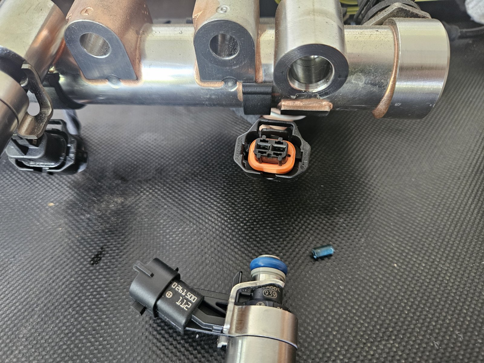

Just gonna leave this here.
Yes. This is the misfiring cylinder.

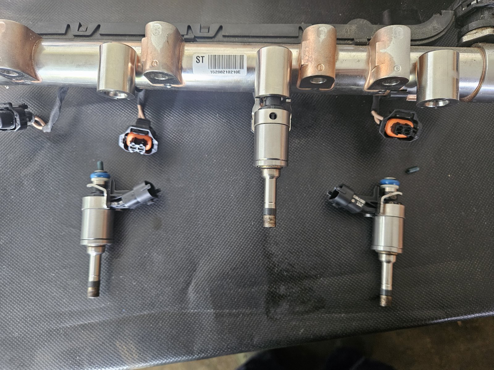

comegetjoe
Never having a DI rail and injectors apart, I'm guessing the separate blue piece is supposed to be attached like the other injector?
Yes.
I pulled #3 and it has a pin attached.
I pulled #1 and it has no pin attached.
I pulled #4 and it has a pin attached.
The pin for #1 was inside of the fuel rail. I was able to retrieve it with a pair of needle nose.
Im excited to see the cartoon arrow and curious to see what ZZP has to say about it.
