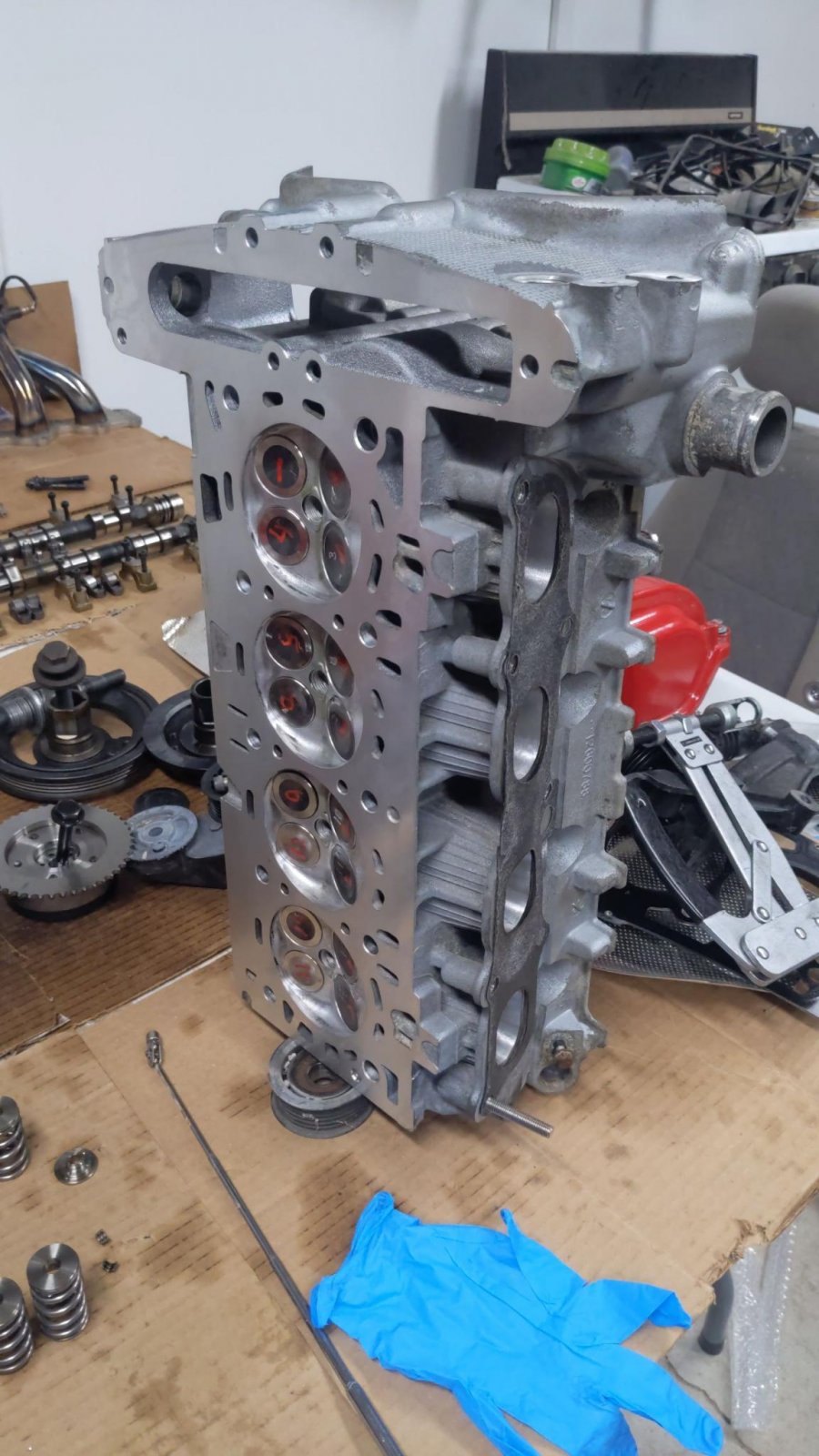

Boy did he do a good job! The valves move smoother and have ZERO play. Started putting springs back in tonight. Tedious so I only had the motivation to get 8/16 done, but I'm excited! They haven't put salt down yet so theres still hope for a test drive!

Little more background. The guy did a valve job, and we put new valves in it just to do it. The valve job pushed the valves up into the head ~0.030" more, so I added a 0.030" shim below the valve spring to make up for it. He also ground down the valve stem to make it within spec since the valve would have been higher than it was before by ~0.030".
Another thought from what the guy mentioned. So my head warped where the middle was higher than the ends. This also means that the cam journals would have this same bend in them. I'm hoping I'm not hearing a "tight" cam or something similar from the journals being "bent".
