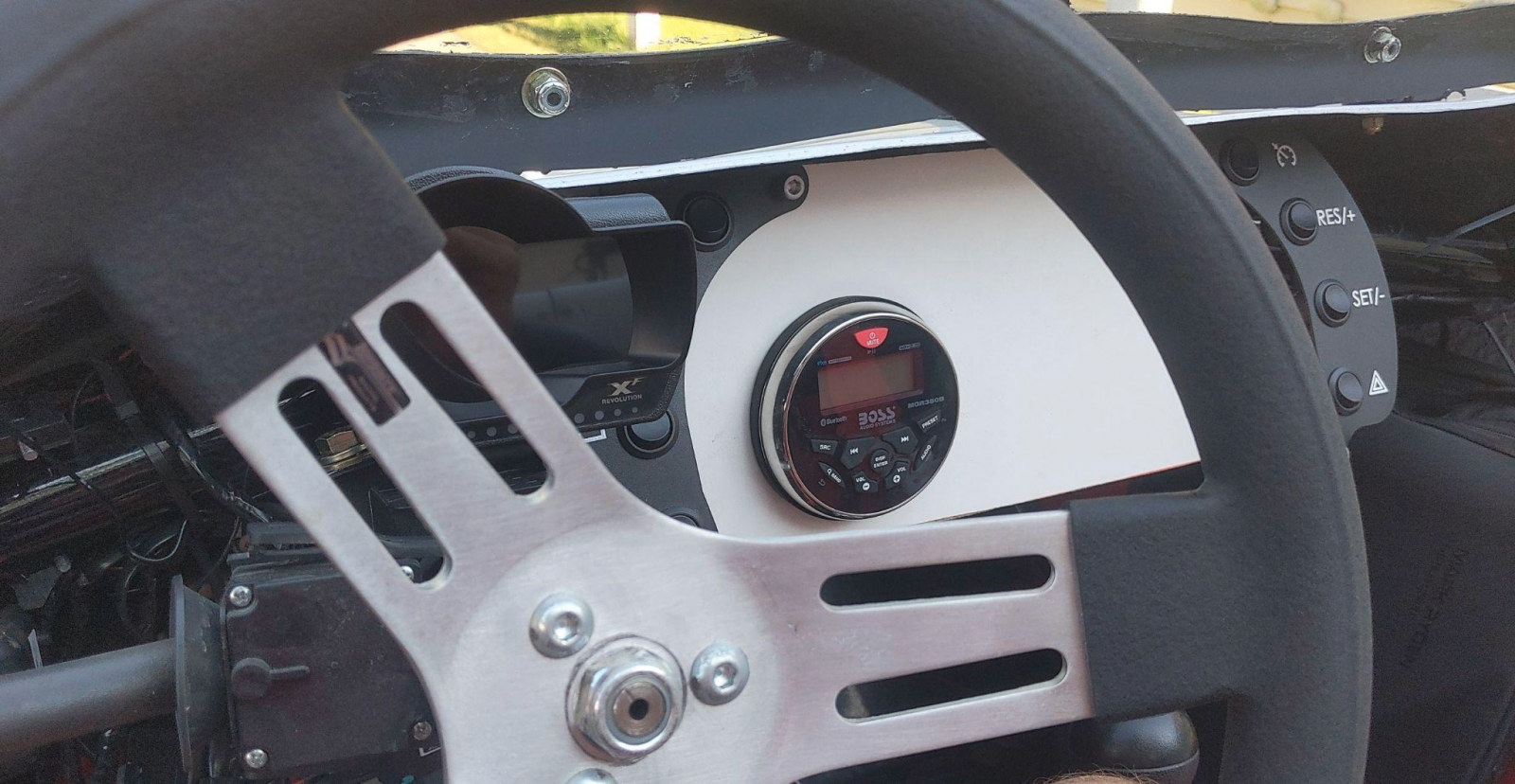

??? 2021 - Installed a BOSS audio marine (see waterproof) head unit and marine speakers. Custom 3D printed skeleton to replace the gauge cluster. Using an OBD2 speedometer mounted with a custom 3D printed mount.

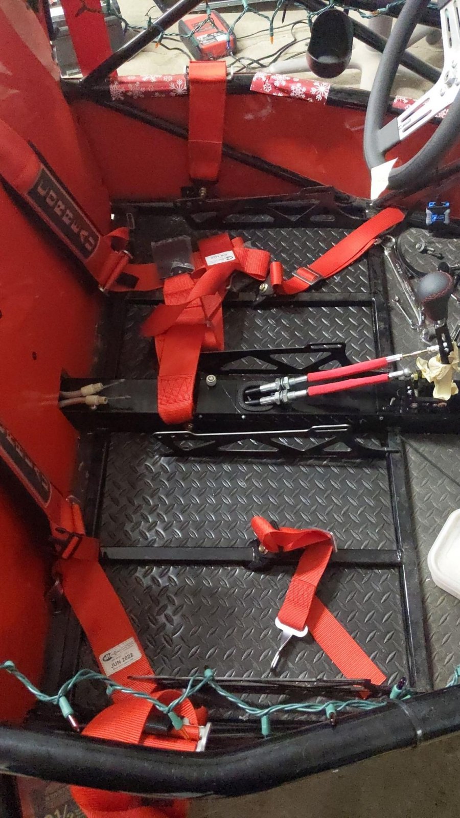

Installed (but didn't adjust) the new shifter. Used self tapping screws for the tunnel cap instead of rivets/rivnuts again.
Also added some more of that standing mat stuff from Home Depot under where the seats go. Should serve as cheap removable sound deadening.

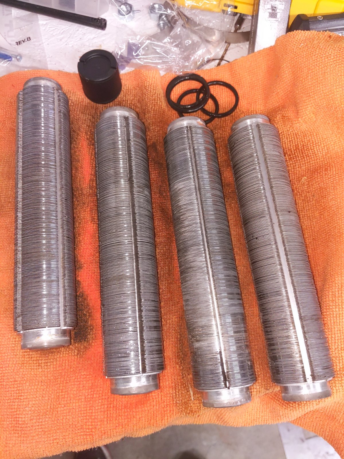

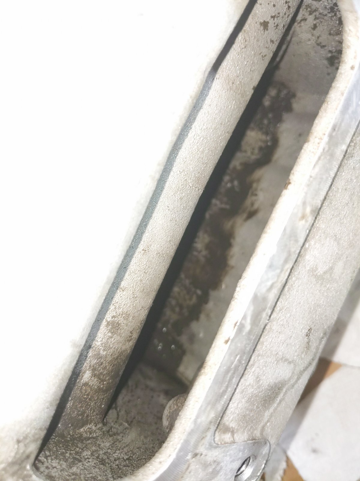

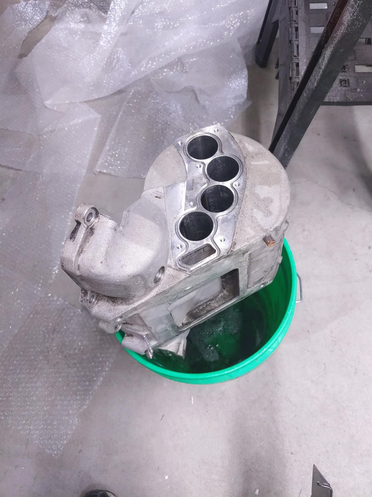

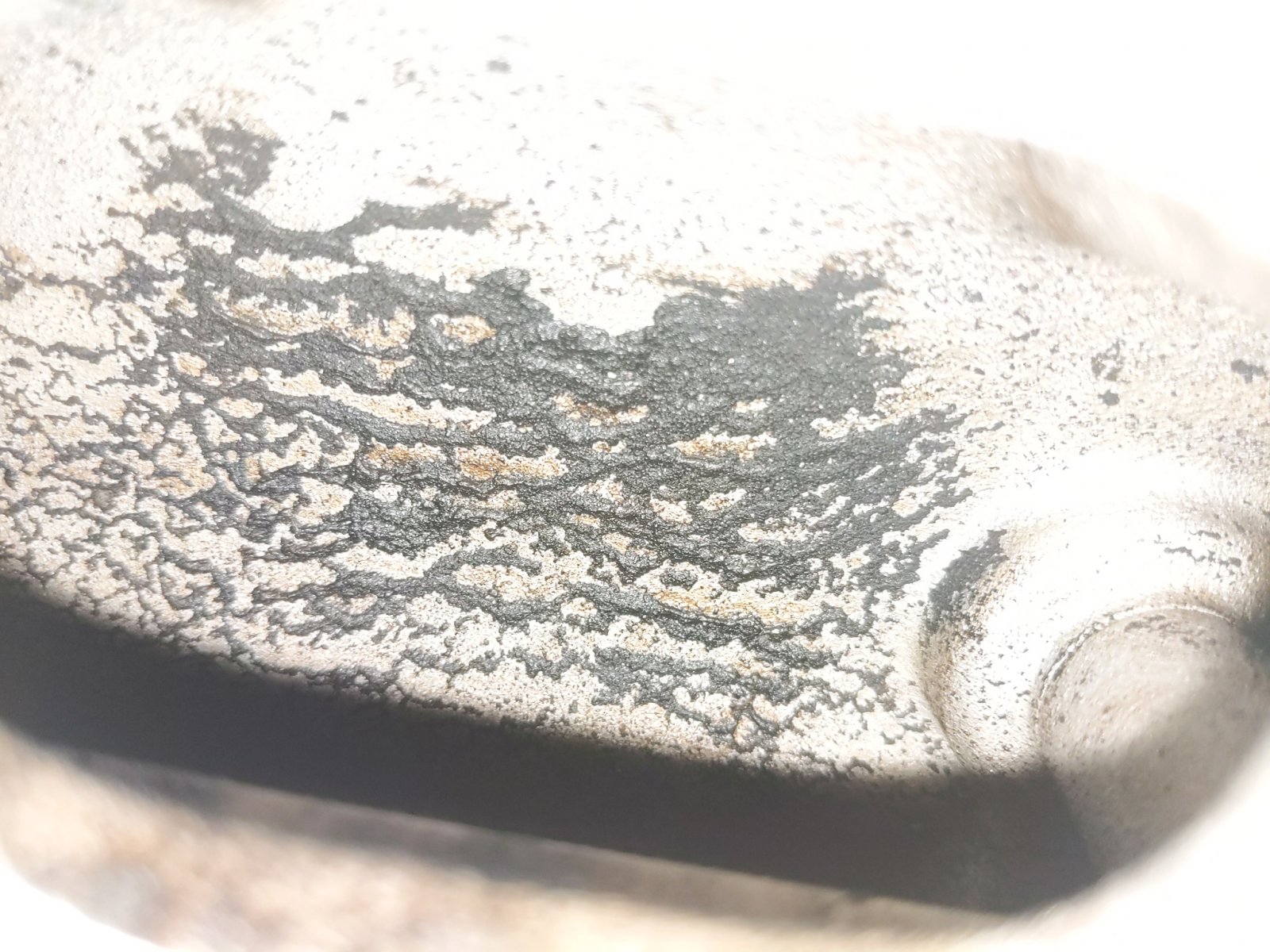

How far would you guys go cleaning an LSJ intake manifold. I'm 2 cans of carb cleaner deep and there's still sludge in there I can't reach. The laminovas are now squeaky clean, but the rest has some sludge that I'm worried will get back on them once installed and ran. Is there a solvent or something I can soak it in that is safe for the aluminum?
