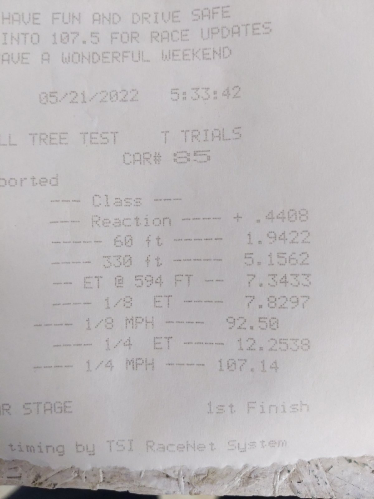

Took it for its first test rip yesterday! That supercharger whine is intoxicating!
Rough idle, but I found out that I didn't cap what is apparently the reference for the boost gauge on the intake manifold. So I had a boost/vacuum leak. Plug that and I imagine my idle will get a little better. To try to get some of the bubbles out of the cooling system I think I'm going to try jacking the rear of the car up while it idles. I've debated trying to find a new radiator like they had in the original videos where it had a cap that you could bleed air from at the top. Hopefully just tipping it will help a bit.
Also... don't be me. Testing a newly supercharged car without the brake booster plugged in is a bad idea.
