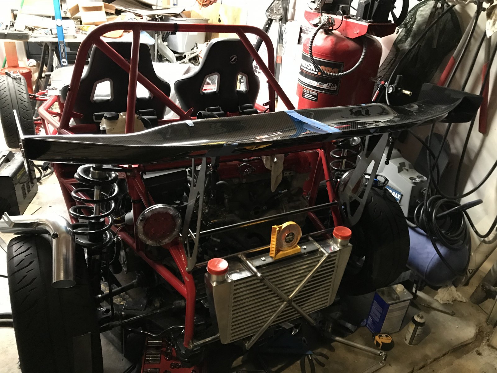

Is the gearbox in both pretty comparable? I like the idea, and most people on here have done some work to the engine when they are building it. So, upgrading a base model as you've done isn't a bad idea.
unfortunately that is the weak link here. But I’ve considered that as well, when (not if) I blow my transmission I’ll be going to the Saab 9-3 6 speed.

All that being said, the LSJ is by far the best deal. No internal upgrades needed and with a smallish turbo like gt28 you’d have a hell of a setup

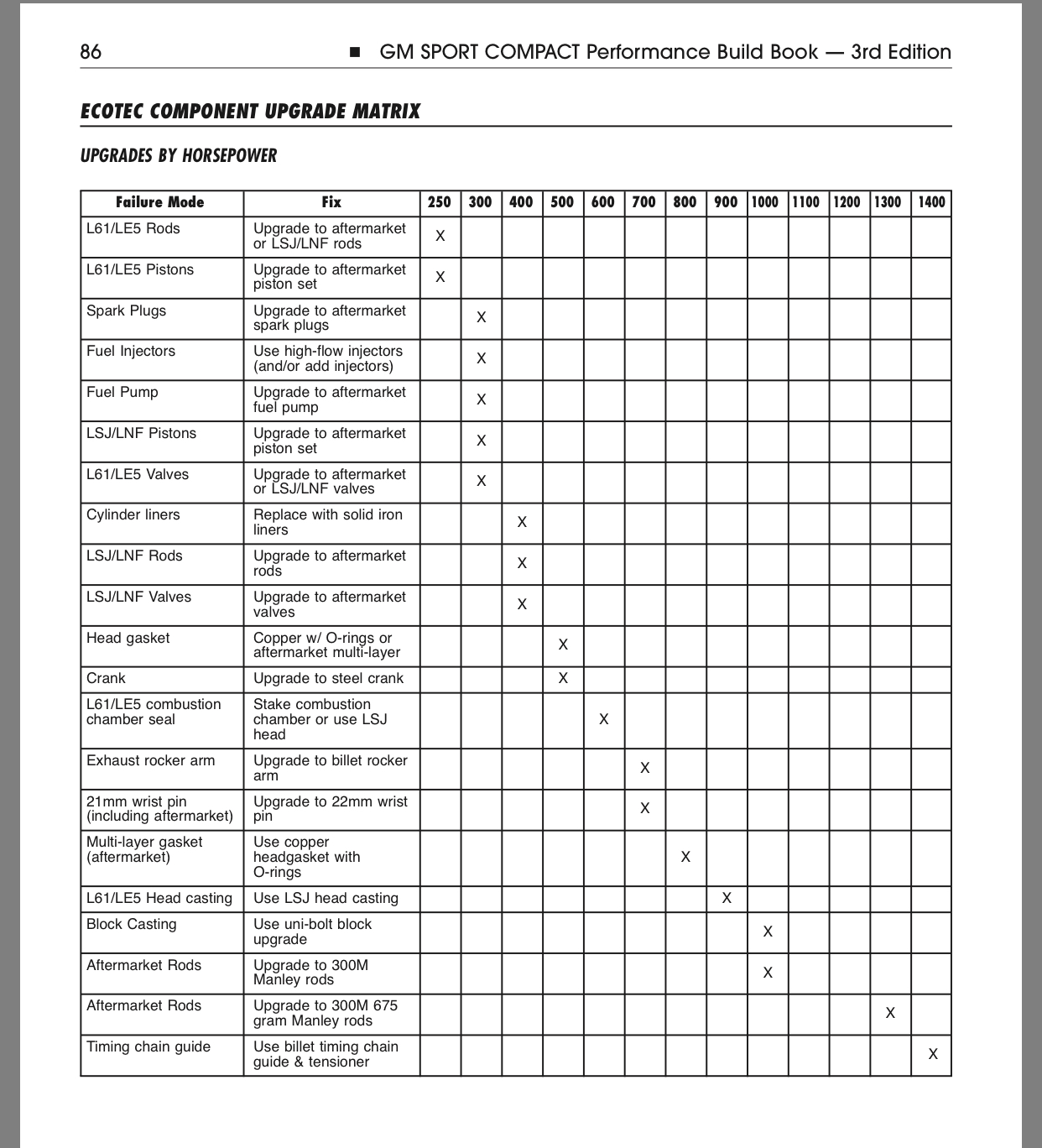

Stock injectors good for that kind of power?
No. Running Siemens 60lbs. The GM build book has a chart with what you have to replace at what level. I’m doing all the recommendations for 400hp (except liners) and then dialing it back to 350.
