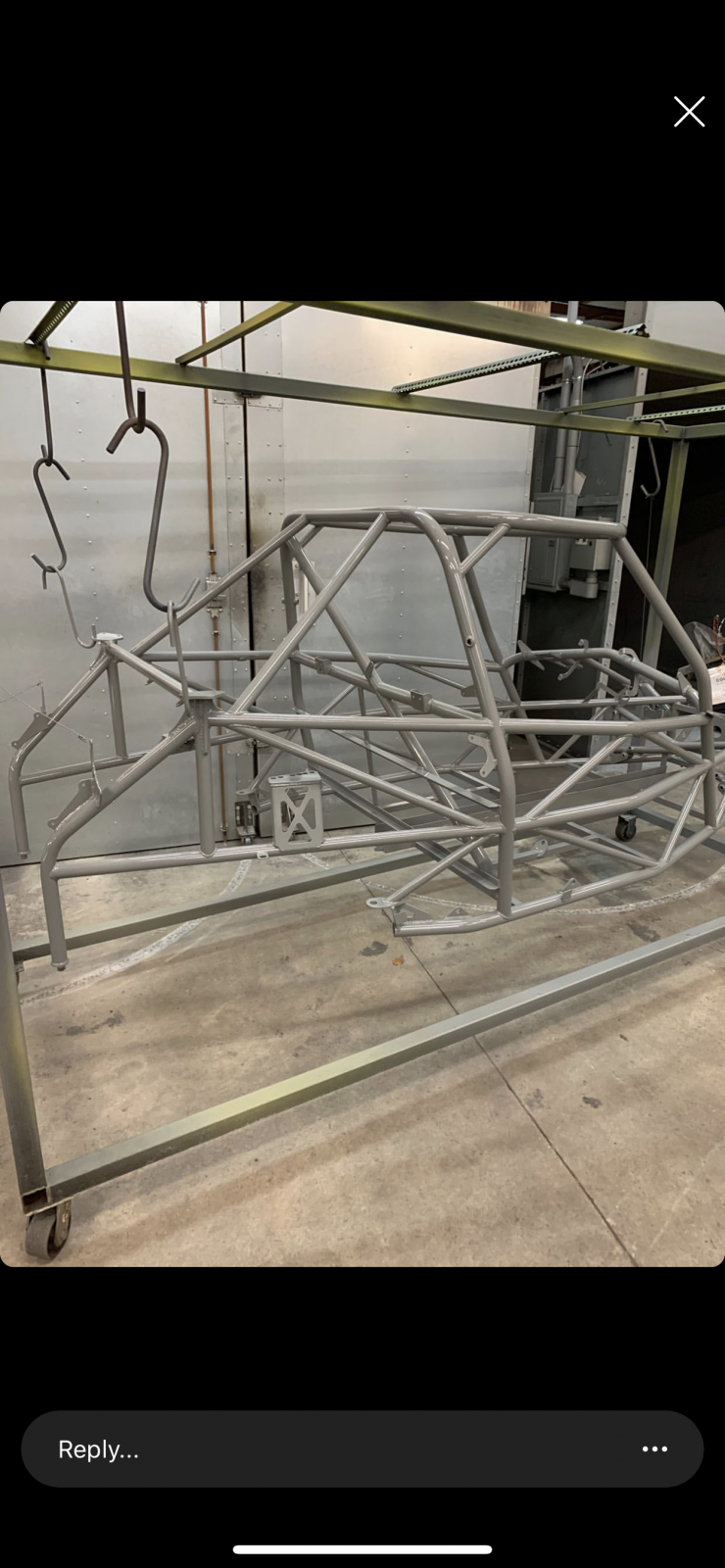

All of the powder coat parts are ready to go!

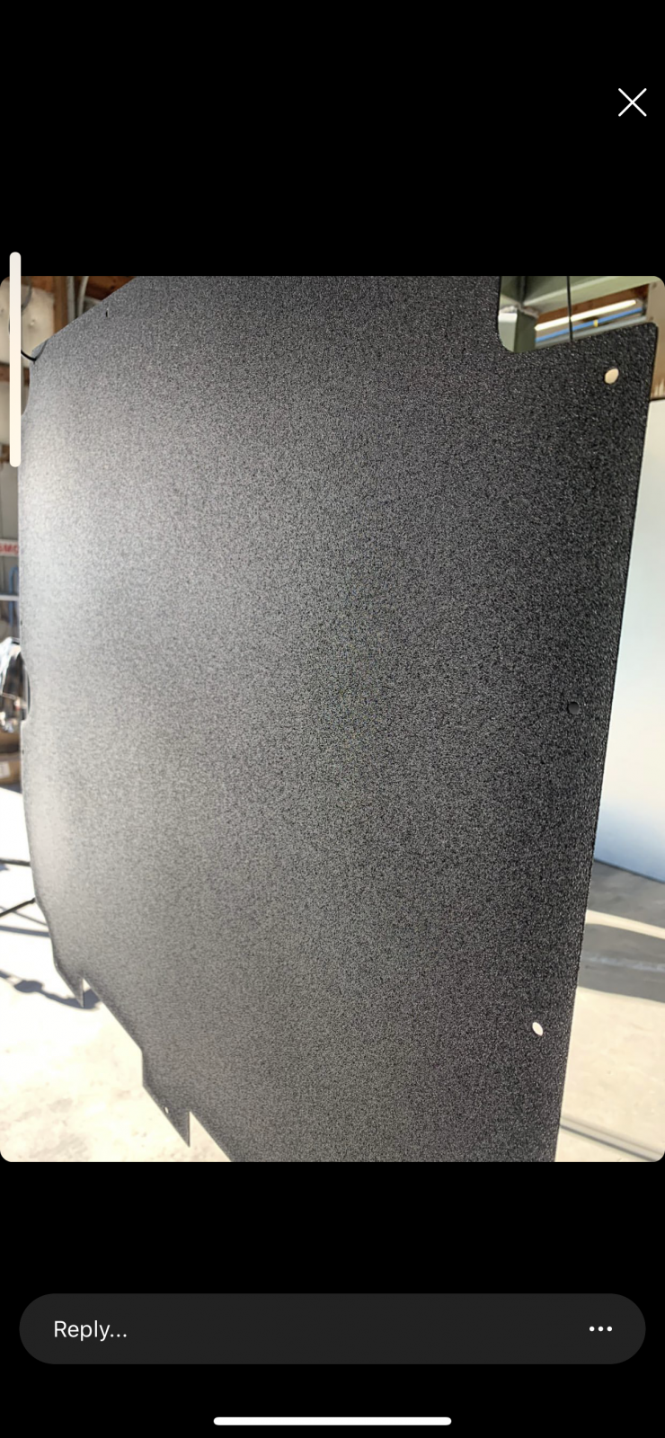

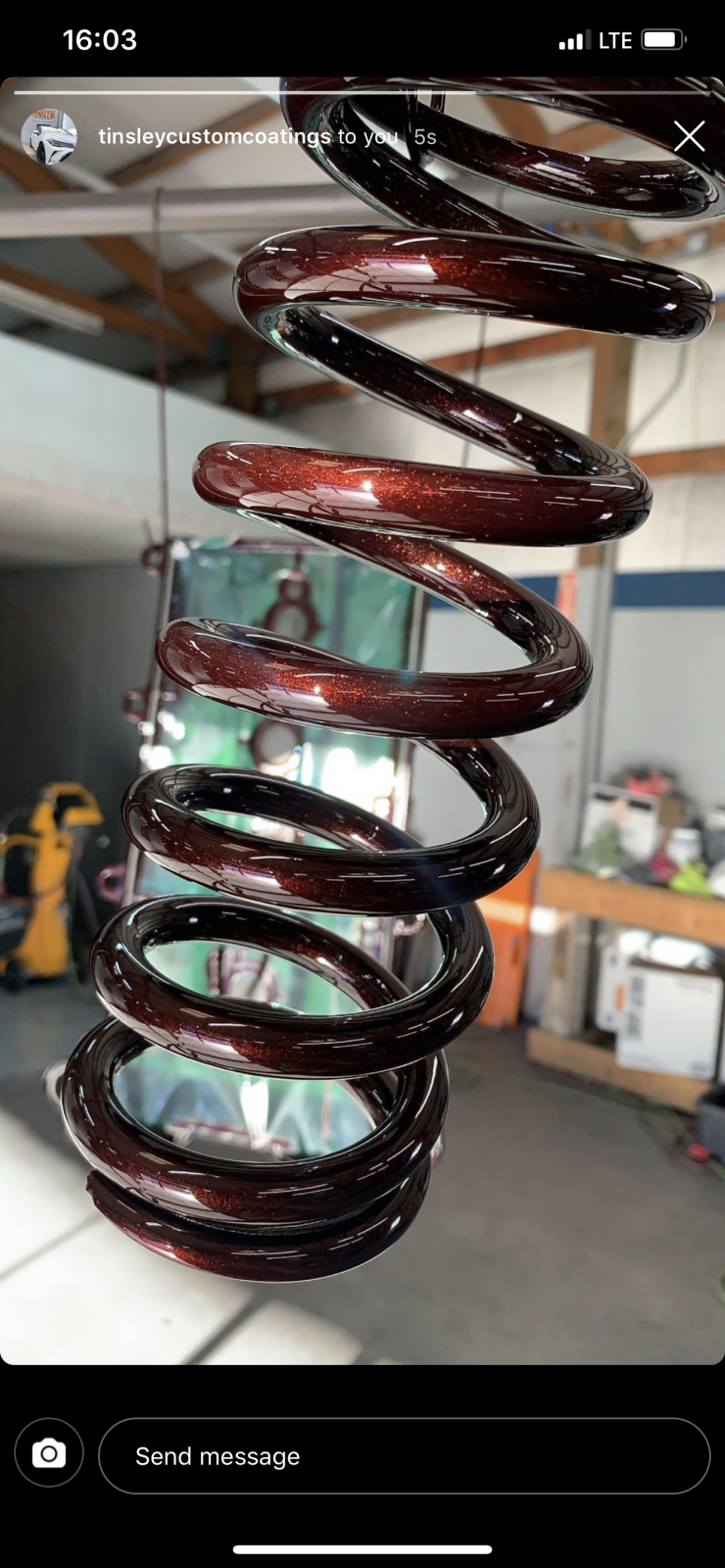

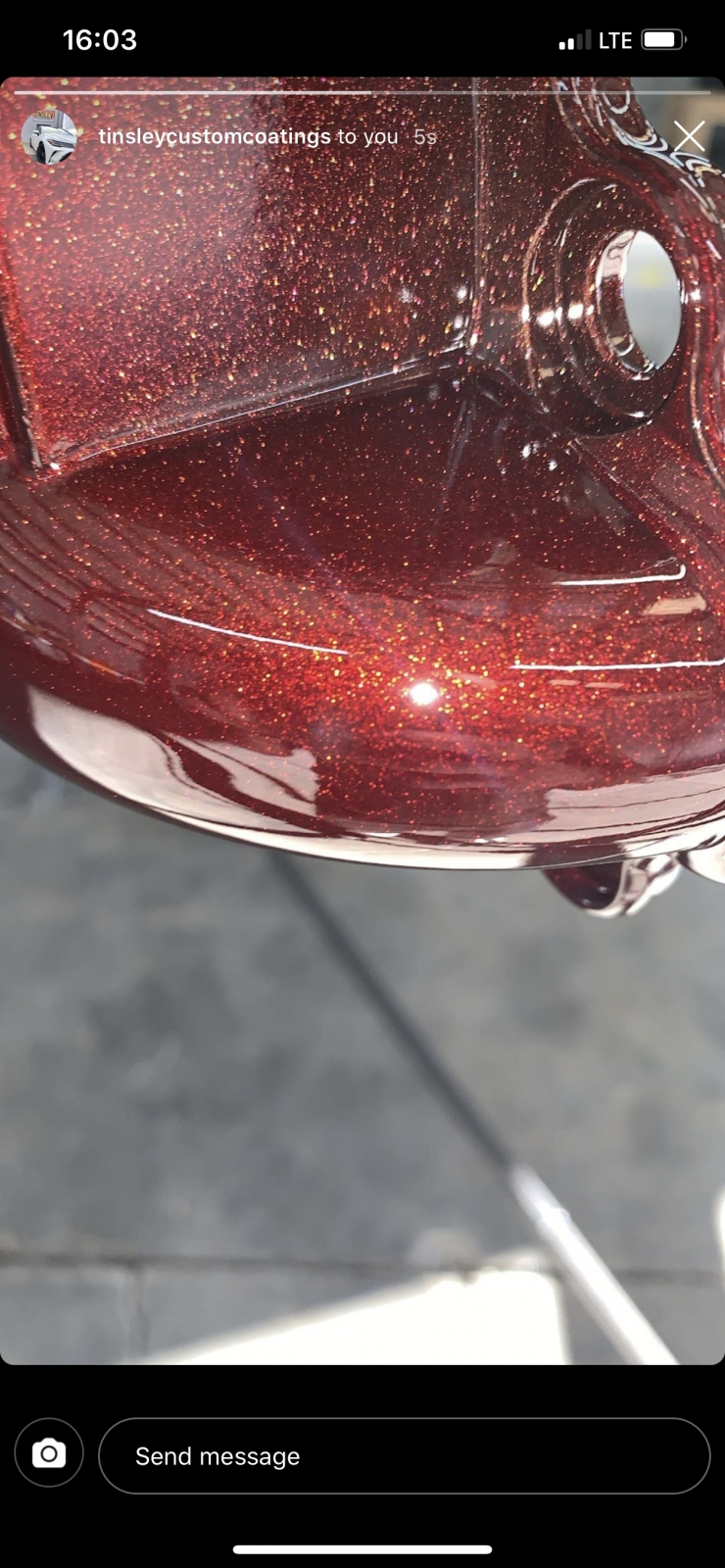

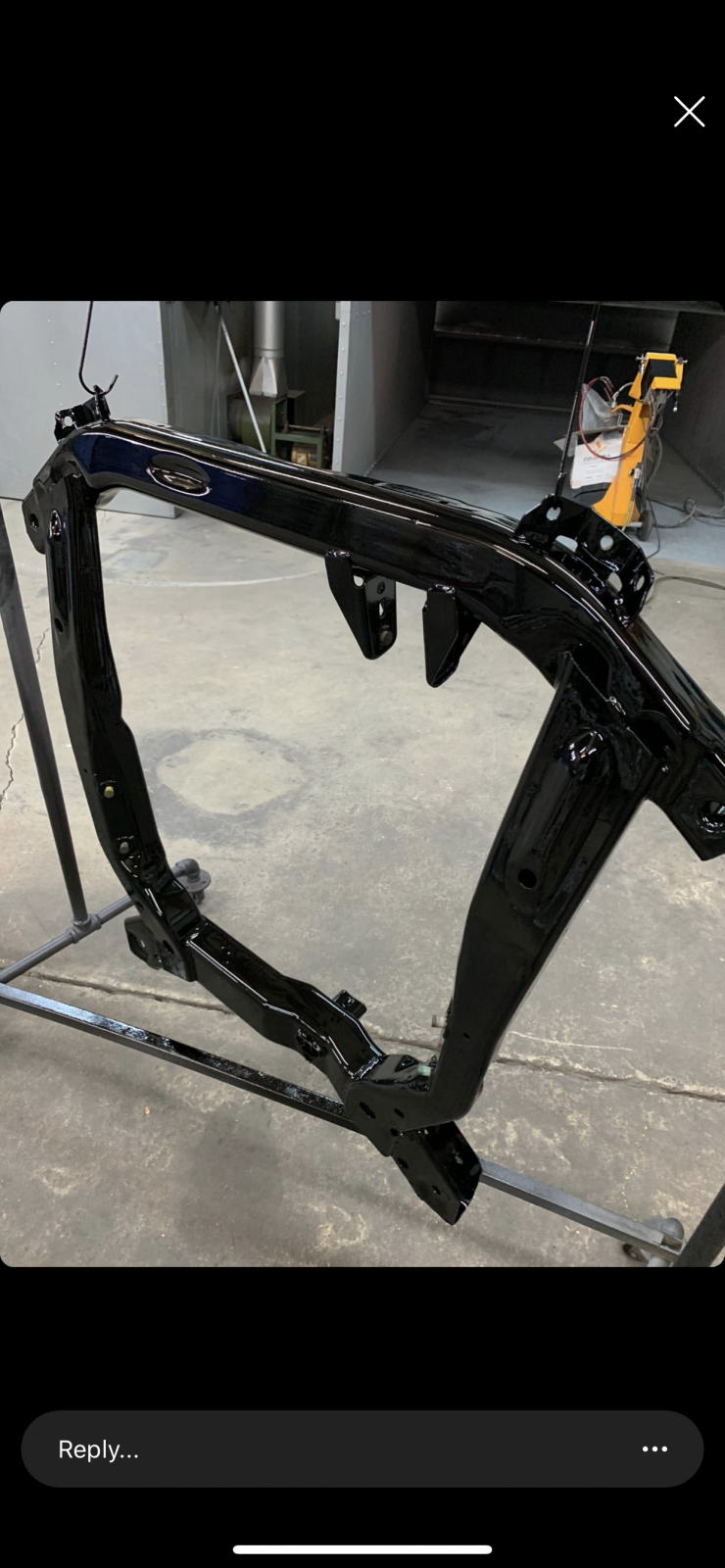

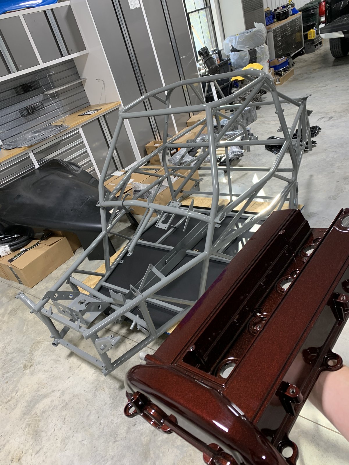

Powder Coat Teaser :)

KSLunsfo
That metal flake on the spring looks very cool. I've seen multiple springs being powder coated lately, I guess powder coat is flexible which I would have thought to be the case not having much experience with it.

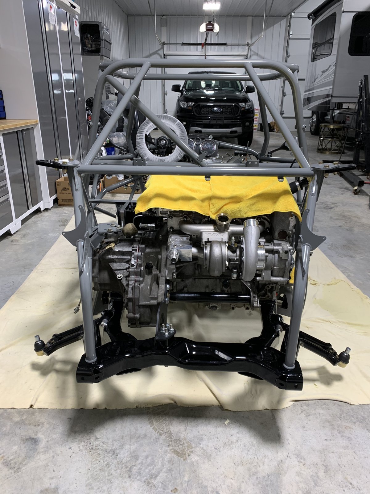

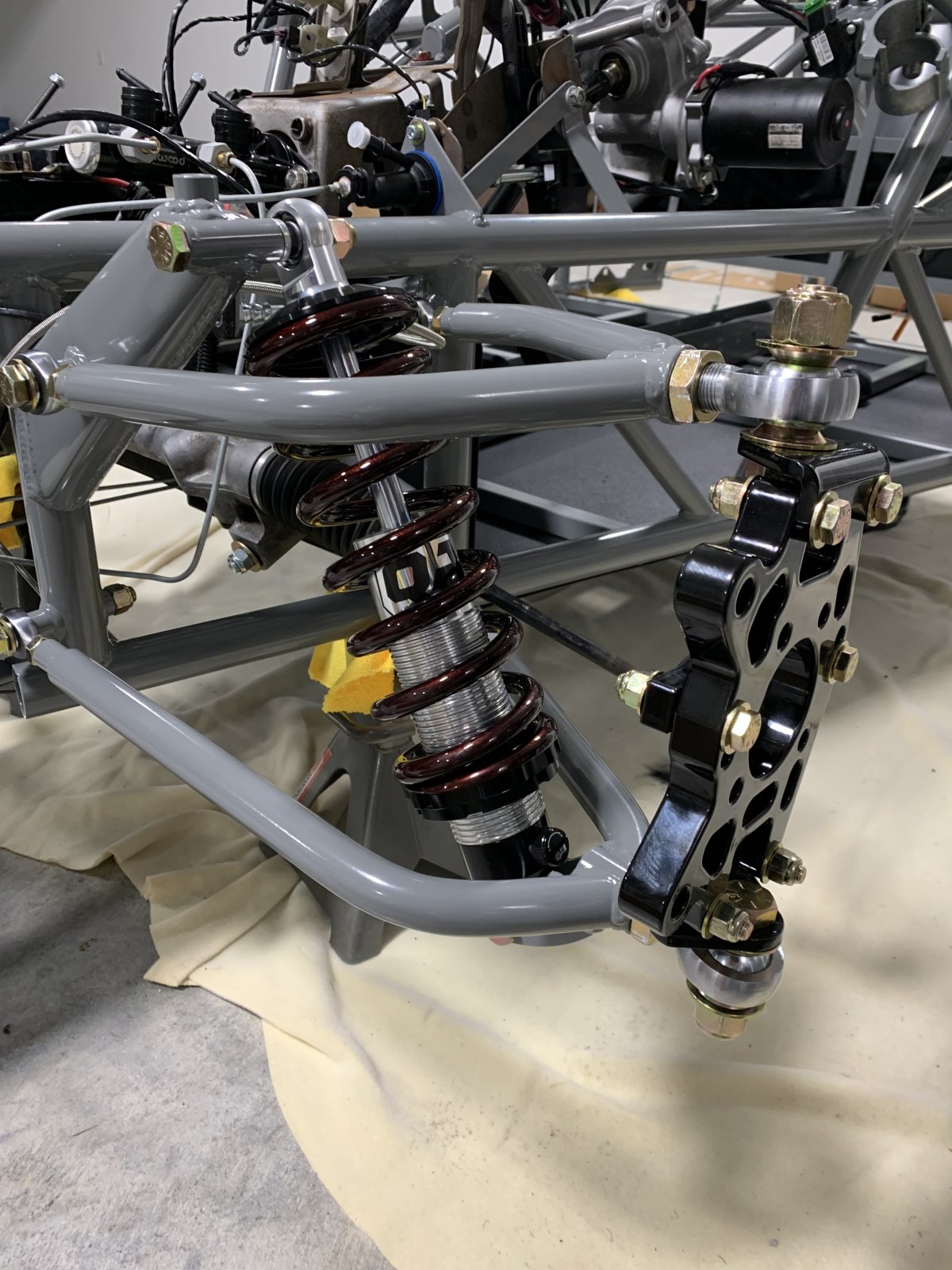

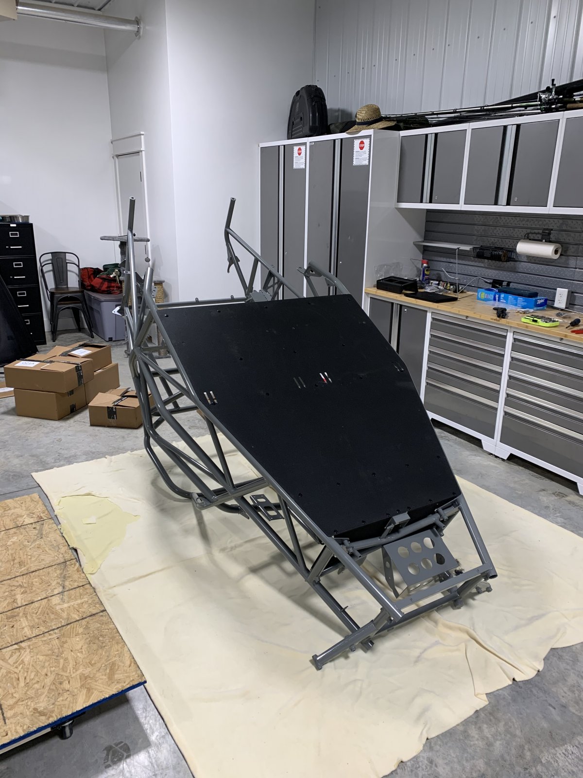

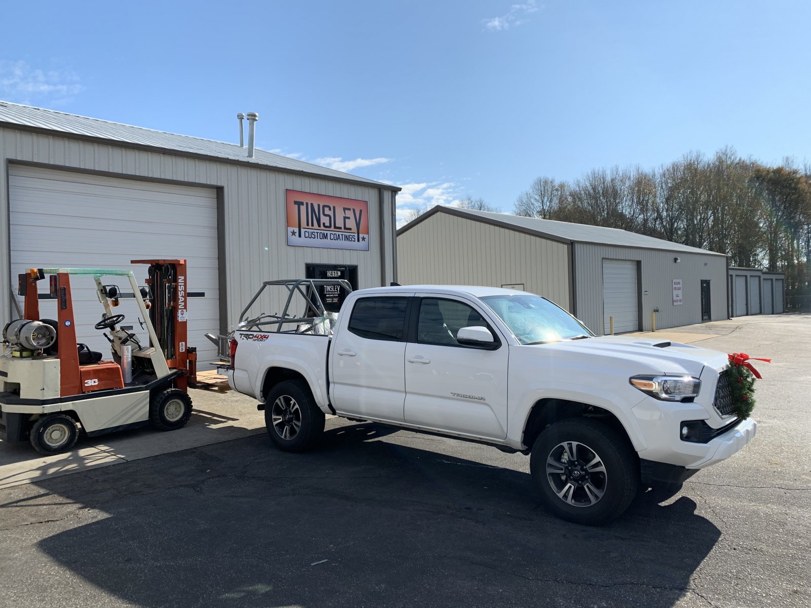

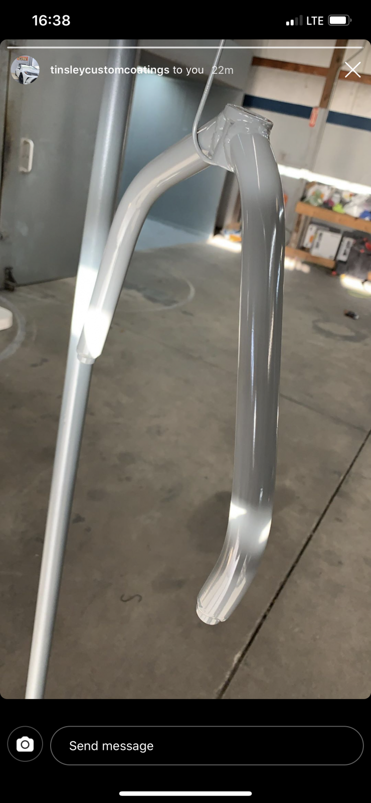

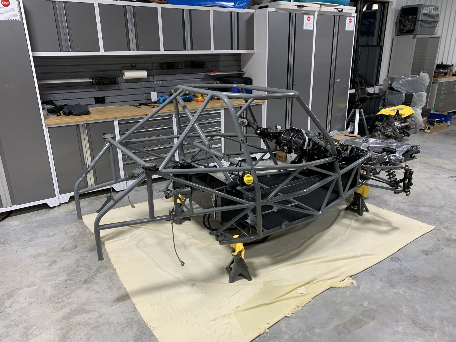

Pretty big update.

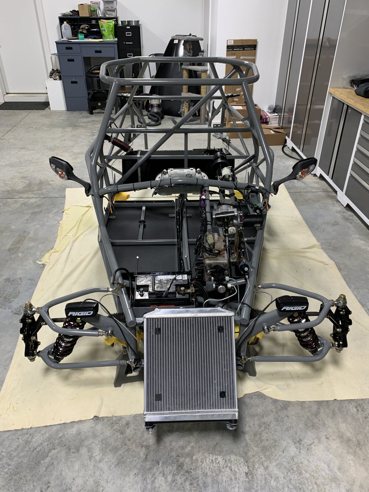

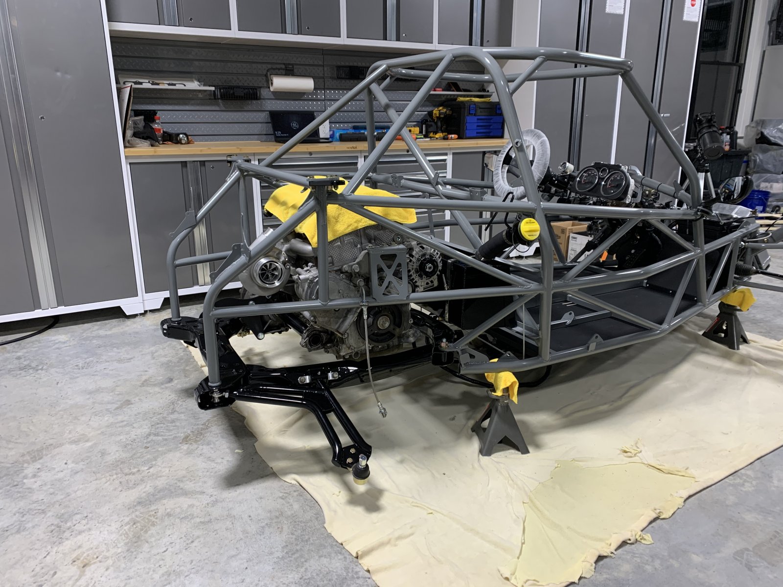

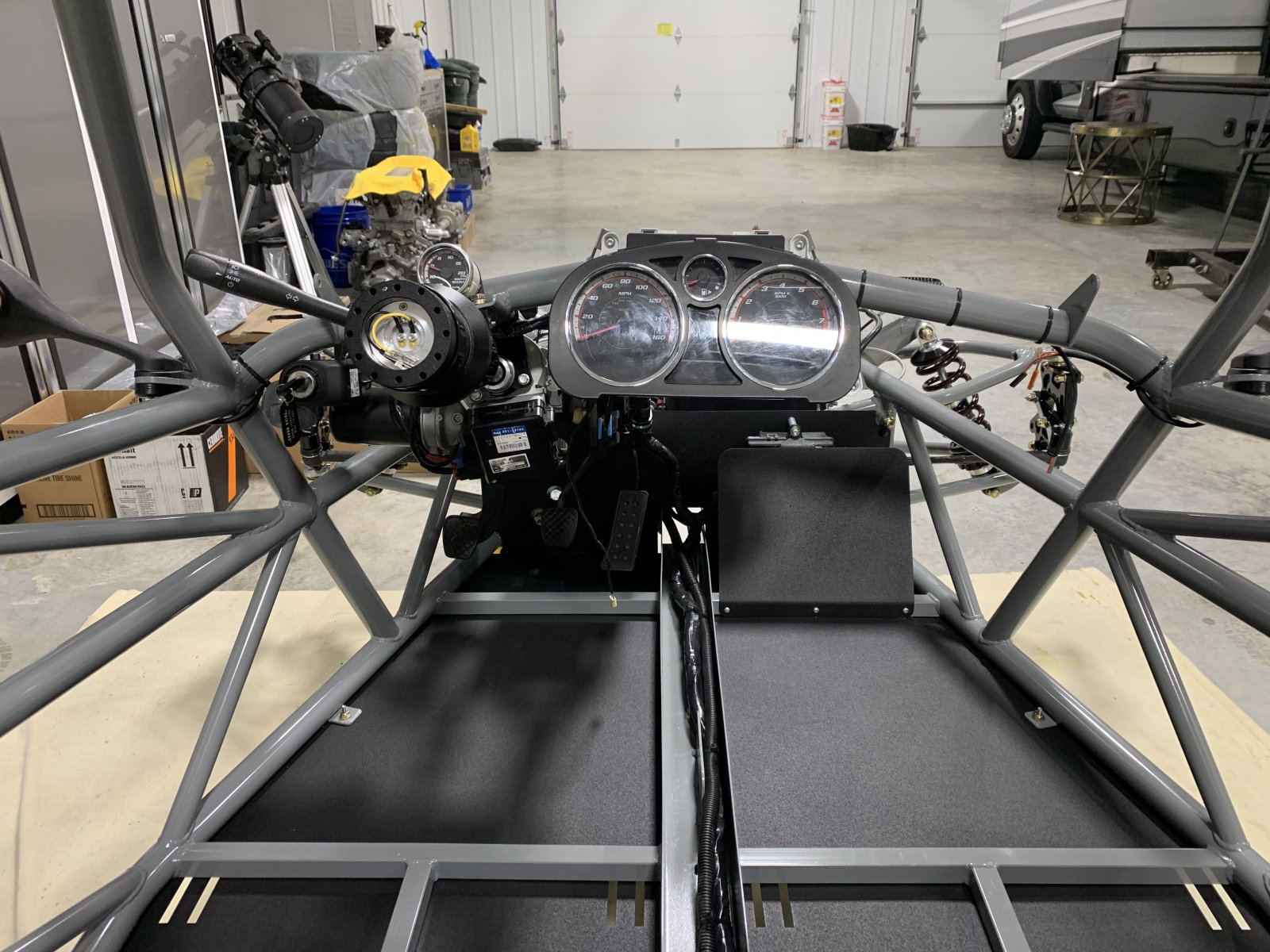

I picked up the chassis and miscellaneous stuff from powder coat this past Saturday. I was pretty burnt out from driving most of the day so I just got everything laid out and prepped to start Sunday. I worked most of the day Sunday and got a fair bit complete. The ZZP Black Friday order is supposed to be here tomorrow. I’ll be able to get the turbo swap stuff finished up and get the engine installed tomorrow evening hopefully!
Tinsley Custom Coatings in Easley, SC did an absolutely amazing job with the powder coat. I dropped everything off on a Saturday and he had it ready for pick up on Wednesday. Everything looks like glass!
