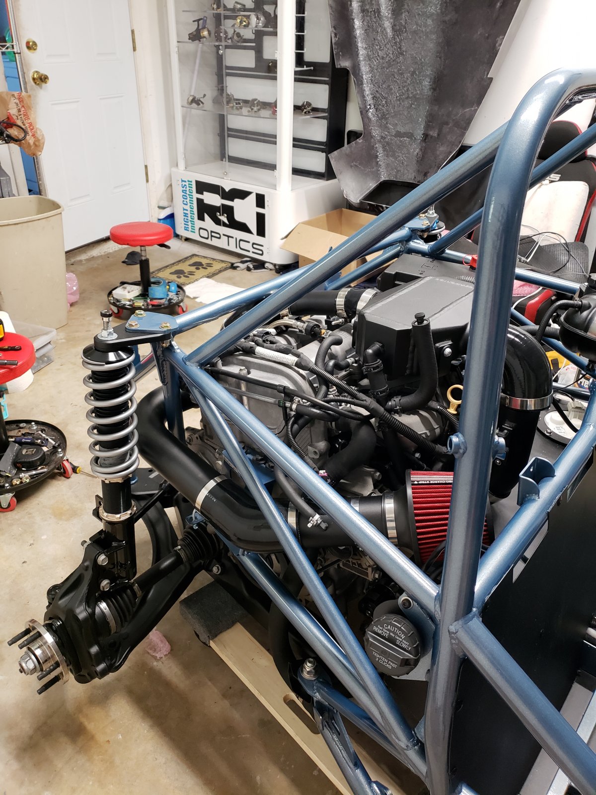

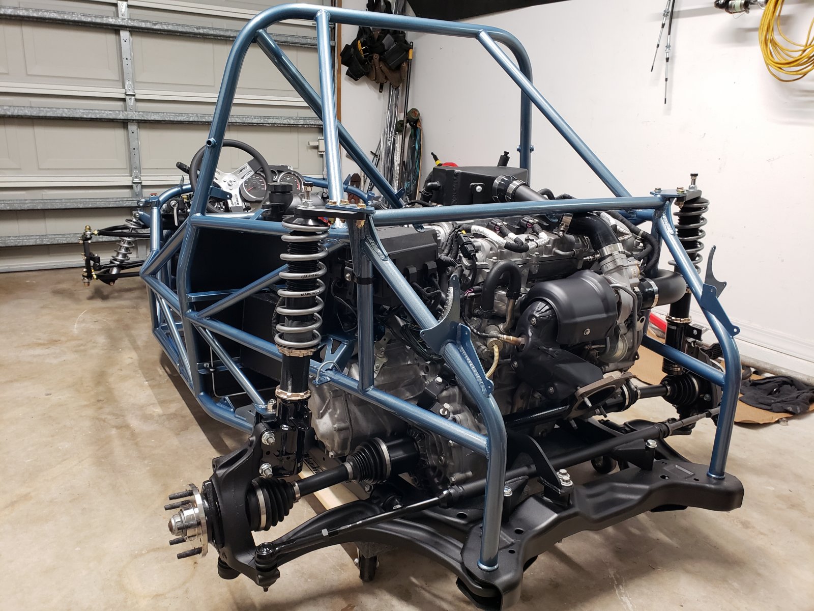

Well, shes almost ready for the road! I got it started for the first time. Thanks to Lonnys amazing wiring she kicked over first try!
Congratulations!!!
We’ve had quite a few lately making major milestones. I can’t wait for us to get to that point - again.
Cheater for having DF do your wiring. Hah. :) I cheated too by having them pull my radiator hoses.
Congrats on the start. The stress of it not starting immediately goes away once it fires up. That sigh of relief never felt so good.
ncgoblin
I spent only 45 hours on my wiring :) yea it was the hardest part x10.
Lethalcast
Well, after seeing so many pictures of plugs, birds nests of wires and countless questions I figured it would be a lot less stressful to have Lonny do it. The wire harness was perfect haha. All the lengths, connections, bends, everything. Most of all it started haha. Yes, it was a huge sigh of relief when it started up and not on fire lol
ncgoblin
I don’t blame you it’s worth the money I’ve touched almost every wire modifying lengths, removing tape, extending grounds if I did it again it would be a ton easier so for Lonny doing it 20x I’m sure he knows all exact lengths.

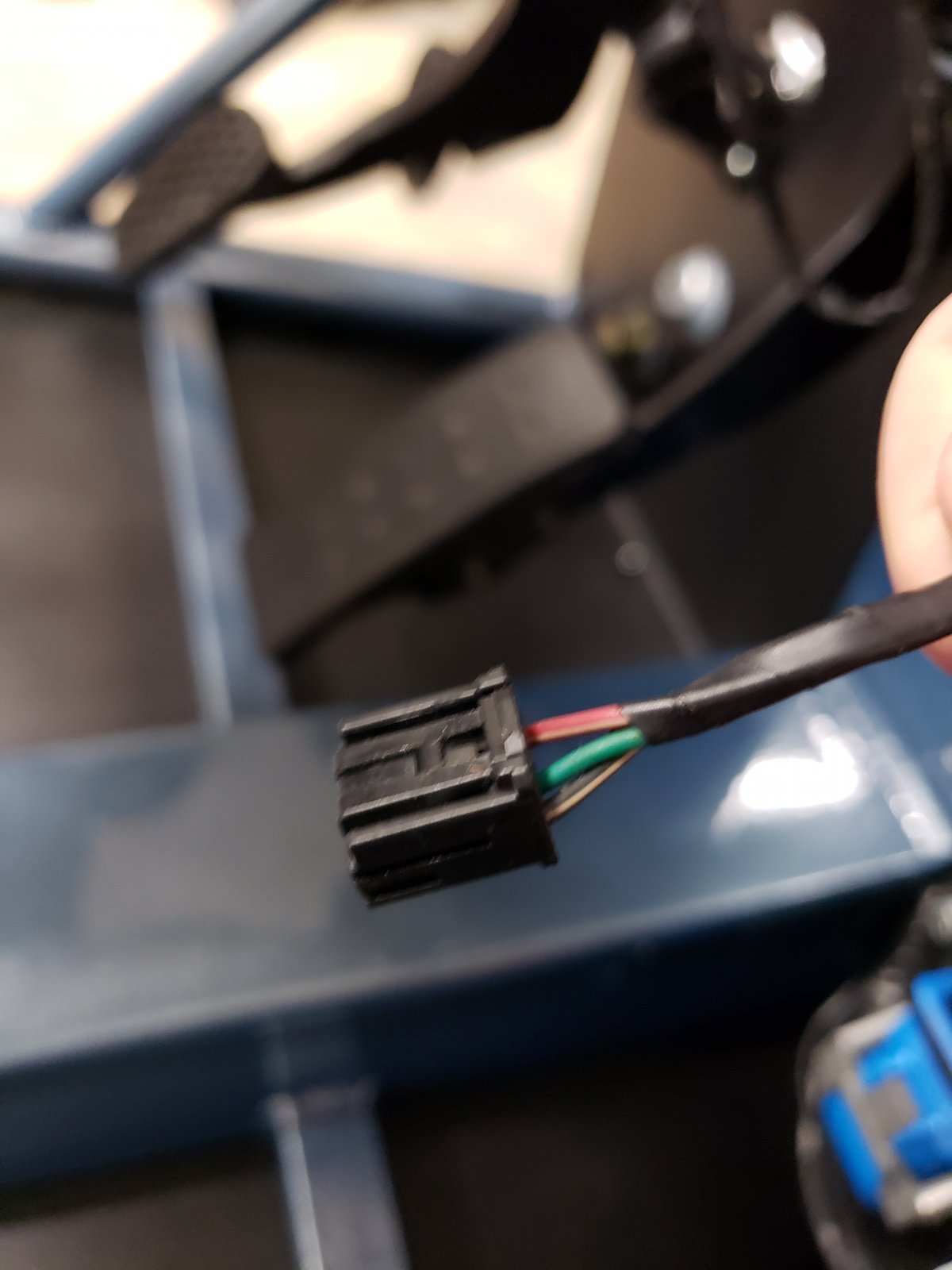

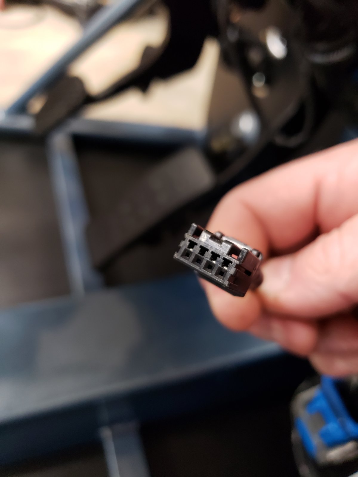

What happens if you don't hook this up. Will the car not start? If so, can you dissable tire pressure and key fob with hptuners? Im asking because my donor randomly pops up "service tire monitor system" with one tire pressure value at zero. Then it goes back off after a few cycles of the ignition and the tire pressure value comes back. Then it will pop up again with a different tire pressure value at zero. Wondering if I need to get this fixed at the dealer before dismantaling it.
With it disconnected it will not pop up any warnings.
You don't need to connect it unless you are installing sensors in you tires.
Mine does the exact same thing. Its always one tire. Fairly annoying. Since TPMS is a body control function it can't be disabled through HP Tuners.
