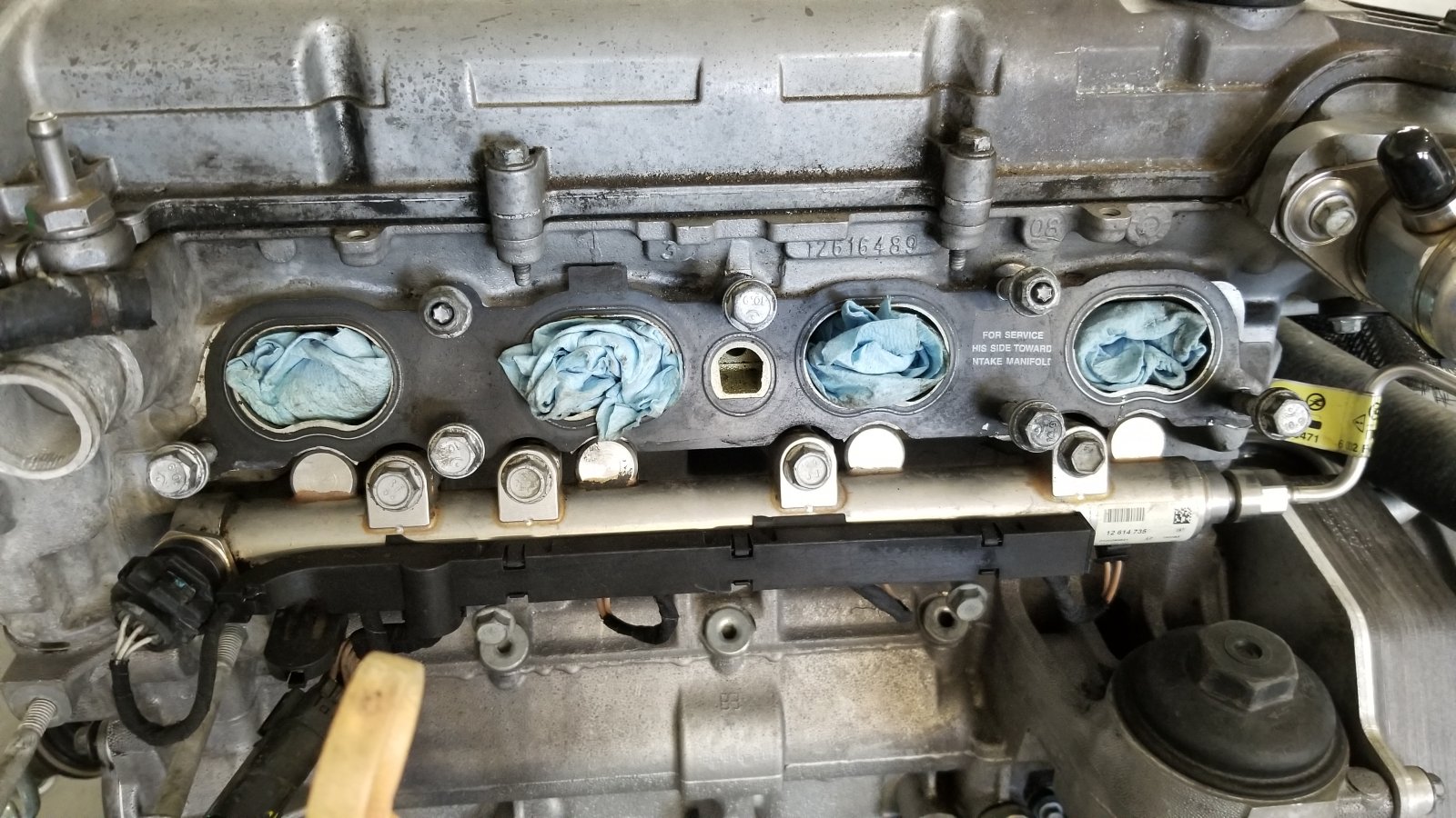

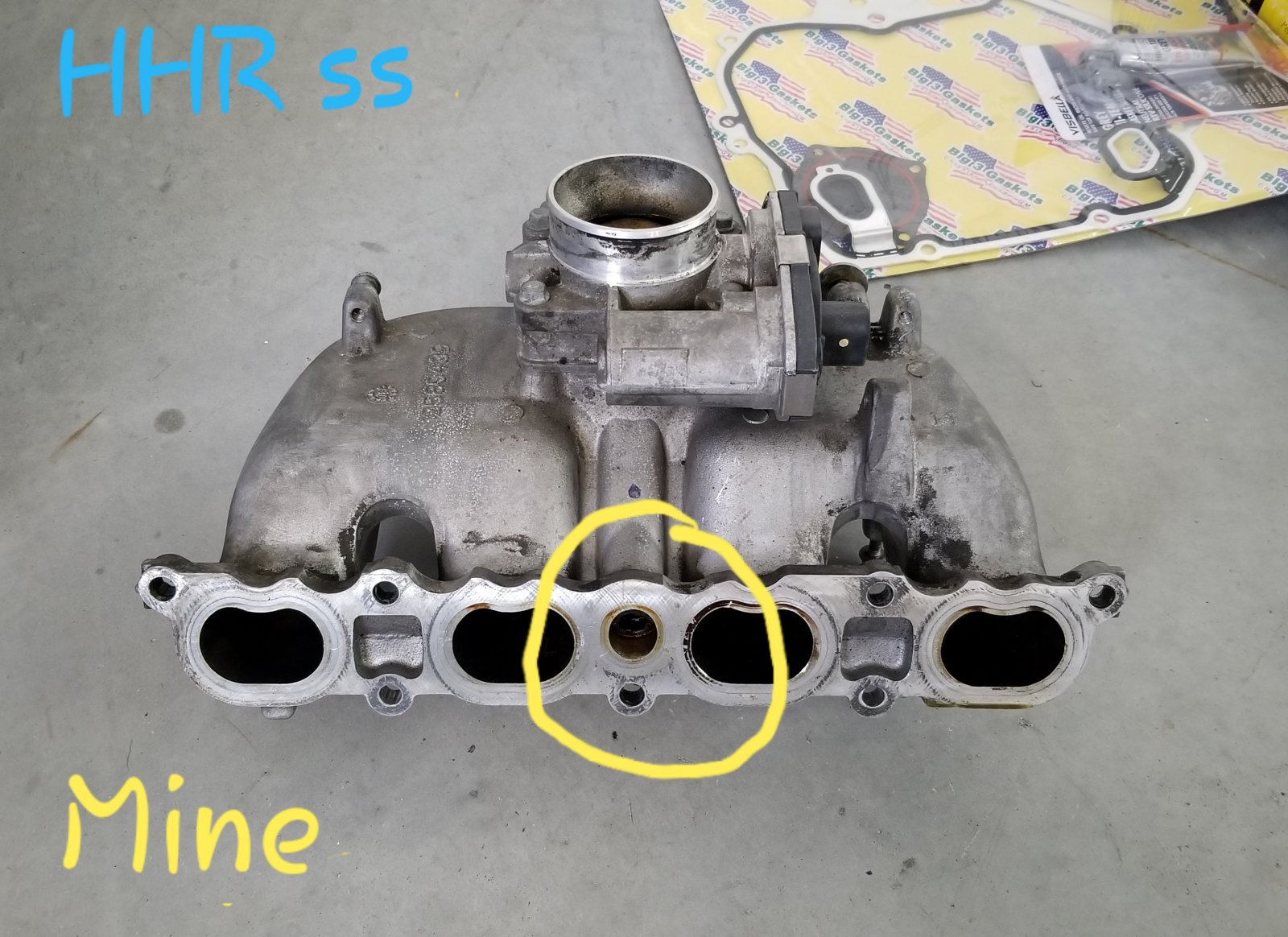

Torchandregdoc
JSATX
I’m not positive on this but I’m pretty sure that’s some sort of California emissions hole. Most vehicles don’t have that.

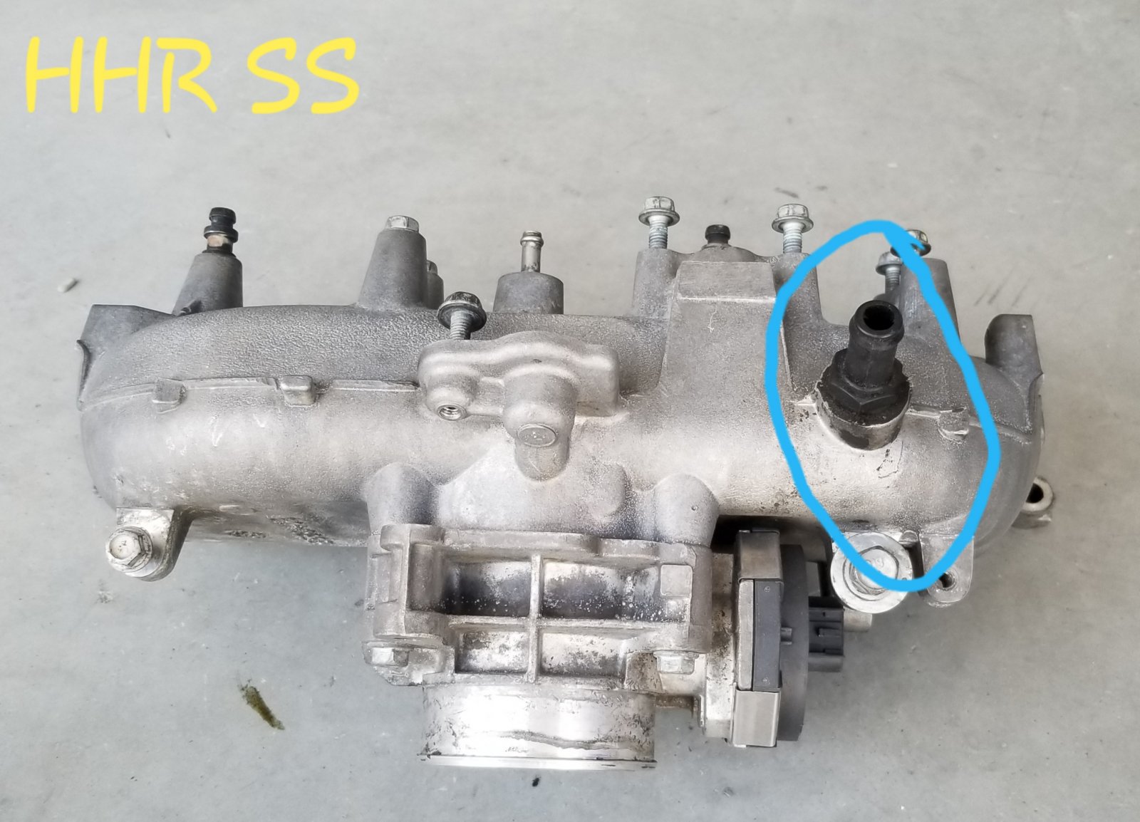

OptimizePrime
It's the PCV. Looks like the LHU intake manifold is the way to go. Would the LNF Throttle Body work with this?
It can be installed in the LNF, however the MAP sensor hole needs to be enlarged and the map sensor bolt hole needs to be ovaled out to match the intake manifolds threaded hole.

Torchandregdoc
I took the car apart 2 months ago and can't remember. Is this for the pcv? The intake manifold is under pressure, how can that be for a PCV?

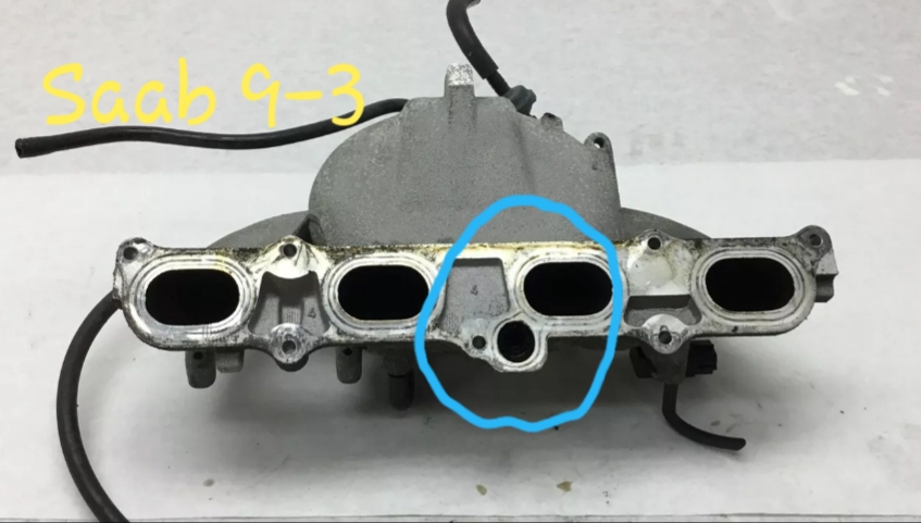

where does that port go in my head? Would i just plug the center port in the saab intake manifold? I agree, its probably emissions, but then again I don't want to push charge pressures into the crank case. I still need to burn crank case vented air or its gonna make a heck of a mess isnt it?
The LNF has direct injection whereas yours is still port injected isnt it?
I need to understand what that center port does and how does a forced induction motor keep negative crank case pressure?

Torchandregdoc
And the story continues.....

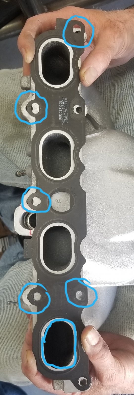

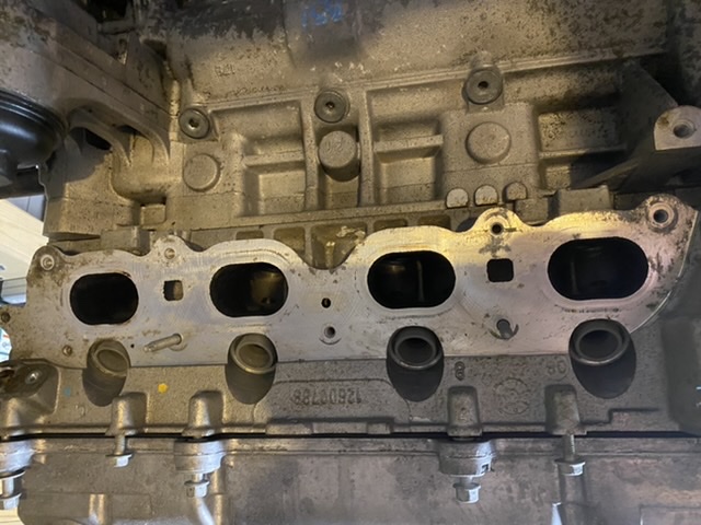

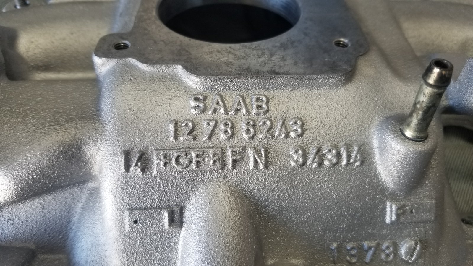

I picked up a Saab 9-3 intake manifold.
Part # 12786243
It doesn't fit the LNF head. It might be able to be made to fit, but it will be crude at best.
Jim, you could have the intake manifold bolt holes welded in, add some extra to the end in your right hand in the photo to extend the flange, and redrill the bolt holes, if you are set on using the SAAB manifold. It would take some work, but it looks doable from the differences with the LNF intake gasket. :)
