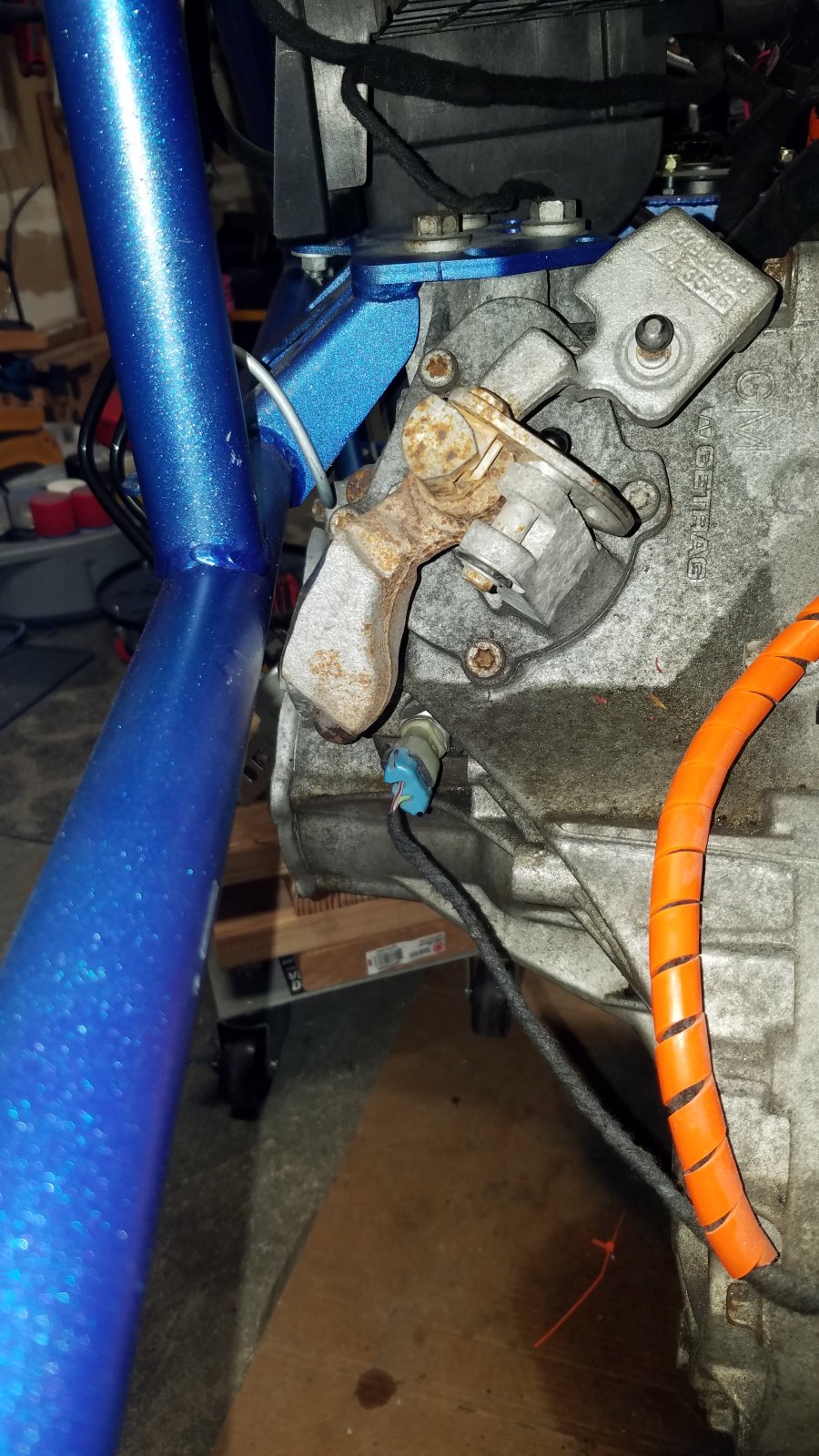

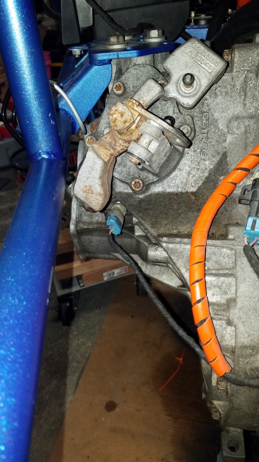

Wasn't sure if any one else had the issue i did when installing the engine and finding the gear selector would bang against the chassis.
I found a video about fixing the wobbly shifter problem that these engines sometimes have and found the way to take off the gear selector. I'll Link to video [here]

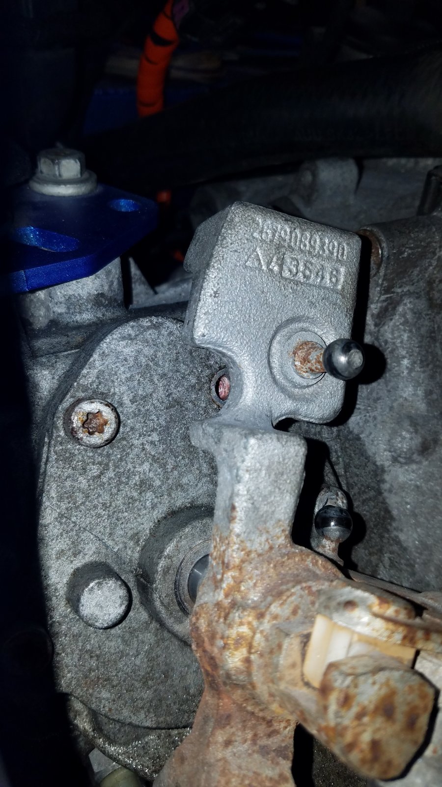

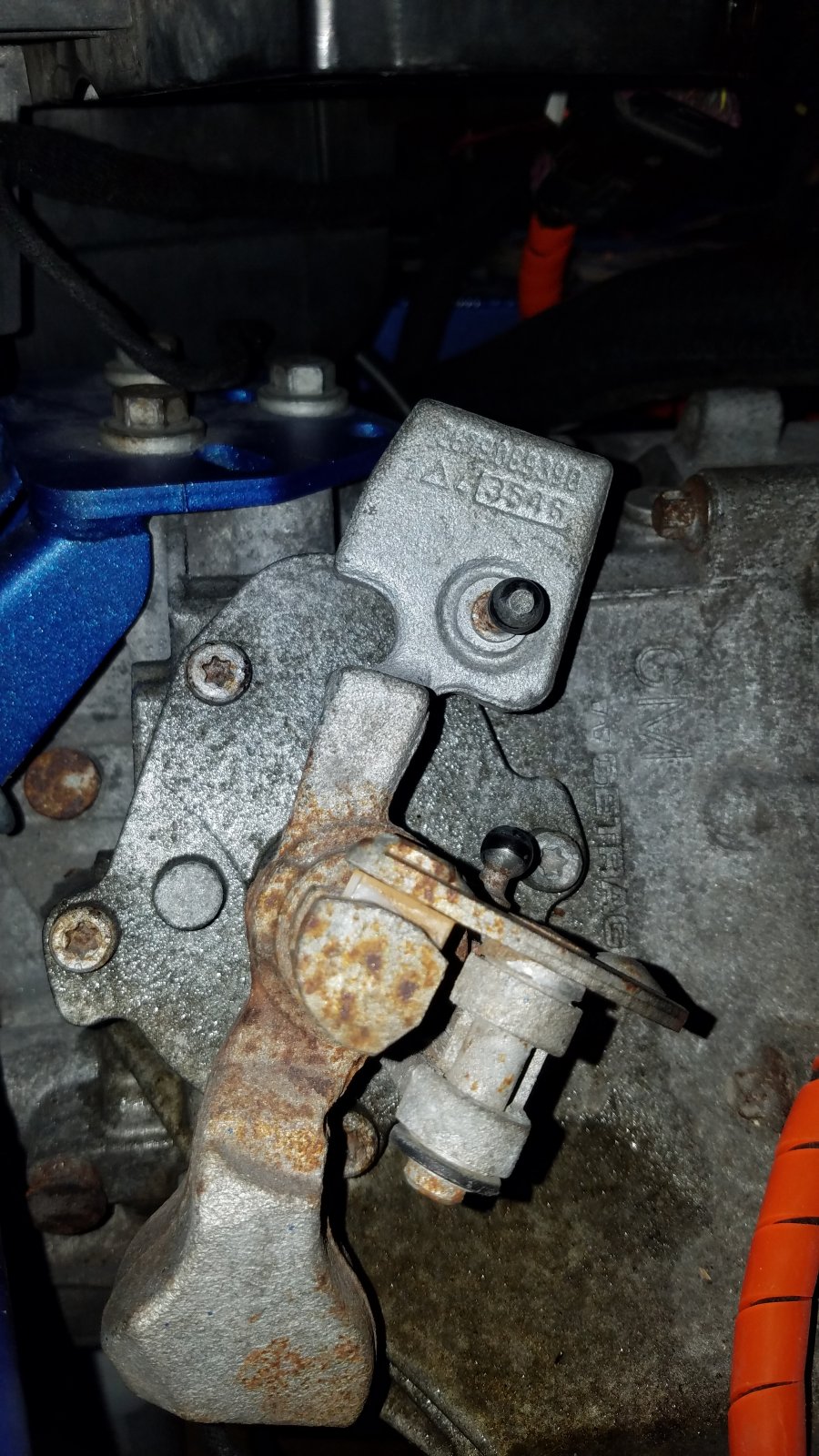

This getrag needs an 8mm ratchet to loose this bolt

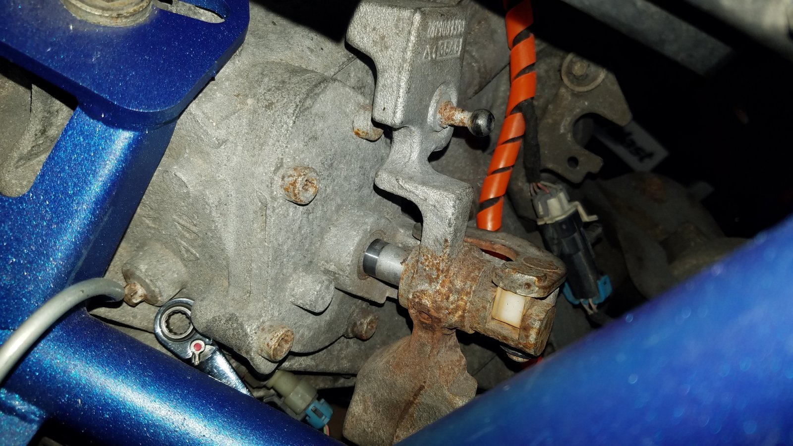

Afterward the remaining bolts on the face of the selector need to be loosed

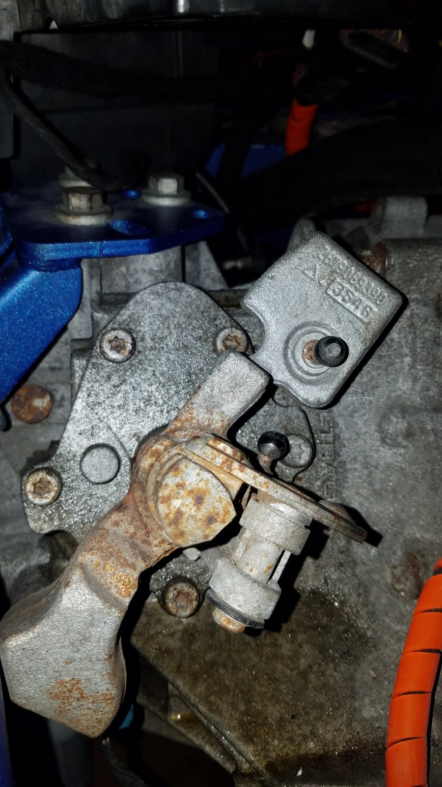

Although one of the top bolts is hidden behind the selector so i loosed & pulled it first then shifted it back to neutral.

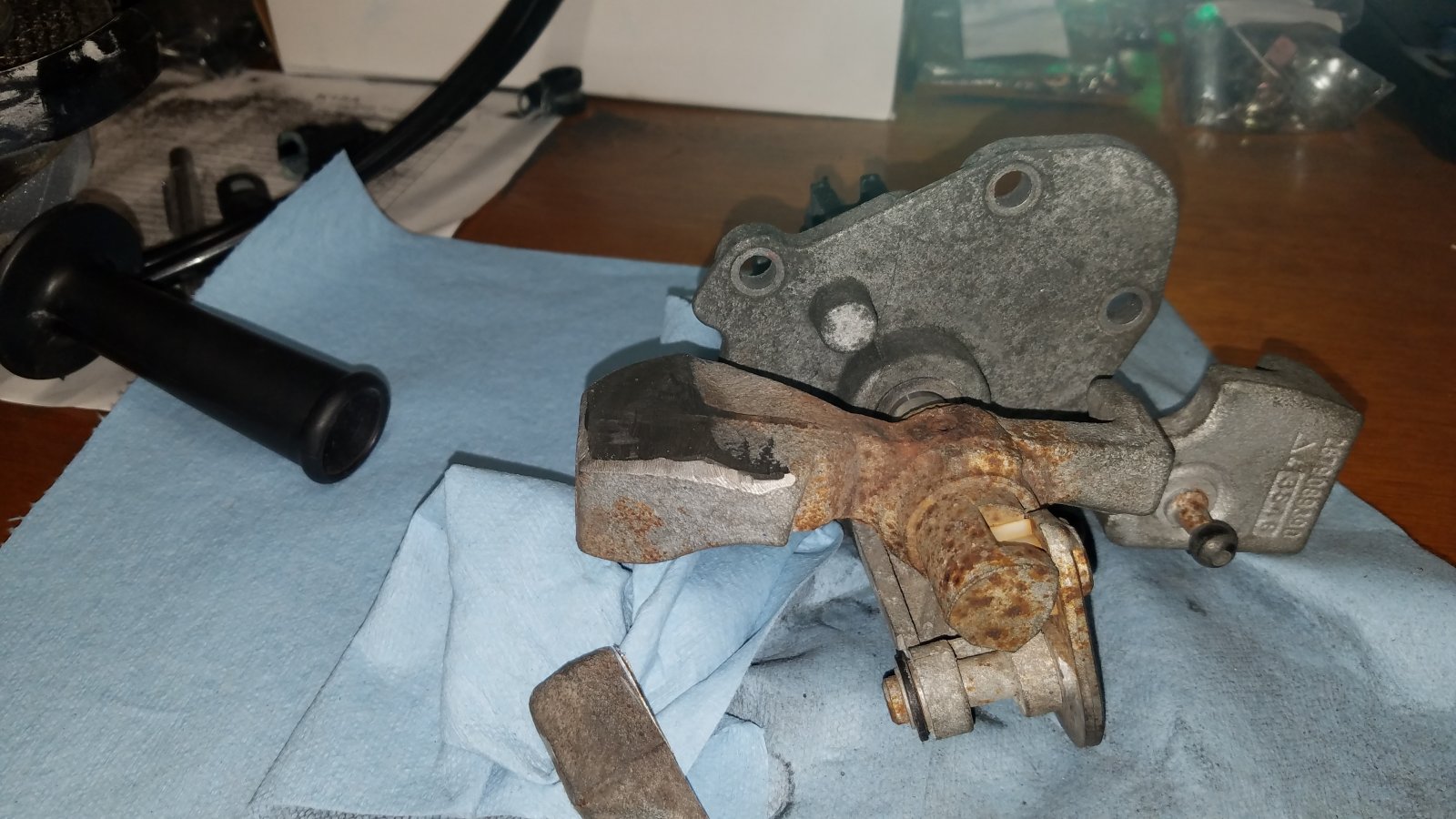

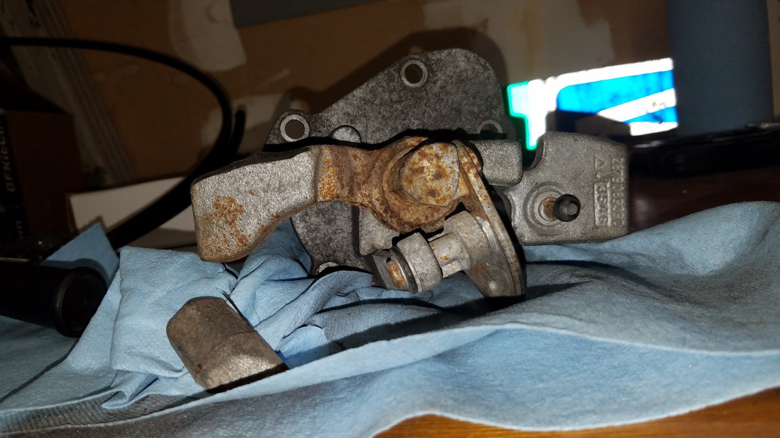

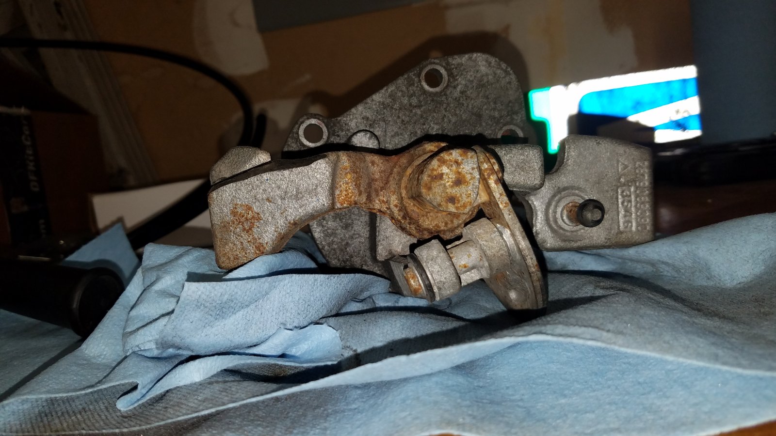

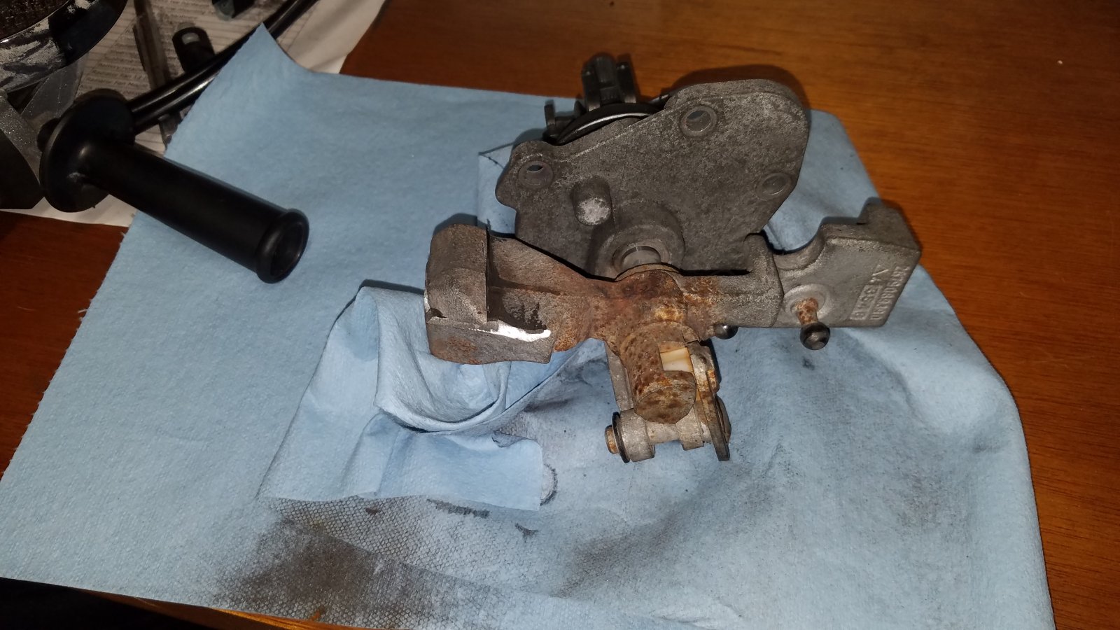

After pulling the selector out I trimmed what i wanted to off with an angle grinder and smoothed any edges while there
Fits like a charm now. No more clanging when the gears are shifted now.
