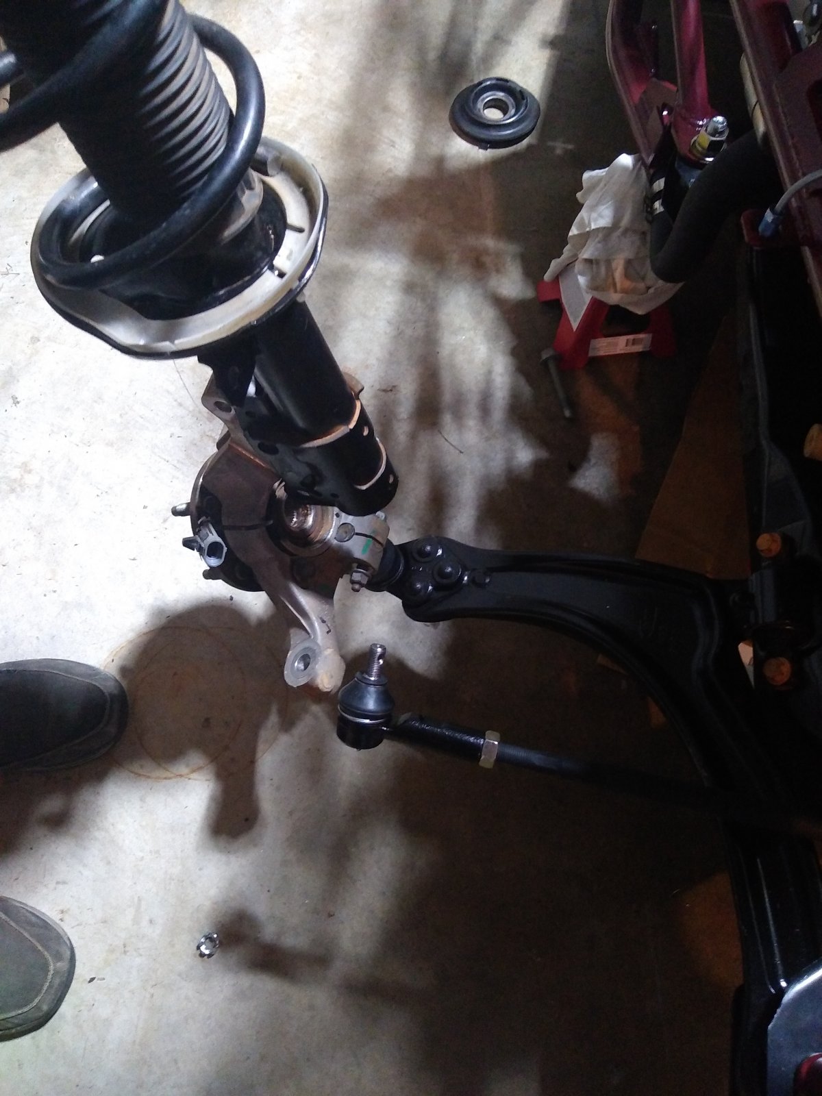

The rear goes together super easy. Are you reusing your struts for the rear or did you get the coilovers? You definitely don’t need the rear axle from the donor so no need to worry there.
I think I will need the drive axles from the transmission. I found what was the 'upright' on the front of the donor and test fit it into place and I see how the rear end goes together. However I cannot find the 'upright' for the right side, only the left. I sense a trip to the pick-your-part place in the near future. I am using the donor coil-overs from the front end, and yes, the assembly looks super easy. I am a little uncomfortable, because it does not look solid to me. I will have the sub-frame, the drive axle, the tie rods, and the strut holding the rear together. Is that all I need? I will be scanning the forum (suspension) to see what else I may need.
Goblin Graber
The right side ‘upright’ you’re missing is the knuckle. Mine was broke on my donor so I got one on eBay from LKQ. They want more money for abs ones than the non abs ones. The knuckles are exactly the same. Its just if the bearing has the abs sensor or not.
Sounds like you have everything in the back except the control arms. The control arm is what bolts to the bottom of the knuckle and connects it to the subframe.
Not assembled but in their proper place
I expected some sort of arm coming from the front of the car connecting to the suspension, since that was how the donor was set up. I will take simple and easy any time!
Brett
That looks right. Dont make the same mistake I made and tighten everything down without the axel installed.
Curious what the extra arm coming from the front on the donor you mention. The only other piece that would have been a part of the donor front suspension is a sway bar, which is mounted toward the rear of the subframe and connects to the back of the struts.
DS, I was talking about the rear suspension. There was a control arm or trailing arm, don't know what it's called, on the donor coming from just behind the door and connected to the rear suspension. I could not picture the rear suspension on the Goblin without that arm. It looked too 'floppy' in my mind. I have test assembled the suspension and I see how it works now, so I am good.
