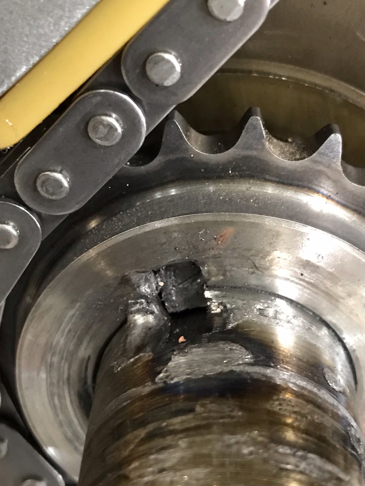

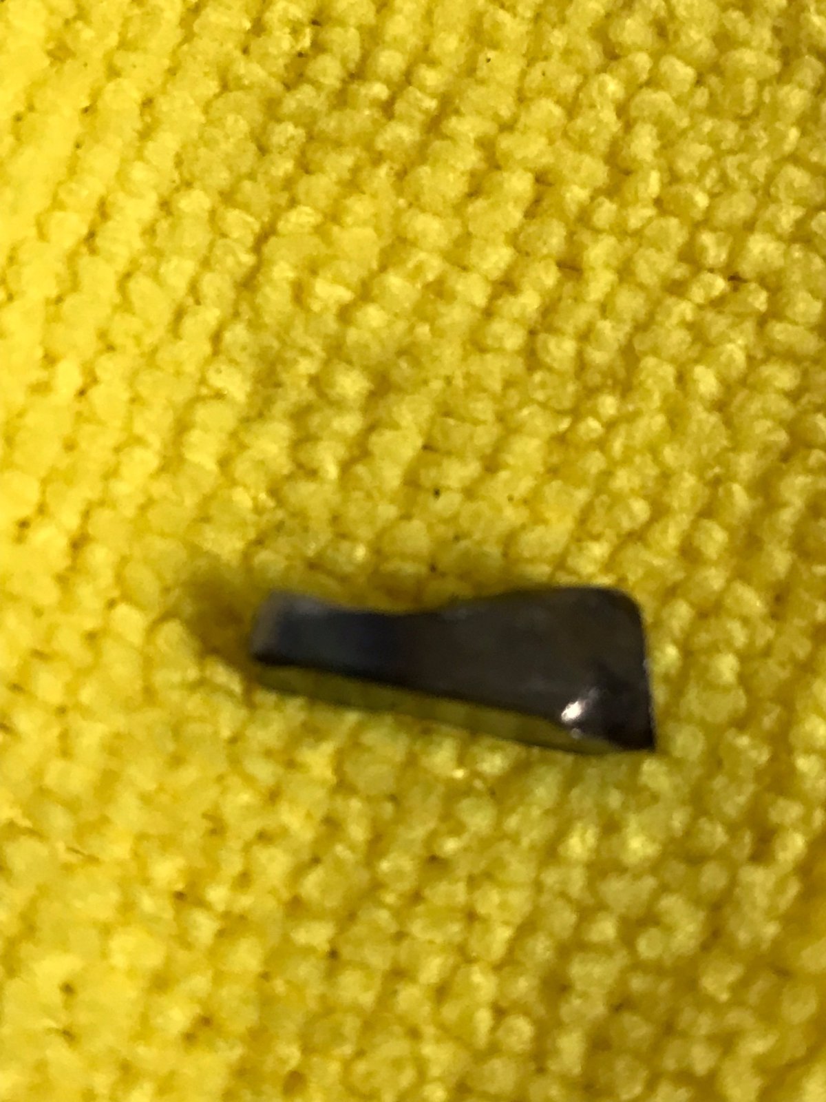

Looks bad, The crank did clean up the keyway is fine. Looks like the hormonic balancer came loose and sheared the key. Looks like a new balancer and key.
thoughts?

Oh that's not looking good. Can you get anymore photos of the crank snout and the inside of the balancer? That single photo of the actual damage is limited in visual information.
You may be able to use a fine tooth file to clean up the edges of the keyway in the crank and use some emery cloth to clean up the scorching and spaulling on the snout. It's hard to tell how large/deep the gouges are on the edges of the keyway slot - this may be a limiting factor for reusing the crank. Additional photos may show other things of concern. Sorry about this. :(
