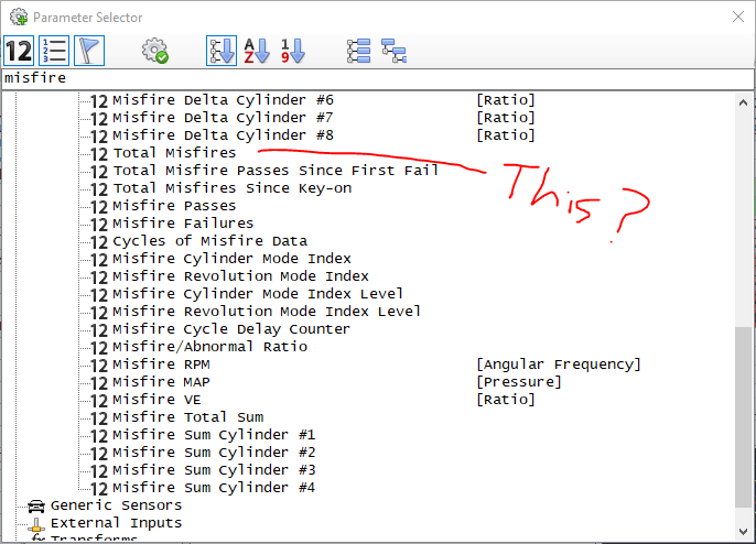

#1, I'm going to try to log misfires. In the scanner, I see multiple parameters for misfires....I have selected "total misfires". Is that the right one?

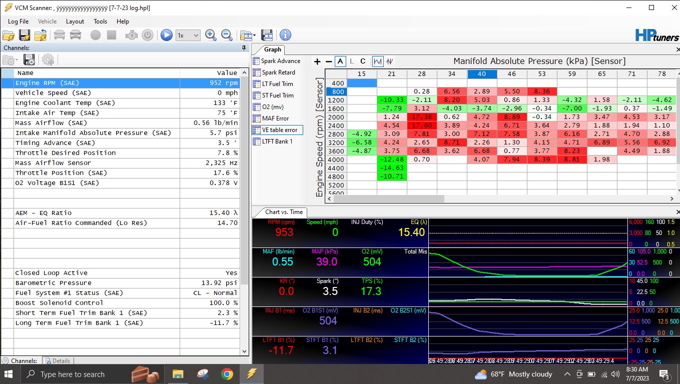

#2, My LTFT seems to be weird. My wide band is behaving correctly....I can see positive and negative values:
41327

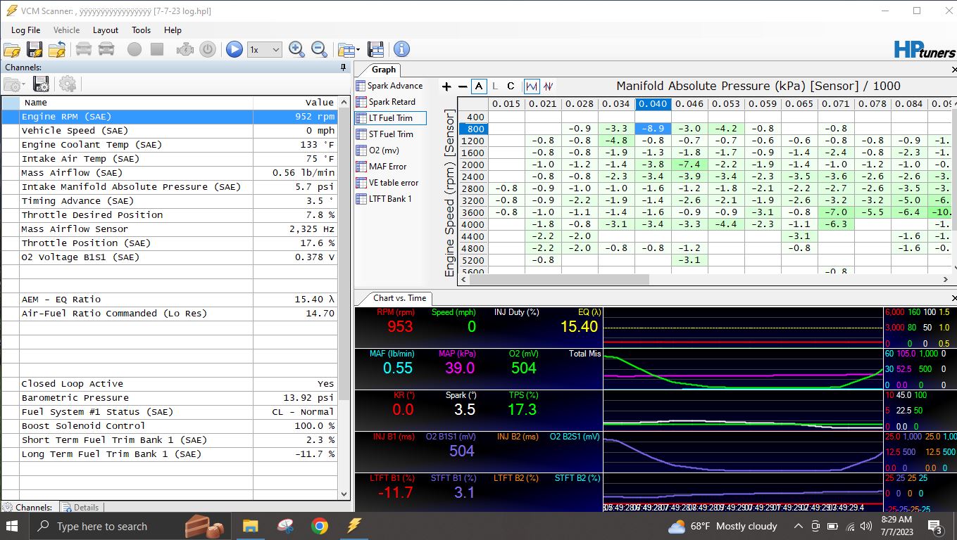

But LTFT is ALL NEGATIVE. It's just pulling fuel all the time, while I can clearly see (and feel while driving) that it's way lean. Is there something wrong with the stock scanning software? That LTFT parameter was one of the stock options, I didn't do any crazy math or anything to log it.

#1: I would look at individual real-time cylinder misfires if it's available, if not maybe the individual sums. A general misfire in all cylinders could be tune related. If just confined to 1 cylinder it's more than likely a different problem.

I don't know enough about the lsj to know if you have everything set up right to tune, but you aren't up to operating temp in the screen shots. What are you using as guide for tuning? Be careful of using a guide or video for an LS V8 ECM since each of the ECM have their own peculiarities that might need to be set up for.

#1 log each of the 4 cylinder misfires

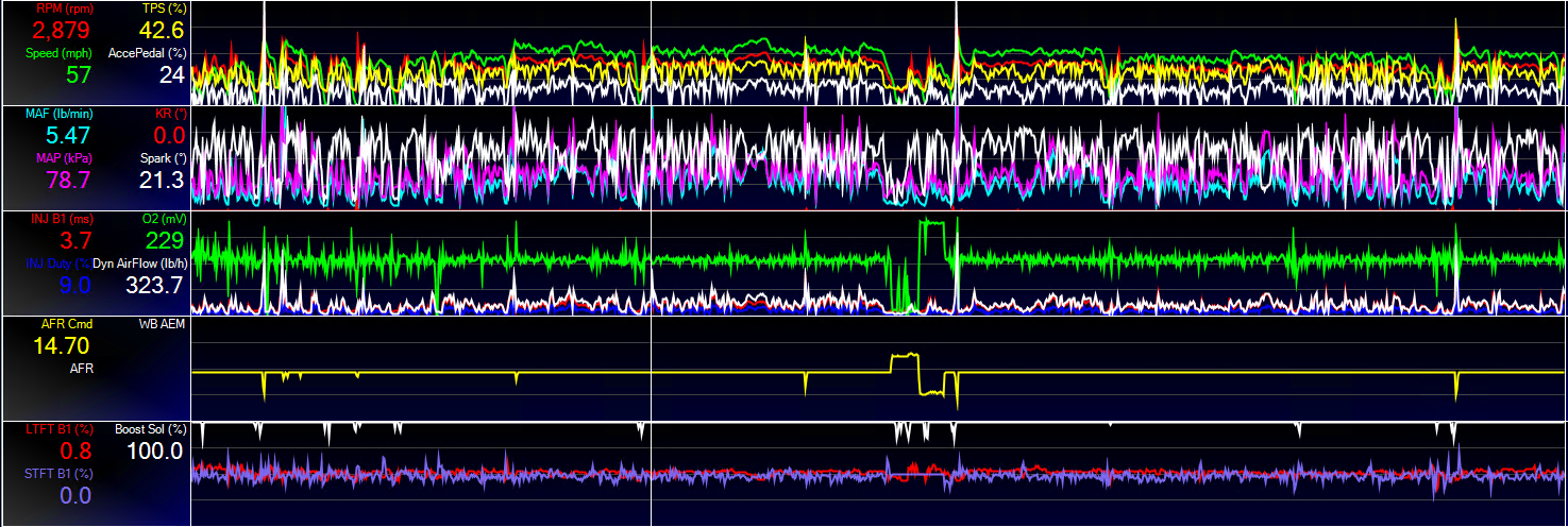

I'm running into some similar issues with the car randomly having similar issues. My donor was originally an 06 but swapped to and 07 PCM due to the supercharger bypass circuit being bad in the 06 pcm. I was fighting these issues until i recently came across this thread removed rear O2 car goen into open loop randomly. I the thread they talk about how this is a apparently known issue with the 07 pcm in the community. I swapped back to my old pcm and although i got no boost cause of the original supercharger bypass solenoid issue, all my other random lean/ open loop activation issues were resolved.
Here is 1-hour drive log of mine that shows it also goes into OL periodically. I always assumed this was for a test, most likely the second O2, but now it sounds like it's pretty proof positive. I never worried about it because it didn't seem to cause any drivability issues. The UP/Down spike you see in the middle was the only time is was in plain OL. The commanded jumped up to 16.20 and then dropped to 12.90. All of the other little dips you see are OL-Accel/Decel and are most likely because of PE or other commanded AFR based upon the accel or decel and not a test.
I should turn on the P0136 (O2 Circuit Bank1, Sensor 2) to see if it logs a DTC after the change in the commanded AFR. Not that this would stop it from happening, but just to prove that's what is going on.
