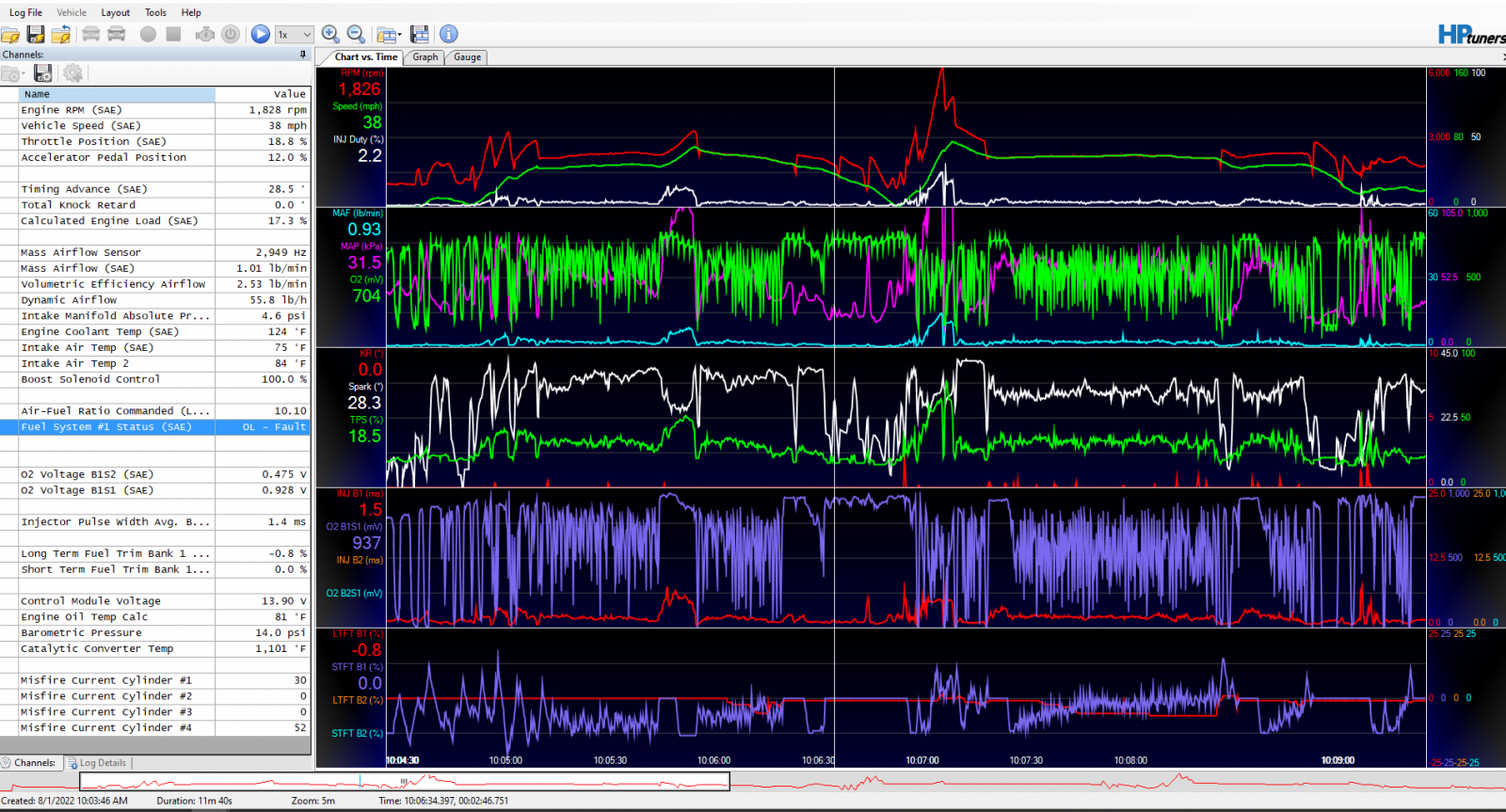

I figured it would be best to move the issues I am having out of my build thread into this one. Might help someone else down the road.
Synopsys is Low Boost and Misfires. I reset all the parameters for the DTCs back to normal. I will try to get out in the AM before the rain hits to see if I get some codes.
Ghostknife

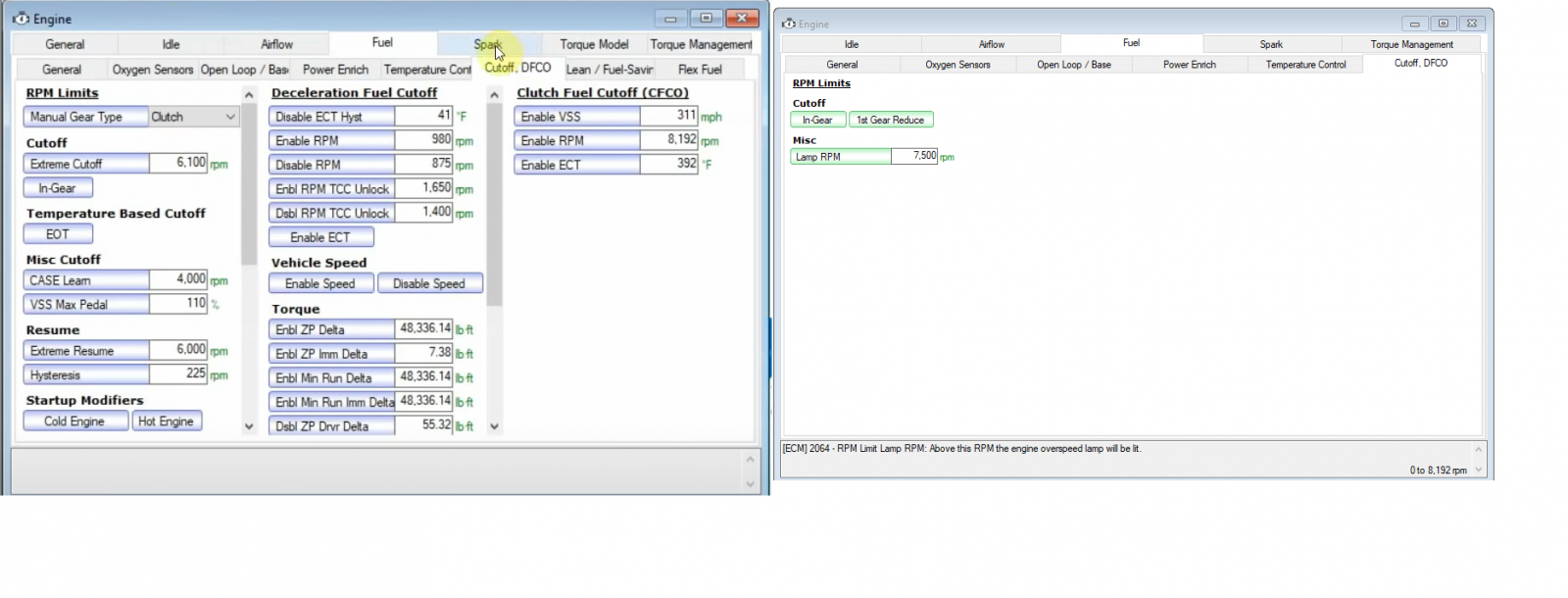

Watching Goat Rope Garages videos, will HP Tuners only give me parameters that I can change? It seems I don't have a lot of options but maybe its since I'm on a newer version. It seems that it is going into Open Loop when decelerating, Also when all of the Misfire counts climb up

Can you get the wideband into the logs?
I don't think I can, I will have to check to see if the AEM has the output. It was in the donor car when I bought it. I may end up having to buy an updated one worst case. I will look into it.

About the not having many options in hptuners, make sure you're in the 'advanced' view, not 'basic'.

It will depend on the model. The reason it needs to be in there is for a check on your narrow band o2 to see if they are failing causing the Open Loop-Fault mode
Make sure that you are in advanced mode, but the available tables will vary greatly from ECM to ECM. I don't know if Goat Rope has ever done anything on an LSJ. I think the basics principles are the same as earlier V8 LS stuff but there will be different tables available. The Turbo LNF stuff is totally different.
Be careful when talking about "decelerating", since to a lot of people this will mean completely off the gas and entering "Deceleration Fuel Cutoff (DFCO). I don't think that is when yours is entering "open loop-fault mode. I think you are still giving it some gas, just not accelerating. But I may have missed something in your log.
I'm still new at HP Tuners, but looking at the log, I'm guessing that there are both issues with the tune and other mechanical/electrical issues. It's going to be hard to distinguish between the two.

Some more research on the "open loop-fault" indicates that it might be the misfires causing the fault, not the fault causing the misfires. Of course then its hard to say what is causing the misfires. Is it mechanical/electrical or in the tune?
